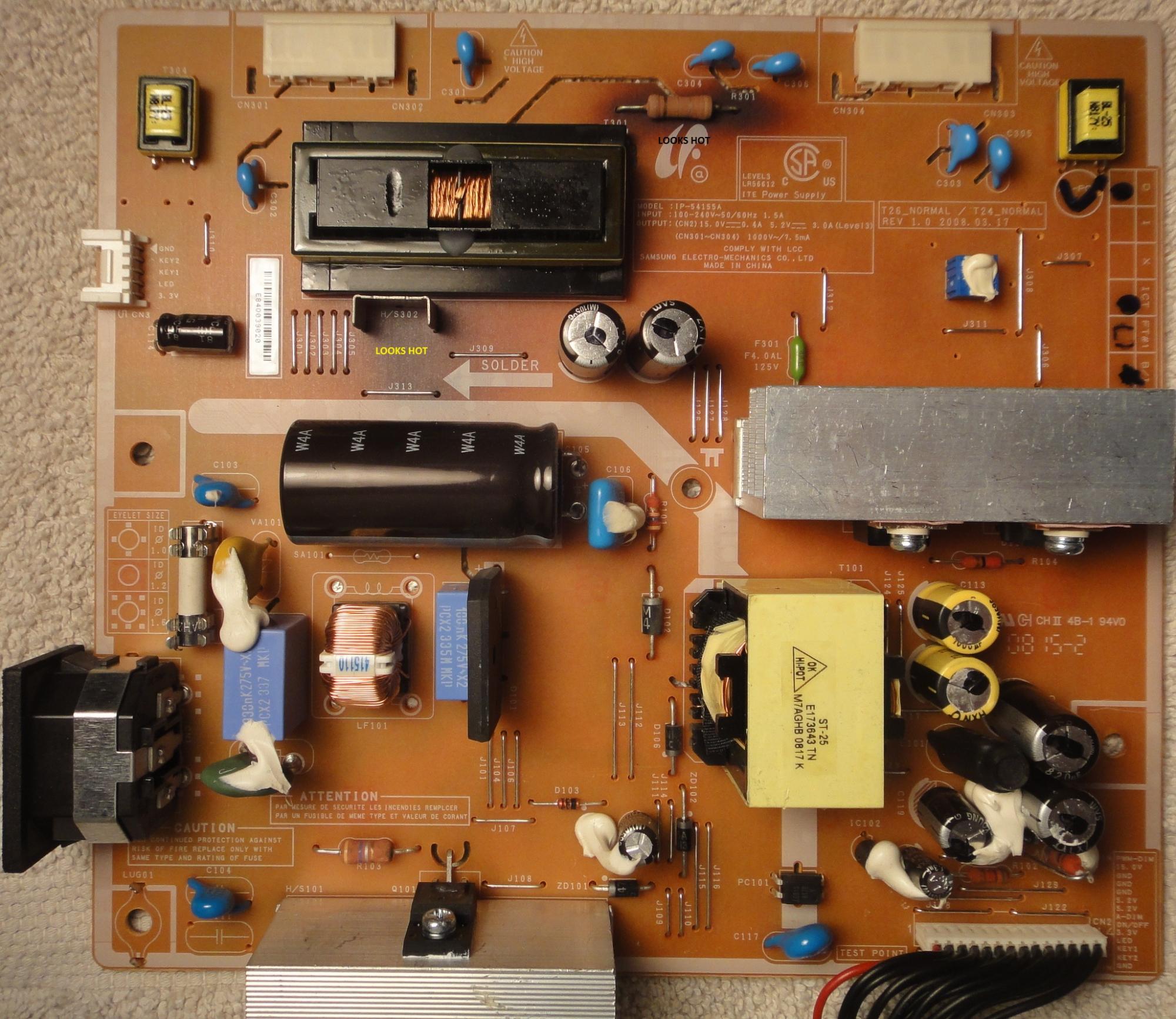

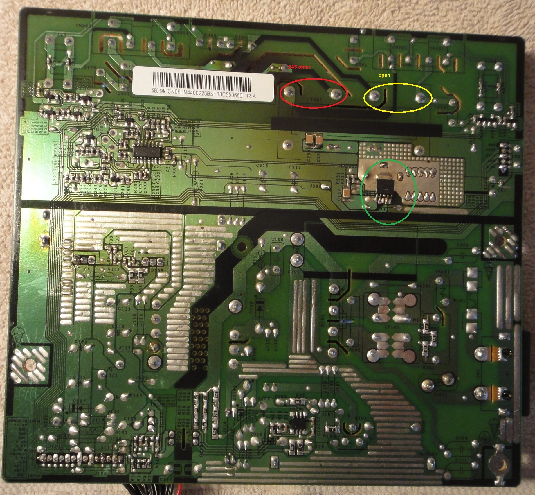

    Hi List Members,
    I am now the proud owner of a dead Samsung T260. It was made in May 2008, so I am hoping it doesn't have too many hours on it. It set me back $25.
    I took out the power supply circuit, and have attached some photos below. The caps look ok on appearance, but all the same I will change them just add to the reliability.
    At first glance, T301 looks like it became really hot; indeed, it does not have continuity across my ohm meter. Can anyone suggest a replacement?
    Also, I am thinking that something caused this to blow. There appears to be another hot spot just below the transformer, almost exactly where the 'Solder' arrow points.
    I read in another post on a T240 that I might suspect the transformer; I have attempted to take an ohm reading across the four different points, and I have annotated my photo. Can someone confirm that I did it correctly? If yes, does this confirm a dead transformer?
    Also, the hot spot in the direction of the 'Solder' arrow has a component below it, which I also suspect, for no other reason that it looks like it was hot once upon a time. Can anyone add their thoughts on this? I have added a closeup photo of that component as well.
    Thanks as always...

    Define dead.
    1) Does the power LED come on at all?
    2) Do you have any DC voltages at the connector on the power board? Measure and report the found DC voltage compared to what is written on the legend.

      In my opening post, I stated that T301 looks like it was hot; actually, after looking at the board again, it looks like it was the resistor R301 that was hot. And it is open.
      • retiredcaps
        • Apr 2010
        • 9271
        Re: Samsung T260
        I would desolder R301 and verify it is completely open out of circuit.
        In addition, check picofuse F301 (the green one) just below R301. A good fuse should measure 1.0 ohms. You can measure the fuse "in circuit".
        It could be a simple fuse if you have no backlights.

          Also, what is the color band on R301? Your photo is nice and clear, but the colors are difficult for me to make out.

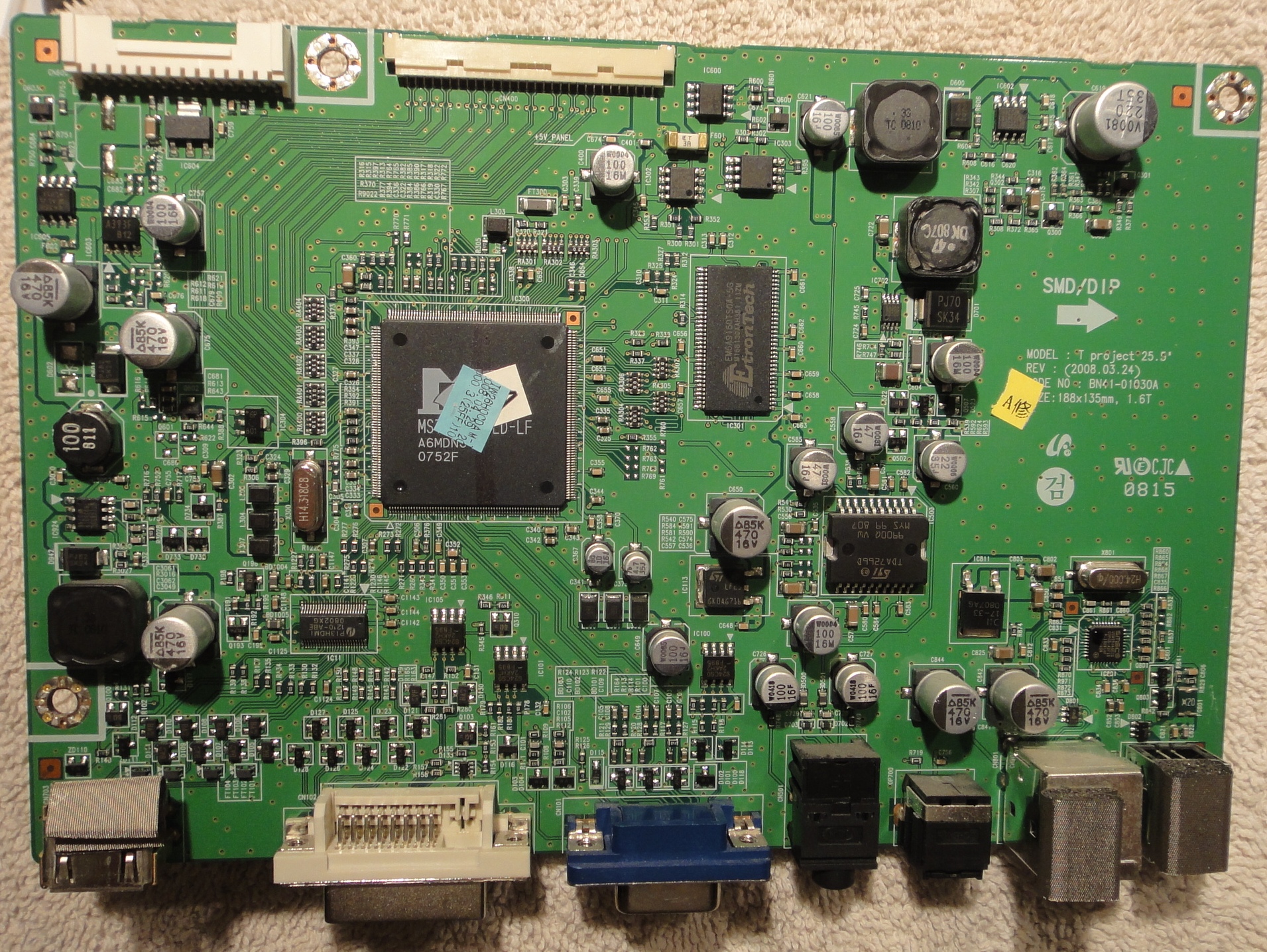

                      2) Let's get a picture of the main logic board.
                      3) When you press the on/off button, I believe pin 9 should go from 0 to over 3V DC.

                        One of the reasons we (mainly PlainBill and I) insist on clear focused pictures is for this very reason.
                        I was able to find another identical power board (IP-54155A) on badcaps.net that had a slightly better picture.
                        https://www.badcaps.net/forum/attach...1&d=1275552641
                        On the above pic, I can make out orange, white, yellow. According to
                        http://en.wikipedia.org/wiki/Electro...r_and_inductor
                        that is 39x10(4th power) or 390,000. So your reading 389k is correct.
                        The resistor is good despite the burned look.

                          Re: Samsung T260
                          Okay, I didn't forget about this, but sometimes I don't work in the same order as everyone else.
                          According to
                          http://www.lcdparts.net/TransformerD...ProductID=3696
                          there are 4 secondary pins. The resistance should be 940 ohms between S1 and S2. Same for S3 and S4. If you are reading an open circuit, desolder the transformer and remeasure to verify.
                          If it is open, you have found the problem. There are plentiful replacement parts on ebay.com starting at $8 USD with free shipping.

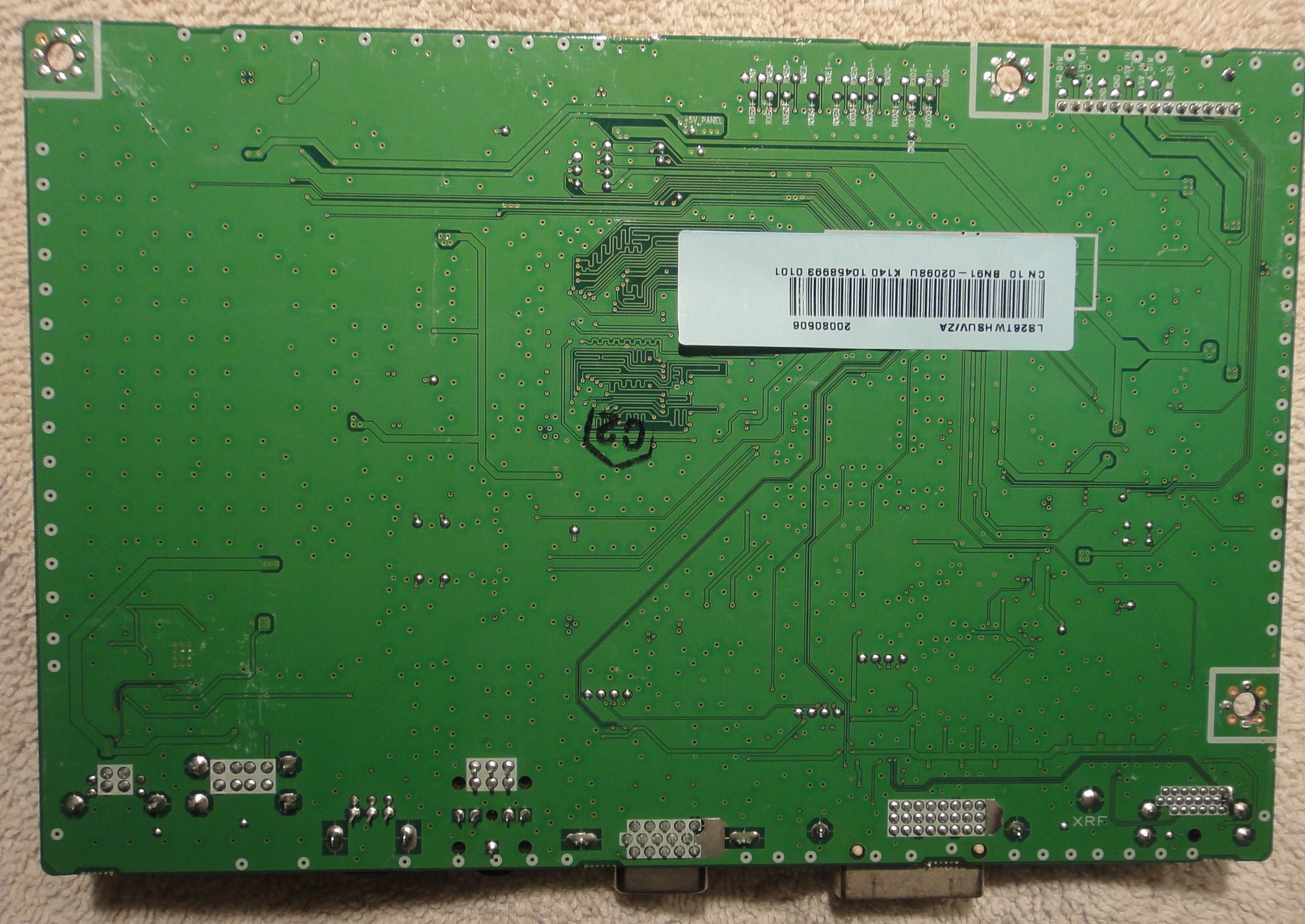

                            Sorry you didn't like the first set of pictures. To my untrained eye they looked ok. I also couldn't read the resistor bands as I looked directly at it.
                            Here are a couple of shots of the logic board. I won't be able to test the on/off bit until the morning, but I will get back to you at that time.
                                Mosfets can get hot during operation and discolor the board. I have seen it many times and there is nothing to really worry about.
                                Datasheet is here
                                I would say if the inverter transfomer tests open out of circuit, you have probably found the culprit. If that is the problem, then you got a pretty sweet deal for $25 + $8 on a 26 inch monitor.
