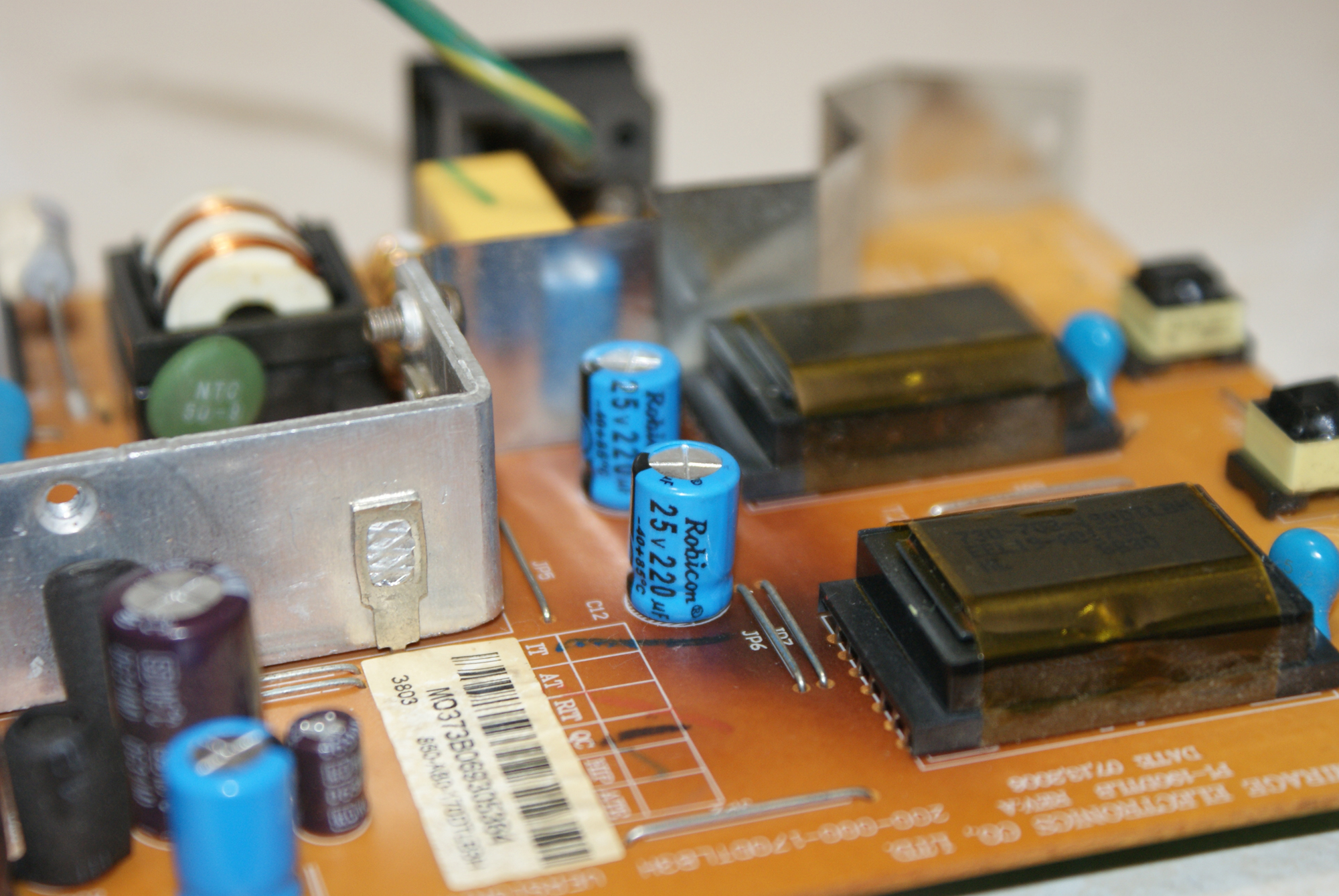

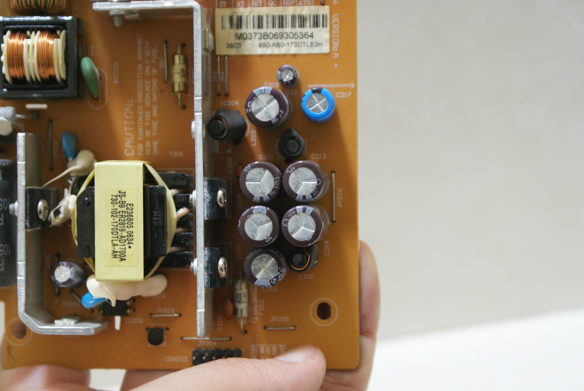

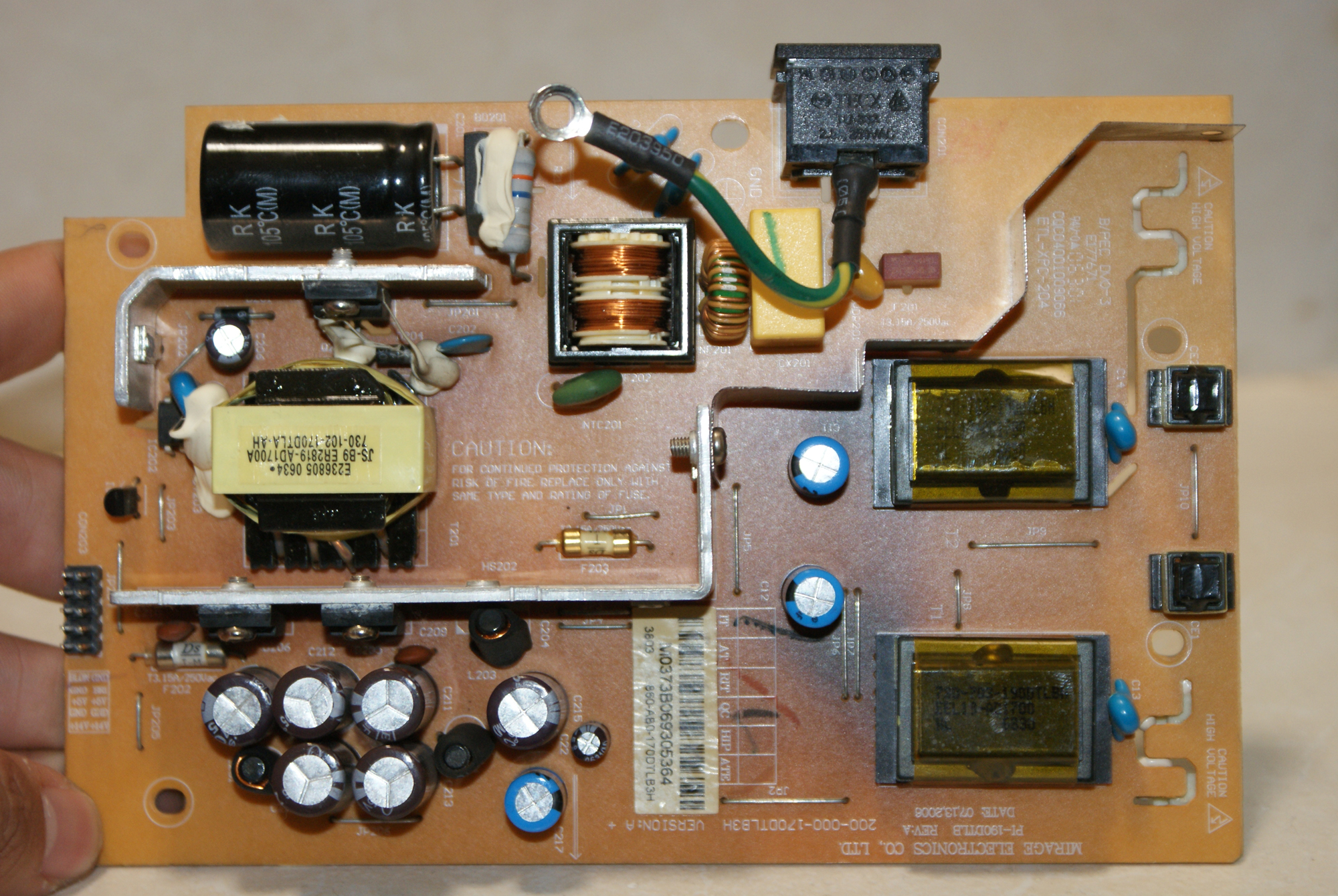

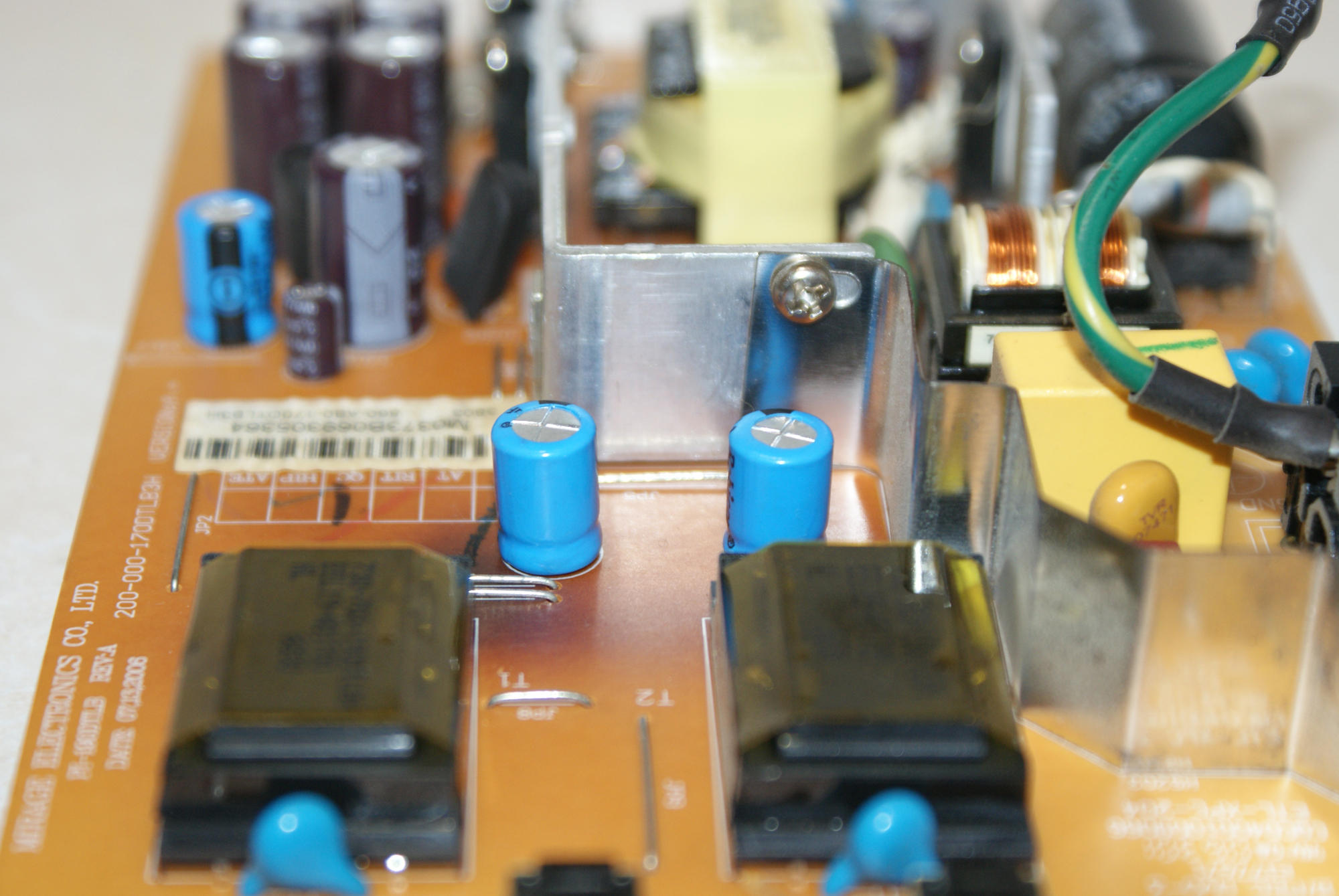

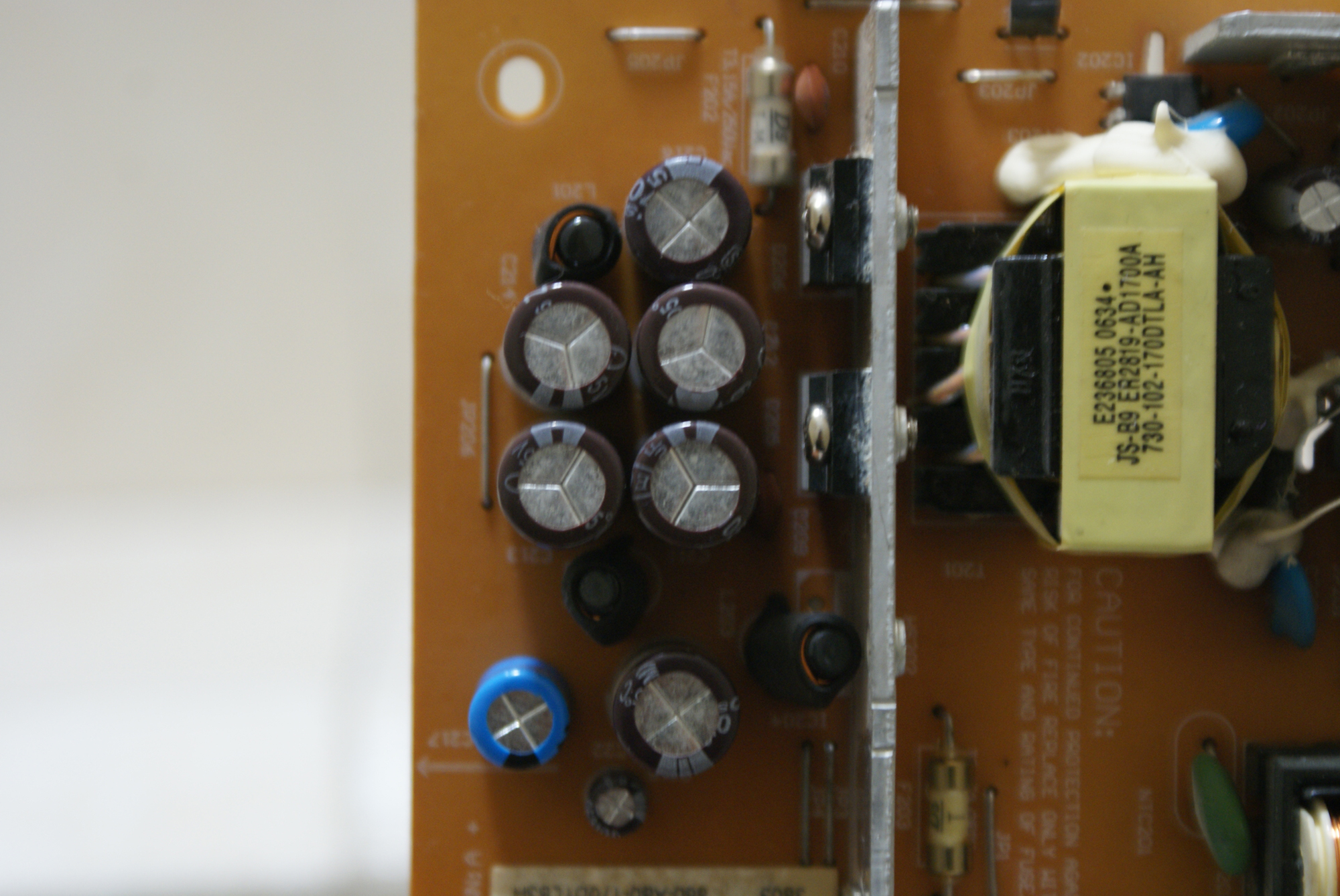

              • contenido20
                • Sep 2011
                • 9

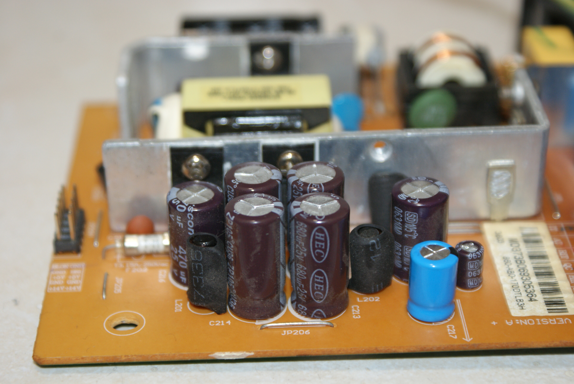

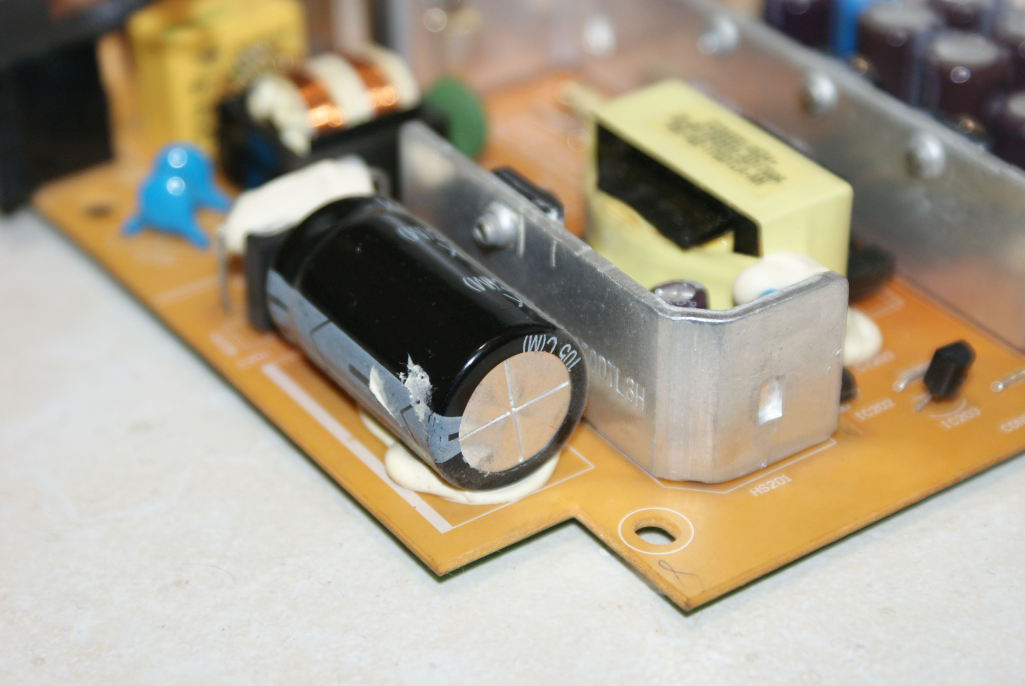

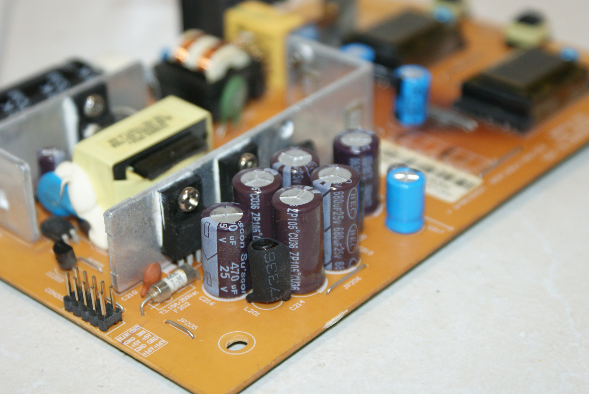

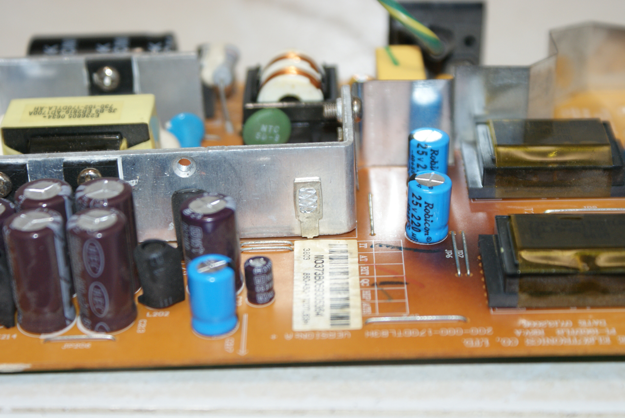

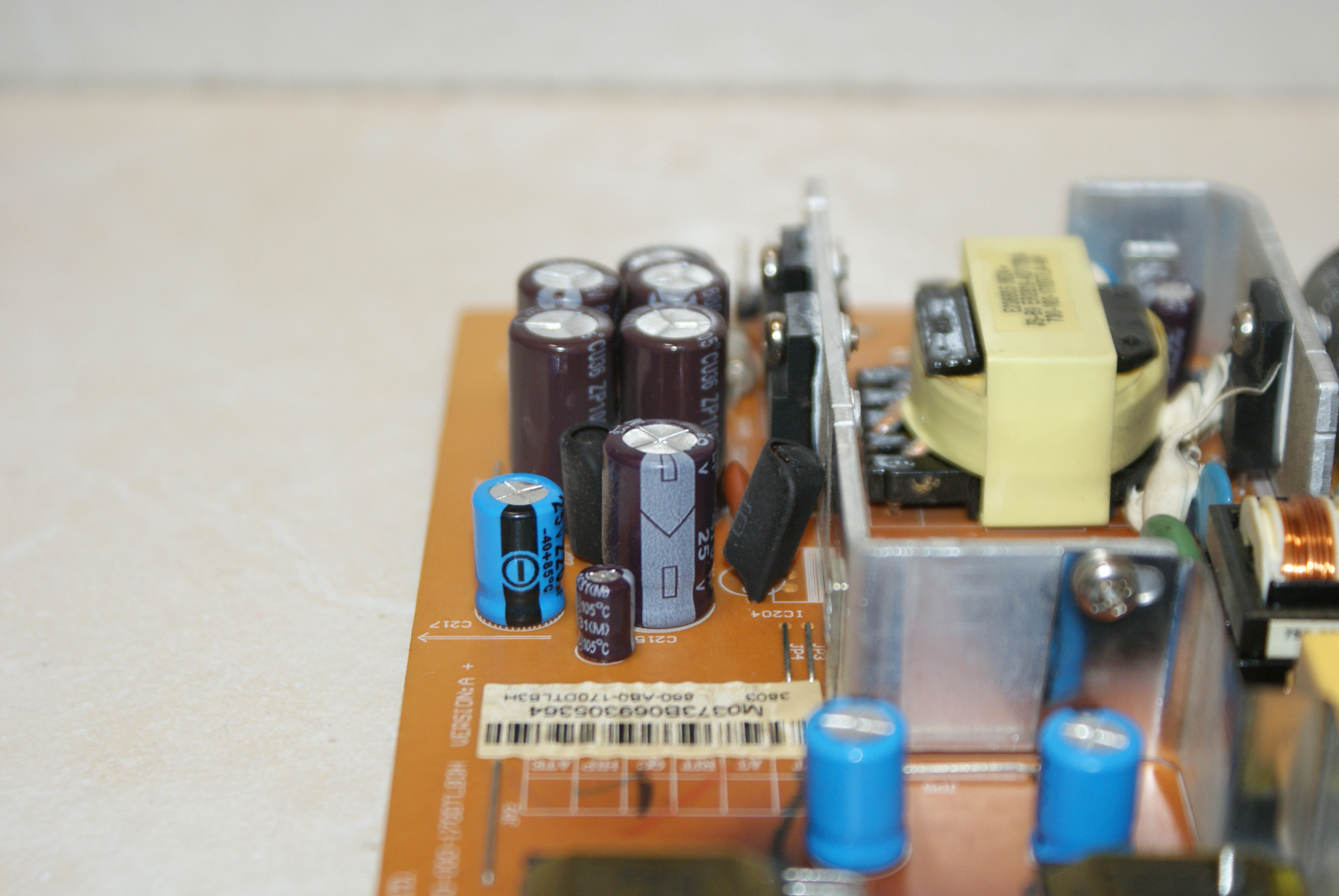

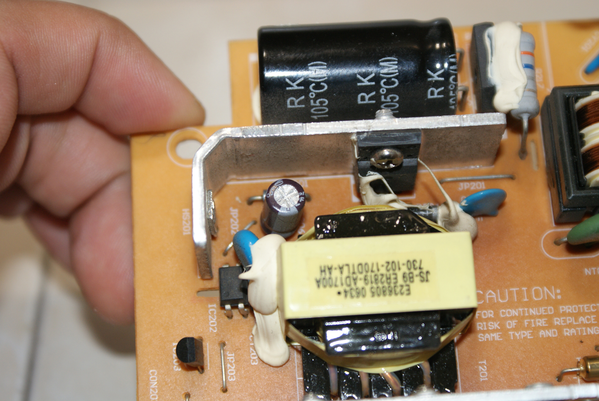

                Re: Gateway 19" FPD1975W help needed
                hi
                these are the pics from the power board.. i´ve already changed the blue capacitor that you see in the pics... you guys told me to change all the caps i´m about to do that but i wanted you to see a couple of pics before i do that...
                • retiredcaps
                  • Apr 2010
                  • 9271
                  Geez, those blue Robicon caps (obviously trying to sound like Rubycon) are terrible caps. They are rated at 85C. C11 and C12 are probably dry since you can see the PCB is hot in that area.

                    #29
                    so what should i do .... i just ask for 220 25v caps and they gave me those i didn´t know that they would that terrible...
                    i mean do i change every cap??
                    • retiredcaps
                      • Apr 2010
                      • 9271

                          #32
                          The startup cap that PlainBill is referring to is C206 on your board.
