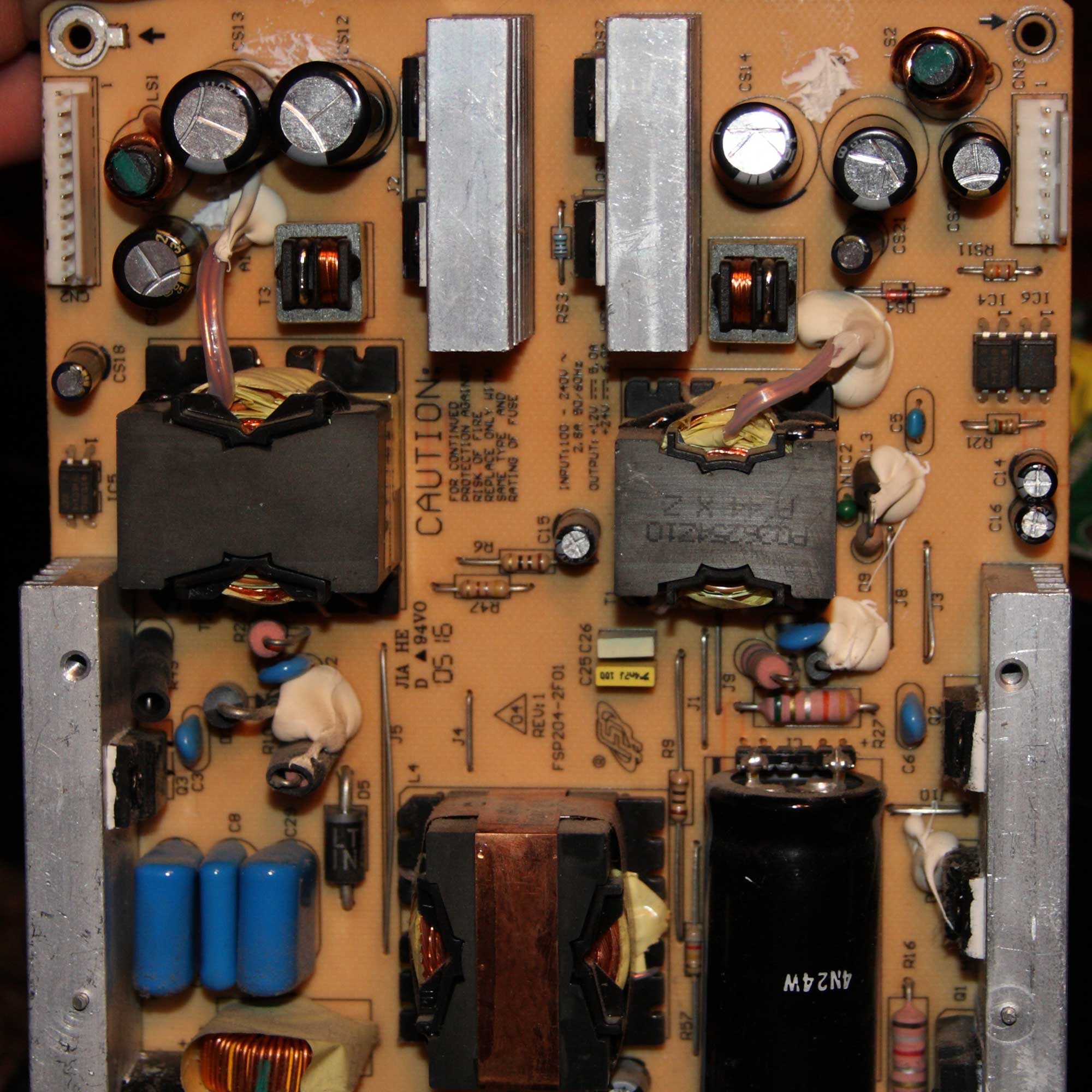

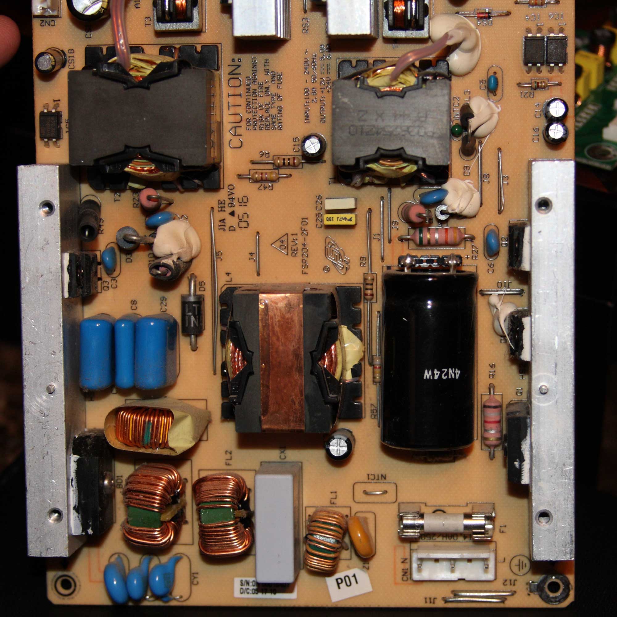

      Hi Bill, thanks for the response. I figured I'd need to upload some photos, but I wanted to make sure I uploaded the correct ones.
      Here's a couple pictures of the Power Supply Board. I think I saw online that this model also has a backlight inverter, I don't think I've uncovered that board yet, so if that's what I need it's going to have to wait until tomorrow (when I will also get my multi-meter. I have high res originals, so if there's part you want to see in detail, I can get that for you.

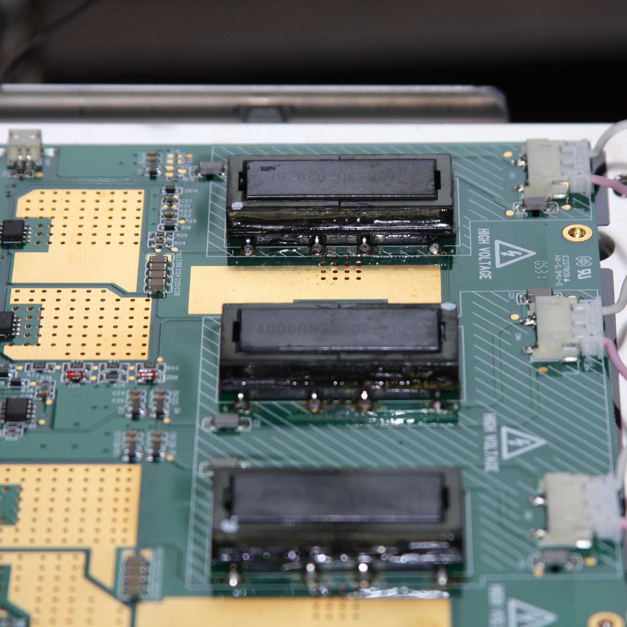

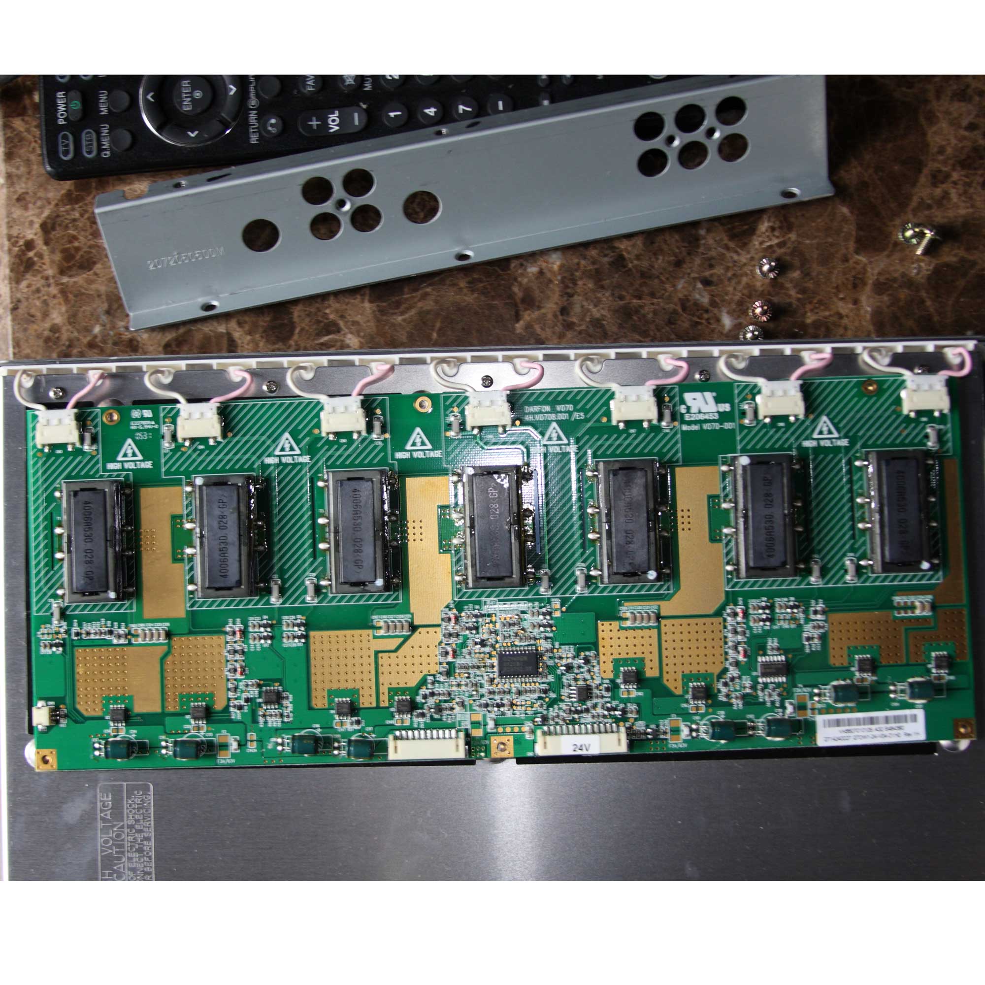

        Most of the testing will be on the inverter, so uncovering that will be useful.

          Ok, folks. These are not perfect pictures. I see nothing obviously wrong (charring or burst / bulging capacitors). Any thoughts?

            What brand/series are those 8 green caps at the bottom of the board?

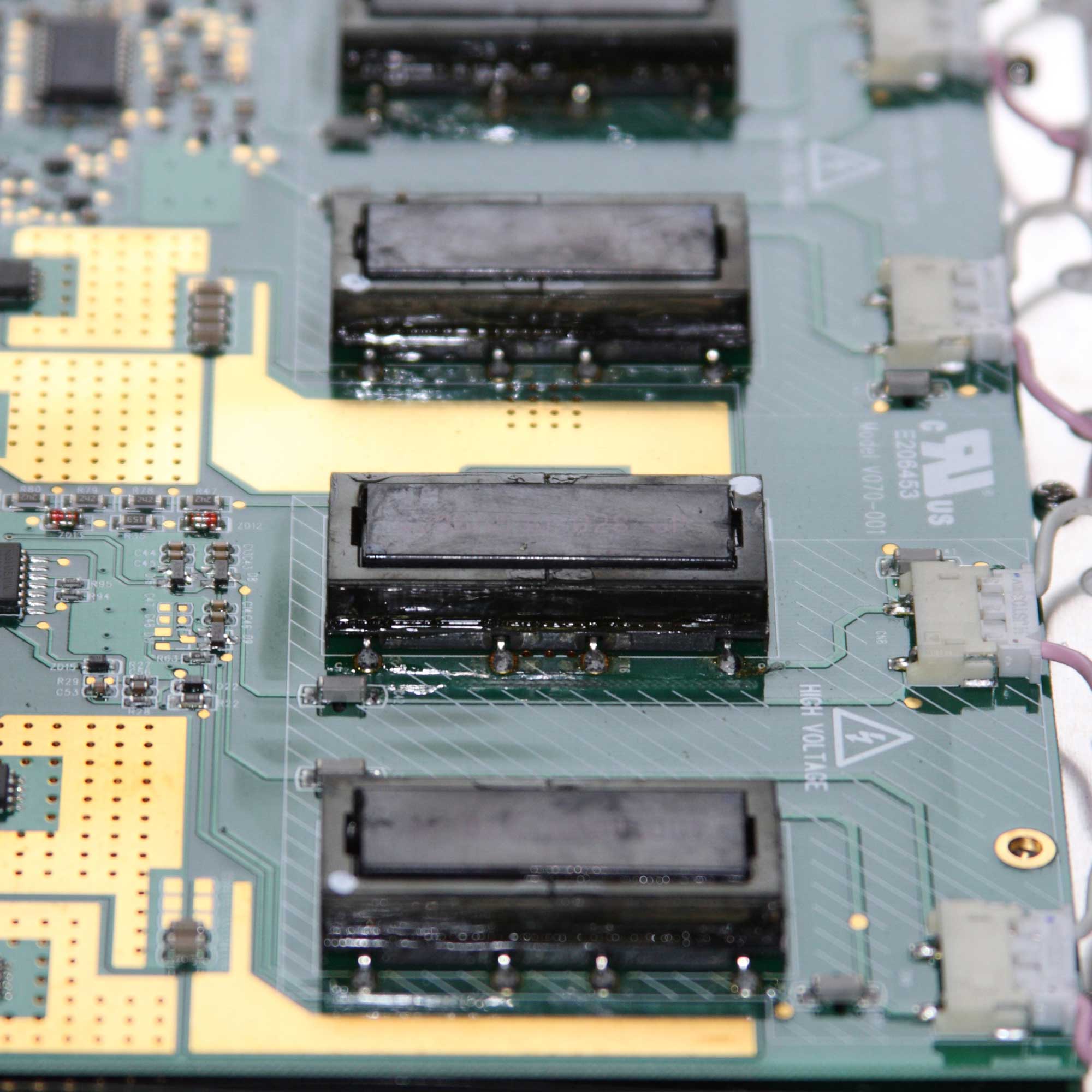

              Take a look at the first transformer. Note the white dot on the lower right corner. That is pin 1. Numbering goes counterclockwise, so the pin at the upper right corner is pin 4. Pin 5 is the top pin on the left, and pin 8 is the bottom pin on the left.
              When you get your DMM, measure the resistance between pins 1 and 8, and between 4 and 5. Write down those numbers, you are going to need them. Do the same with the remaining transformers. Each reading should be about 980 ohms.
              Now compare the readings. You are looking for an 'outlier' - a reading that is lower or higher than the rest. Report the readings.

                  Ok. I went to Radio Shack and bought a cheap DMM. I got home and realized it had a billion settings, I knew Bill was looking for resistance so I set it to "200K" under the Ohm settings and started taking measurements. Here's the readings I got:
                  1. 1-8: 102.1. 4-5: 101.9
                  2. 1-8: 101.5. 4-5: 101.7
                  3. 1-8: 101.9. 4-5: 102.1
                  4. 1-8: 102.4. 4-5: 102.4
                  5. 1-8: 102.9. 4-5: 187.8
                  6. 1-8: 103.3. 4-5: 103.4
                  7. 1-8: 103.6. 4-5: 103.7
                  Obviously the outlier is the 4-5 pin on number 5. Unless my method of measurement was faulty. I checked it like 4 times because it was so far off. So, what do you guys think now?

                    Looks like PlainBill made the right call. Transformer #5 looks way off with 188 ohms. Does the transformer have a part number stamped on it?

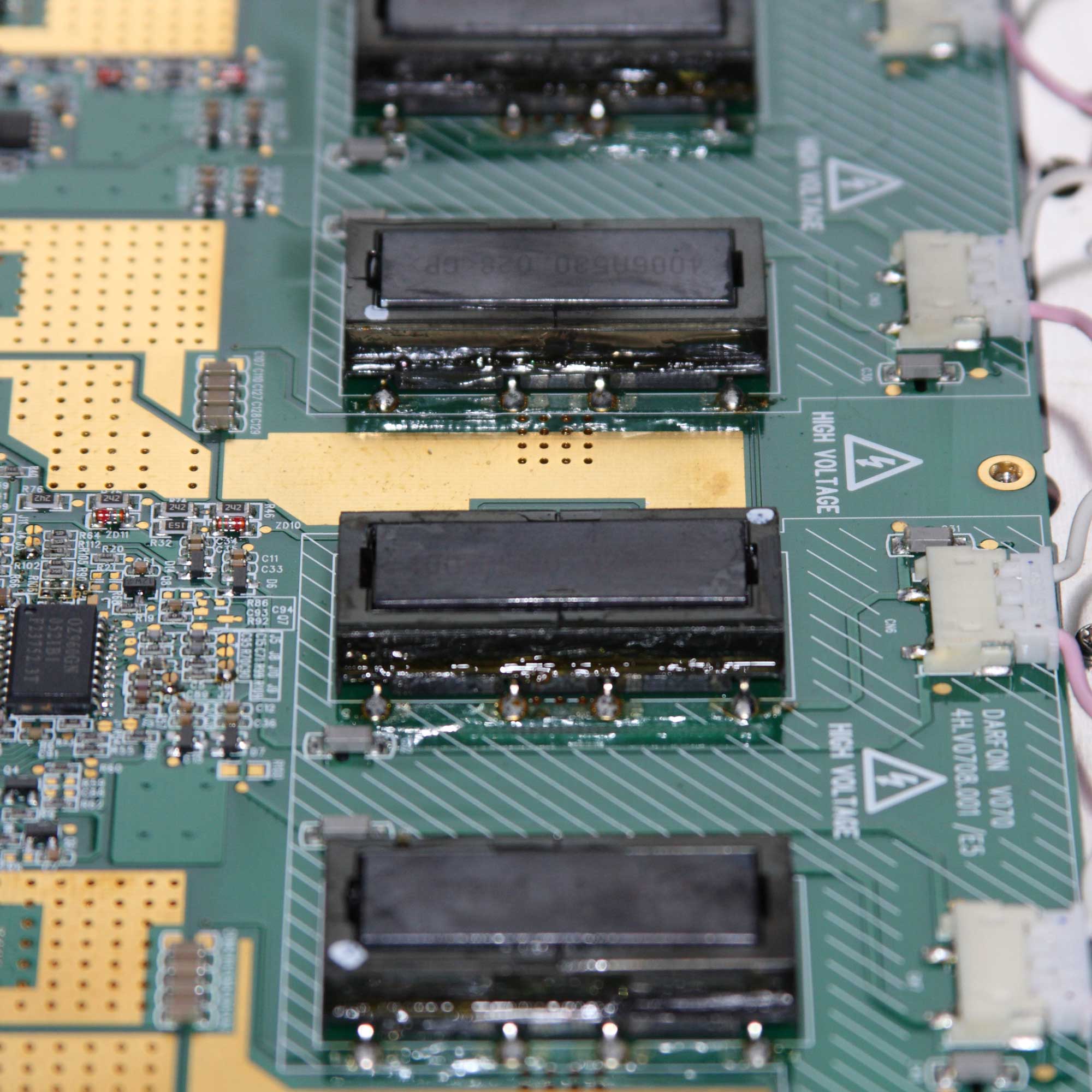

                      Yes, the part number is visible in the photos above (I think its the part number anyway):
                      4006A530 028 GP
                      Do I just need to find a replacement and solder it onto the board?
                      EDIT: Looks like any transformer labeled 4006A will work, correct?

                        The part number is visible in the first inverter picture; it is a 4006A. There are a number available on eBay; search for 4006A 070-001.

                              Wow, great find. If you look at my third picture of the inverter board you'll see it's the same as this one for sale. I'm going to get it...but let me ask a question: If this board fails for whatever reason, can I just use one of the transformers from this board and replace the faulty one on the board I have? Is that shady or "not recommended" or anything?
