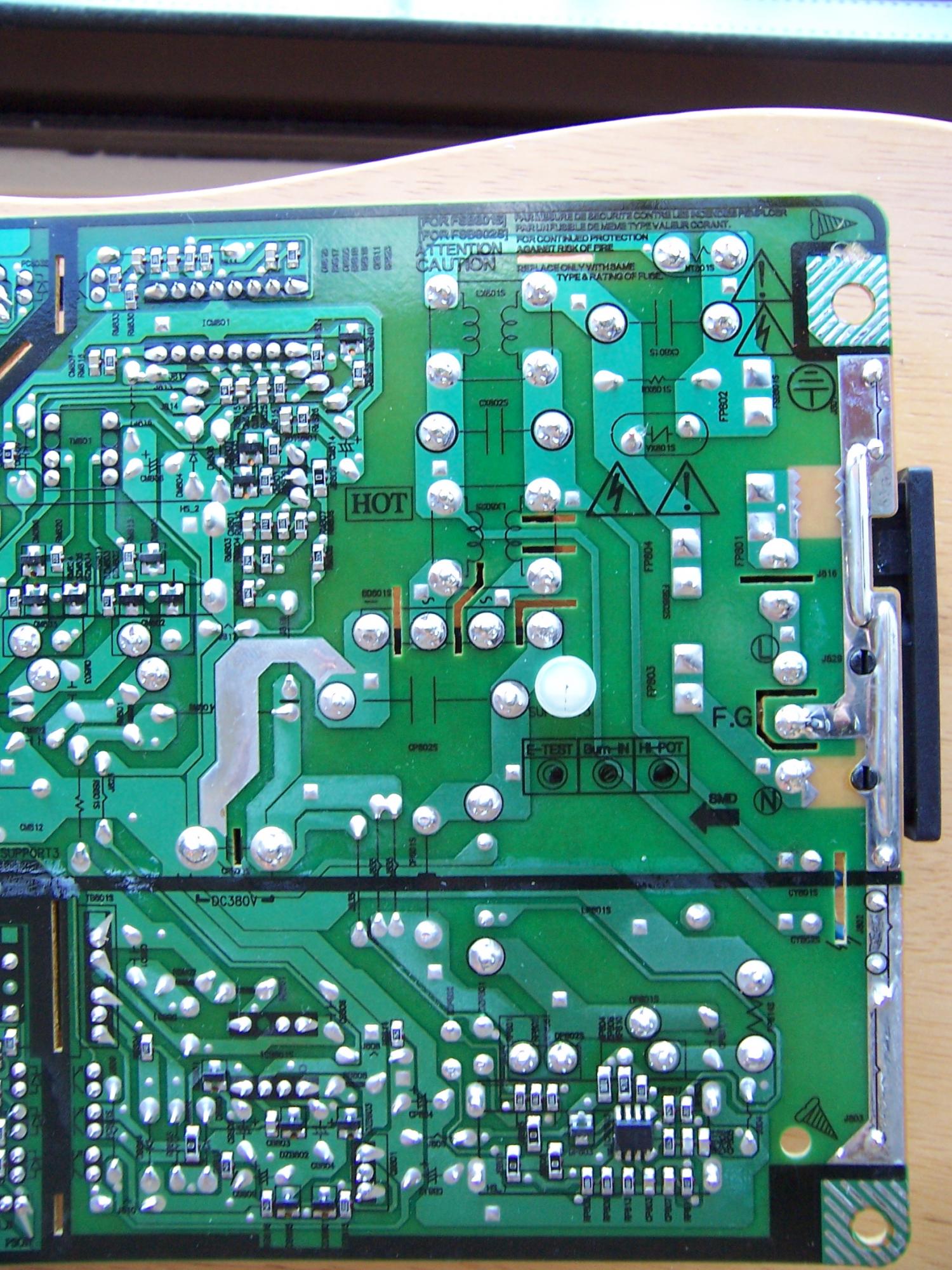

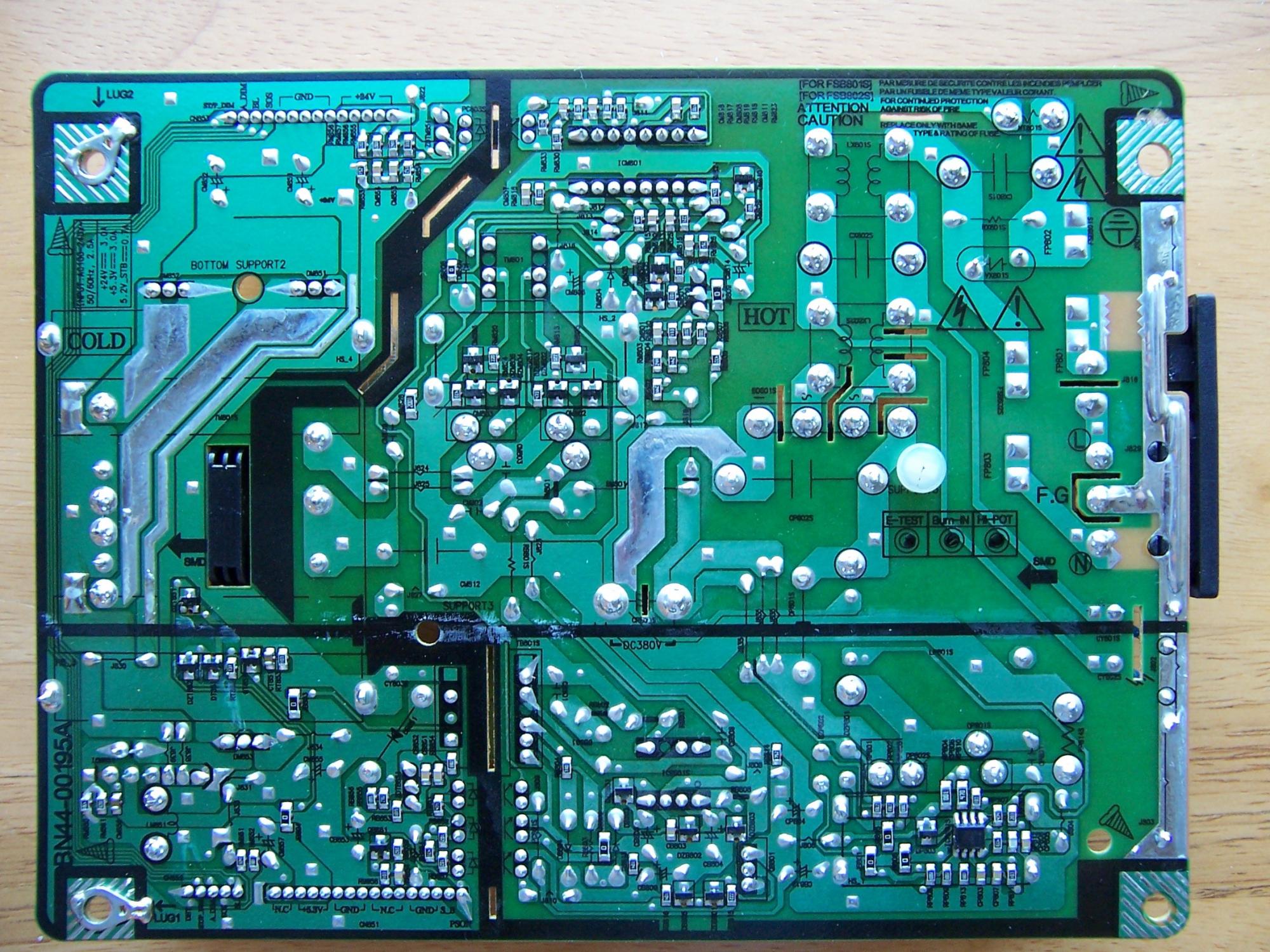

          I will need a picture of the bottom side of the power supply. the picture of the top is excellent, something equivalent of the bottom would be helpful.
          Also, ICM801? (the 16 pin IC) is the SMPS controller for the main supply. Pin 1 is in the upper left corner, and pins are numbered counterclockwise. Pin 4 is Gnd, I am interested in the voltages on pins 5, 9, and 15.

            Here are some more pictures !!

                Great picture quality, but has been a failure to communicate. I need a picture that covers the entire bottom of the power supply, just like picture 100_4219 covers the top.
                The voltages into ICM801 indicate it should be operating. The voltages you measured are on the input side of the IC, before I have you make measurements of the output side, I want to make sure there are no voltages likely to damage your DMM.

                  Oops, sorry about that !
                  This one should be better

                    #29
                    Re: Samsung 2493 HM issue
                    Yes, much better. And I've verified that the output of the chip is driving a transformer at low voltage. For the following measurement, use pin 13 as the ground point. If you would, measure the voltage on pins 12 and 14. Do this with both monitor off and monitor on, and try it with the meter on the DC Volts range, then try it with the meter on the AC Volts range.

                                  Whoops!!! I almost made a huge mistake. Or maybe not.
                                  The data sheet shows pins 12 and 14 connected directly to the driver transformer. For several reasons that is a bad idea, and it would not be possible to have 0 volts and 14 volts at the same time on the two outputs.
                                  This power supply uses a resistor and a capacitor in the drive lines. Also, there may be a problem trying to measure the drive voltage. The typical SMPS runs at 40 - 70 Khz. This is designed to run at 1 Mhz!!! Still, I'm not comfortable with the output voltages you measured earlier. They should have been at some intermediate voltage in my opinion.
                                  First, with the power LED on, measure and report the voltage on every pin of the MC33067P. Use pin 4 as the ground point. I'll examine the data sheet and make sure all of them are reasonable.
                                  Also, I've marked up one of the pictures.
                                  I've circled two components in yellow. These are the resistor and capacitor I mentioned earlier. Measure the resistor, and verify it matches the number on it. Examine the cap carefully for any signs of damage.
                                  I've circled two diodes in blue. these are actually on the top of the board. Check them for shorts. And I've circled the primary of TM801 in white. Check the resistance between those pins.
