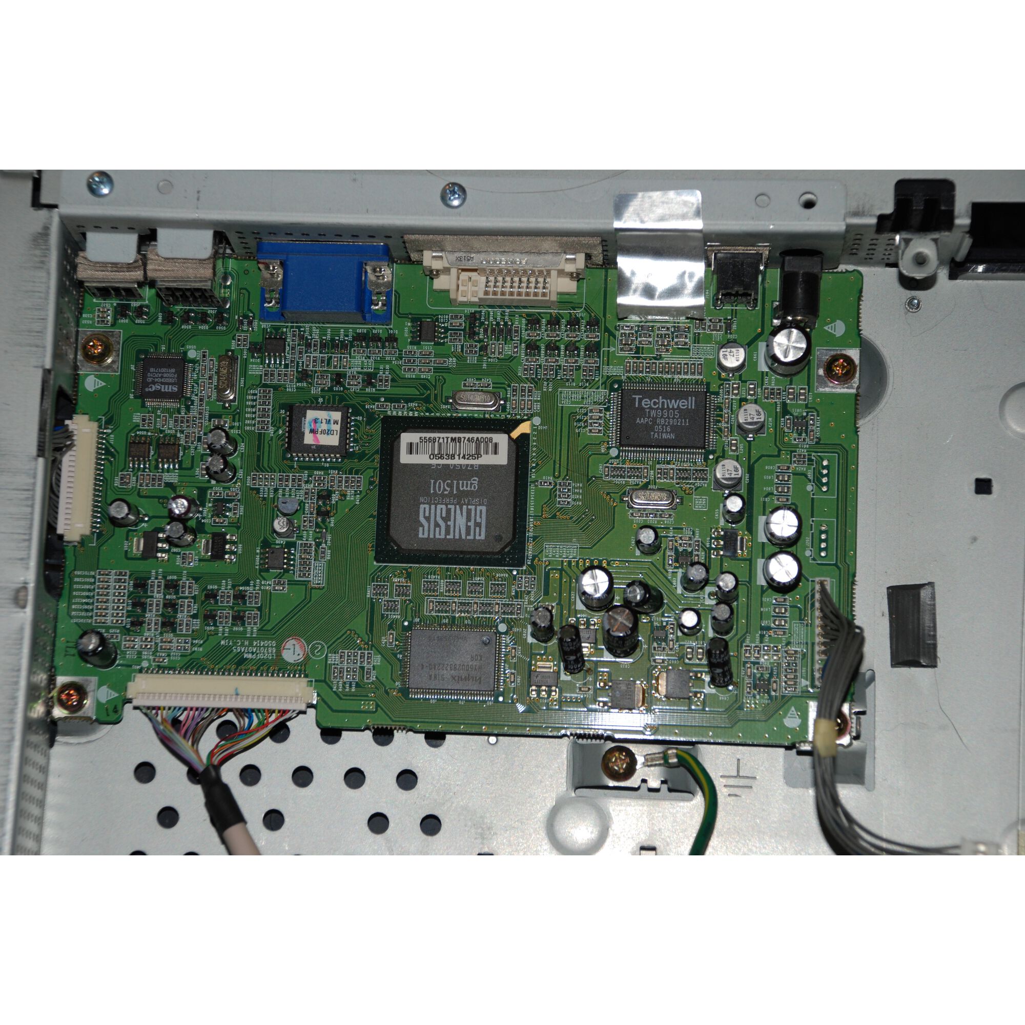

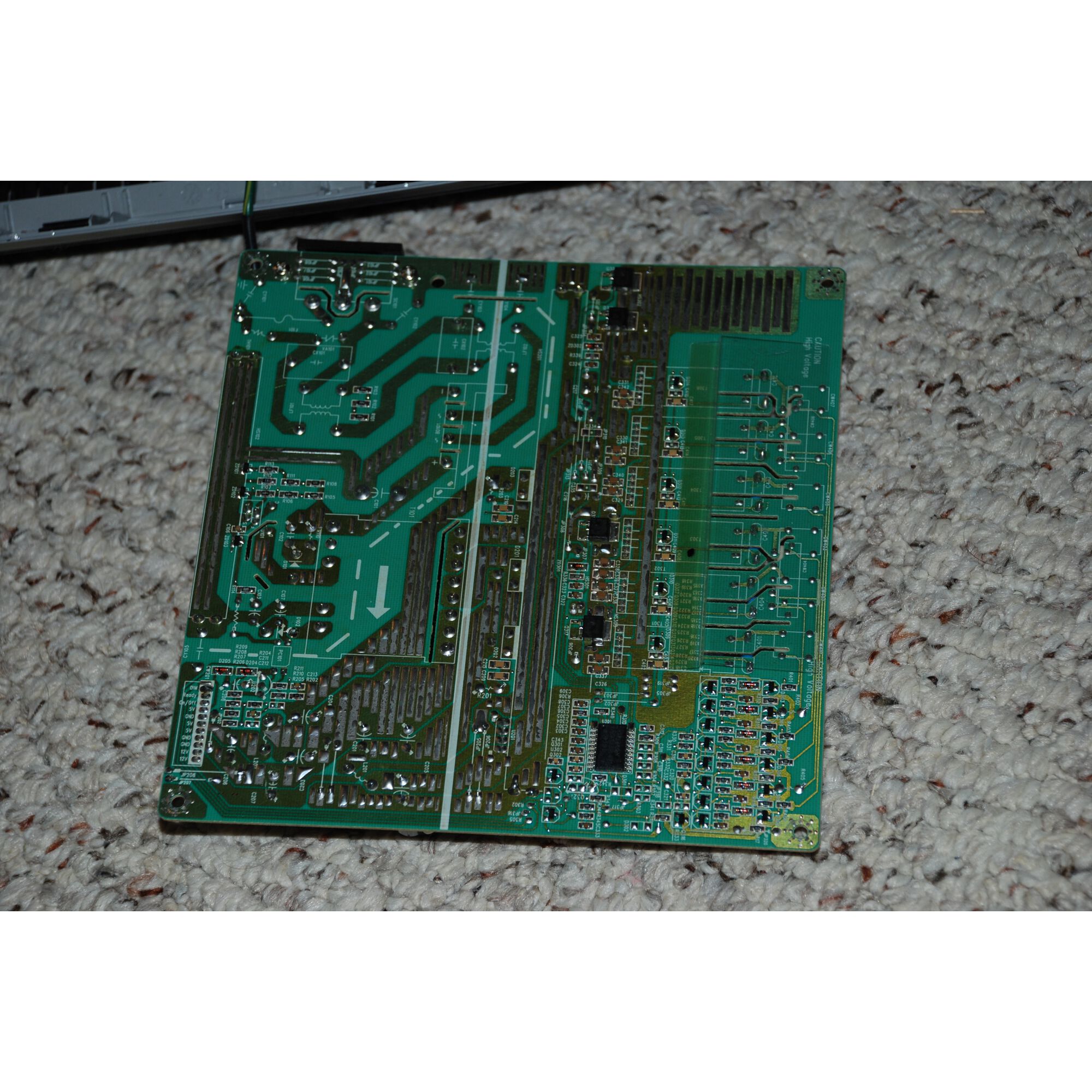

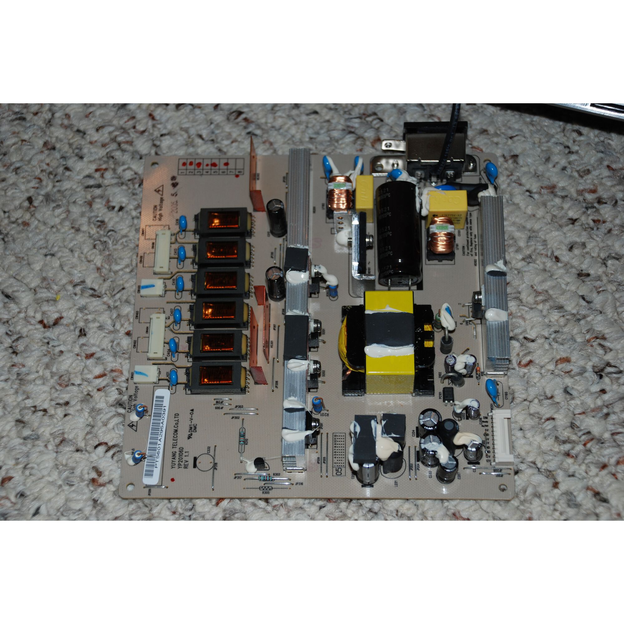

    Hi
    I've been having similar troubles with my Dell 2005FPW as many other people here seem to be having also. When I first power it up cold, usually the backlight will come on and the display will work - but the image is completely garbled because all the pixels will swipe up and down the screen randomly. I don't really know how to describe it. However, this will go away after about 30 seconds, and the display will work fine. If it is turned off and back on, however, it will come on for the standard .2 seconds and shut off, like many other people noticed. Sometimes, it will come on and emit a high pitched hum that will sometimes go away with a power off, but often will lead to a cycle of the .2 second power, then reboot, and loop forever until the power is pulled.
    I have opened the monitor up and inspected for bad capacitors - I've had that issue before in my motherboards However, none of them seem obviously bad. I can replace them, but there's tons of them on both the inverter/power board and the video board, and I don't know which to replace.
    Sorry for the long posting - it's my first post here Pictures are attached of both sides of the power board and the front of the video board. I'd be happy to read off and part numbers you need if they aren't visible in the pics.

    Re: Dell 2005FPW Issues
    Looking at the picture of the video board you posted, note the slightly darker area on the board on the lower-right corner around the linear regulators. That slightly darker are is heat discoloration and it's very possible that the capacitors in that area have gone bad or are on their way out.
    I would suggest to replace those first and see if that cures the problem.
    It seems like the power supply has Sam Young capacitors - those aren't overly horrible, but if you're buying new caps online, you might as well get replacements for those too. The only exception is the big high-voltage capacitor - this one does not need to be replaced since it rarely fails.
    If you're not sure what replacements to get, post each capacitor's brand, series (usually 2 or 3 letters), capacitance (uF), voltage (v), and size (dia. x height in mm).

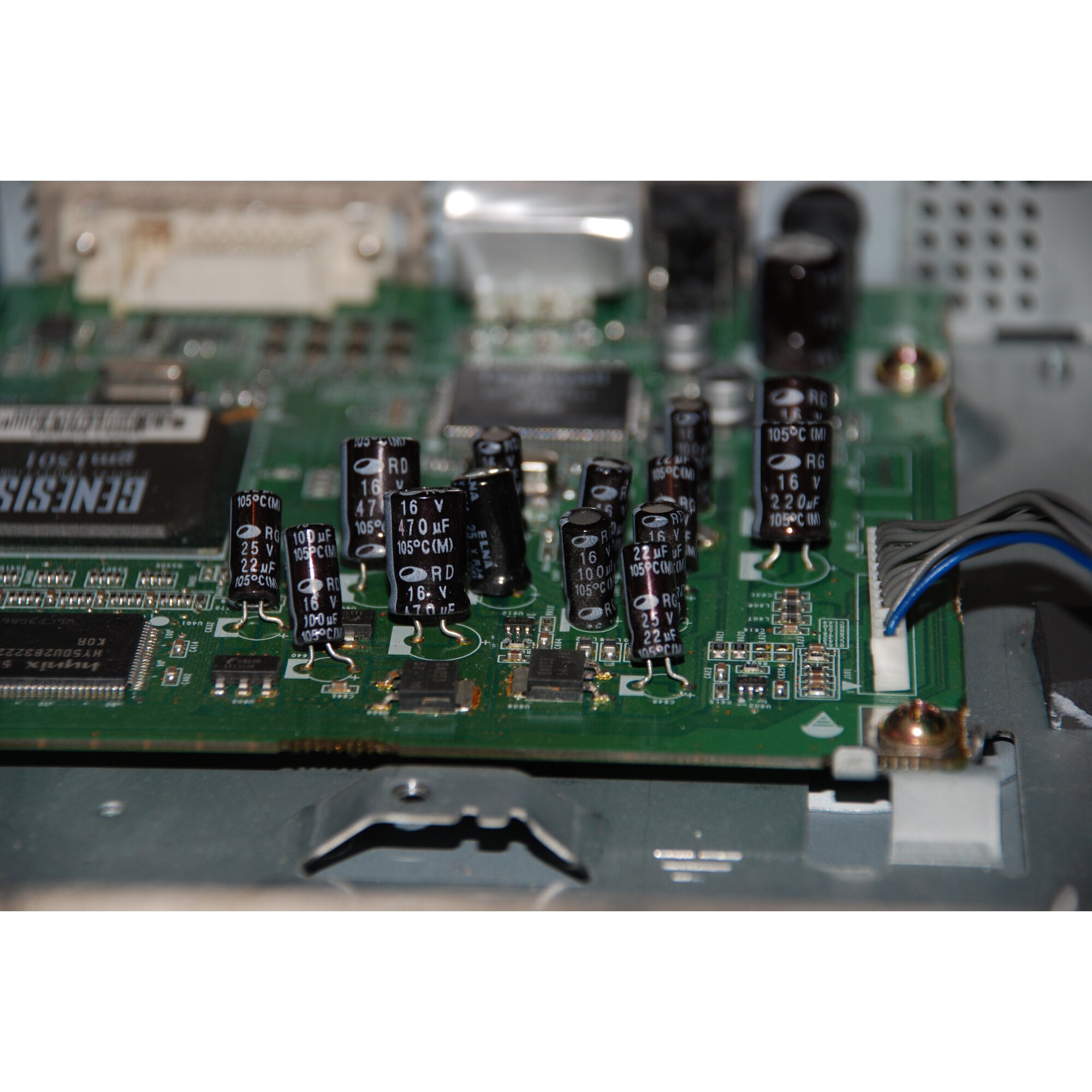

      Here's the listing for the caps in that section of the video board:
      2x 220uf, 16v, 12x7mm, T3C series
      3x 22uf, 25v, 11x5mm, T4C series
      2x 470uf, 16v, 12x8mm, T5A series
      6x 100uf, 16v, 11x5mm, T2C series
      I don't see a brand name on them, and I don't know the logos, so I attached a pic.
      I know my way around digikey a bit, but if you could tell me what to buy, that would be great.

        They look to be Sam Young caps. If you need to "try" to replace one or two caps, then I would say go ahead and try it. However, your looking at replacing over a dozen caps. I don't know what your soldering skills are like, but the logic boards tend to be smaller and the solder pads easily peel away due to excessive heat. Also, are the replacement caps you have been removed from other equiptment? If yes, you might be replacing questionable caps with questionable used caps. You probably would be better off ordering new caps. That way, you have good quality caps installed, or at least a good starting point if the new caps don't work.

          As far as the caps, I've never seen that brand before either. Only 1 Elna I recognize. Still, all of them are likely just general purpose rated for 105C. I guess the Radio Shack *might* work (or at least they won't be that much worse).

                        Oops! Looks like they're using Samwha RD series general purpose 105 deg C caps and not Sam Young as I had mentioned earlier.
