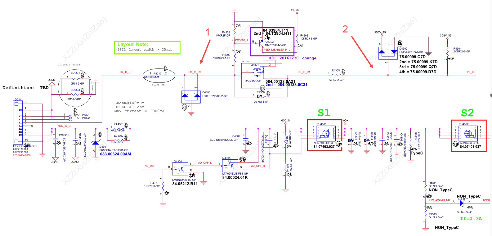

                  Post the voltage to ground measurements of the attached regions of your board.

                    1) 115k (at test point just above unpopulated/soldermasked r4317)
                    2) 2.25k (at r4305)

                      Attach the power adapter and measure the voltage at the above points (not resistance).
                      • benwaterson
                        • Aug 2008
                        • 202
                        • United Kingdom
                        1) 156mv
                        2) 158mv
                        (sorry misread the question and measured resistance to start with)

                          Also to note these 3 things:
                          1) If plugging in the AC adaptor (after boards caps have discharged) - the charging light flickers rapidly for 2 or 3 seconds and then goes solid white
                          2) There is noticeable coil hum from PL4501 (3.3v)
                          3) The 3.3v voltage here is 0.85v
                          • mon2
                            • Dec 2019
                            • 14725
                            The voltage to ground measurements for the PS_ID are not correct. This can also lead to the observed issues.
                            Remove all power. Meter now in resistance mode. Measure the resistance to ground on each side of this same PS_ID line. We are checking if the diodes @ D4303 are shorted or not.
                            The PS_ID interface and fix is well documented on this website but in short, is a single wire (Maxim / Dallas Semiconductor) communication line with the external power adapter. This single wire must operate correctly and is read by the EC (8051 microcontroller based) to gauge if the power adapter is worthy enough to power the logic board and charge the battery. Absence of this communication and the logic board will shut off.
                            Moving forward, you can remove D4303 off the board and confirm if the PS_ID line on the power adapter side returns to ~3v3. If yes, then the line should be ok to test again. If not, remove the mosfet @ Q4301. After this removal, confirm the voltage on the RIGHT side of the schematic which is the EC side. This line must offer a ~3v3 measurement in parked mode.
                            These ~3v3 values are used to power the single wire ID IC that is implanted inside of a true Dell power adapter.

                                Confirm the voltage to ground of the following (still in this area of the PS_ID circuits):
                                R4304, pin 1 = 3D3V_S5
                                R4303, pin 1 = 5V_S5 (used by mosfet Q4301)​

                                      3D3V_S5 = 0.845v
                                      5V_S5 = 4.95v
                                      So does seem to be a partial short on 3.3v?
                                      • mon2
                                        • Dec 2019
                                        • 14725
                                        Remove all power. Meter in resistance mode. Measure the resistance (not diode mode) to ground of 3D3V_S5.
