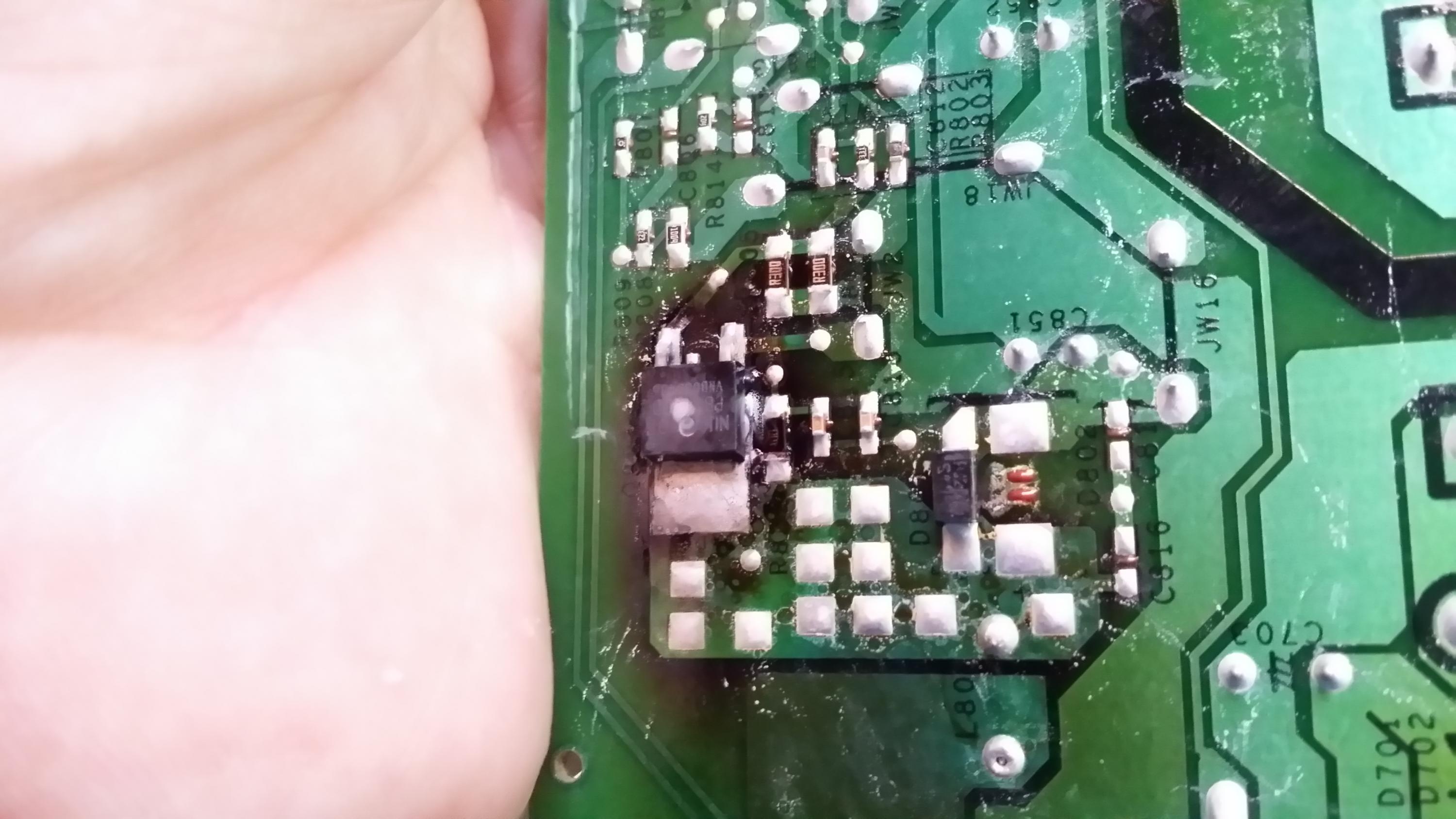

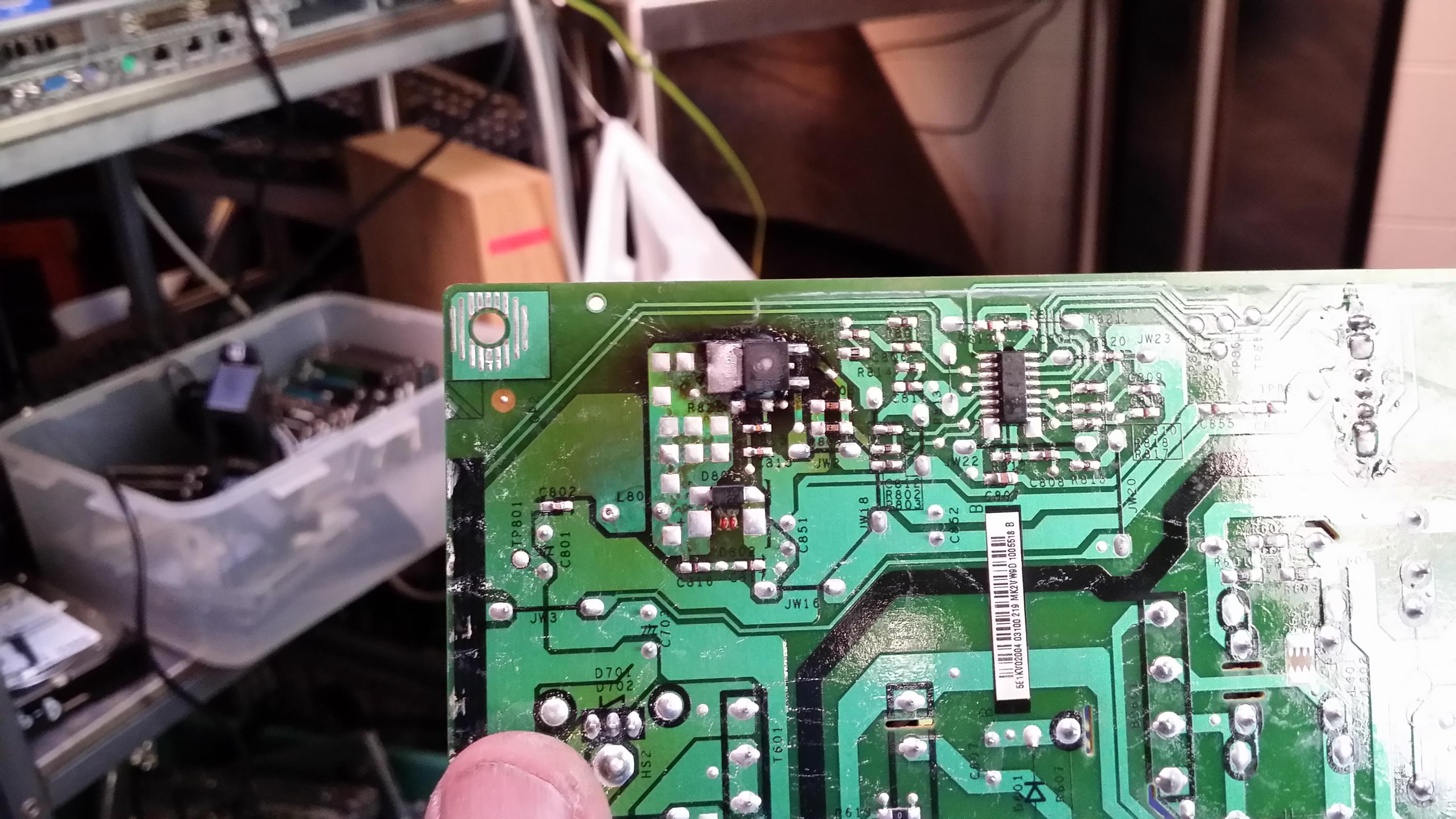

      Re: ACER P241w 24inch Monitor
      I have an ACER 2450 B and there is nobody home.
      On examination of one of the PCB's I see that a component has burnt out.(Power reg?)
      Typically not enough of the chip is legible. Except for NIK???OS on one line. Then PB or P8... and on bottom line VNB000436.
      Would anybody be able to suggest what I could replace it with?
      HOPE SPRINGS...
        • 30963
        nice.
        that nikos part is a fet.
        and obviously the coil is toast that it was driving.
        post a foto of the complete board,
        and what's the real part number? because 2450b is a laptop!
