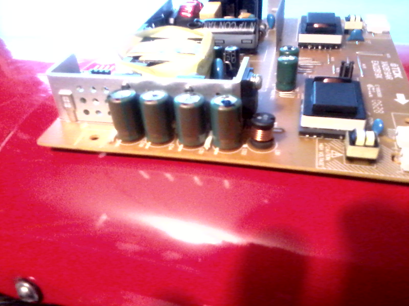

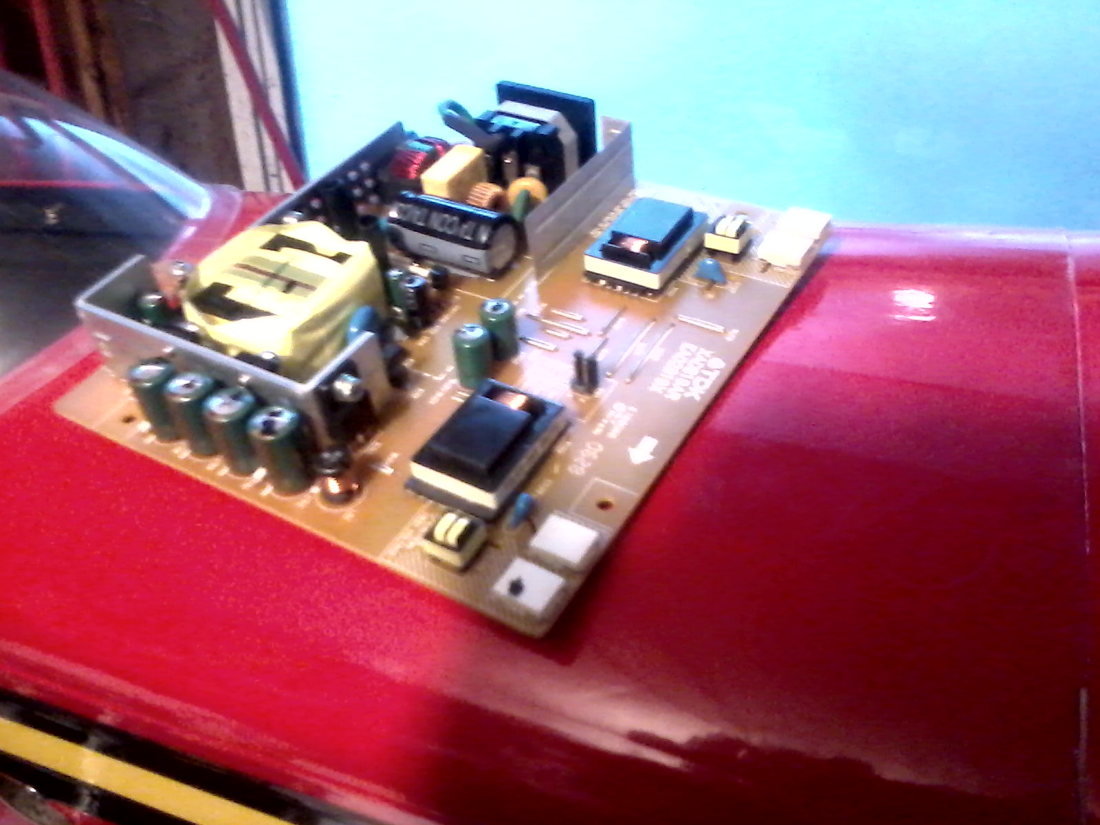

      Here is a picture of mine , I see "6" swollen caps. Figured for ~ $10.00 it's worth a shot.
      Sorry for the poor quality pictures .
      God Speed, Fred
      God Speed , Fred

        Re: Acer 1716 problems
        @fc227a
        Bearing in mind that you dont tell us what the problem/s is/are. You dont tell us what tests you have done and as you say the pictures are poor and reveal nothing we dont know if it is worth a shot.
        Use good quality caps panasonic FR, FM and FC or other good quality caps from
        digikey/mouser or a known good dealer. Caps from radioshack will not do.
        Care with ebay - many fake caps about.

              • fc227a
                • Jan 2015
                • 12
                Well the caps are bad , I pulled @ break tine @ Work , Put the LCR across them the 1000ufd where measure 8 ufd and the 470 & 220 where measuring 1 ufd @ 1khz. Also found a few bad solder connections around to power and inverter transformers.
                I think the new caps in are in place it will work again. Maybe
                God Speed , Fred

                  • fc227a
                    • Jan 2015
                    • 12
                    #29
                    It work's, Thank you Jesus !
                    God Speed , Fred
