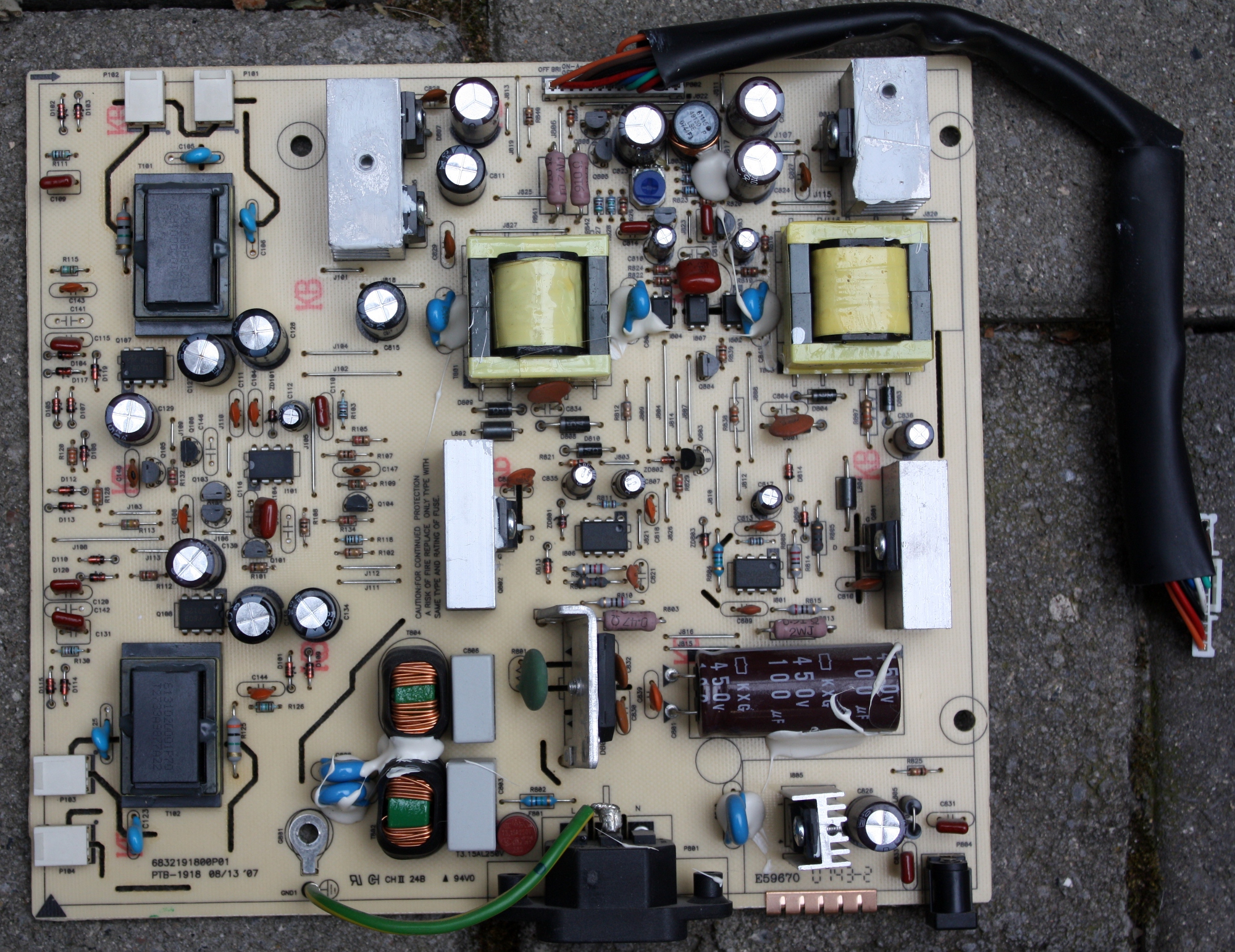

    My latest project is a Dell 2208WFPt, a 22" widescreen computer monitor with LCD backlighting. The problem is it doesn't always display the image on screen. Sometimes you turn it on and you can see the image, but most of the time with you turn it on there is no image on screen. The flashlight test confirms the problem is the backlights aren't always coming on. Before I even open up the monitor I suspect bad capacitors.

    Finally you can remove the circuit boards. You need to remove both the video and power boards as the connecting cable makes removing just one difficult (if not impossible). There are 3 screws in the video board plus the 4 hex screws by the VGA and DVI connectors. The power board has 4 screws plus 2 black screws by the AC input plug, AND there are two silver screws on the backside which hold two heat sinks in contact with the metal cage. Finally, the video and power boards are free.

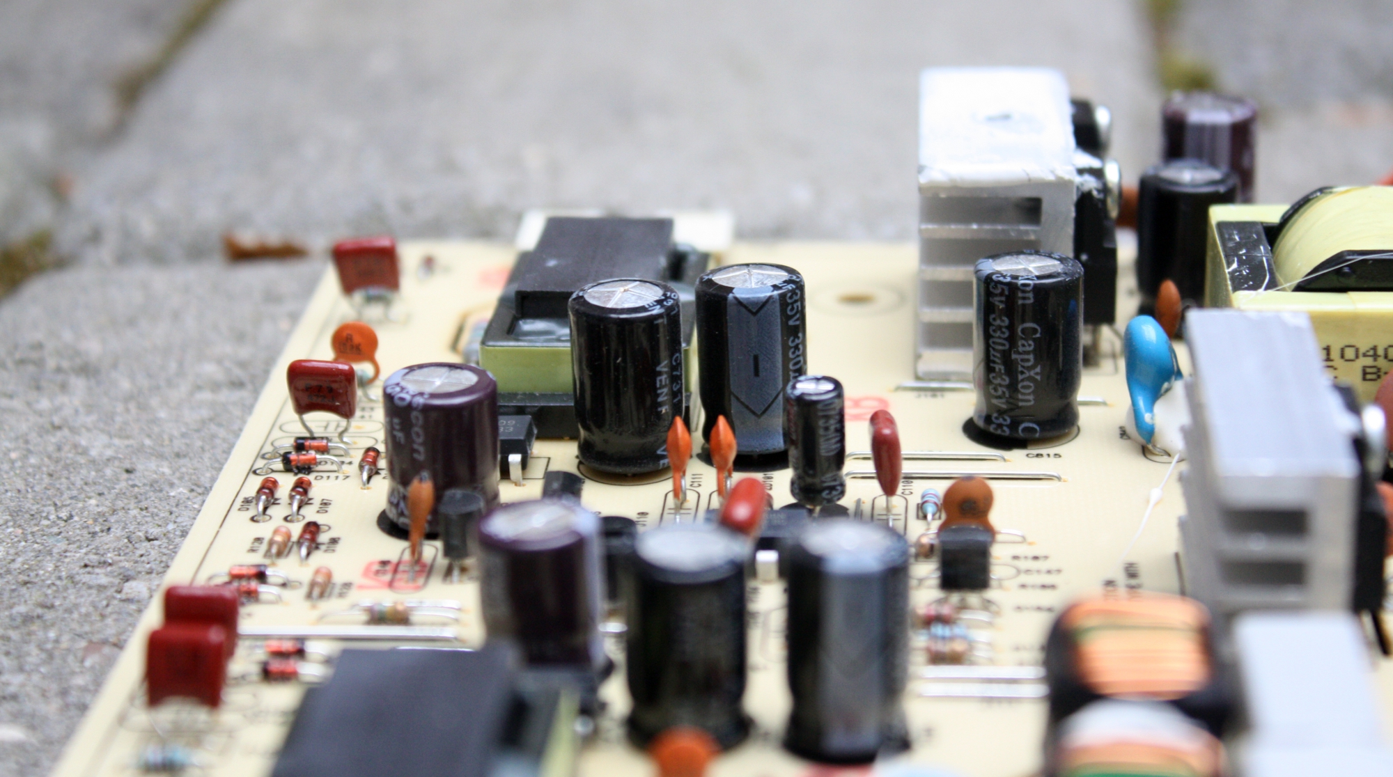

    Immediately I noticed 2 bulging caps on mine, located at C127 and C128. I also noticed this monitor has a lot of capacitors in it. Typically a monitor power board has 5 or 6 electrolytic capacitors in it, but this monitor's power board has 20 (not counting the big reservoir capacitor). This monitor has a mixture of CapXon and Su'scon caps. I used my ESR meter to test all the caps and only those two were bad (ESR of about 89 ohms). But given those caps failed in less than 3 years time, I decided to replace every caps on the power board (again, excluding the big one). I used all Panasonic EB series (or FM series where EB series were not available). This ended up being a more expensive repair at $13 including shipping.
    After replacing all the caps and reassembling the monitor, it powers up first time every time.
    Hopefully this review of my repair helps someone else.

    Interesting board. It's stamped 2007, yet it looks like an earlier board because of all the discrete components used . Did they use any surface mount (smd) components on the bottom of the board? Also, it would have been better if you used all Panasonic FM for replacements, since the EB series is not really a low-esr cap.

      No, the bottom of the board had no surface mount components.
      Good to know about the FM versus EB, in the future I'll use only FM components. I was using EB because of the long life.

            I just wanted to thank you for your post, Freezer. Using it as a guide, I was able to refurb a 2208WFPt that a customer had dropped off for us to take to recycling. In my case, all five of the CapXon 330μF 35v caps were bad, bulging and leaking electrolyte. I replaced them with Panasonic FM caps, which only cost me $7 incl. shipping for a pack of 20 on eBay, and it now works perfectly. Now we have a much nicer monitor at our main diagnostic workstation.
