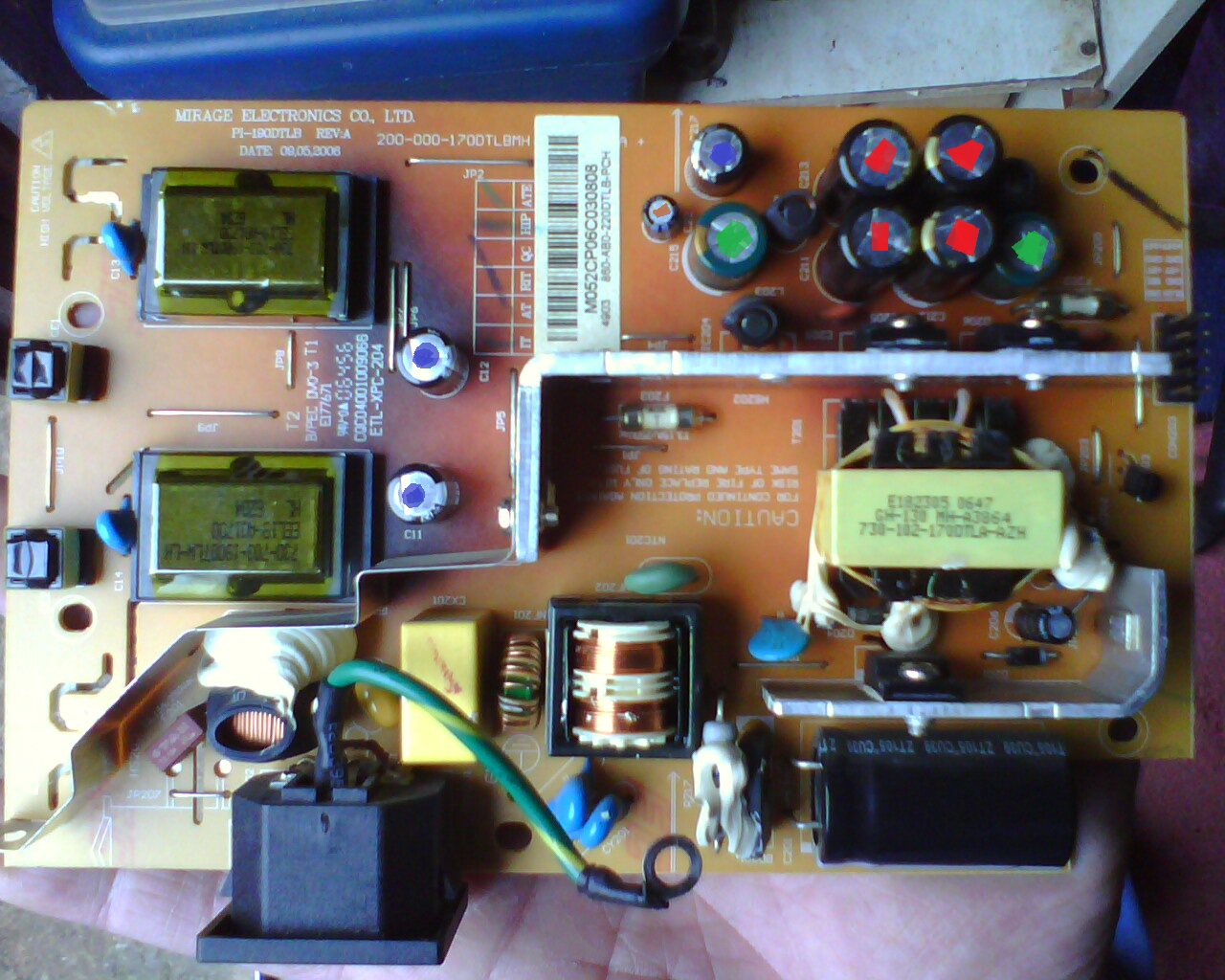

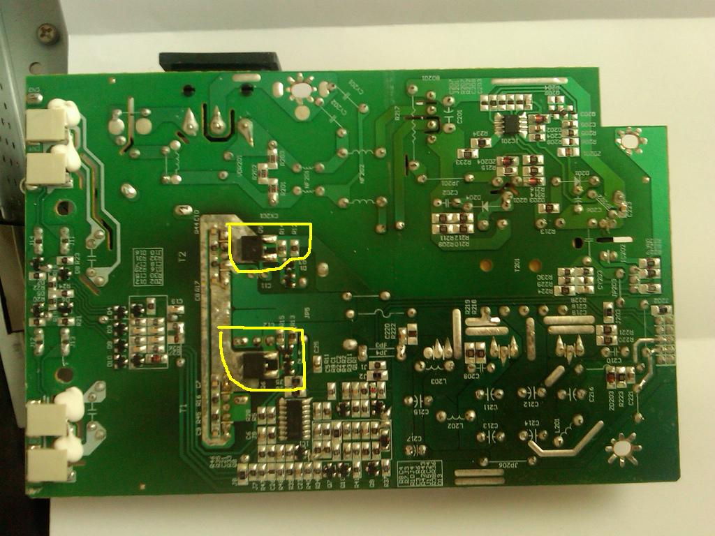

Re: zerox 22" lcd psu help
The tick, tick, tick sound is typical of either a bad start up cap or excessive load. The fluctuating output would point to the startup cap.
PlainBill
zerox 22" lcd psu help
Re: zerox 22" lcd psu help
I have'nt changed the start up cap yet but i set it up on my desk and plug'd it into the mains and you can here a tick,tick,tick sound coming from the board.
Also when i checked the dv voltage from the pins on the connector on the right hand side of the power board the voltage fluctuated.Leave a comment:
Re: zerox 22" lcd psu help
Did you check the main fuse, F201? Also, check fuse F202, as that is for the 5V output.
If F201 checks good, try measuring the voltage across the main cap, C201. If you're in the USA, it should read 165VDC.
You should have also changed cap C206, since that is a startup cap.Leave a comment:
Re: zerox 22" lcd psu help
cheers for that i'll get a clearer picture uploaded tomorrow.Leave a comment:
Re: zerox 22" lcd psu help
If you have a multimeter, then check the DC voltages of each of the pins on the connector on the left hand side of the power board. Your photo is too blurry, but there is a legend just above the pins. List the legend and each DC voltage.Leave a comment:
zerox 22" lcd psu help
Hi there everyone im new to the forum and could really do with some advise.
Im not getting any power what so ever to the monitor,
So far ive changed these caps :
Green - 470uf 25v
Red - 680uf 25v
purple - 220uf 25v
brown - 10uf 50v
and still nothing im wondering if the 100uf 400v cap might need changing.
Heres a pic of the unit.
Cheers swampyTags: None
by RassHello, could you help me with the boardview of an ASrock X670E Steel Legend? I have a project to assemble a PC from scrap parts. My last purchase was this motherboard and I want to try to repair it as much as possible. Any help is acceptable and welcome. Always grateful for the help Greetings
Channel: BIOS & Schematic Requests!
by MiguelitowsHi Guys,
I am new in electronics repairing. Do anyone have Asrock b550m steel legend schematic and boardview if can with front and back layer file?. Thank you in advance guys!...-
Channel: BIOS & Schematic Requests!
03-21-2025, 05:44 PM -
by karlp028I've got an ASRock B450 Steel Legend that I'm trying to diagnose for no reaction to the power button.
The SIO receives the PWRBTN# signal and sends PSOUT#, but the CPU doesn't return SLP_S3# so nothing further happens. I have been looking around the board trying to figure out why and I happened to touch the STEP-DOWN CONVERTER NB685GQ-Z (UP10 in photo) which was VERY hot (like burn your finger). This seems to provide VDDP_S5, and indirectly, VDDCR_SOC_S5, which the CPU needs in order to handle the startup signals.
The VCC voltage powering the converter does not look right....1 Photo -
by Gamer128Kindly share boardview of ASRock X570 Steel Legend!!
Channel: BIOS & Schematic Requests!
12-30-2024, 10:16 AM -
by sunofra78Would anyone know what this component may be? It's on an ASROCK B460 Steel Legend Gaming PC Motherboard. The writing on it is 29 7B / 43N.
Thanks....1 Photo - Loading...
- No more items.
Leave a comment:
