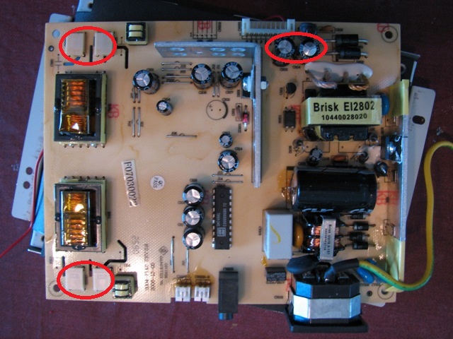

For several weeks I had a hard time turning on my monitor, if I would push the power button several times it would eventually power on and work fine. But a couple of days ago it would not power up after multiple attempts. The blue light would only blink like every 5 sec. So I used an old crt monitor and googled the problem. I found on other sites that the blinking light was a fault indicator most likely caused by bad capacitors. It also said to replace them in sets. When I took it apart all of the caps looked good except for a pair (circled in red on the photo) which are 1000uf 16v. I found this forum later on so I thought the "set" would be the 2 that are side by side. I was able to find them locally and replaced them. But now when I turn it on it does seem to want to power up better because the blue light will come on for several seconds but then the screen will show "No Signal Detected" and the blue LED turns red. I saw on another site that this may be caused by a timing problem but the monitor had worked on the same computer before and no settings were changed. I don't think that just hooking the computer up to a crt will change those settings. I did check though and the refresh rate is 60, which I think is supported by this monitor. I gained a lot of info from this post in this forum,https://www.badcaps.net/forum/showthread.php?t=8571 and my attached picture is taken from that thread even though my set of caps seem to match the second listing rather than the one from original poster and picture. I am quite sure I put everything back together right so can not understand why it is not getting the VGA signal. One problem may be with the 2 pairs of plastic plugs I have also circled in red in the picture. They both have bluish and pink wires that plug into them. Can someone tell me what they are for because I may have pushed the wires in with too much force because they did not seem to go in all the way. Sorry for this lengthy post but I wanted to try and be as descriptive as possible. But if any other info is needed let me know what to add. Thanks for your help.

Did you trying hooking up a working computer to the lcd? Most monitors will say "no signal" and then go into sleep mode if there is no working computer hooked up.--- begin sig file ---

The blue/pink wires are for the inverter board to the ccfls or backlights connection.--- begin sig file ---

Thanks for the prompt reply, yes, I did power up several times after I turned on the computer, all with no signal detected. I even hot swapped between the crt and lcd and back to the crt--crt worked both before and after but the lcd still had no signal detected. The only change I may have done is to put too much force on those plastic plugs which you say are related to the backlights connection. I was able to push them back into place though and it seems if they were messed up the screen would not show the "no signal detected" message, so I am baffled what the cause may be.Comment
Re: Sceptre X20WG-1080P monitor would not power up
You got blown caps, if they are all matching your best bet is to replace them all.
The monitor is working better because you have it open to air movement which allows the components to cool better and work longer before failure.
Can you tell us what brand, series, capacitance and volts they are in a list?

Never use force unless you absolutely need to. You probably damaged the solder joint there so when you recap you may want to apply some solder to fix it.The only change I may have done is to put too much force on those plastic plugs which you say are related to the backlights connection. I was able to push them back into place though and it seems if they were messed up the screen would not show the "no signal detected" message, so I am baffled what the cause may be.
What's happening is you are damaging the connector and the ccfl is not drawing power from the PSU which allow more stable voltages to other parts of the LCD to work correctly, all caused by bad caps. You need to chill and learn a bit, before you really break something.Last edited by Mad_Professor; 05-08-2011, 02:25 PM.Comment
Thanks to both RetiredCaps and Mad Professor. I almost hate to admit what the problem was because I feel like a total fool. But to make this be more helpful to others who may have the same problem I will explain. Because I only dealt with the power supply on the left side of the back of the monitor I did not pay any attention to the right side when I plugged everything back into the power supply. So I am sure your learned minds can predict what I am about to admit. As soon as I took it apart to get the specs for all of the caps, it was very easy to see that the DVI/VGA plug had been inadvertently unplugged. So I plugged it in and put it back together and it now works fine. But I now know that if it goes bad again I will replace all of the caps rather than just the pair that appeared to be bad. So this thread can be closed. Thanks again and God Bless.Comment

Like OPT said, as shown (bubbled up red) in picture of PSU circuit board, & exactly same as in my situation:
Problem: Capacitor (only 1 of the 2) top is bloated (meaning bad); C204 (bad); C205 (still good);
Solution: I replaced both C203 & C204 as a pair with new CAP; however I left all other CAP as is;
Old CAP C203 & C204: 1000uF 16V 10x20mm (different from OPT);
