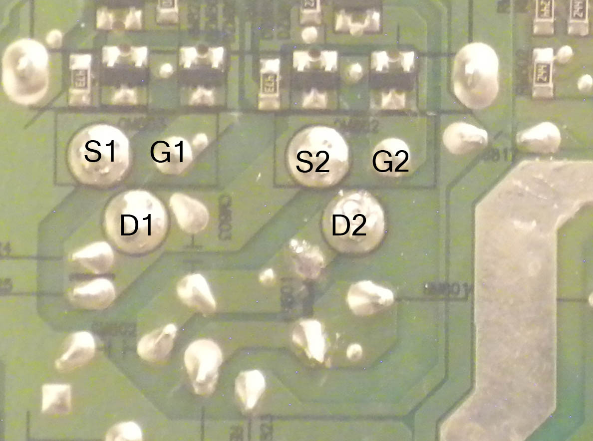

    That MOSFET seems to be okay, but you are testing the wrong one. The ones on the heatsinks are what you should be worried about. Trace the path from the resistor that blows up and you will arrive at the cause of failure.
    Test QM802 and QM803 for a short.
    WOW! Look at all those other MOSFETs that were hiding. Actually, on closer inspection, some of those MOSFETs have diode symbols on them. I'm guessing those aren't tested the same way as QM802 and QM803? There's also a MOSFET on the large heatsink on the far right of the board, lower right hand corner marked ICM851. It's 5-pins, and I can't quite make out the manufacturer. I think it's SK, or SIK, and 2008HFE. I couldn't find a match after a quick Google.
    I tested QM802 and QM803 and here's what I got:
    Black on S1, Red on D1 - .4 ohms
    Black on S1, Red on G1 - 1.6 ohms
    Black on D1, Red on G1 - 1.6 ohms
    Black on S2, Red on D2 - .4 ohms
    Black on S2, Red on G2 - 1.3 ohms
    Black on D2, Red on G2 - 1.3 ohms
    So it looks like these are bad? Is there anything special I need to do to remove them and replace them, or is it just a matter of desoldering and resoldering? While reading up on MOSFETs, I found this forum thread, and this post in particular caught my attention:
      If it looks like a duck and quacks like a duck, it's a duck. If it has a diode symbol and tests like a diode, then it is a diode. They are most likely double diodes with common cathode on the center pin. Check those for shorts too. Normally, a secondary side short should make the power supply fail "gracefully" ie it shuts down, but you never know. Use the diode setting of your multimeter. Black lead always goes to cathode, in this case center leg. Since it is a double diode, move the red lead between the outer legs and get readings on both. They should read between 1000 and 100. If they read lower than 100, reverse red and black leads and see what you get. A diode must only conduct one way so if you get a reading the other way round it's bad.
      Uh huh.
            Those are probably schottky diodes.
            Correct. They are shorted. Desolder them and re-verify they have same readings.
            A diode only allows current in one direction. Since these are shorted they are causing the RM801 resistor to blow.

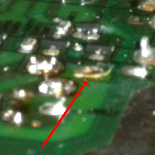

                Yup, they have the same readings out of circuit as well. Unfortunately, I may have messed up. Removing these were a lot tougher than capacitors and resistors, and I lifted the trace up slightly on one of the legs of one of the MOSFETs. I attached a picture - though it's pretty blurry. Does that mean this board is done for, or is there something I can do to repair it?
                Since they are "live" (at mains potential), there will likely be a rubbery thermal pad between them and the heatsink. Just re-use that. Also make sure that you don't lose the plastic washer on the screw if that's the case. Power semiconductors don't need as good thermal transfer as a CPU does, you can just use cheap white silicon paste if you want to, but in most cases that pad is good enough by itself. Arctic Silver is likely to be conductive (even if they say it isn't).
                Thanks, good to know. Hopefully I didn't break my board and I'll put this info to use...

                  I just checked the continuity of that lifted pad by touching the pad with one lead and another component along the trace further down. It still shows continuity. Hopefully that's a good sign?

                    That's fine don't worry. Been there done that many times. You can always use a piece of wire in case you mess it up permanently. Get yourself a solder sucker and some desoldering braid and you won't lift a pad again ever.
                      Hahahaha, I have both, and I still lifted the pad on this one. Guess I need more practice on the bigger joints.
                      I am actually surprised I got this far before doing something like that, I usually screw up much earlier on. Knock on wood - I'm not out of the woods yet...
                        If it didn't show continuity, you can always run a wire to something that is in the circuit. And since you already mapped it out earlier, it would be easy to do.
