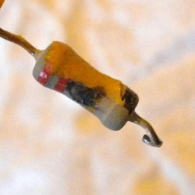

    Ok, some good news and some potentially bad news -
    The good news is that I removed the resistor and it appears to be open - tested it with the "20M" setting on my DMM and now it shows out of range.
    Can I pick up this resistor at my local electronic supply shop (they sell capacitors, resistors)? Or do I need one with special ratings, like the capacitors, and order it from Digikey?
    The potentially bad news is that when I went to remove the solder with my desoldering braid, I noticed I left behind some black residue (picture attached). I tried gently cleaning it with a Q-tip, but it wasn't coming off. If so, is there anything I can do to repair it? I'm asking because I'd like to know if there's anything else I need to pick up other than a new resistor.

      No harm in trying to find it at the local supply. Radio Shack would not carry it. If you live near a Fry's, then you might have a chance. 0.22 ohm is not a standard value. Be sure to take the old resistor as a sample as it's hard to tell from the photo what wattage it is. Maybe 1W?
      The black stuff is probably burnt rosin from the braid. Q-tip dipped in alcohol should work to clean it off.

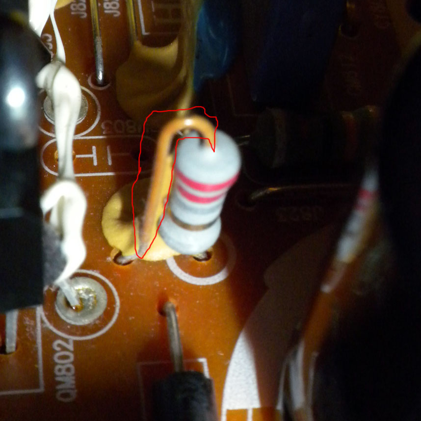

                I just picked up two 0.22 ohm 0.5W resistors from the store ($1.50). They look to be the same size as my original resistor, and the 1W versions were a bit big. The lady mentioned something to me that didnt really register until i left. She said i could go up to 1W and insulate the leads.
                On my original resistor there is a brownish paint(?) that is coating the leads that were exposed on the topside. Is that insulating paint? Will i need some for when i put the new one in?

                  Glad to see that you were able to find the resistor locally. The brown stuff you're referring to is an adhesive used to hold the resistor in place during the soldering process. No need to replace.

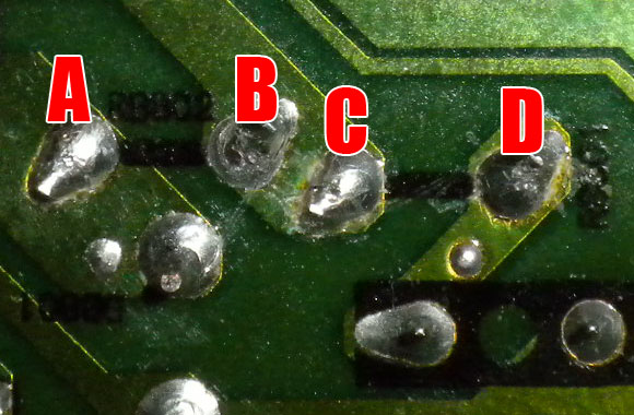

                    I put in the new resistor, and turned on the power supply (by itself with nothing else connected) and within seconds, POP! The new resistor popped. I'm guessing that means I should've gone with the 1W resistor? I also noticed that the original resistor was ceramic coated, and the resistors I purchased were metal (or at least had a glossier look). Is this an issue?
                    I removed the RM801 resistor again, and I'm not sure if I'm paranoid or what, but I noticed that a component right next to it had a little black on the lead. I've attached a picture of it, it's labeled BM801. It doesn't look like the other diodes or jumpers on the board... diodes seem to start with "DM", "DB" or DP" and the jumpers start with "J". Just trying to figure out what it is so I can determine how to check if it's damaged.
                    Also, after the RM801 resistor popped, I decided to check to see if any of the other resistors were damaged and rechecked all their resistances. They all checked out fine, except I noticed something interesting with resistors RB801 and RB802 (the ones to the NE of the SMPS chip). Depending on which "direction" I measured the resistance, I got different values. I attached a picture with the leads labelled.
                    RB802:
                    Black lead on "A", Red lead on "B": 18.8 kOhms
                    Red lead on "A", Black lead on "B": 98.0 kOhms
                    RB801:
                    Black lead on "C", Red lead on "D": 99.1 kOhms
                    Red lead on "C", Black lead on "D": 88.5 kOhms
                    I retested all the other resistors and confirmed they have the same resistance (within tolerance) regardless of "direction".
                    I'm not sure how I missed this before... regardless, I'm not sure what this means. Does this mean that RB801 and RB802 are also bad?

                    I don't mean the gunk on the resistor and the board. I mean it looks like there's a brown "sheathing" on the lead itself. I attached a picture of RM801 again, with the part I'm referring to circled in red. Is that heatshrink insulation?

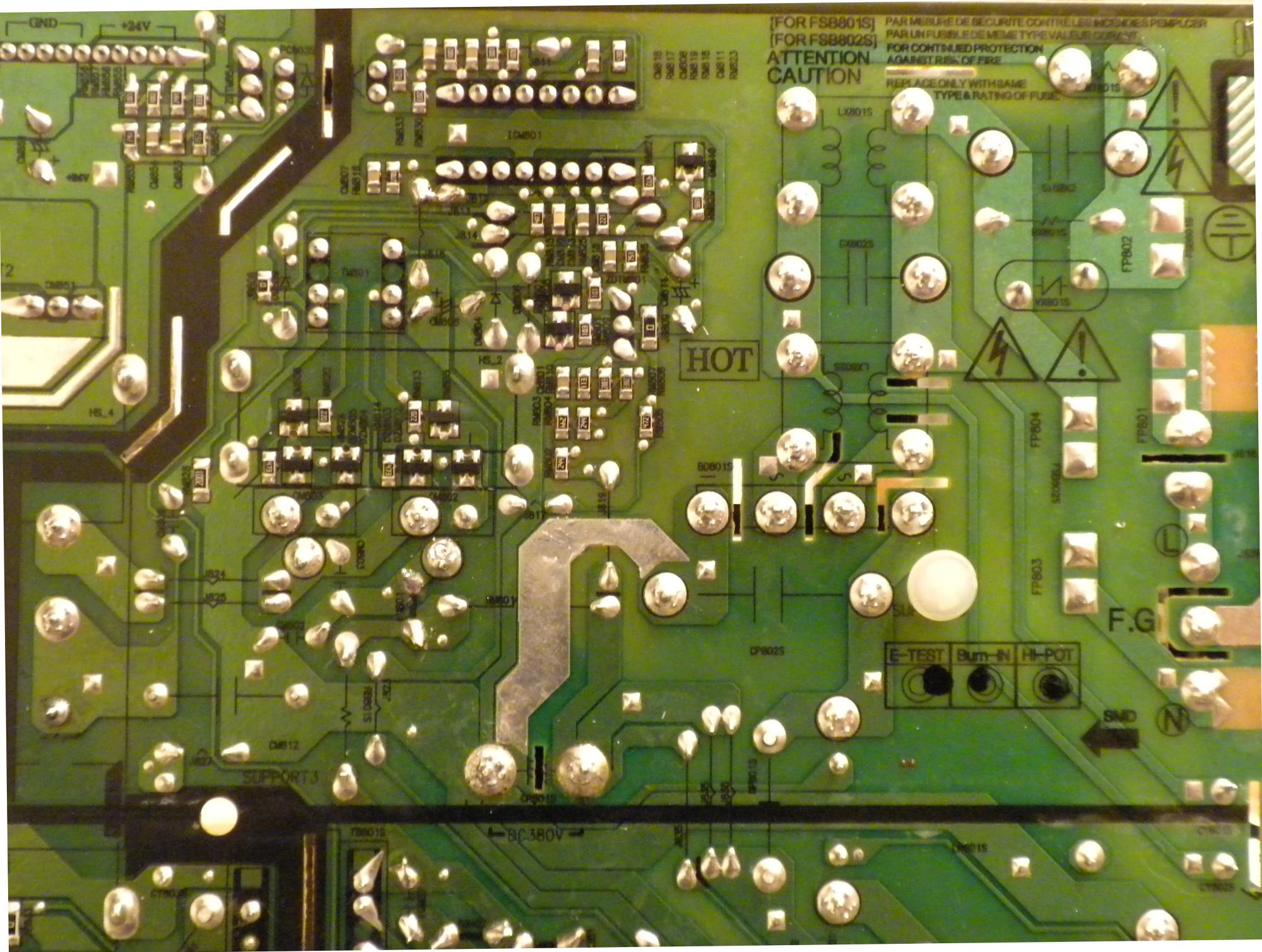

                          I suggest taking a close up photo/pic of the resistor and the surrounding components and draw out the path for us. Identify each component in the path.
                            Ah, ok, sounds good, I'll get right on that! A couple questions though for the diagram. I assume high resistance resistors will show "not continuous", and I should test the resistance between them to confirm there isn't anything wrong w/ the resistor? And I assume the same is true for high capacitance capacitors?

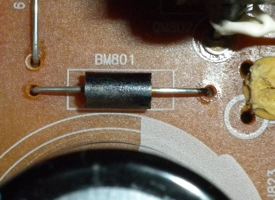

                                      [Side Note: After reading that case study in RetiredCap's post, I see that BM801 on my board looks similar to the inverter fuse in the case study. Can anyone confirm?]
                                      I googled "MOSFET" to get an idea of what it looked like, and I was only able to find one MOSFET, which I marked in the attached picture (burned-resistor-top.jpg). If there are others, please let me know and I'll test those as well. The one MOSFET I found doesn't seem to be anywhere near the burned resistor, but I suppose that doesn't really mean anything.

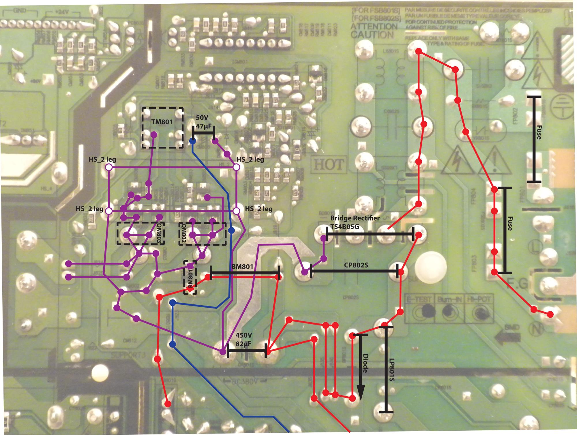

                                      As RetiredCaps asked, I used my continuity meter and did my best to trace the components near the leads of the burned resistor (burned-resistor-trace.jpg). Since I faded out the underlying circuit board so the trace and labels would be clearer, I also attached the same picture of the bottom side of the power board, without all the tracing (burned-resistor-bottom.jpg) and no fading - just as a reference.
                                      The red and purple lines originate from the RM801 resistor leads. The blue line is from the MOSFET, which is off of the picture to the bottom right. I can take a picture of the area around the MOSFET and trace that, if that will help (or is necessary).
                                      In black, I labeled a couple capacitors, a diode, the fuses, and the legs of what I believe is a heatsink (labeled HS_2 on the board). There were a couple other components I didn't recognize, so I labeled those as well (in black) and then referenced them in burned-resistor-top.jpg
                                      Please let me know if I did that right, or if it's unclear, or if there's anything else you'd like me to do. Thanks again, guys!

                                        First of all, congrats for the great writeup and thorough documentation. Even i don't do that sometimes.
                                        That MOSFET seems to be okay, but you are testing the wrong one. The ones on the heatsinks are what you should be worried about. Trace the path from the resistor that blows up and you will arrive at the cause of failure.
