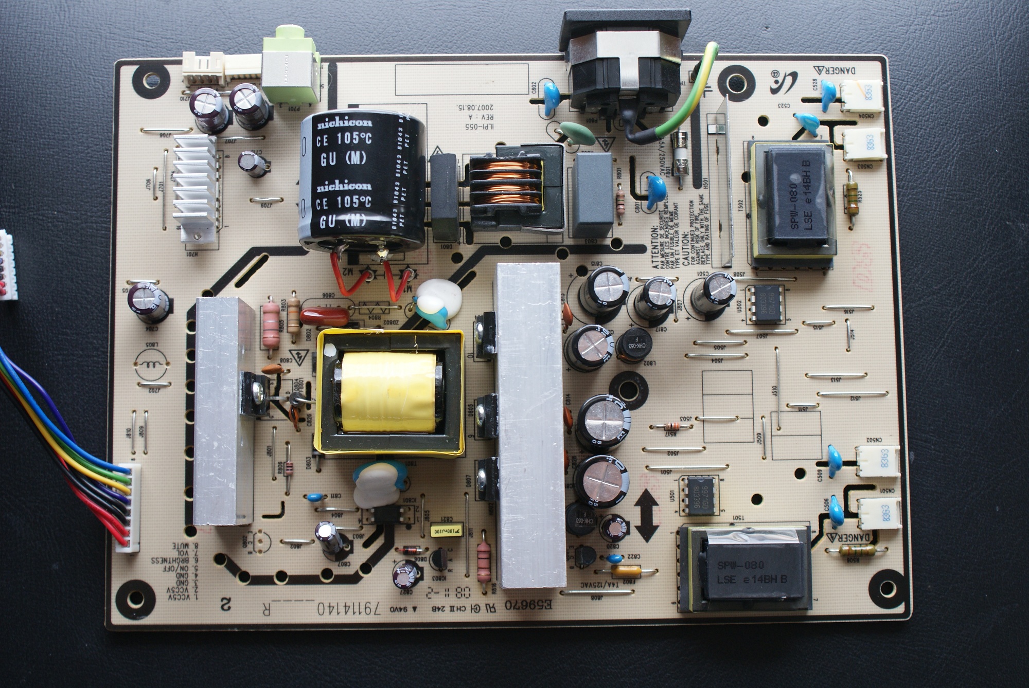

        • RobertoIsRad
          • Nov 2009
          • 42
          Re: Samsung Syncmaster 2220wm
          Pictures as promised

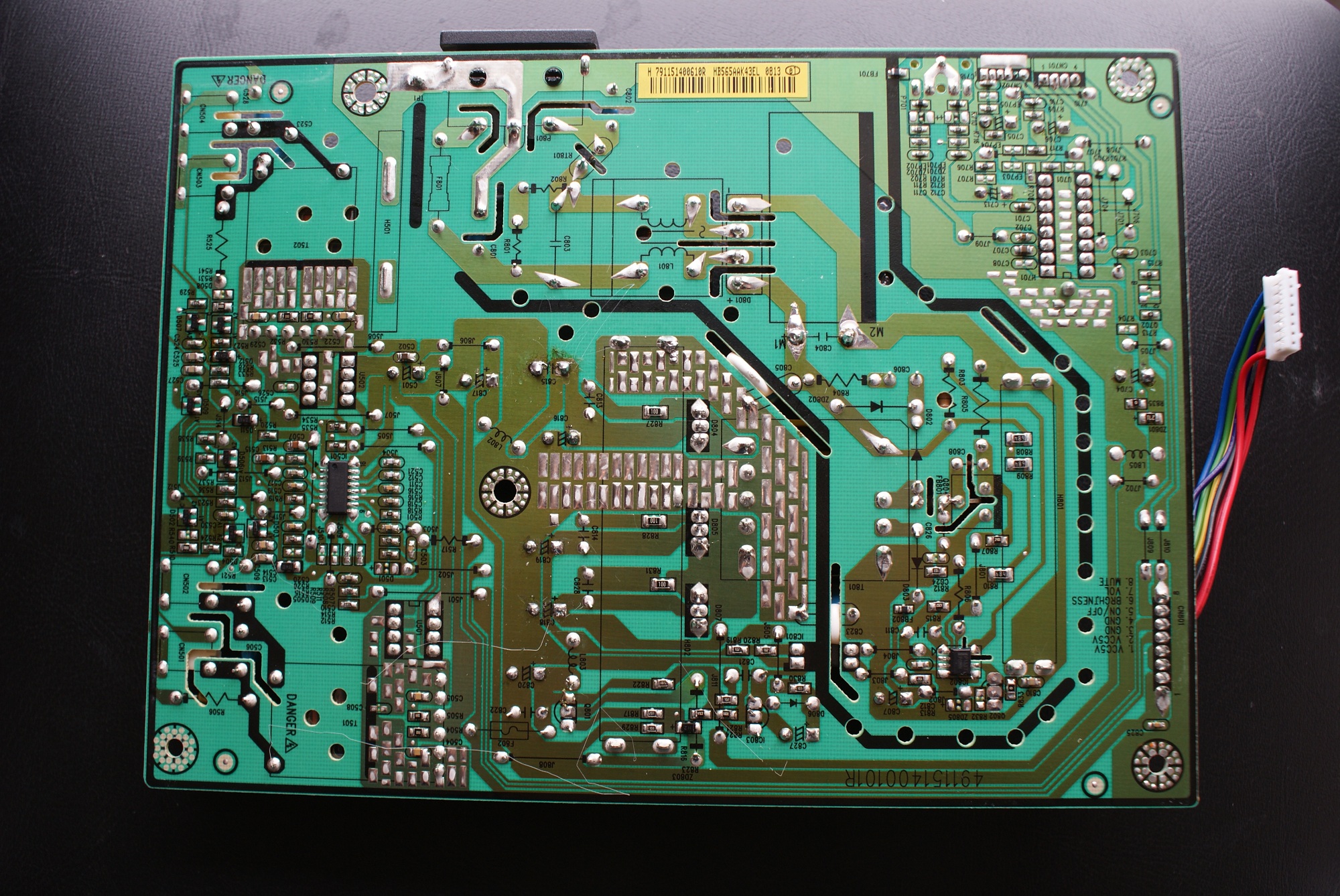

          • jsog
            • Feb 2011
            • 220
            On the bottom, the middle lead of those three left of the Q801 label looks very close to touching the pin above it. The cap leg just to the left of them looks bad.
            • RobertoIsRad
              • Nov 2009
              • 42
              I trimmed the lead you thought was touching, and it didn't change anything. I don't know which leg you're talking about though.
                  C822, the right-hand connection in the photo doesn't look like the solder wetted to the leg. But it's probably just a little ceramic and isn't significant. Solder on the right pad on the replacement cap right above it, C820, looks questionable, and that one might be significant.
                  • RobertoIsRad
                    • Nov 2009
                    • 42
                    I think that it might just have been the light when I took the picturebecause they look good right now.
                    Also I think I mis-spoke, I changed out all the barrel shaped caps. I never did anything with the disc shaped ones because I don't know how to find the specs for a replacement

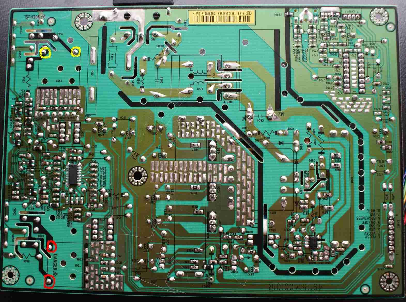

                      Originally posted by RobertoIsRad
                      Any ideas?
                      Okay, let's slow it down first.
                      1) Does the power LED light come on at all?
                      2) Are all the internal cables inserted/seated properly?
                      3) I have attached your picture (excellent btw) where the secondary transformer pins are. With power off and lcd unplugged, put your multimeter on 2000 ohms (if manual) and measure the resistance between the 2 yellow dots. Report measurement. Do the same for the red dots.

                      • RobertoIsRad
                        • Nov 2009
                        • 42
                        1) No LED at all, Before it used to turn on as soon as it was plugged in. Then when I pressed the power button I would get the 2 seconds to black. Now it's off if I press the power button or no. I may have popped f802 originally it was reading 00.3 now it's 1 . I'll try to jump it if you think that might be the cause to this most recent problem at least
                        2) Yes, i've unhooked/hooked everything up a few times and looked at all the cables and they look undamaged.
                        3)
