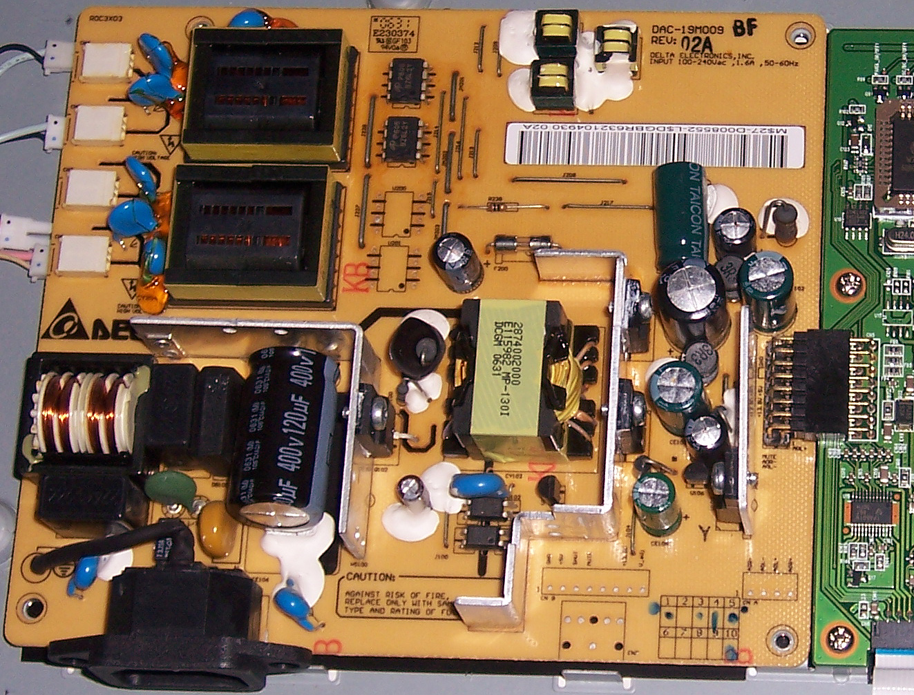

    I am new to this forum, so please forgive me ahead of time.
    I will try to make this simple. I have a 22" lcd (Westinghouse LCM-22w2) that is malfunctioning. Research reveals my symptoms are cause by faulty caps in the PS. I making a desperate attempt to replace the caps (as some are bulging pretty badly) in hopes to fix the problem.
    So here is my problem. I need polarized electrolytic caps (at least that is what the board comes equipt with. I was having some issues finding caps with the exact specs that came from the board. I just want to get the right replacements.
    IE: The voltage is 5 or 10 V off on the rating, but the capacitance rating is the same.
    1) Will getting a slightly higher or lower voltage rating not be a good idea (providing I have the right capacitance) ? What issues will I run into in either direction?
    2) Do I have to get the same caps, or is it just the spec that needs to be the same.
    If you have experience in any of these areas, any help would be much appreciated. If you know what will work for me and what will not, that would be awesome as well. I have pics if anyone needs them. I only need like 5 caps, and I do have the specs if needed.
    Also, if this is not in the correct forum, please let me know where this post belongs.

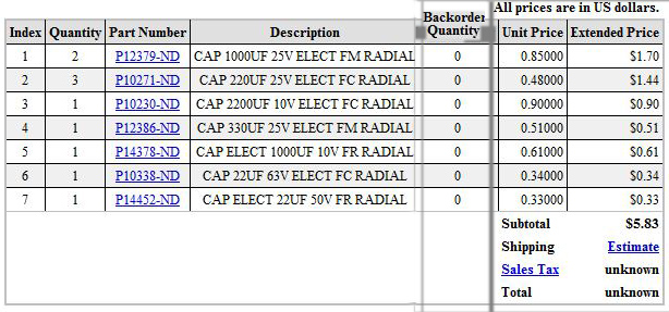

              OK, where to start...lol. I spoke to a cousin of mine that said he could get me caps, as he works in the stock room for the Electronics dept at his College. This was before I joined this forum. He got what he could for me, but I ended up with 5 Axial caps(out of 9) even though I specified radials. (that was today). So, concerning that. Other than just bad practice habits and spacing, how bad of an idea would it be to just use the Axials and route one lead down the side of the cap, into the mounting holes like normal ?
              On to the more practical note, I have decide completely against using any of the caps my cousin gave me, and just ordering all new ones from Digikey, as advised. This takes out most controversy/ambiguity (since I'd have little specs on the ones from cousin).
              Start by making up a list of capacitors by location number, diameter, capacitance and voltage. Note the height of the tallest cap - that is the maximum height. Flag those caps which are crowded together (diameter limitation).
              Now search Digikey for suitable caps. Before you place the order, post the maximum height, diameter, capacitance and voltage of each value, and the stock number of your proposed replacement. Someone will verify this.
              And when you place the order, specify USPS First Class Mail shipping.
              PlainBill
              I have made a list of info for the original caps in an Excel spreadsheet, noting everything mentioned. I have searched Digikey (finally figured it out, LOL) for what I thought were suitable replacements. As far as I know, all replacements are what they need to be. 1 or 2 were a little smaller and a couple were a little taller (but not exceeding the tallest. Diameter will work as well. I was hoping you guys could take a look for any red flags, as I have never done this before. As such, I have yet to purchase the order, it's just waiting for verification.
                2) For the 220uF 25V, I would choose the FM over FC at
                http://search.digikey.com/scripts/Dk...name=P12383-ND
                3) For the 2200uF 10V, I would choose the FR over the FC at
                http://search.digikey.com/scripts/Dk...name=P14382-ND
                4) For the 330uF 25V, I would choose FR over FM
                http://search.digikey.com/scripts/Dk...name=P14415-ND
                In general, FR => FM => FC. FR/FM are lower ESR and higher ripple than FC.
                The less than $10 that you will spend is totally worth it for a 22 inch monitor. You will probably never have to replace the caps again using these high quality caps.

                  Okay, replacement caps came in today. I have successfully replaced all of them, excluding the big one. I still have a problem, but a few symptoms that were present before, are now gone :-)
                  But lets back track a bit. From the beginning. This was my initial problem (phase 1)
                  http://www.youtube.com/watch?v=KQ_Q4mf2QdQ
                  After running it like that for a a month, it totally croaked on me (phase 2). Upon powering on, it would turn on normally for a few seconds (no more than 5). After which point, the green LED (on) would flicker then shut off (as would the monitor). I noticed that this new found issue was accompanied by a high frequency whine (~16-18 kHz). The unit did not have to be powered on, only plugged up, and I could hear it. I narrowed the noise down to the PSU. I was right (I think).
                  Now that I have re-capped the board, I have no white or blue screen. So the advice given was good. However, I am still left with the problem from phase 2 (less the high freq whine).
                  At 1st I was unsure where to go from here, but it turns out, there are a few threads in here with this same monitor. It did not show up under the search of the model number though, but under Westinghouse:-?
                  I read many threads which led me to try and see if I have visual when shining a light on the lcd. I DO. So is that indicative of my back-lights ? Any advice on that? I'm busting into it today.
                  PS: Should I continue in this thread here, or should I revive an old thread ?

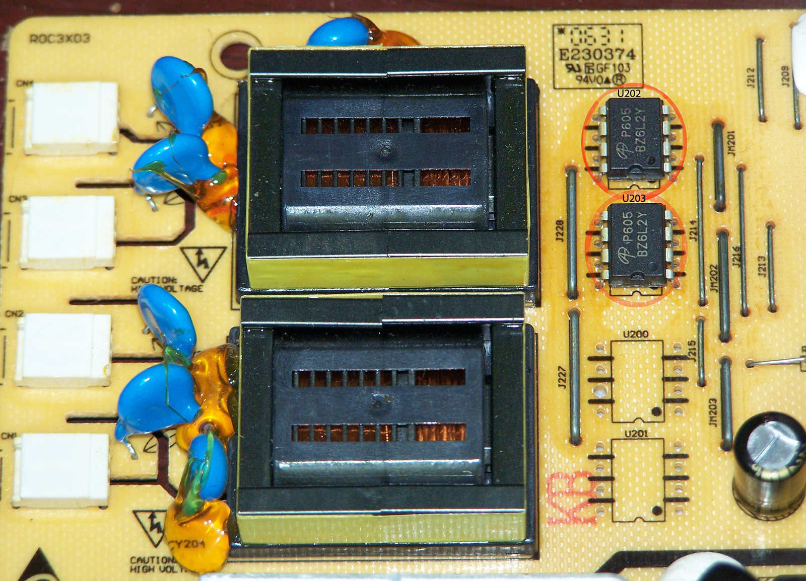

                    Continue this thread. Have you checked the fuse for the inverter (F200)?
                    PlainBill
                    • retiredcaps
                      • Apr 2010
                      • 9271
                      Re: Needs caps for my 22" lcd
                      If the fuse is good (it will measure less than 1.0 ohms), then check the mosfets just right of the 2 inverter transformers to see if they are shorted.
                      If you need help testing them, list the mosfet part number, and find its datasheet (with URL).

                        I assume you are talking about these (referring to the Mosfets) ? http://search.digikey.com/scripts/Dk...0cfp&x=16&y=17
                        I only ask because (referencing from my pic), the Inverter transformers are on the top left (above the large cap), yes ? The 2 other electrical components just to the right of them, I do not identify as Mosfets (though my knowledge is limited with these things).
                        I identified the Mosfets to be the link above, which are on the other side of the board (far right side mounted along the heat sink). If you could clarify just a smidgen, I think I can take it from there. And I will post my results Thanks

                          The mosfets are the 8 pin ICs just under the label that says E230374. Normally, I would give PCB designations, but your photo isn't sharp enough to read.

                              If you search this forum for AOP605, some of had problems with this chip.
                              You might as well test the ones on the backside because I'm sure someone will ask for those test results as well.

                                    Ok, I tried. My readings are as follows, for
                                    *All readings were with components in the board, not powered.*
                                    Mosfet U202
                                    a) black on (pin 3) S1- red on pin G1: .6 Ω (pin 4)
                                    b) black on (pin 3) S1- red on pin D1: OL & OL (pin 5 & 6)
                                    c) black on (pin 4) G1- red on pin D1: OL & OL (pin 5 & 6)
                                    Repeat for the "2" pins. That is:
                                    (pin 1) S2-G2: .6 Ω (pin2)
                                    (pin 1) S2-D2: OL & OL (pin 7 & 8)
                                    (pin 2) G2-D2: OL & OL (pin 7 & 8)
                                    Mosfet U203: All readings identical to that of U202
                                    Can we (lol, or you, rather) tell from this data if removing the component for further testing is necessary? I think I did it right.

                                      I you're reading only 0.6 ohms across S1-G1 and S2-G2, that would indicate it's shorted. You may have to remove from board and retest.

                                        a) black on (pin 3) S1- red on pin G1: .6 O (pin 4)
                                        (pin 1) S2-G2: .6 O (pin2)
                                        Both mosfets seem to be shorted (the 0.6 ohms reading) and need to be replaced. Desolder both and retest to verify the 0.6 ohms reading.
                                        If you get the same reading out of circuit, order AOP605 off ebay.com since Digikey.com has no stock.
