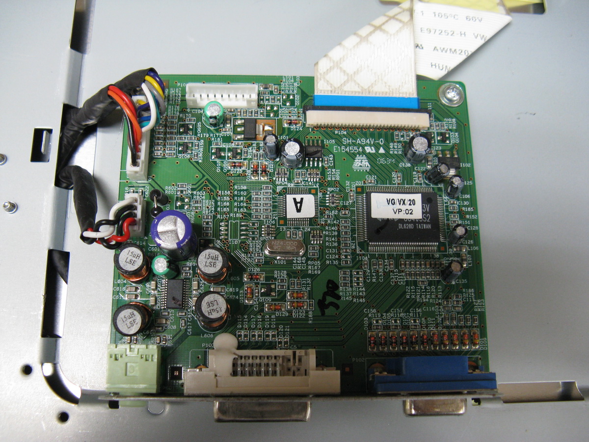

    Found this LCD monitor in the hallway at work with a post-it note that
    says "Dead". Took it into the lab and attached AC power and only the blue

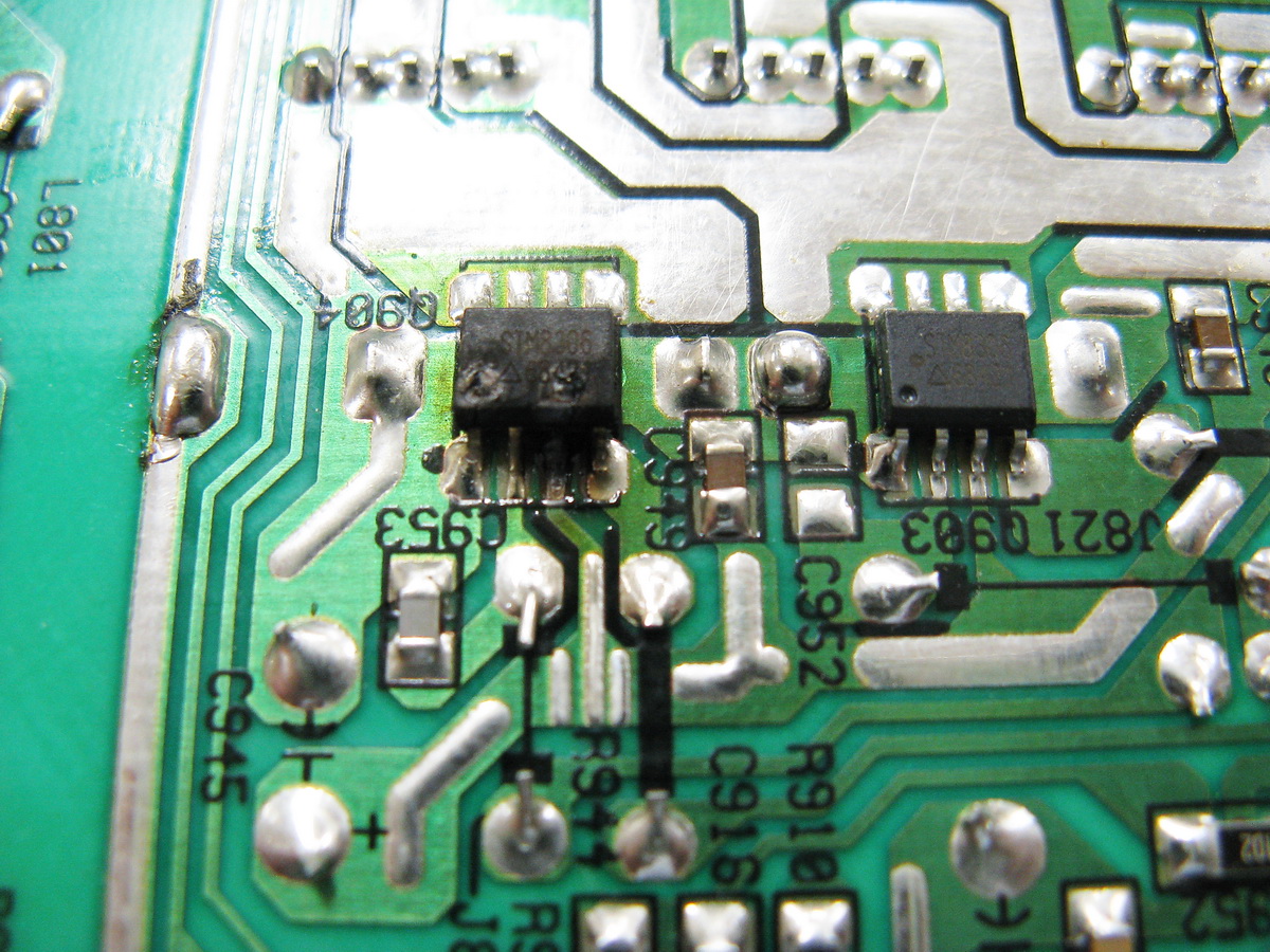

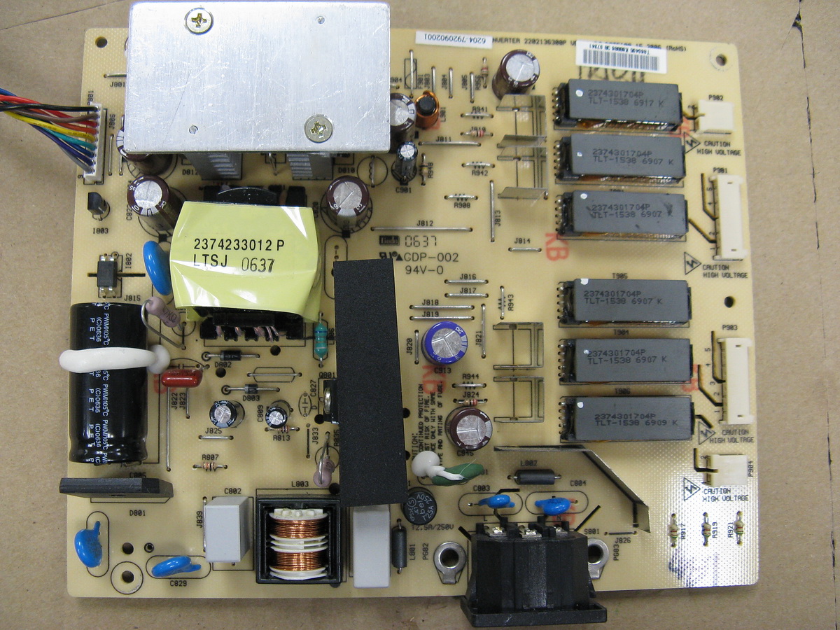

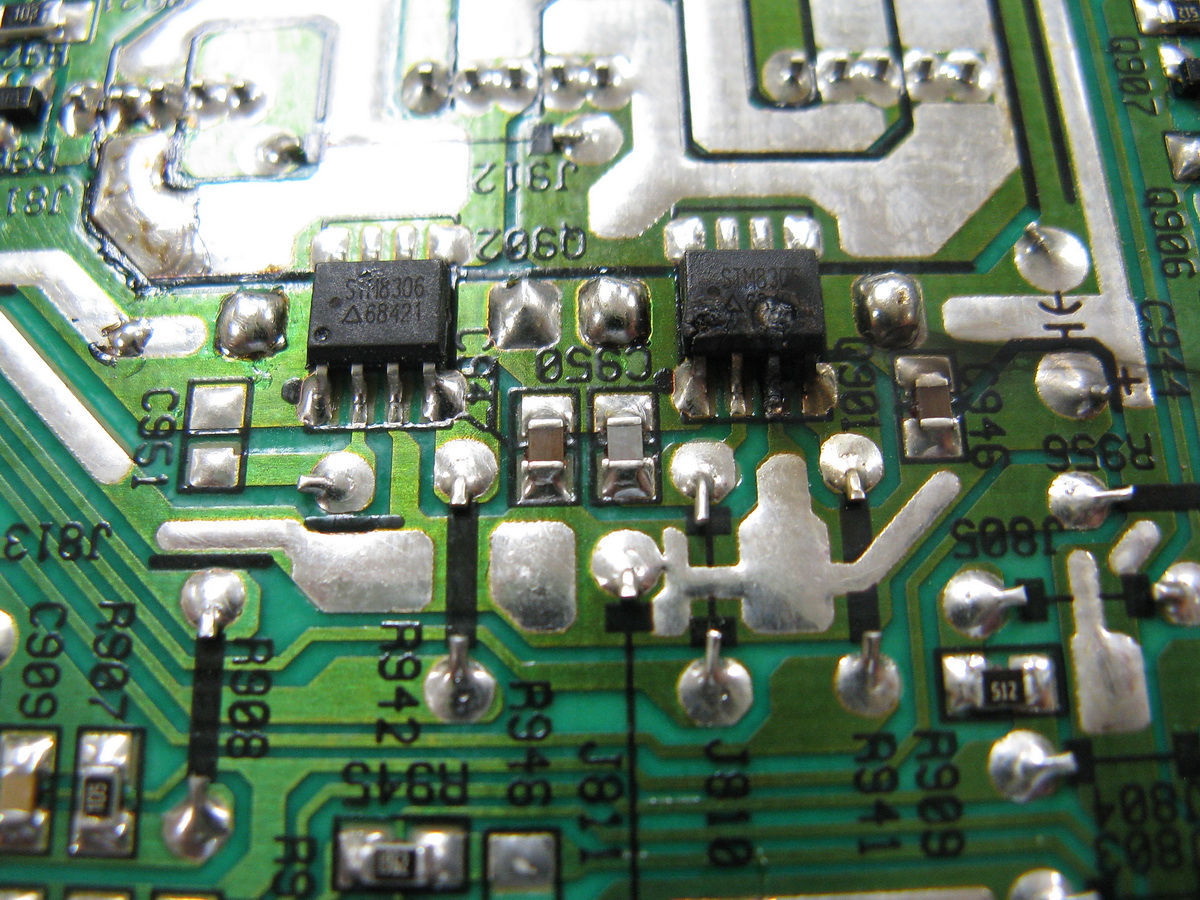

    light came on on the on/off button and nothing else. Opened it up and found
    no visible bulging caps but did find two popped FET ICs. These should be the
    inverter driver FETs with part# STM8306 printed on them. There are a total
    of four of these ICs and only two are visibly damaged. The other undamaged
    two although measuring ok may have seen adverse effects that probably
    needs to be replaced as well. These STM8306 dual FETs with one being a
    N-channel FET and the second being a P-channel FET seems to come from a
    company called SamHop based in Taiwan. I looked around and can't find any
    US sources for these STM8306. Does anyone know where I can find these or
    recommend an applicable substitution ? My research shows the Vishay
    Si4599 part should work in this application.
    Pictures of the popped FET packages and the spec for the STM8306 and Si4599DY are attached. Any help is appreciated.

    Apparently, viewsonic used several different duo mosfets for Q901-904:
    STM8306
    AM4502C
    AP4509GM
    AP4511GM
    Replace them in pairs.

      Oh, I forgot to add that since you got the monitor for free, it probably wouldn't hurt to replace all caps, except for the large 450V one. It might have been a failing cap that caused the mosfet failure.
      • Scenic
        o.O
        • Sep 2007
        • 2642
        Re: Viewsonic 20" VG2030wm
        all caps look like they're HERMEI (with a panasonic T-vent )
        definitely replace them. known crapcap brand
