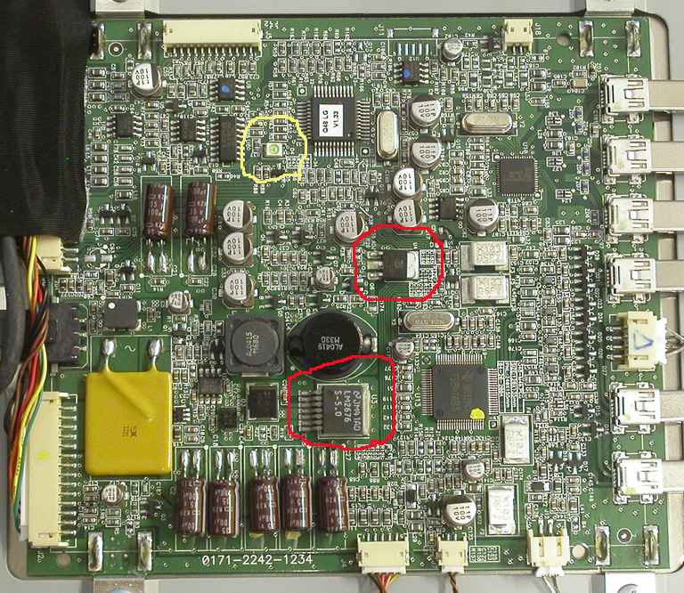

    Picked this up last month without a power supply. After getting the correct Apple power supply, 24.5v, unit would not turn on. After I disassembled, was able to verify that it is getting power. Caps appear to be United Chemicon KZH - using ESR meter, they measure OK. I have 24.6v across 5 caps at bottom, nothing across the two @ mid photo. Sometimes the LED, circled in yellow will come on when energized, sometimes not. Regulator in red is 1117-3.3, but am not getting a reading. Switcher in red, from top down reads, 5.03,24.6,14.91,0,0,5.01,6.31 volts. Lots of small SMD stuff!! Need help to get power. In testing small transistors - E to C should be open?

          Just wondering trwilson70 have you had any luck with you cinema display I have two of them a 20 and a 23 inch not working I can get them to come on most of the time buy cycling the power on and off a couple of times I have checked the 23 inchs caps and reg. and they seem ok.

            got this info from another site....check the VR3 3.3VDC REGULATOR center pin to make sure it is putting out 3.3v, bad one will put out about 4vdc

                budm which 3.3VDC REGULATOR would you recomend? Is this one ok http://www.digikey.com/product-detai...483318?cur=USD ?

                  Re: Apple Cinema Display 20"
                  Well, it won't turn on without being attached to a computer with DVI that's powered on.
                    3.3v 1A Fixed, that should be fine.
                    Does the output read close to 4vdc?
                        ok i got it out...middle pin output reads 2.7vdc??
                          That is bad, when it failed, it can be higher or lower than what it should be.
                            Thank you...fixing to order the part...and see how it goes..
                              YES!!!!! IT worked..!!!!! Thankyou Budm for your help!!!
                                Great!
                                Most people on youtube will tell you to mask off the sensing pin on the power connector or buy new power supply, but if the regulator puts out 4v or higher, then sooner or later the main board may be damaged.
