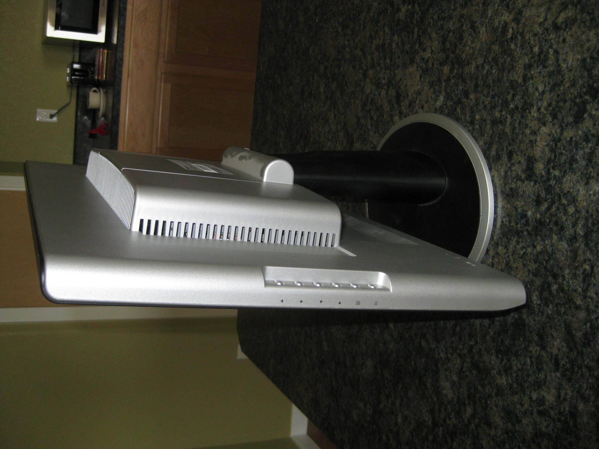

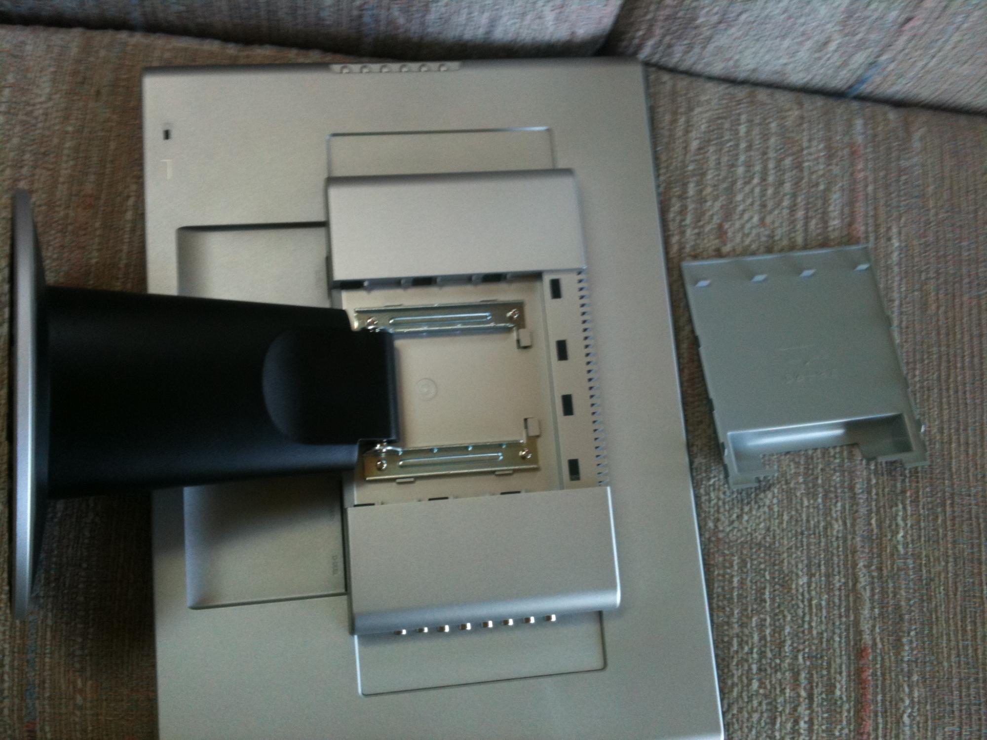

    How to Open Case on Westinghouse LCM-22W2
    I'm a noob that had great success with my broken Samsung monitor after following the advice on these pages and replacing some bad caps. You guys are great!
    Now my Westinghouse LCM-22W2 is no longer working and after running through the forums, I've got some great ideas on where to start. But, I'm stumped on step one - opening the silly plastic case! I'm guessing there are some plastic clips need to carefully be pried apart - but I don't know where they are. I'd love some advice on dis-assembly.
    Here are a couple of pics of the case in case anyone can edit or point me to the right procedure.

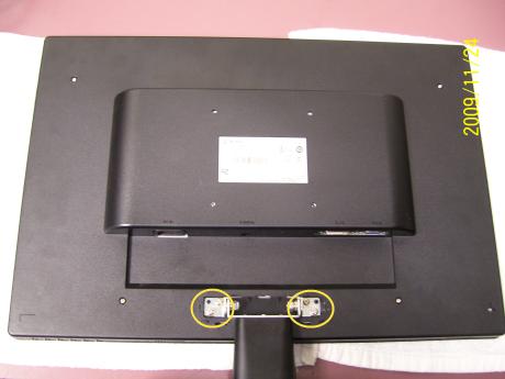

    Remove the Stand there is a plastic cover hiding the screws, and four screws at each corner of the monitor.
    Sorry there are no four screws at the corners.It most likley has snaps

      Re: How to Open Case on Westinghouse LCM-22W2
      Not exactly the same monitor (22W3) but should come apart the same

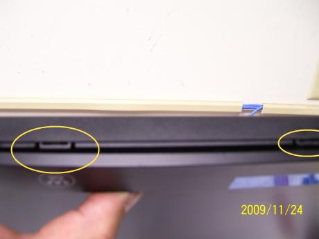

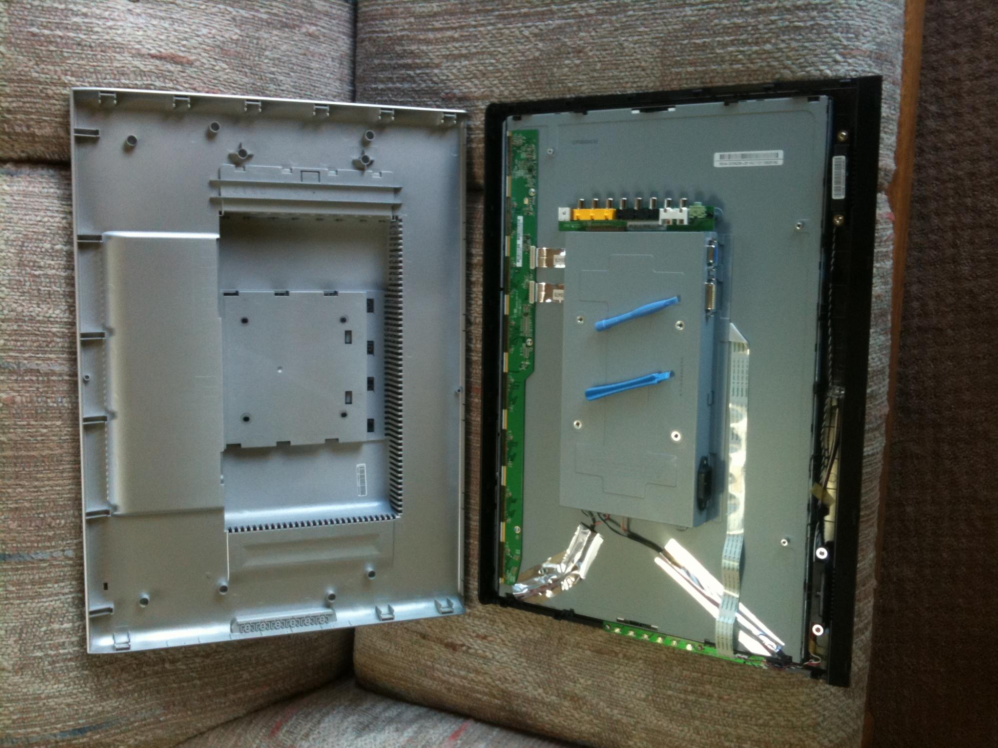

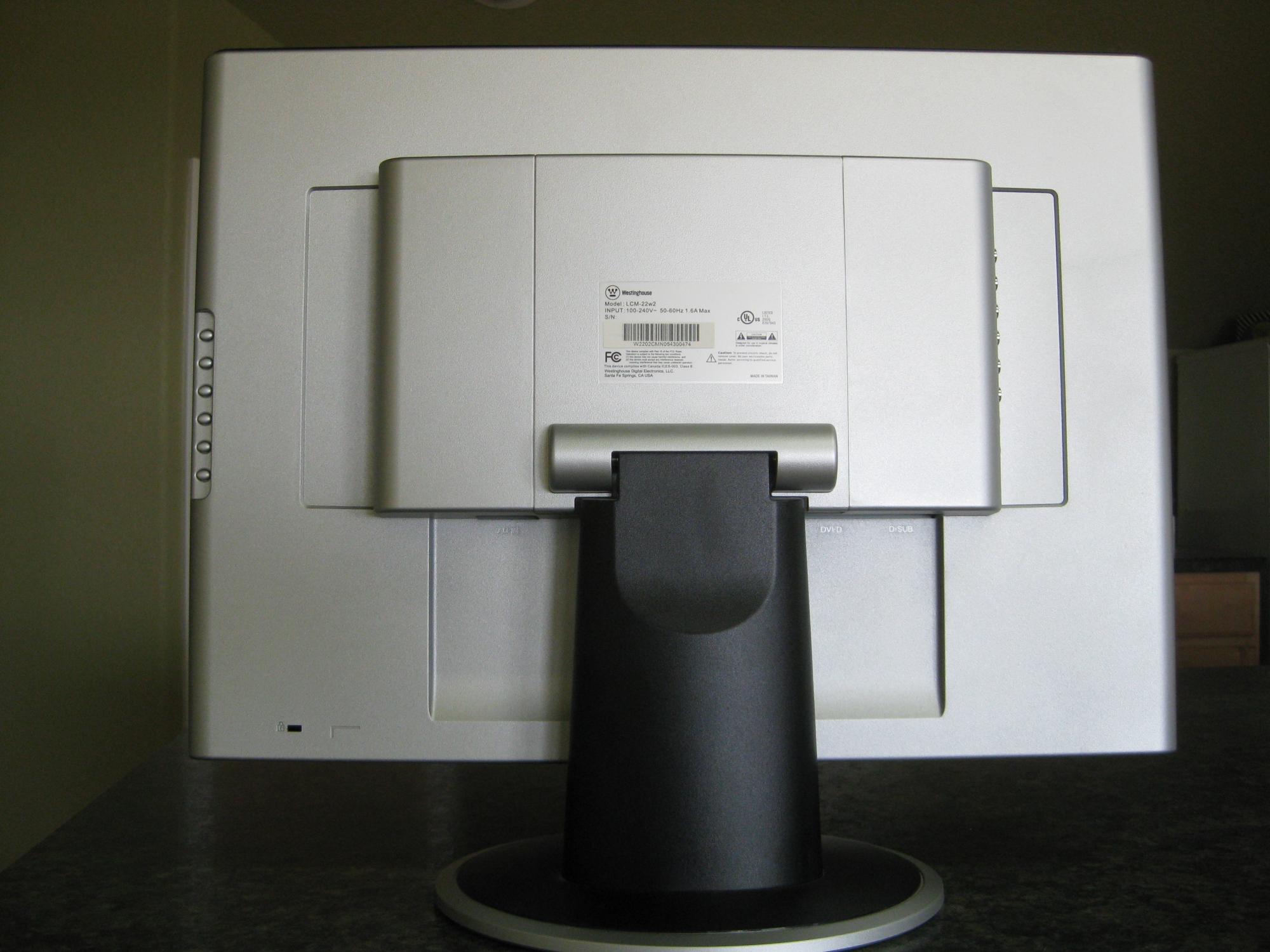

        Thanks for all the help. There was a small cover that just snapped over the center of the back - with that pryed off I was able to get to the four screws that held the stand on. Then I used an iPOD tool to pry apart the plastic case.
        Anyway - some photo's attached for the next guy who has to open one of these. After getting to the motherboard - I found three 220uf CapXon Caps that were bulged. Using other data from this site I ordered new caps from Digi-Key

          Did you use to tool to unsnap the clips at the bottom? There are like 4 or 5 of them. To pop them open, just push the tabs in with a small screwdriver (or anything that is small and stiff enough), you have go through the slits. They will make a popping sound when they come unlatch and the 1/2 will separate slightly. Work you way across the board till you get all of them othewise if you just pry it open, you will break the tabs. But I suppose it's not the end of the world. The top does not have them so it just opens like a suitcase once the bottom tabs are popped.
          You probably did that though, but the post was a bit unclear. I only mention this because I was told to just pry it open and I broke a tab in the process. You can easily see them if you look through the slits with a light.

            Did you use to tool to unsnap the clips at the bottom? There are like 6 of them. To pop them open, just push the tabs in with a small screwdriver (or anything that is small and stiff enough), you have go through the slits. They will make a popping sound when they come unlatch and the 1/2 will separate slightly. Work you way across the board till you get all of them othewise if you just pry it open, you will break the tabs. But I suppose it's not the end of the world. The top does not have them so it just opens like a suitcase once the bottom tabs are popped.
            You probably did that though, but the post was a bit unclear. I only mention this because I was told to just pry it open and I broke a couple tab in the process. You can easily see them if you look through the slits with a light.
              Yes, I used the iPOD plastic tool for this and it worked out fine.
