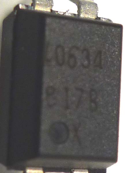

                    So I took the photocoupler out and found the number, but not making much sense to me? Is there a way to check to see if the part is good? also does it have to be installed a certain way? it says L0634 8179 on the chip.

                      i tried googling the part number marking to no avail.
                      As for me mine is this (EL817)
                      The readings i took on the GOOD photocoupler are as below,..
                      Pin 1 (Anode)> 121V (the pin closest to the circular dimple on the marking)
                      Pin 2 (Cathode)> 121V
                      Pin 3 (Emitter)> 6.4V (this one links to the control pin of the topswitch, on the one with poor slder joint it reads 0V)
                      Pin 4 (Collector)> 16.7
                      All the readings were taken with the black probe on the (-ve) point of the BIG cap.. All the readings were taken at first start-up (mains switch turn on, Power led light up, but no respond)
                      Have u tried soldering it back & see whether it is still the same? What is the marking on U101?

                          I'll solder it in now and check voltages, but here is a close up of it and see if you can figure it out what it is :P
                          Now that I look at it, maybe L0634 817B ?

                            Yup, that'd be an 817. Typically Sharp PC817. Shouldn't be hard to locate a datasheet. One at http://www.futurlec.com/LED/PC817.shtml
                              Thank ya kindly sir! I'm in an area of repair I've never done before.
