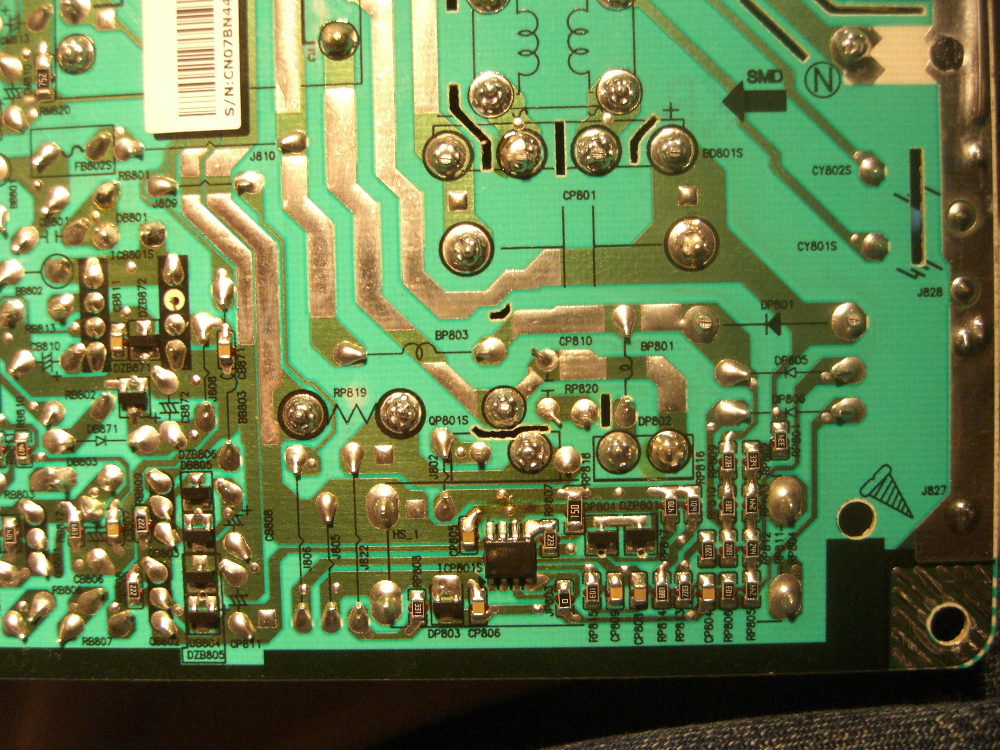

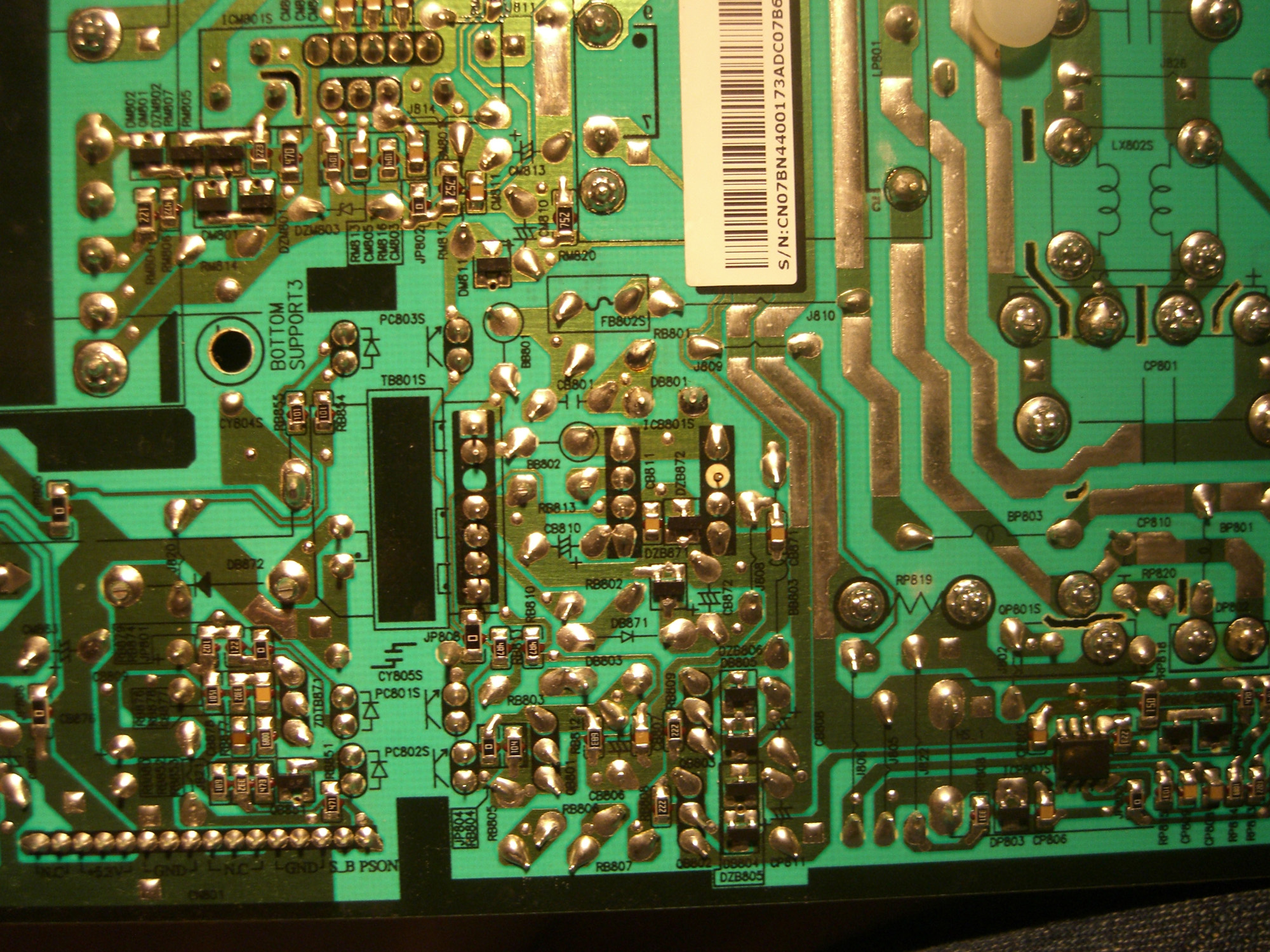

                    Okay, this implies that the SMPS power supply is not starting for some reason.
                    1) It could be a bad small capacitor either dried out or has high ESR.
                    2) It could be the SMPS controller chip is bad.
                    Service manual is here

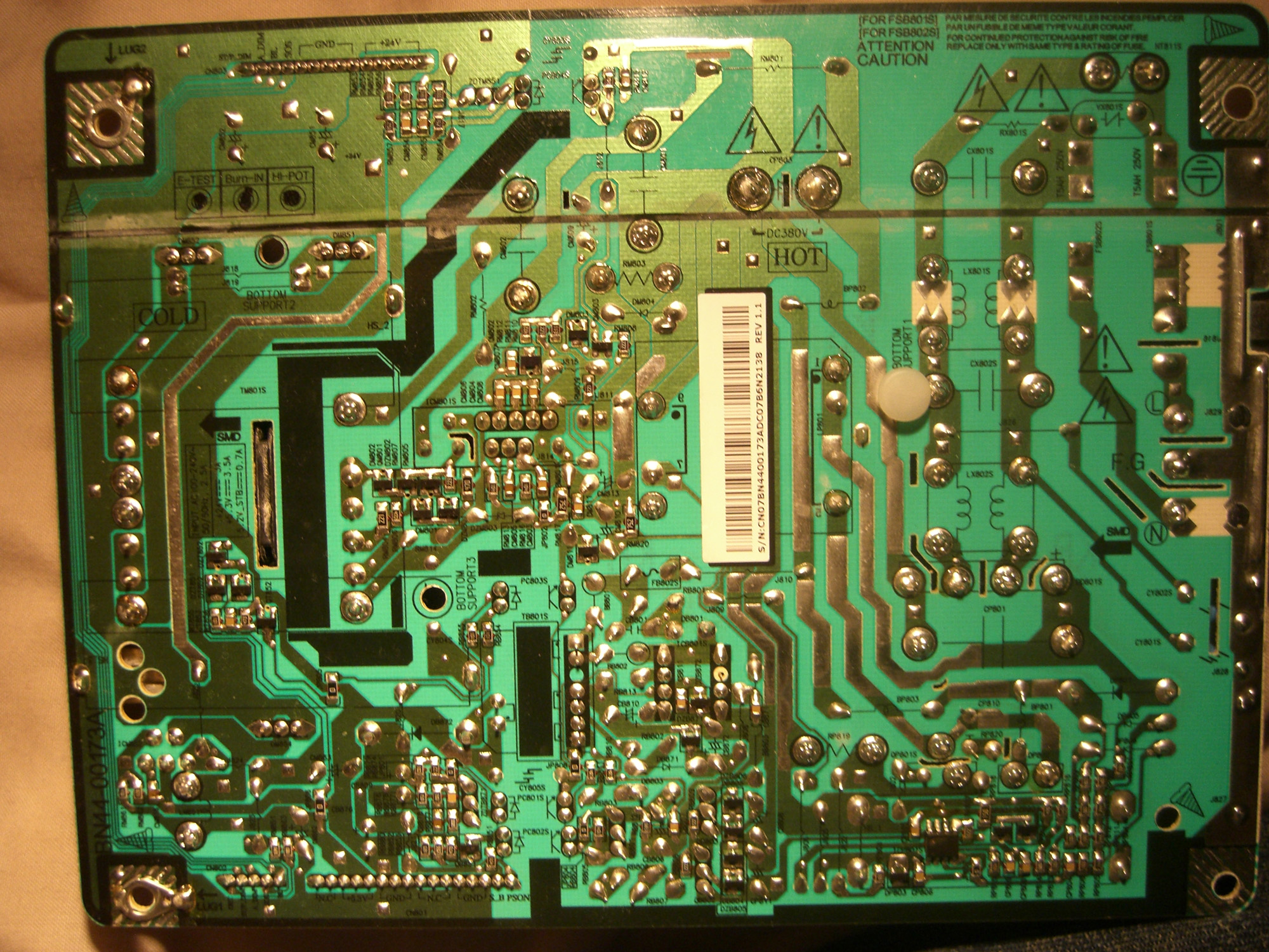

                    PS. We will also need a clear focused photo of the backside of the power board.

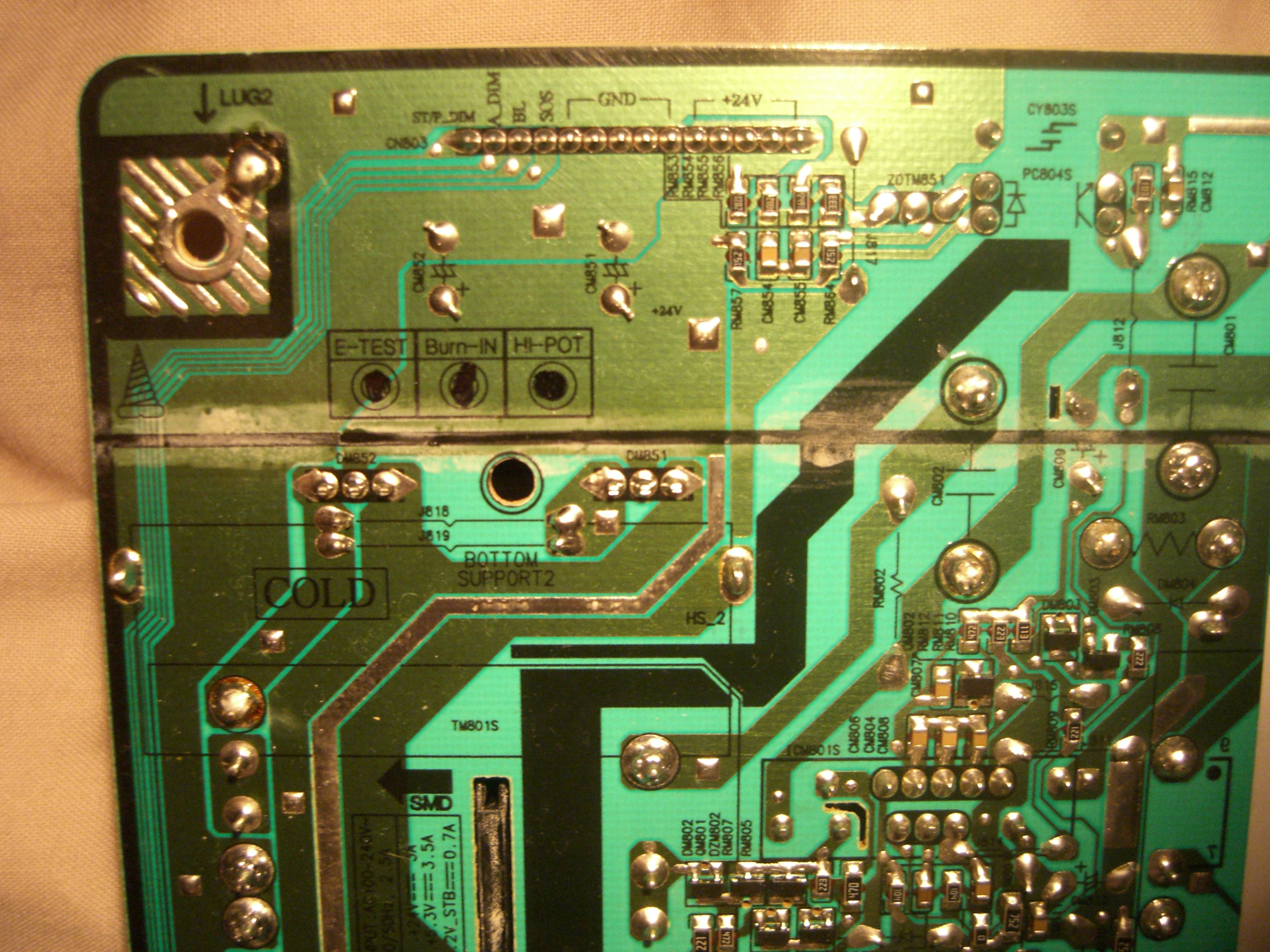

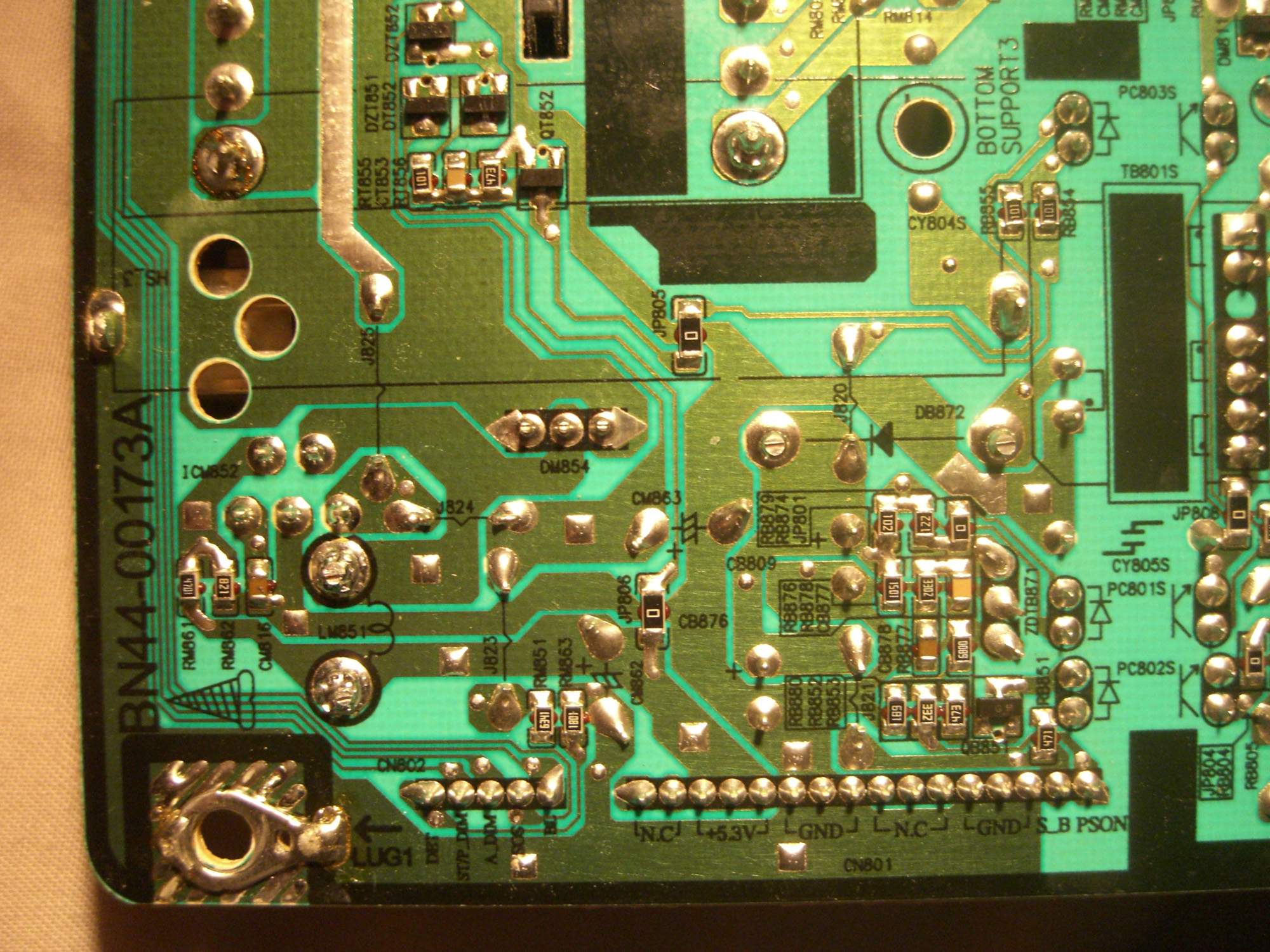

                      Thanks for that, downloaded the manual, not really sure what I'm looking at though. Here's the pictures of the underside of the power board.

                        Okay, this thread has a ton of info.
                        https://www.badcaps.net/forum/showth...highlight=245B
                        1) If you haven't seen it, try measuring RB805, RB806, and RB807. One may be burned?
                        2) Check QM802 to see if it is open.
                        3) Check fuse FB802S.
                        Anyone of the above could be the cause of the SMPS not starting. Details of all 3 are in the above thread.

                          Do you mean to measure the voltages? RB805, 806 & 807 all appear to be scourched quite a lot.
                          Fuse seems to be ok, resistence measures 0.04

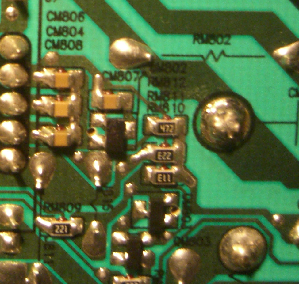

                          How do I test QM802? I can see it marked on the bottom of the board but not tell what part it's connected to as there are lots next to it.

                              Where is QM802 on your board? I can't seem to find it. I see a QB802 near the resistors. I got the QM802 designation from the other thread.
                              If QB802 is the "correct" part for your board, also check QB801 and QB803.

                                RB806 & 807 measured close to 67 each, 805 there was no reading at all so looks like that may well be dead.
                                QM802 I'm still confused by - this is what I'm looking at.
                                  Remove RB805 and retest out of circuit.
                                  I still can't see what you are looking at for QM802. Maybe circle it so I know what you are looking at.
                                  Test QB801, QB802, and QB803 for sure though using the method I described above with 1-2, 1-3, and 2-3.

                                    Sorry it's not very clear in that photo - QM802 is marked above RM812, I'm not sure what part to test though. When you say 1-2 for example do you mean the pins on it?

                                      Normally transistors are 3 pins. Some are more. For a 3 pin transistor, just number them 1, 2, 3. Measure the resistance between pin 1-2, 1-3, and 2-3.

                                        Taken RB805 out and it's dead. Tested qb801 02 and 03 but couldn't get a result on any of them.
                                          If QB801, QB802, and QB803 all read out of range, 0L, or "1", then they are good.
                                          So order a new resistor and retest.
