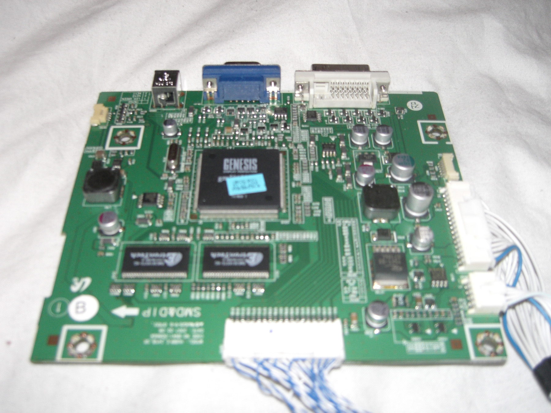

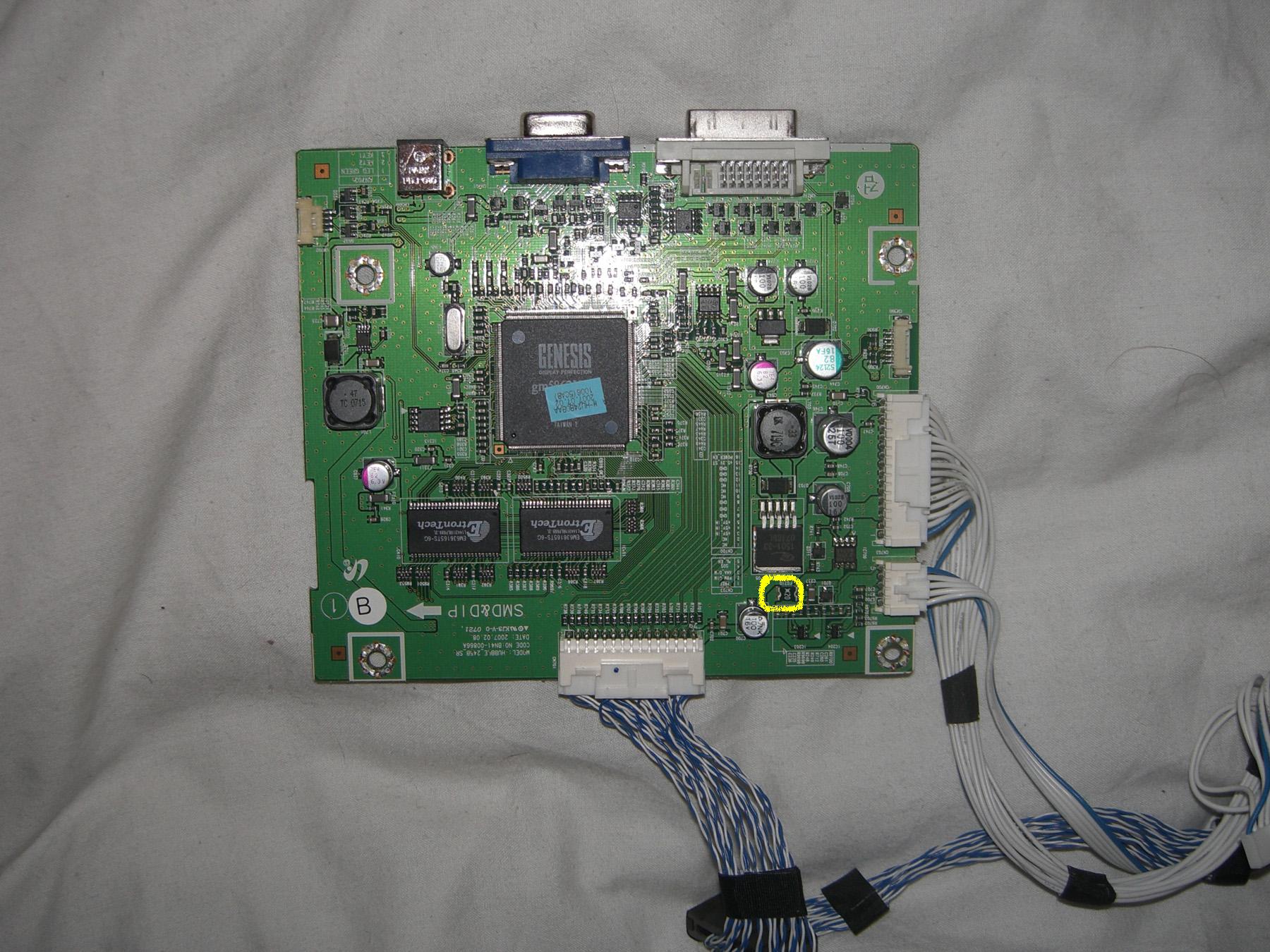

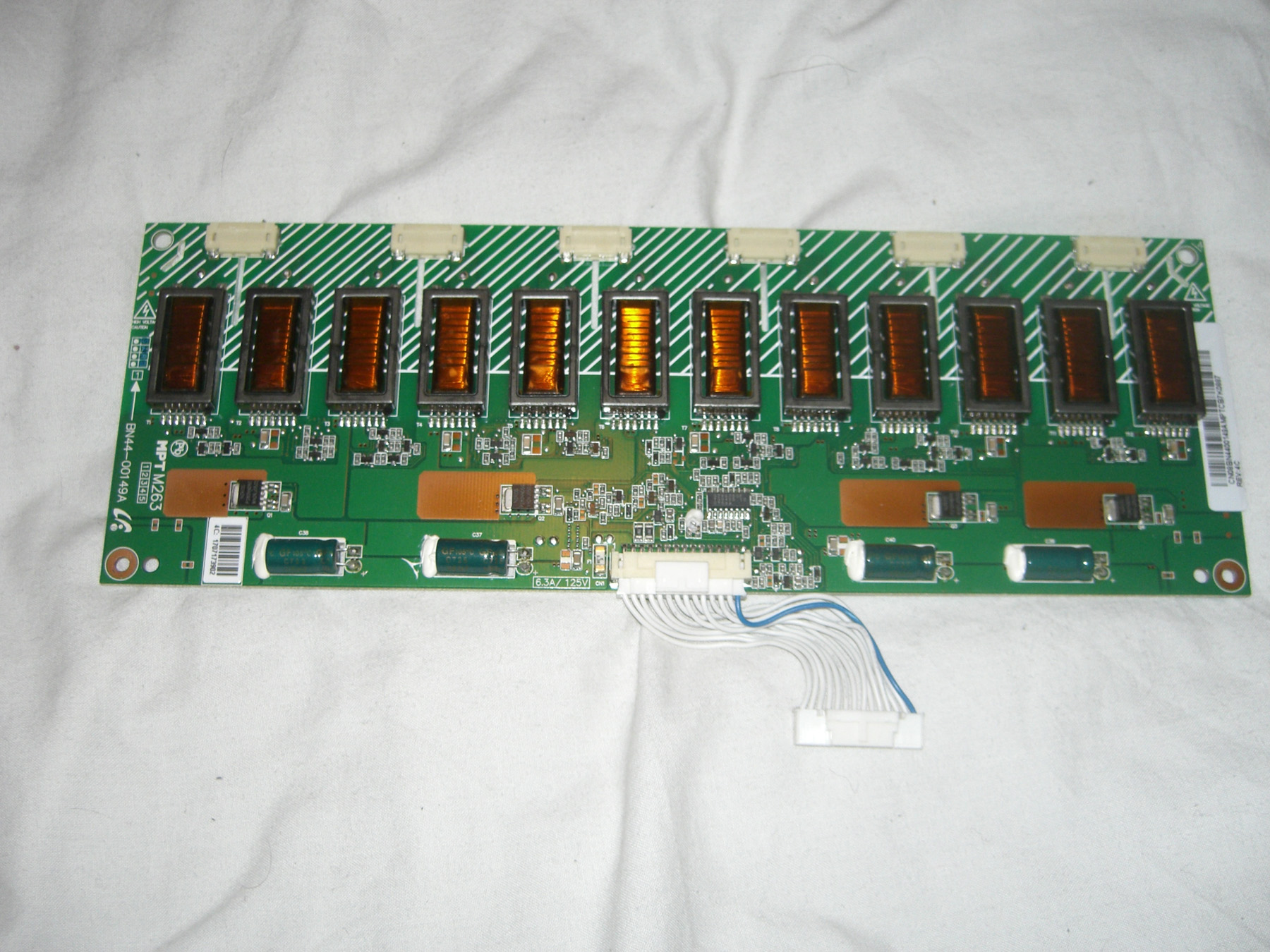

          Re: Samsung Syncmaster 245B

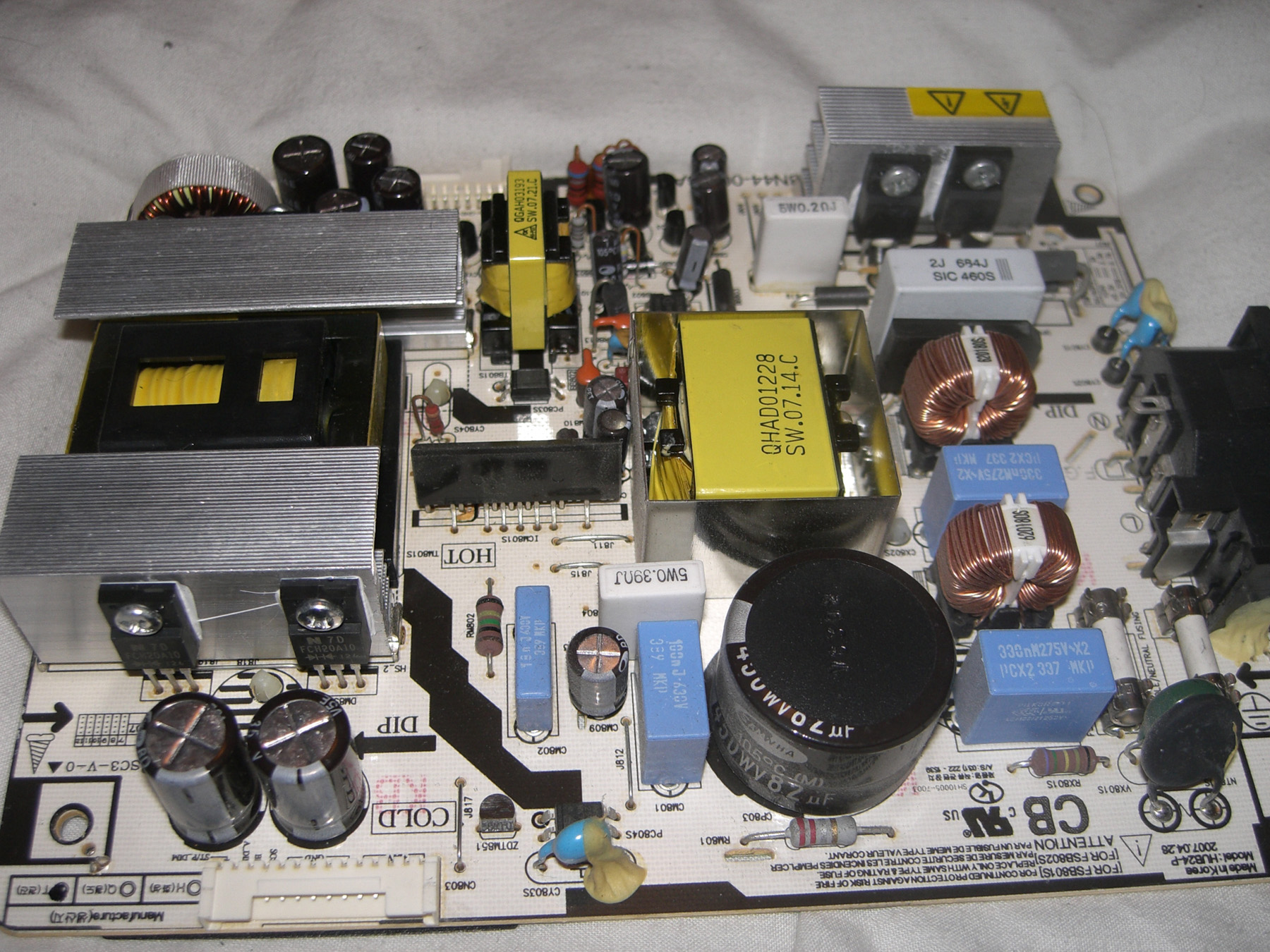

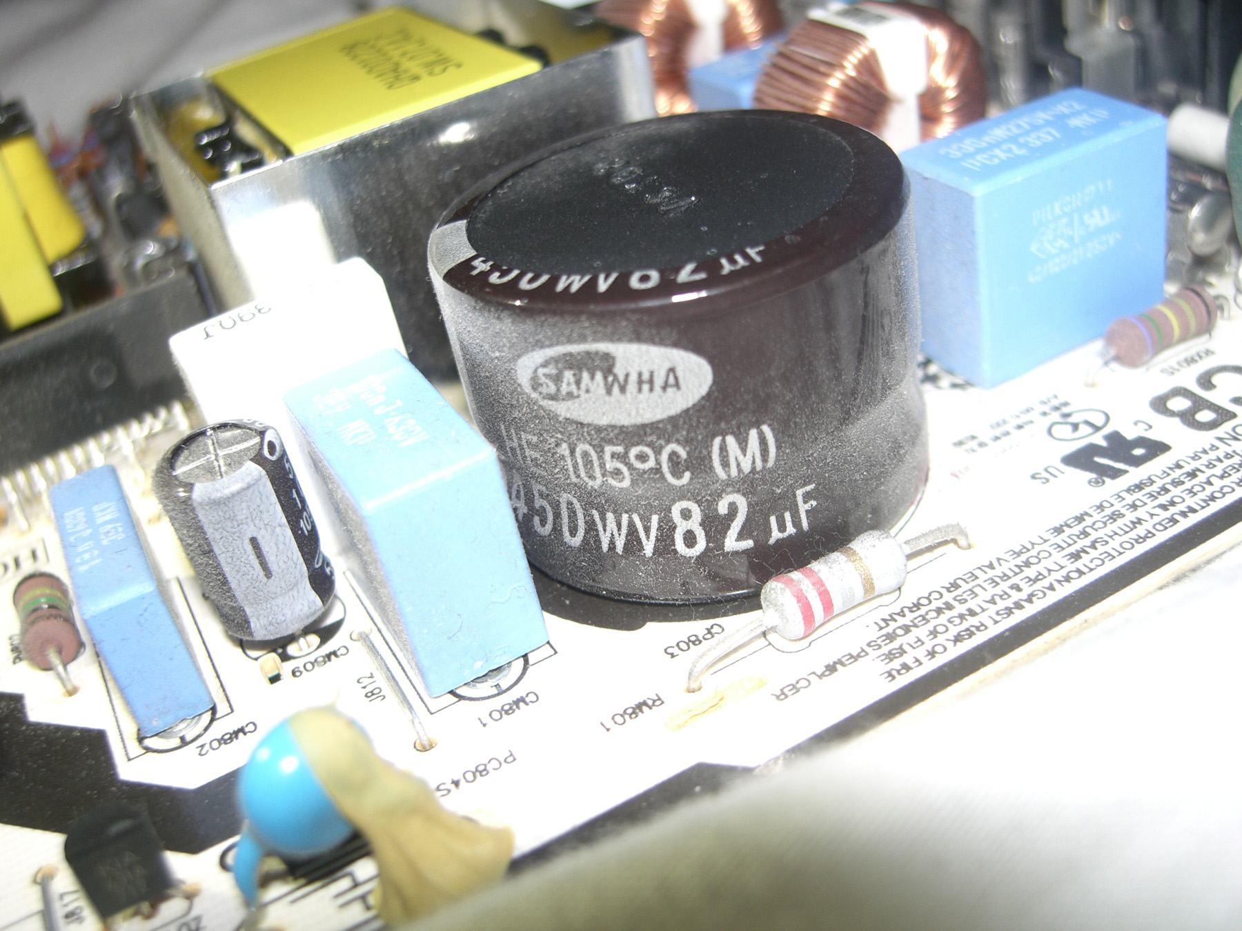

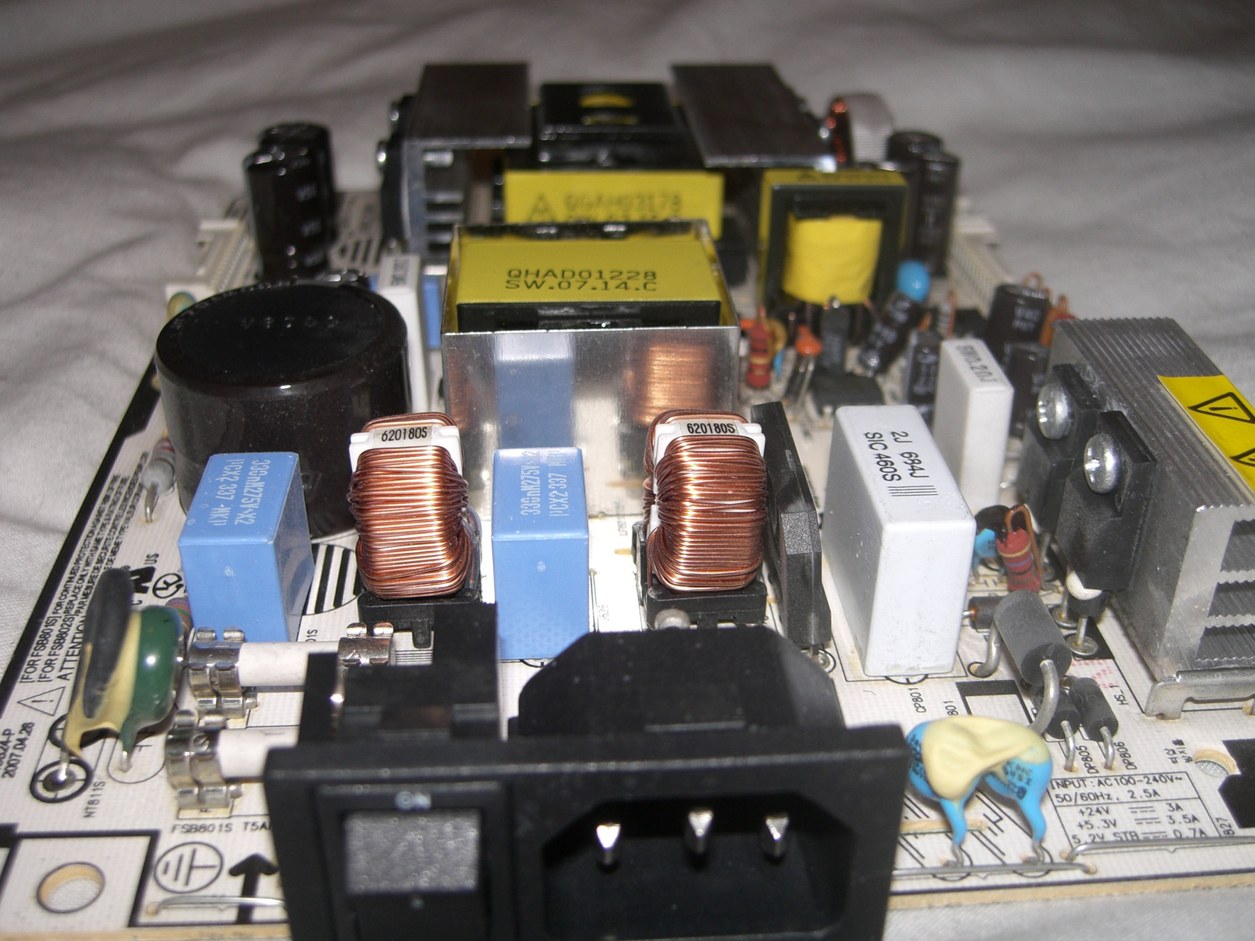

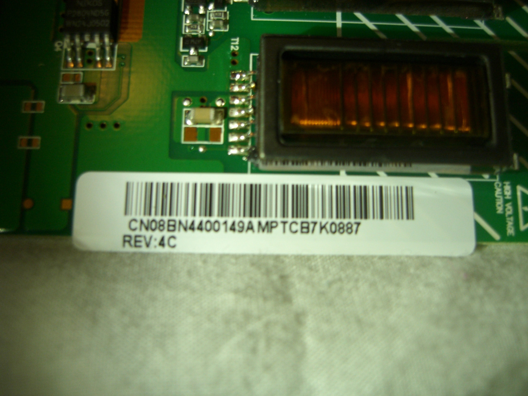

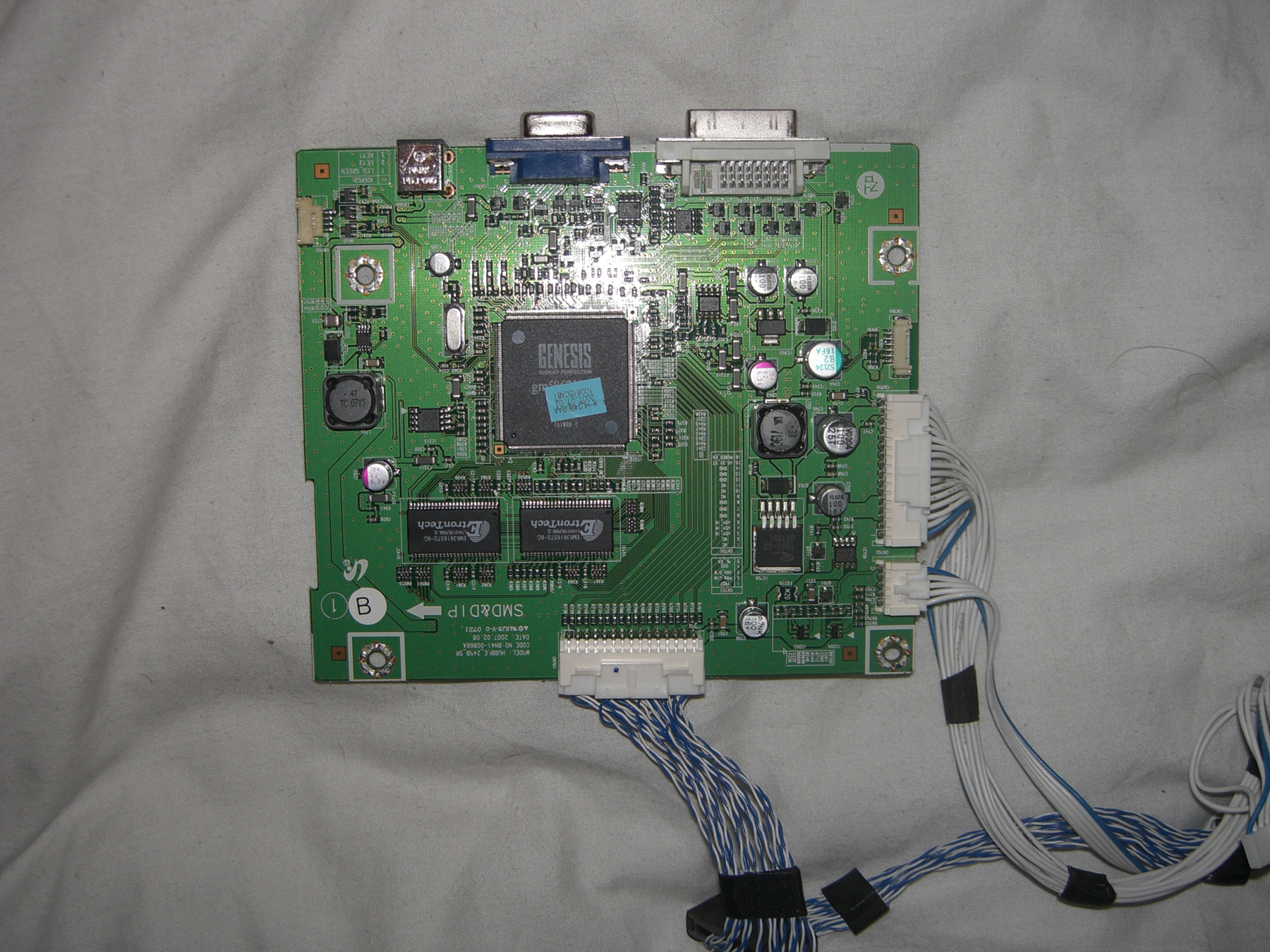

          Ok here are a few photos, wasn't really sure what was important so if you need anything else I'll grab a photo of it.
          Cheers!

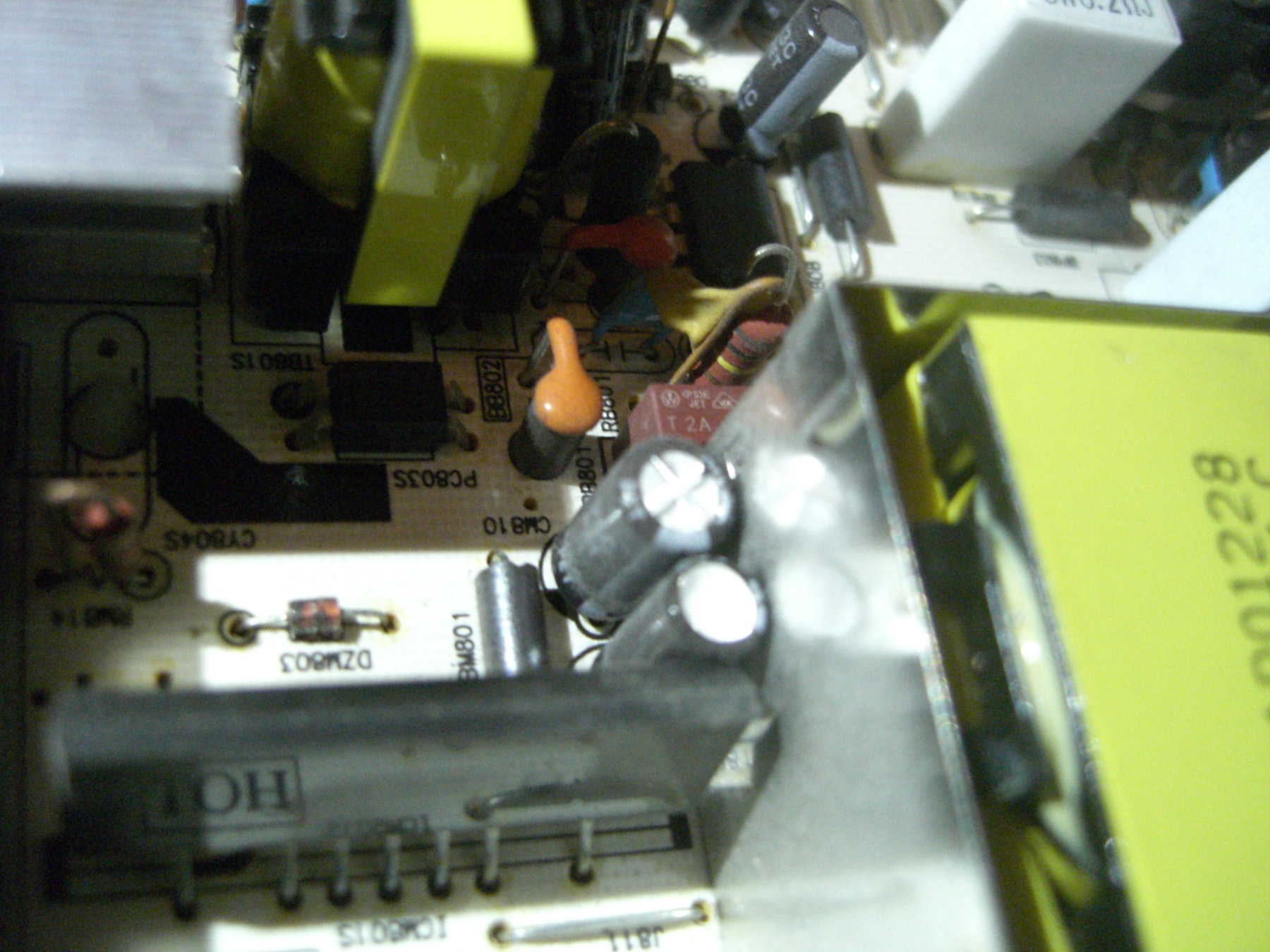

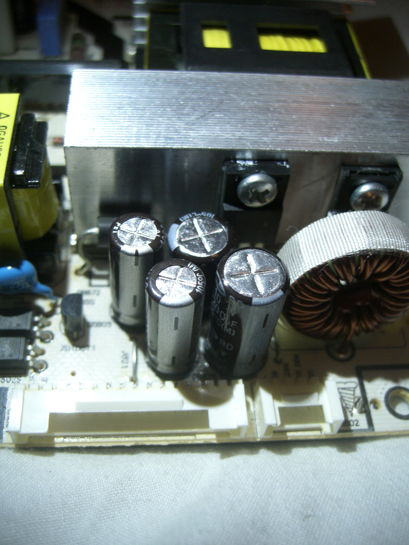

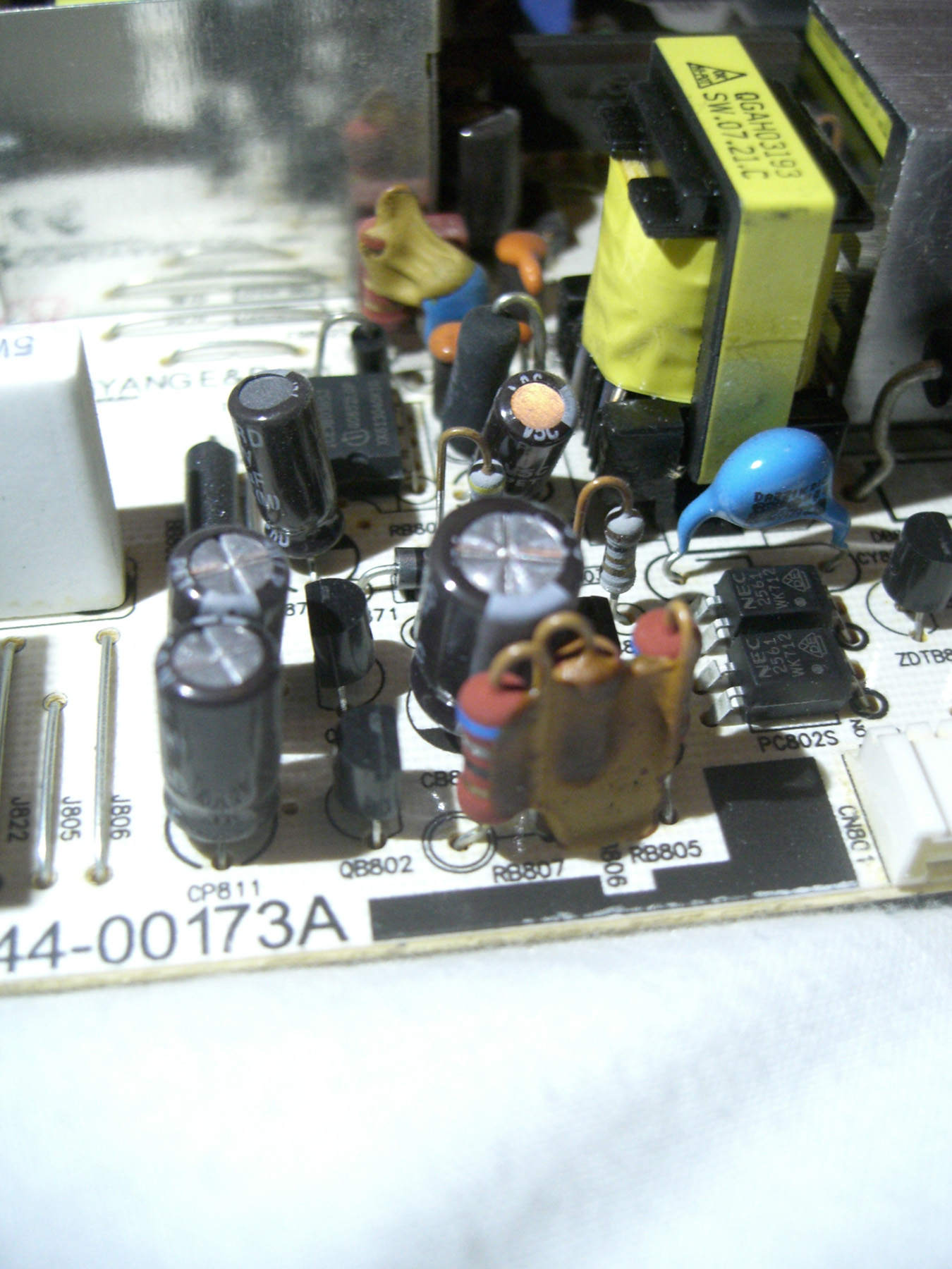

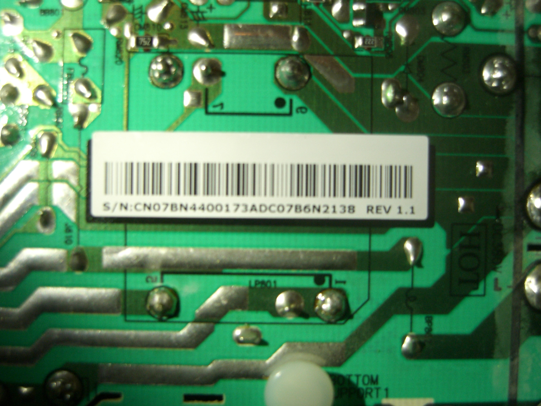

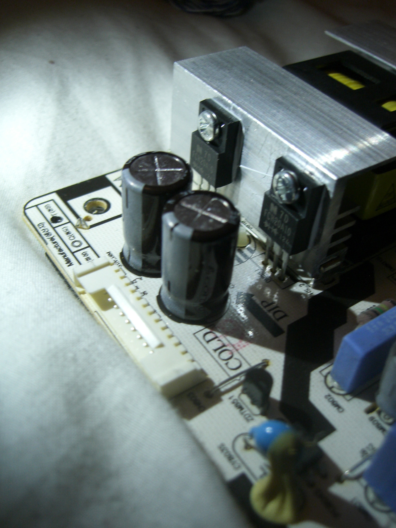

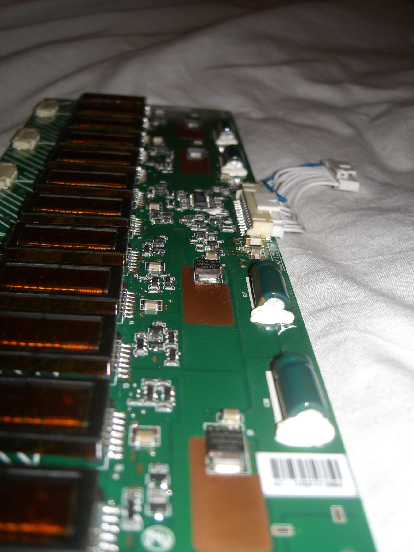

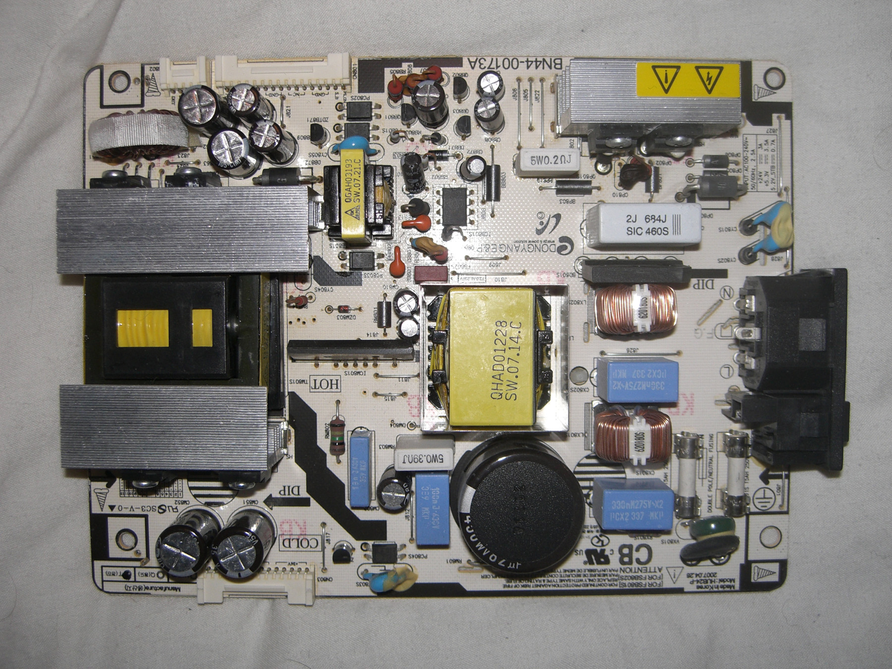

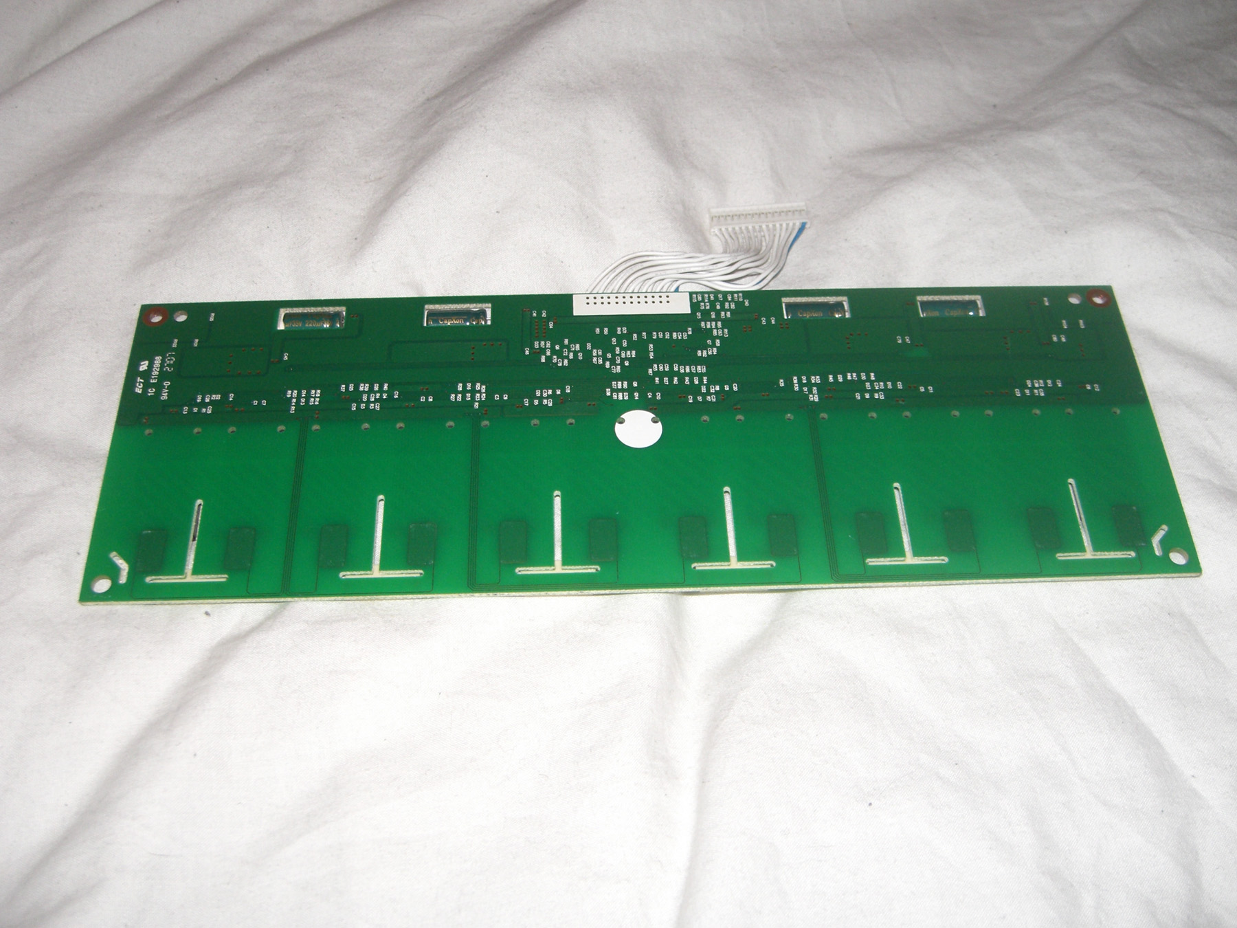

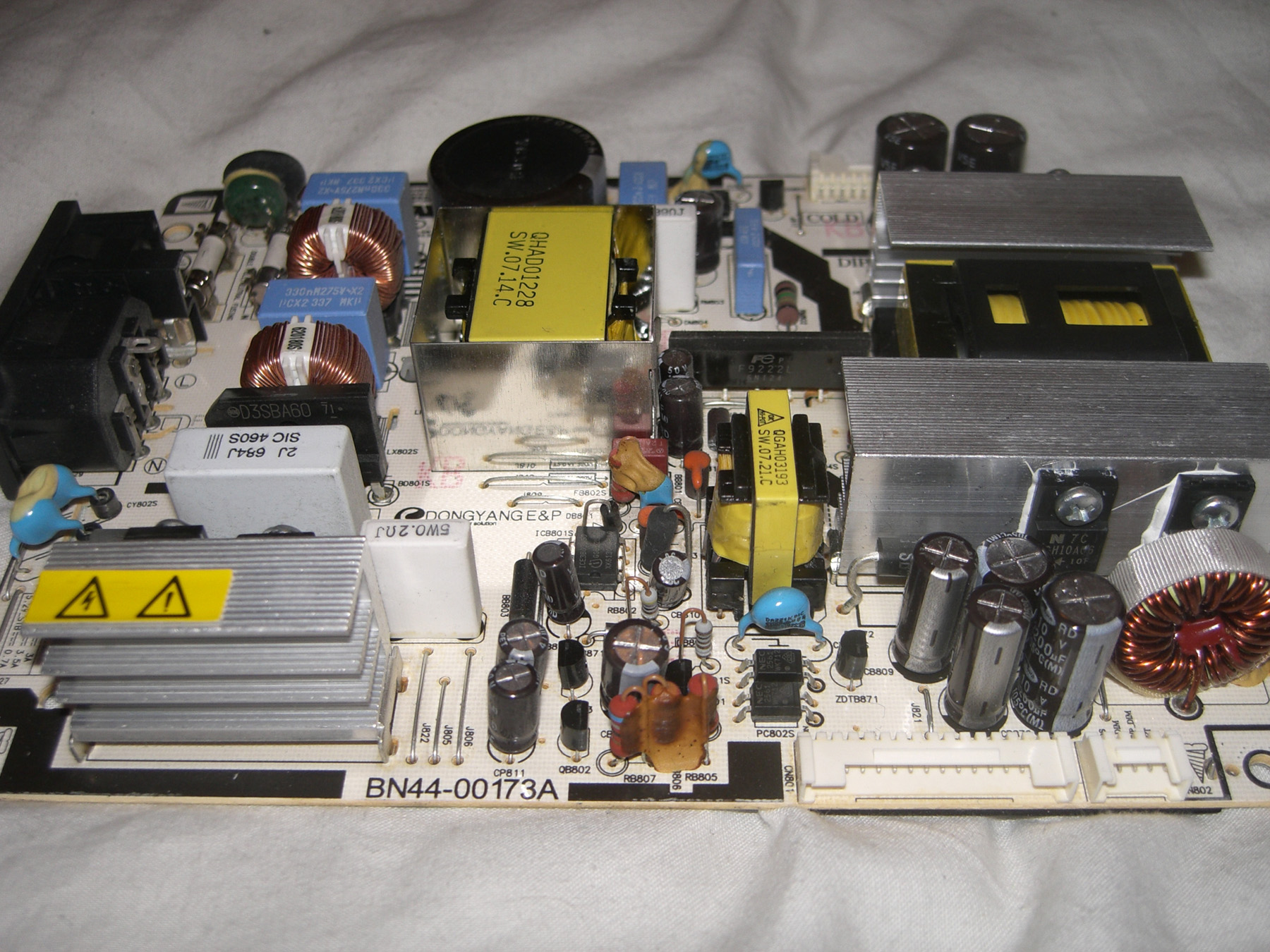

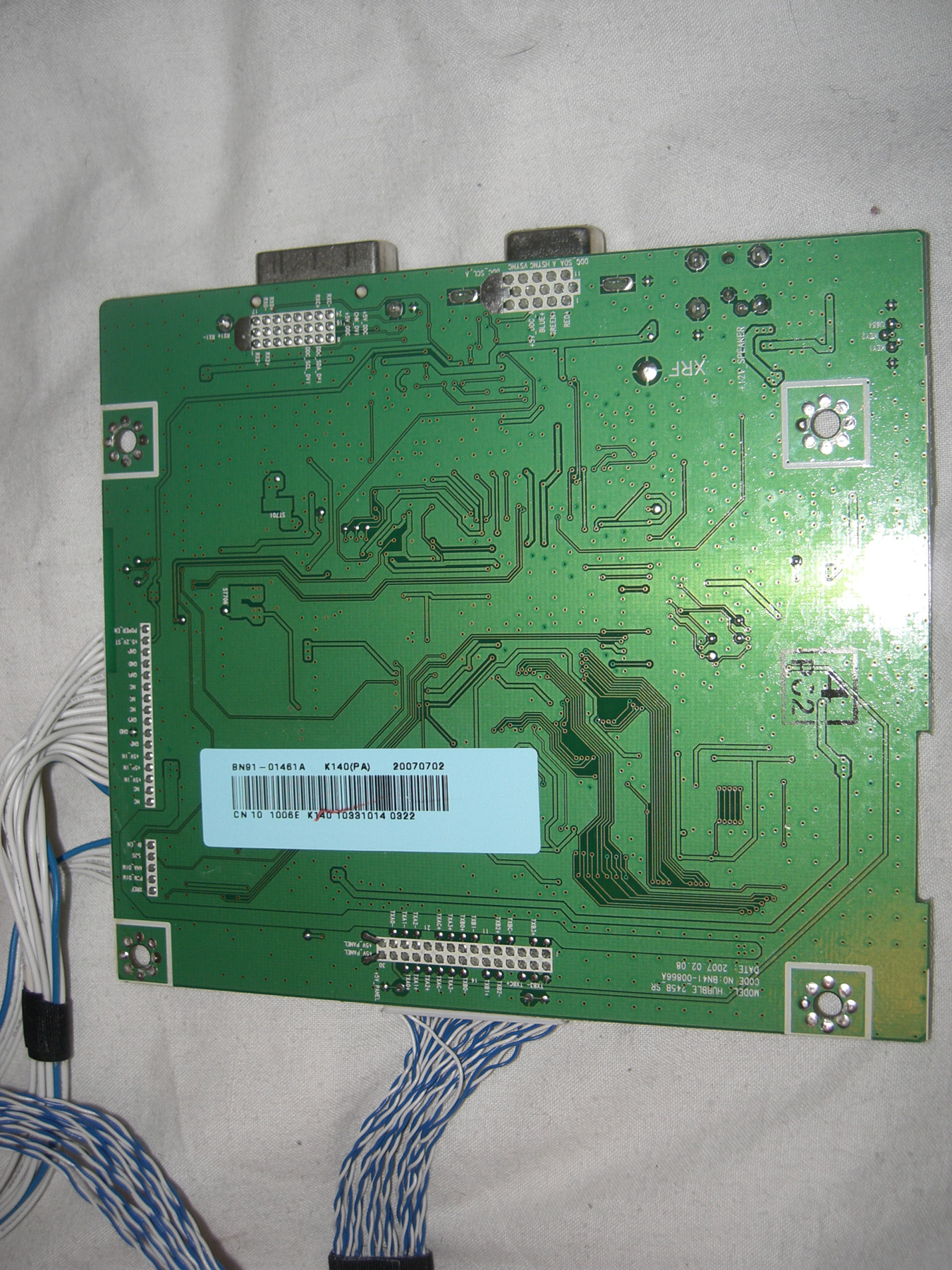

            And a few more.
              That looks like a fairly solid board so it could prove difficult to fix. You have a couple connectors on that power supply. The white ones on the edge of the board. In the pictures they are obscured by the caps, could you please list everything that's written above the connectors? That way we can give you hints on what you can check.

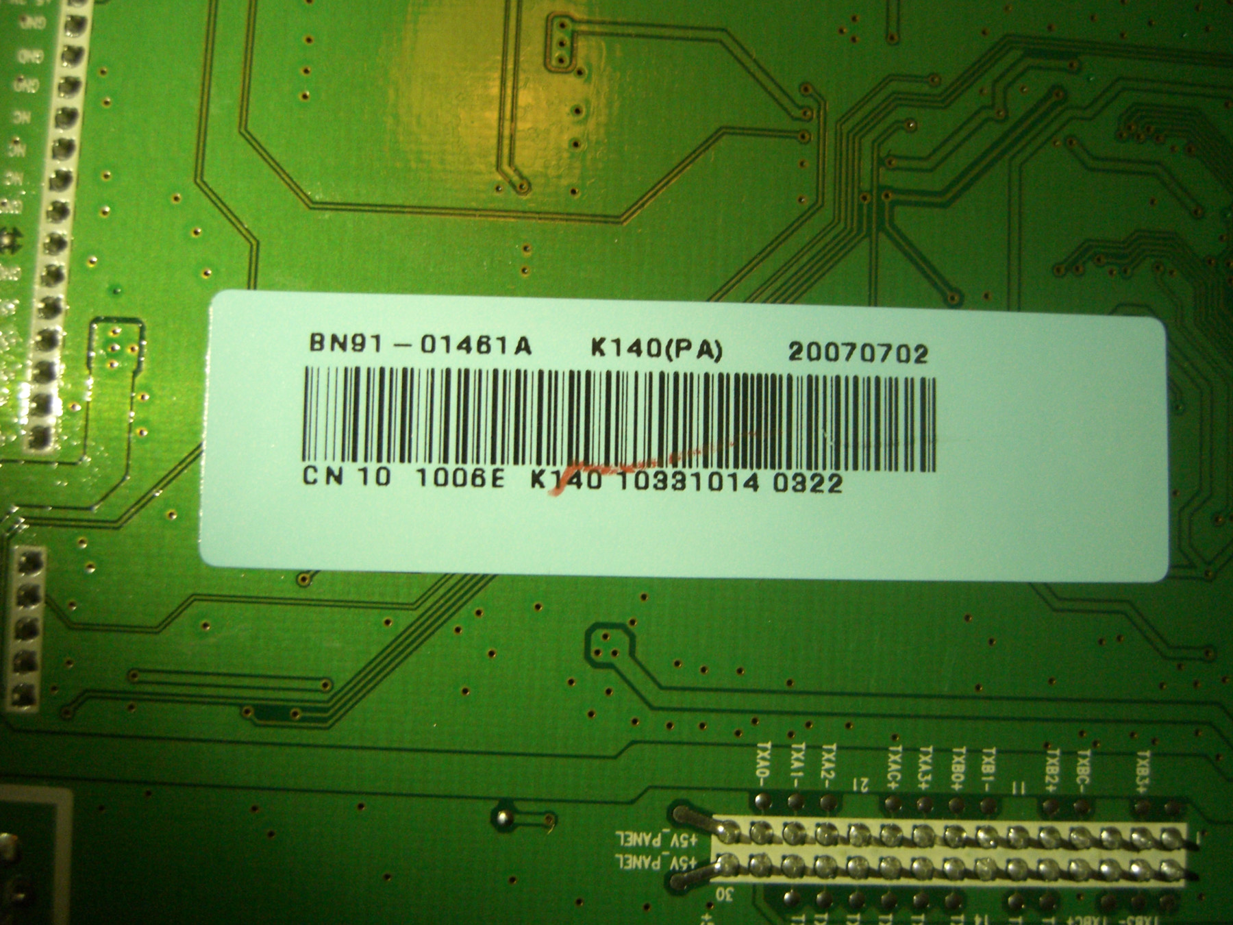

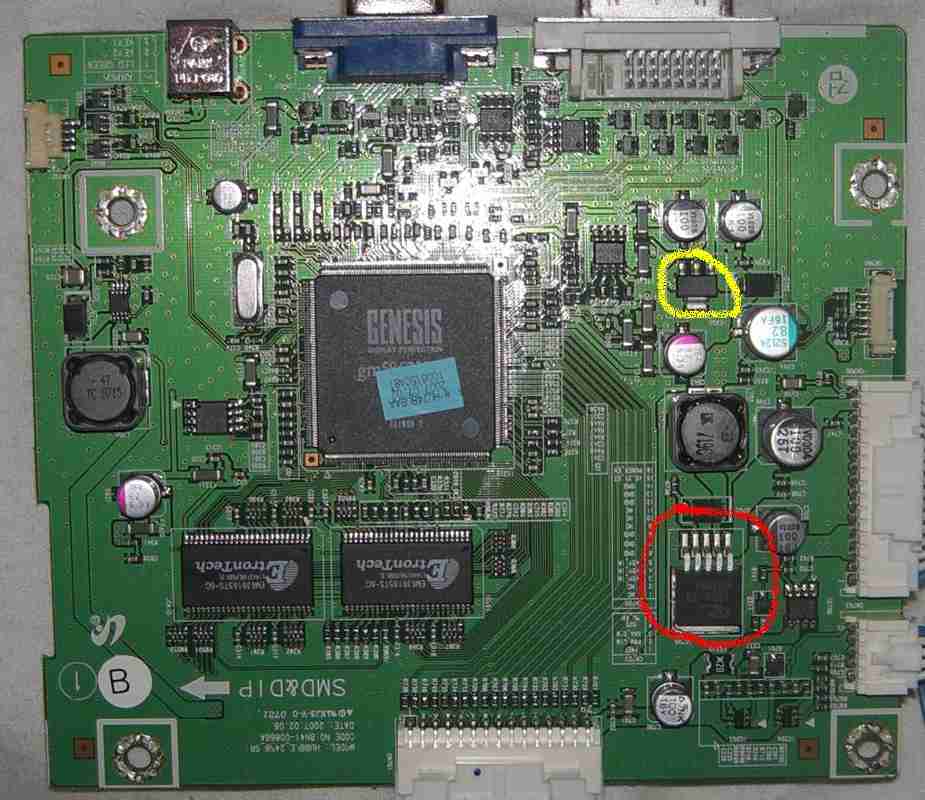

                1) See attached pic.
                2) The yellow component is a voltage regulator. The part number might be something like AS1117-18. The suffix, 18, indicates the DC output voltage.
                With power on and lcd plugged in, set your multimeter to 20V DC (if manual ranging). Use a ground screw on the logic board for your black probe. Your red probe will go on each pin (one at a time) on the voltage regulator. Report the findings.
                3) The red component is a DC/DC converter. The datasheet is at
                Refer to page 2 and see the diagram labeled TO263-5L.
                Again with your multimeter set on 20V DC and your black probe on a ground screw, put your red probe on all pins (one at a time) and report voltages.

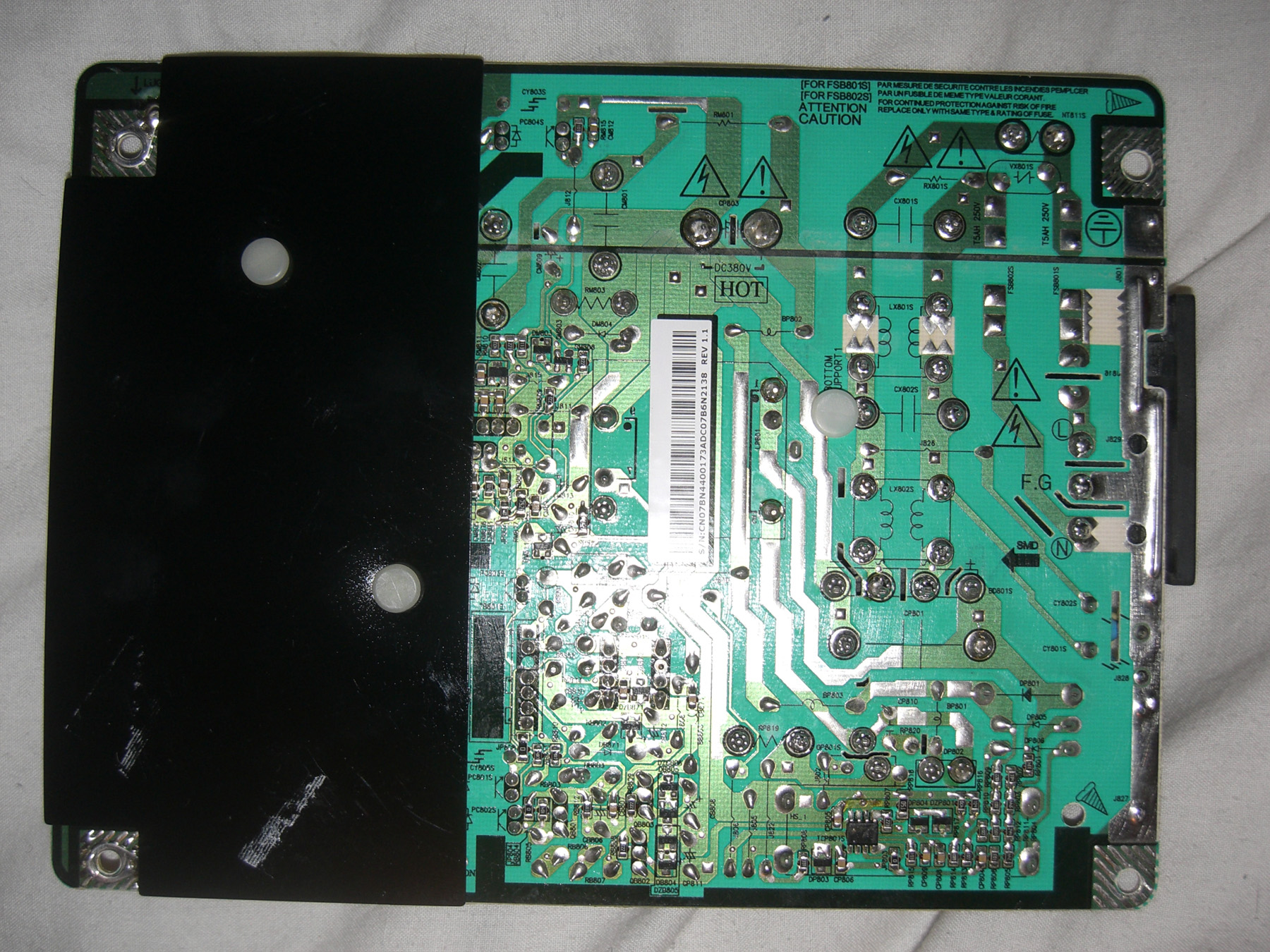

                  I'll need to pick up a multimeter (terrible I don't have one to be honest), would I need to reasemble the bulk of the monitor before attempting to measure the voltages? Anything I'd need to be careful of? Because I think the ground screw goes through the metal chassis, but it'll be impossible to get to the chip when it's attached to that.
                  Attached a diagram of the connections on the power supply board.
                    A basic 830B multimeter should suffice for now. Look for a UNI-T branded one, those are decent compared to the nonames.
                    Yes you will have to wire everything together but that doesn't mean they have to go in the same places. Put some plastic or cardboard over the back of the LCD panel and put the power supply and logic board on top of that. That way you can measure stuff without assembling the whole thing. For more complicated measurements you solder a wire to the spot then power the monitor... but at least the main connectors should be accessible without the need for such stunts. You don't have to wire the ground lead of the plug now.
                    Black lead of multimeter always goes to the nearest GND. Red lead goes to the circuit you are testing. First things to check are the voltage rails which are SB, 5.4v and 24v. SB is usually 5 volts.

                                  Ok some results! First of all I tried testing the logic board fuse, but couldn't get a stable reading at all. It seemed to constantly fluxtuate from 0 to anywhere up to 100.
                                  Next the volatage regulator on the logic board. With the pins at the top and left to right the results were: 1.8v, 0, 2.9v
                                  The DC converter: (pins at top left to right again): 0, 3.3v, 0, 3.33v, 5.2v
                                  And the power supply board:
                                  +24 = 0.03v
                                  SB = 5.23v
                                  5.4v = 0
                                  I'm guessing that's not a sign of a healthy board =/
                                      What is the part number of the voltage regulator?
                                      --- begin sig file ---
                                      --- end sig file ---
                                        Balls read the instructions and had my red and black wires plugged in the wrong way round. Touching the wires gives a result of 0.03 once it's settled down.
                                        Resistence across the fuse seems to be 0.06.
                                        The voltage regulator is: J162 953-18
