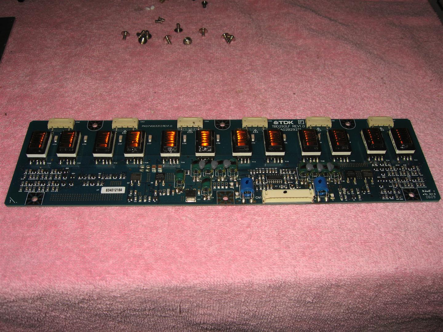

    This is my first post, after having learned (or tried to learn) much from you all. Truly a great resource and community.
    I am trying to repair an Acer AL2416w sd that would start up, show the word "ACER" then a black screen and the power light would change from green to yellow. I had no dim image using a flashlight. None of the caps on the 3 boards are domed or "look" bad.
    I followed the other threads about this monitor, and decided that, even though there was no visual evidence of failure, I would replace the caps on the power board. Lo and behold, progress! Now the power button stays green and there is a dim image when using a flashlight. So I am left with 2 possibilities (I think). The inverter board or backlight bulb(s).
    I think I am getting close to my limit on diag skills here and could use a little help determining which. It looks like there are 6 bulbs on this model. Could one bad bulb cause this? How do I test a bulb? Continuity?
    All the caps on the inverter board "look" ok. Can someone point me in the right direction? I'm not sure about the MOSFETs (or even which ones they are). Yeah, I'm a little green.
    TIA
    PS I've attached photos of the inverter board.

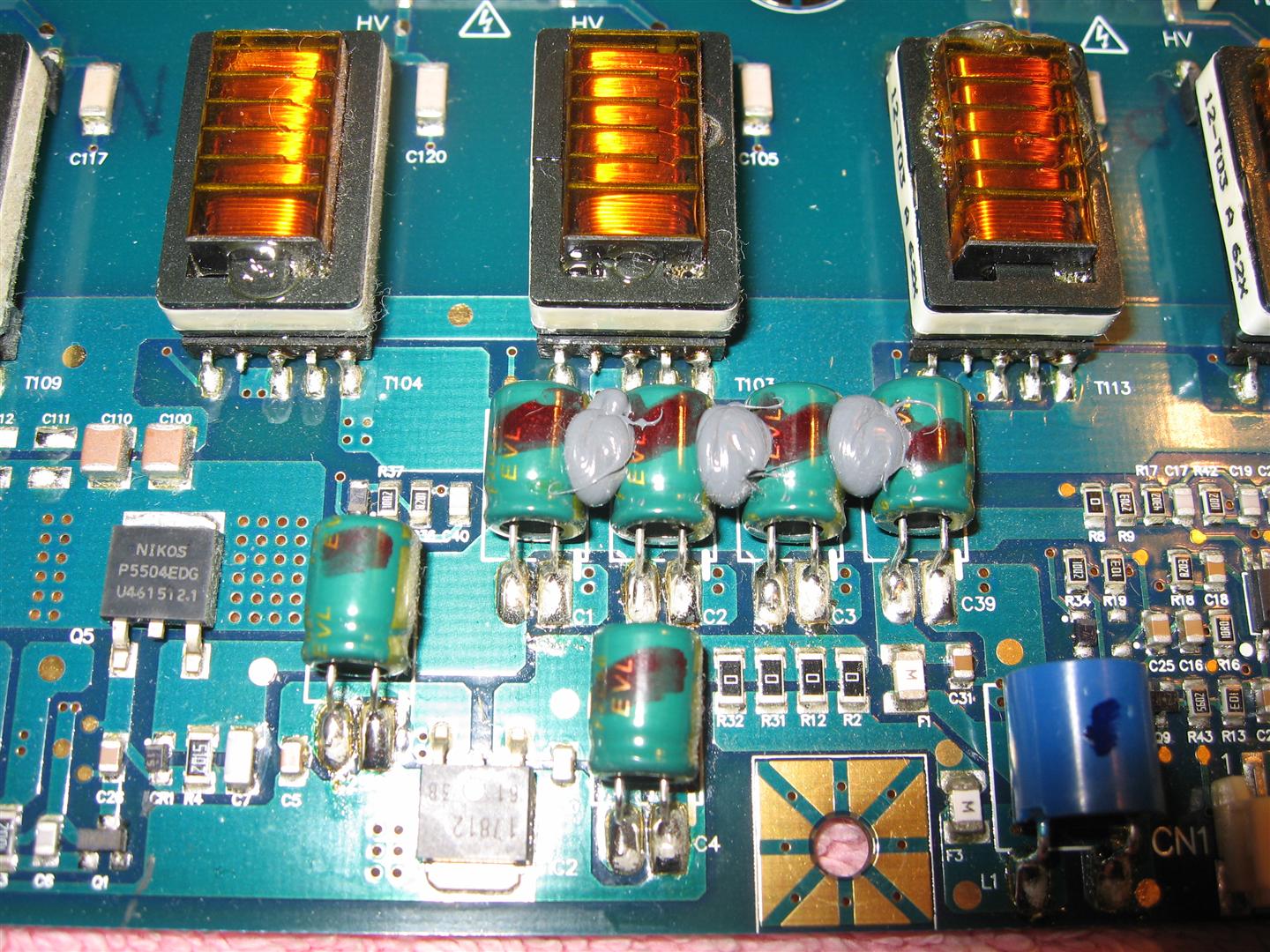

    Verify inverter is getting voltage (12-24V?) from power board.
    Check fuse F3 at the bottom of your photo.
    Check mosfet Q5 (p5504edg, should be four of these mosfets) and the 3 others for shorts.
    Also, post a good closeup of the entire inverter board.

            I agree with you that if the backlights stay running , then the mosfets are probably ok. I would suggest that you NOT try plugging the connector in while power is on, since this will cause a voltage spike which can cause severe damage to the inverter board. It almost sounds like you have a bad CCFL tube and that "jolt" in voltage is enough to cause it to turn on. Other members will probably suggest that you get hold of a good CCFL tube and substitute it one at a time with the current tubes. By doing so, once you get all the tubes to light, then you've isolated the bad tube.

                          A bad CCFL tube will be seen by the CCFL controller, which in turn will shut down the power supply. Therefore, just because you didn't see voltage at the tube connector doesn't mean the inverter is bad. So, a bad CCFL tube is still a valid possibility.

                            I ended up replacing the 8 small 35v, 100uf caps on the inverter board. Everything has been working fine since then. 30+ start-ups, from cold start to immediate reboot. Monitor works as advertised every time.
                            Thanks for all your help and input.

                              just to share, i had same issue, i replaced 4 caps of 35v 100uf 105c, and its back to life.

                                I have replaced all the 100mfd capactors and 2 mosfets as well as the fuse on the inverter board with no result. Not getting 24V from the power board. Can anyone tell me were I can get hold of a connector diagram so that I can check all the voltages. Better still a circuit of the inverter and power board.
