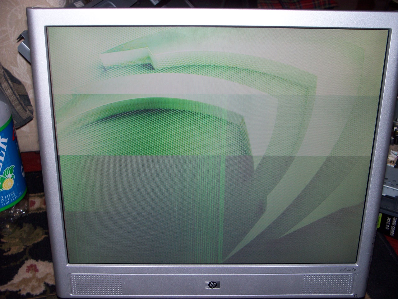

    I got this as a non-working monitor. Took it apart, didn't see any obvious damage, so I resoldered the transformer connections, and anything that looked like it might be a bad joint.
    Put it back together, and it seemed to work. When the person who owned it got it back, they reported it shut off when they touched the monitor.
    I got it back and took it apart again, and saw that the cable between the logic board and the panel was a little loose. I taped it back down with fresh tape and put it back together. Tapped and shook the case a bit and it seemed fine.
    However, after letting it sit for about 10 minutes, it started flickering and having static, white areas. Kind of blocky.
    Any suggestions on what to look for? I'll be pulling apart the monitor again tomorrow but it is probably too late tonight. I'll take pics of the board then.
    Also, I have a short (10 seconds or so) .mov video file of how it is behaving. If anybody thinks it will help, I'll post a link to it.

    Re: HP EN623AA - static /blocky white areas
    Looks like a loose LVDS cable to me (the one you've already taped down between the logic board and panel -- did you check both sides?), but it might also be a panel going bad (bonded connectors, not permanently repairable).
    Definitely post pics of the power/logic cards when you can, maybe something can be spotted that looks out of place.

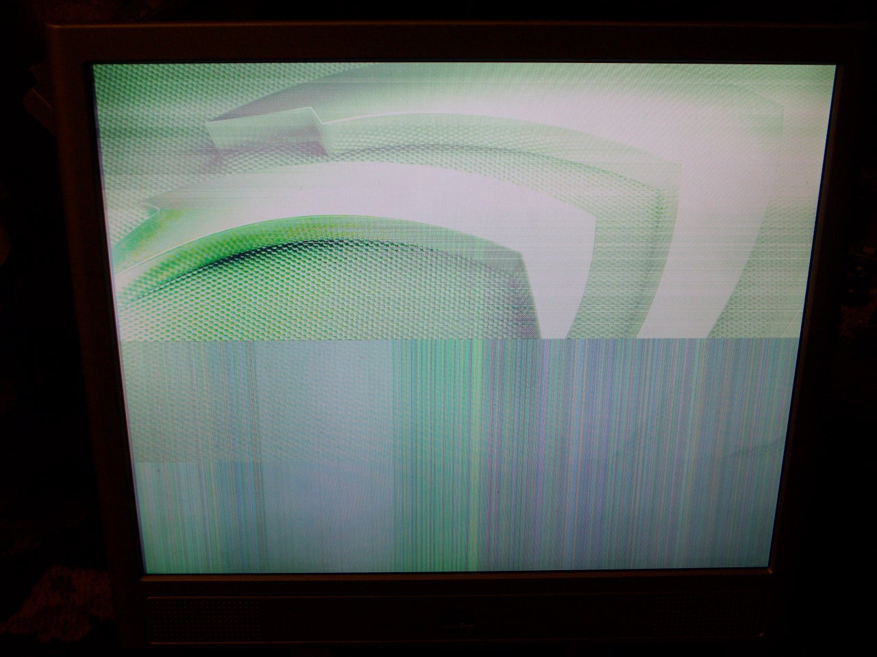

        Does it stay that way after the 10 minutes, or does it clear up after a while? Does it still have the original caps? If so, what brand/series? Possible bad caps on the logic board. Check the voltage regulator(s) output on the logic board.
          I let it run for about 4-5 minutes and no improvement. Turning it off for about 5 minutes, and back on and it is fine for another 10 minutes before the static returns.

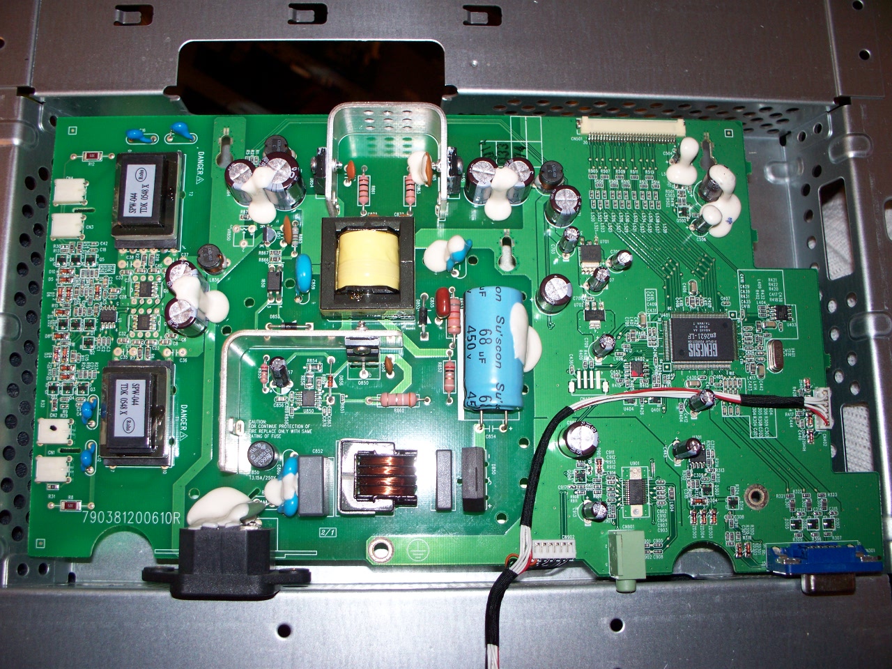

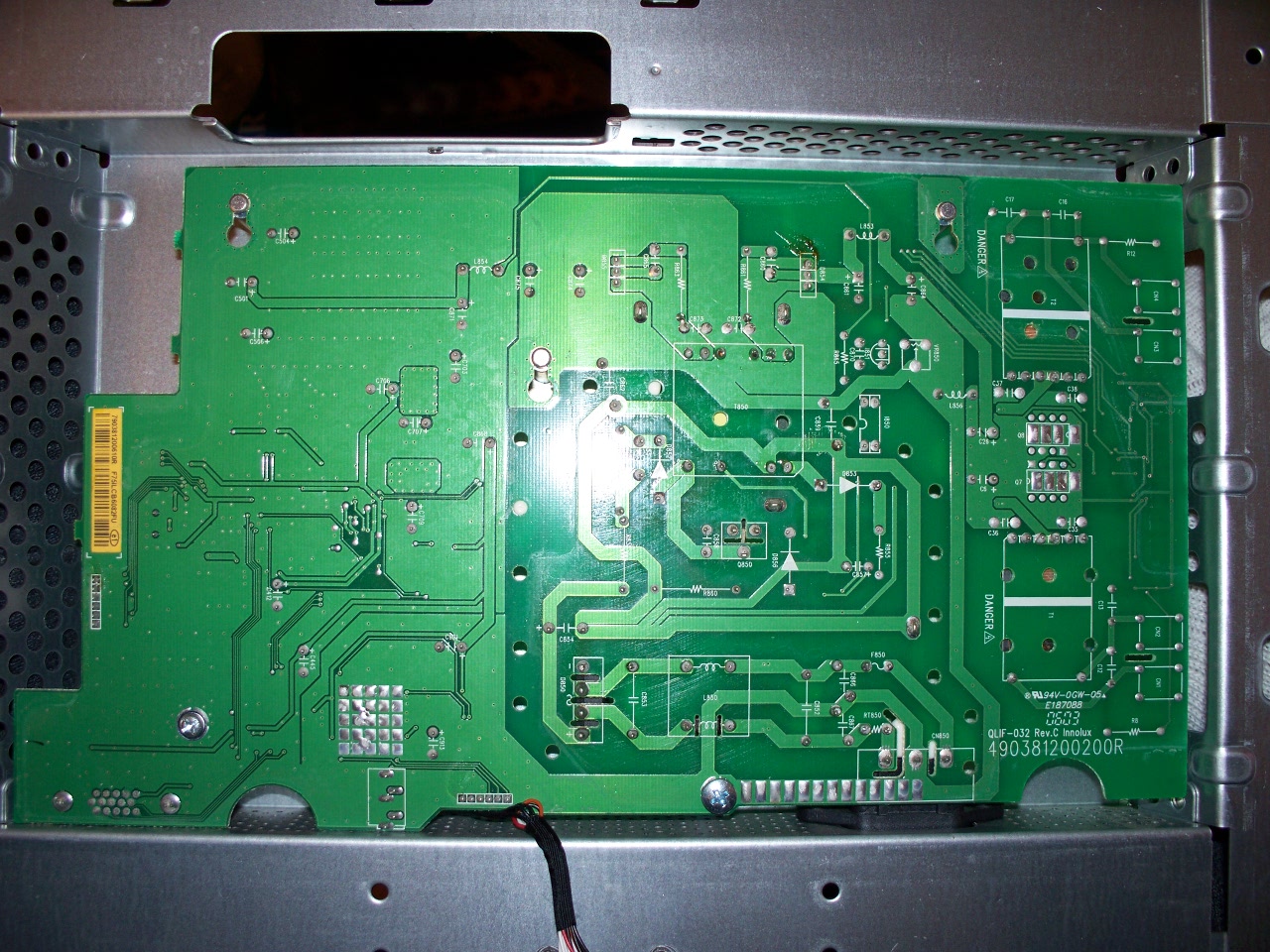

          I didn't recap the board, so it is still all the original caps.
          Ahh...what the heck. I'll pull it apart now and take pictures.
          Edit: Here they are.
            Board looks like the Dell E177FPf board at
            https://www.badcaps.net/forum/showthread.php?t=12344
              Nice photos! Interesting board with everything on one board. What brand/series caps are they? In the photo, I circled what I believe are the voltage regulators. What are their part numbers? Oh yeah, get some sleep and do this tomorrow.

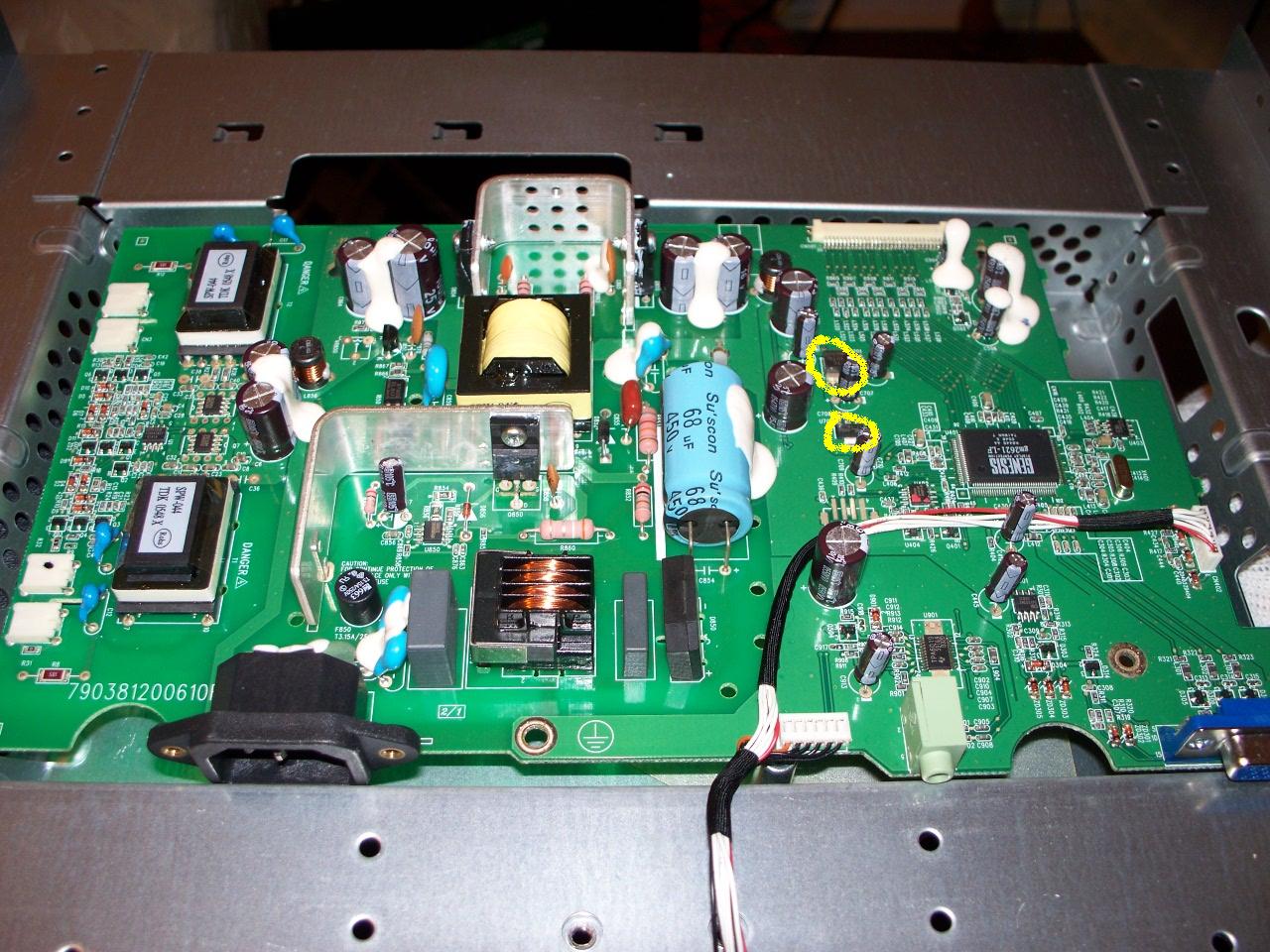

                They appear to all be Su'scon SG series caps.
                One of the voltage regulators (the larger one) is a 1117 (LD1117AL 33AGFSL06) part number. And I know the 33 inidicates a 3.3V. The other one is (logo AC) 6A2L 17-18L
                Edit - Here are the caps:
                1 1000uf - 25V 13mm
                2 1000uf - 10V 10mm
                3 680uf - 16V 10mm
                3 470uf - 25V 10mm
                1 470uf - 10v 8mm
                3 100uf - 16v 5mm
                6 47uf - 15v 5mm
                1 10uf - 50v 5mm
                And it looks like the board was designed for larger cans on most of the caps based on print size and wider lead hole spacing. Looks like the 8mm cap location can fit a 10mm cap. And most of the 5mm caps can fit 8mm caps.
                Plenty of height.
                So, keeping in the Panasonic FM / FC range, as long as the uf - volts - 105°C temp specs are kept the same, I'd be ok with going with the larger can sizes if available?
                I do have some 680uf and I think some 100uf caps on hand. I'll swap those out now.

                            1) Sounds like it might be a thermal problem. Try heating up parts of the board with a blow dryer to see if you can accelerate the problem.
                            2) Once the the display goes bad, measure the input and output voltages of the 1.8 and 3.3 voltage regulators.
