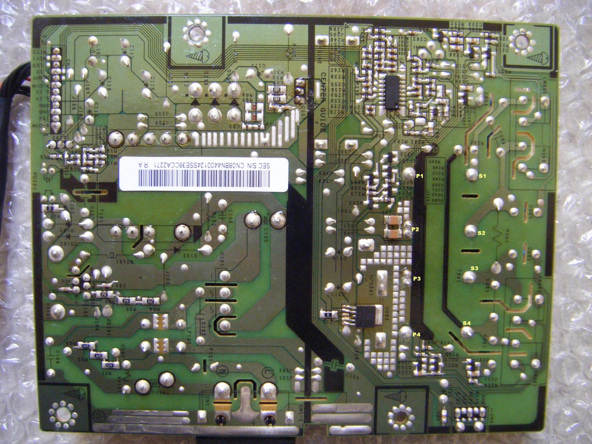

    Symptom/Problem
    -2sec to black. Image visible if using torch light.
    -If i leave the monitor on longer, 20 sec later the backlight will lit up again for about 2sec... then off.
    -Power LED steady blue
    Description/what's been done.. or not
    - Age around 2-3years, But it is an export set so no warranty.
    - No schematics at hand
    - Have not replaced all caps because they all 'look' to be super fine. But will replace them if advised to do so.
    - Use another panel (my 'dead' HP f1905 and working hp w20) to test ccfl (subtitute them one at a time or all at once), but still 2sec to black result.
    Unplugged & measured resistances
    - no short in between pins of D101(in circuit) & D107 (out of circuit)
    - U201 BD9893F Pin 16 (Vcc) not shorted to Pin 6 (Gnd)
    - on T301 (in-circuit)
    : P1 =open to all
    : P2 =1.2ohms to P3, increasing to P4, open to the rest,
    : P3 =1.2ohms to P2, increasing to P4, open to the rest,
    : P4 =increasing until max to P2, P3
    : S1 to S2 =897ohms,
    : S3 to S4 =initially 1500-1520ohms but drops to 943ohms after re-testing it again & again
    : S1&S2 to S3&S4 = 191k ohms
    Plugged & measured Voltages = backlight on (off)
    - across Big cap = 330V (330V)
    - CN2
    13V = 12.2V (14.19) both unstable
    5V = 5.2V (5.21V) both stable
    3V = 3.27 (3.27) both stable
    - U201 BD9893F
    Pin 16 (VCC) = 11.01 (10.9)
    Pin 9 (Comp) = 0.61 (0.51)
    - on T301
    : S1 & S2 - Over volt (almost busted my DMM again)
    : S3 & S4 - 6.2-6.5V?!!
    So 1 side of the transformer is reading less voltage than the other.. So is this transformer faulty & need to be replaced?.
    Or are there other components or test points that i missed out?..
    Am i troubleshooting it correctly?..
    Hope the experts here can guide me along.. again thanks..

    Hello! I'm guessing that U202 is a duo mosfet (?) that is used to drive the inverter transformer. Try checking it for shorts.
    Don't try measuring the inverter voltage output (approx 700-900VAC).
    Odd transformer readings. You may have to remove it from the board and retest S1&S2, S3&S4.

        Like jetadm123 said, don't try measuring the voltage. 700V AC can do more than just damage your multimeter. You could be on the floor hoping someone calls 911.
        On the 13V rail, please clarify what you mean by unstable? Does the voltage drop steadily or flucutate all over the place? What caps are on the 13V rail? They should be the caps that are rated 25V and higher.

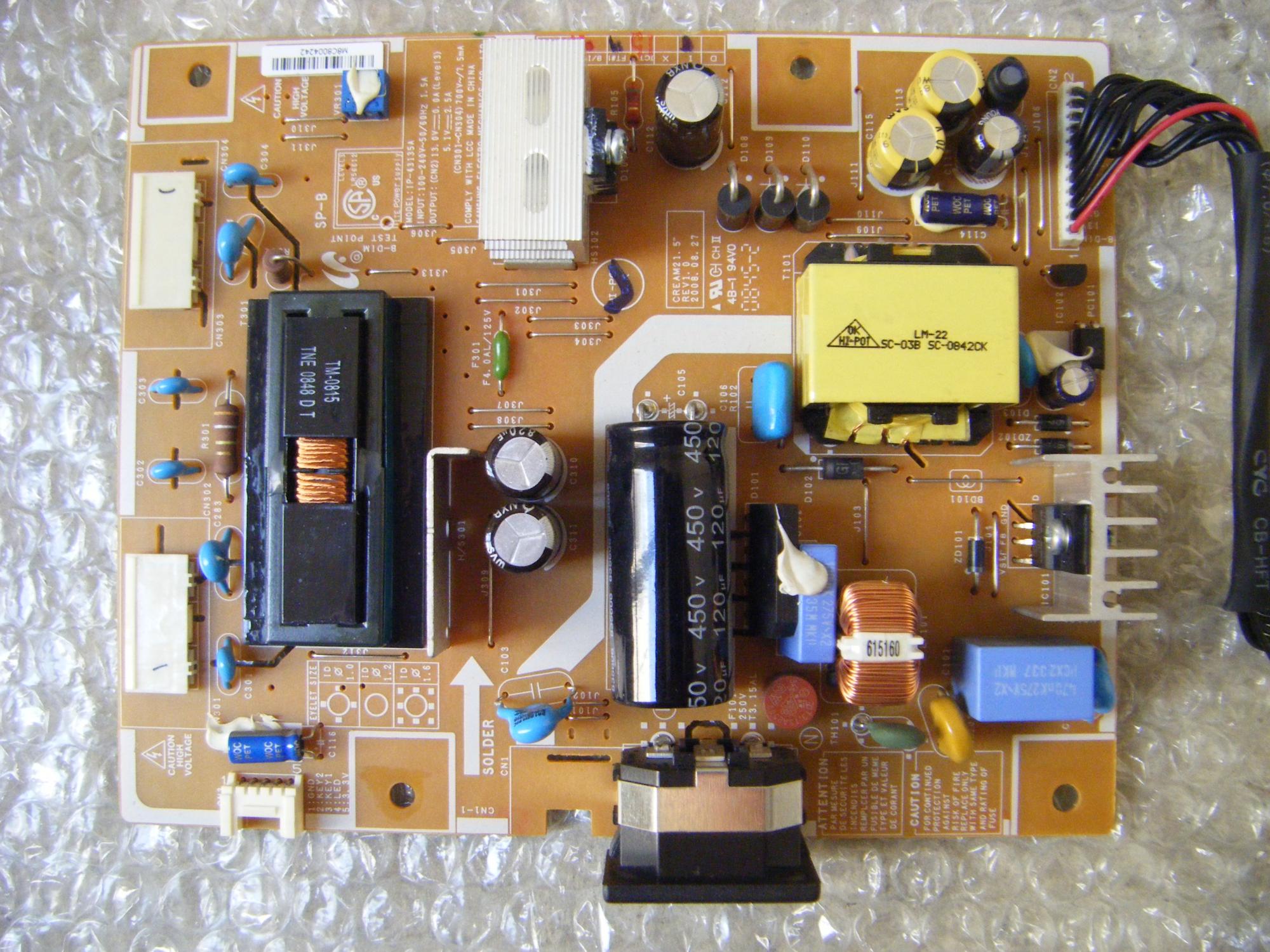

                For the 13V, what i mean by unstable is that at backlight on, it reads 12.2V but when off it fluctuates between 14.19-14.90V. Not forgetting the caps, I have labelled the top side pix (thanks for the compliment, takes me a hell lot of hours waiting for the right sunshine angle to take them), kindly see below
                Cap A - don't know what brand, dark blue color, what i can see is W0C PET, rating hidden below, 4x11 (estimated mm as i am using ruler, not calliper)
                Cap B - Samyoung, NXB 330uf 10V, 7x10
                Cap C - Samyoung, NXH 1000uf 10V, 10x12
                Cap D - Samyoung, NXB 820uf 25V, 10x20
                Cap E - don't know what brand, dark blue color, what i can see is WF W9C PET, 47uf 50V, 6x10
                add: oops i just noticed while typing that i missed C116, i think its the same size with C114 (Cap A) but light blue in color.
                * PlainBill, thanks for sharing the information on the caps.. $0.10 certainly wouldn't justify cracking open the LCD again.. better be safe, rather than.... having my fingernails bruised again..
                Next, I should be de-soldering the transfomer & measure resistance again right?. What kind of resistance you guys suspect I should be getting?..

                    With LCD plugged in and power OFF, measure the diode (just next to R105) for DC V. The middle pin should be where the red probe goes and a ground screw for the black probe. It should read a steady 14.xy DC V.
                    If it is steady, I suggest replacing the 820uF 25V caps to see if that solves the problem. As a test, you can use anything handy if you don't have the proper low ESR caps. Even 1000uF 25V as a temp test should work? You cn replace them 1 at a time or all 3. I would do 1 at a time, but that is me trying to find "root" cause.
                    My suspicion is that 12.2V is too low.
                    If that works, replace all the caps afterwards.

                      Definitely desolder the transformer and measure the secondaries. I would expect something in the 890-920 ohm range and both windings match to within 3%.
                      Several people have mentioned that the backlights coming back on after the 'two seconds to black' is unusual. One possibile explanation is the BD9893F contains an over-temperature shut down circuit.

                          I have noticed in other Monitors where there are Diodes in the Main Tmfr secondary,and not just Schottky diodes,to produce the 5v and 12v etc etc, that without a load the voltage does look unstable, but is fine on load.I would not concern myself with that at the moment.

                            this is what i can afford to update as of now,
                            *Al, nope. I did try to leave it for about 1 min but it did the 2sec-to-black twice only.. One during start-up & the second one 20sec later.. After that couldn't detect anymore 2sec-to-black..
                            * retiredcaps & POM_MJ ('sawadee krap', fellow Asian), I manage to swap the three caps 820uf 25v (one at a time) with three caps 1000uf 25V Panasonic FM (12.5x20mm) & here are the result of the voltage measurement taken at middle pin of the diode (D107)
                            [backlight on > backlight off-power led on > all off but power plugged]
                            = 1st cap changed - 12.2V > 14.18V > 13.43V
                            = 2nd & 3rd cap changed - same as above
                            FYI, i did further measure some other points near the secondaries (see attached), hope i did the right thing
                            [backlight on > backlight off-power led on]
                            V1 = 3.7V > 0V
                            V2, V3, V4,V5 = 0V > 0V
                            V6 = 0V! > 0V
                            I am a bit puzzled by this, why V6 is not reading the same as V1?.. hhmm.. Is it indicating transformer problem or circuit on that side of the transformer?..
                            *Rtech, thanks for sharing.. i think swapping caps still gives me 12.2V at backlight on, which i kinda belief caps are not causing this problem.. anyway, if you guys think otherwise, i am open to all ideas..
                            *PlainBill, sorry i could not desolder & measure the transformer yet,, The 'Queen' is having her shopping session & i'm stuck with my little rascals at home.. ..I will try to do it in a few hours time..
                              = 2nd & 3rd cap changed - same as above ...
                              Yes, 'Sawasdee Krab' is greeting in Thai language.
                              While [backlight on] and you've got 12.2V, the temp. of D107 is just warm or too hot?
                              if it too hot, maybe voltage drop by overload in your CCFLs drive circuit.
                              if not, the 13.8V supply has defected somewhere.
                              just guess.
                                V1 = 3.7V > 0V
                                V6 = 0V! > 0V
                                Just to add, I did swap the pair of CCFL connectors but voltage readings on V1 to V7 are the same.

                                  Re: Samsung 2233sw '2sec to black'. Need guidance please.
                                  just guess.
                                  thanks.. I did not notice earlier & now I have already de-soldered the transformer.. Maybe later once I have re-assembled, i take note of it..

                                    Ok managed to re-soldered the transformer & measure the resistance
                                    - on T301 (out-of-circuit)
                                    : P1 = open to all
                                    : P2 = 0.3ohms to P3, open to the rest,
                                    : P3 = 0.3ohms to P3, open to the rest,
                                    : P4 = open to all
                                    : S1 to S2 = 904ohms,
                                    : S3 to S4 = 981ohms
                                    comparing to T301 (in-circuit)
                                    : P1 =open to all
                                    : P4 =increasing to P2, P3
                                    Any thoughts?
                                    So currently, on the board now are the replaced 13V caps (820uf) with 1000uf and it is without Transformer T301..

                                      Looks to be a greater than 3% difference between S1&S2, S3&S4. Suggest you start looking for a new inverter transformer.
