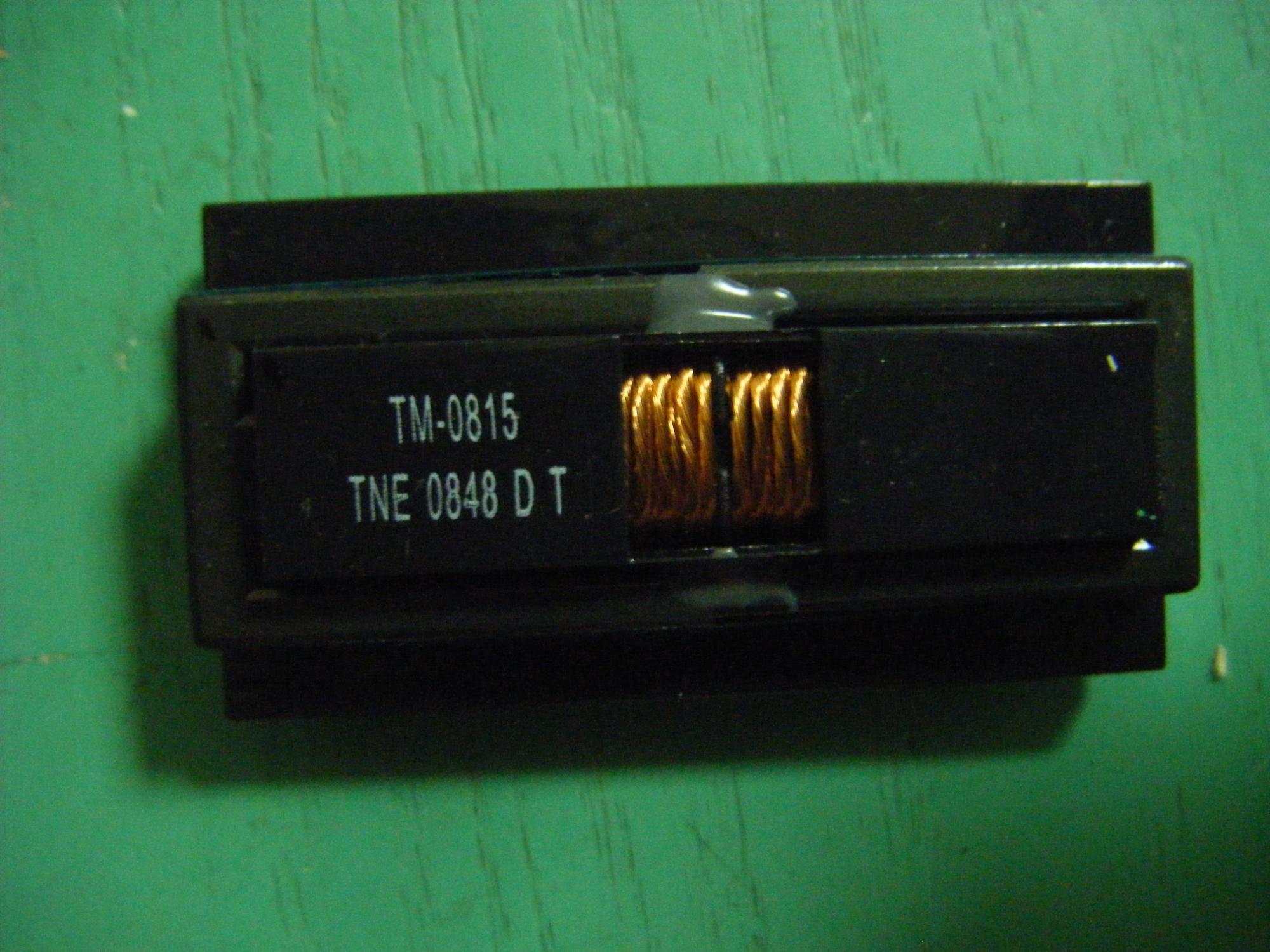

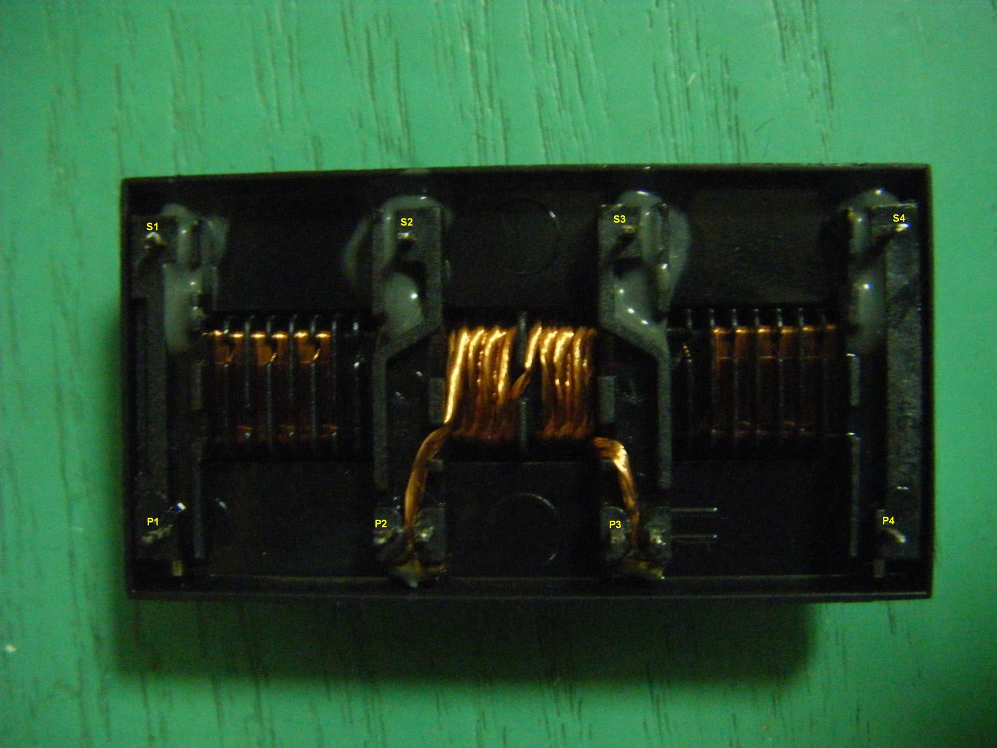

    Unplugged & measured resistances
    - no short in between pins of D101(in circuit) & D107 (out of circuit)
    - U201 BD9893F Pin 16 (Vcc) not shorted to Pin 6 (Gnd)
    - on T301 (in-circuit)
    : P1 =open to all
    : P2 =1.2ohms to P3, increasing to P4, open to the rest,
    : P3 =1.2ohms to P2, increasing to P4, open to the rest,
    : P4 =increasing until max to P2, P3
    : S1 to S2 =897ohms,
    : S3 to S4 =initially 1500-1520ohms but drops to 943ohms after re-testing it again & again
    : S1&S2 to S3&S4 = 191k ohms

    Hello! I'm guessing that U202 is a duo mosfet (?) that is used to drive the inverter transformer. Try checking it for shorts.
    Don't try measuring the inverter voltage output (approx 700-900VAC).
    Odd transformer readings. You may have to remove it from the board and retest S1&S2, S3&S4.

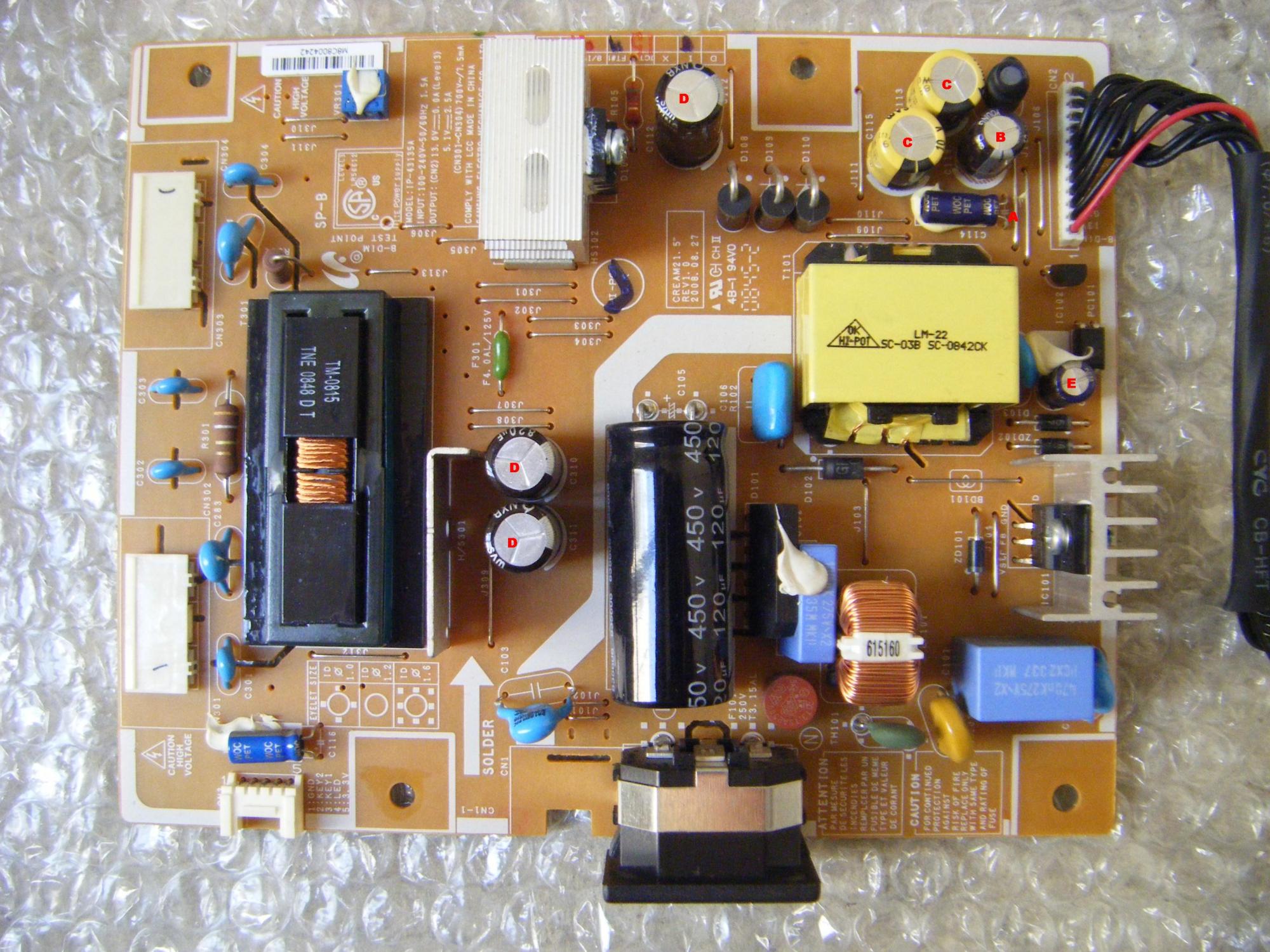

      - Use another panel (my 'dead' HP f1905 and working hp w20) to test ccfl
      so you're sayign you HAVE done this? just clarifying.
      also, what brand(s) are those caps. those yellow guys (or gals) look an awful lot like the "yc" and identical "fuhjyyus" (so same copmany i guess) that were completely bad. thanks...
      and yes if they are a crap brand i may have you replace the m
        Odd that it jumps and then settles.

                hey guys, thanks for all your inputs. I will try to clarify/answer all the queries here. If I am not clear enough in my explanation or missout something, do ask more..
                * CCFL - yes, shovenose. I did swap the CCFL with another panel. Same result.
                * U202 (Dual channel Mode FET - STU312D) - jetadm123, using DMM set at 200, I cannot detect any shorting in between the pins. thanks for the info about the output voltage of the transformer.
                * retiredcaps, noted on the warning. I certainly do not want any incident or accident to happen here. Yes, i feel its odd as well that if i leave it on a little while longer the backlight light-up then 2sec to black again. As for the transformer S3 to S4 resistance, initial reading when i opened it up was 1500-1520ohms, AFTER i did all the voltage measurements i measured it again & it drops to 943ohms. Now, after overnight, it is still steady at 940+ohms.
                For the 13V, what i mean by unstable is that at backlight on, it reads 12.2V but when off it fluctuates between 14.19-14.90V. Not forgetting the caps, I have labelled the top side pix (thanks for the compliment, takes me a hell lot of hours waiting for the right sunshine angle to take them), kindly see below
                Cap A - don't know what brand, dark blue color, what i can see is W0C PET, rating hidden below, 4x11 (estimated mm as i am using ruler, not calliper)
                Cap B - Samyoung, NXB 330uf 10V, 7x10
                Cap C - Samyoung, NXH 1000uf 10V, 10x12
                Cap D - Samyoung, NXB 820uf 25V, 10x20
                Cap E - don't know what brand, dark blue color, what i can see is WF W9C PET, 47uf 50V, 6x10
                add: oops i just noticed while typing that i missed C116, i think its the same size with C114 (Cap A) but light blue in color.
                * PlainBill, thanks for sharing the information on the caps.. $0.10 certainly wouldn't justify cracking open the LCD again.. better be safe, rather than.... having my fingernails bruised again..
                Next, I should be de-soldering the transfomer & measure resistance again right?. What kind of resistance you guys suspect I should be getting?..

                    With LCD plugged in and power OFF, measure the diode (just next to R105) for DC V. The middle pin should be where the red probe goes and a ground screw for the black probe. It should read a steady 14.xy DC V.
                    If it is steady, I suggest replacing the 820uF 25V caps to see if that solves the problem. As a test, you can use anything handy if you don't have the proper low ESR caps. Even 1000uF 25V as a temp test should work? You cn replace them 1 at a time or all 3. I would do 1 at a time, but that is me trying to find "root" cause.
                    My suspicion is that 12.2V is too low.
                    If that works, replace all the caps afterwards.

                      Definitely desolder the transformer and measure the secondaries. I would expect something in the 890-920 ohm range and both windings match to within 3%.

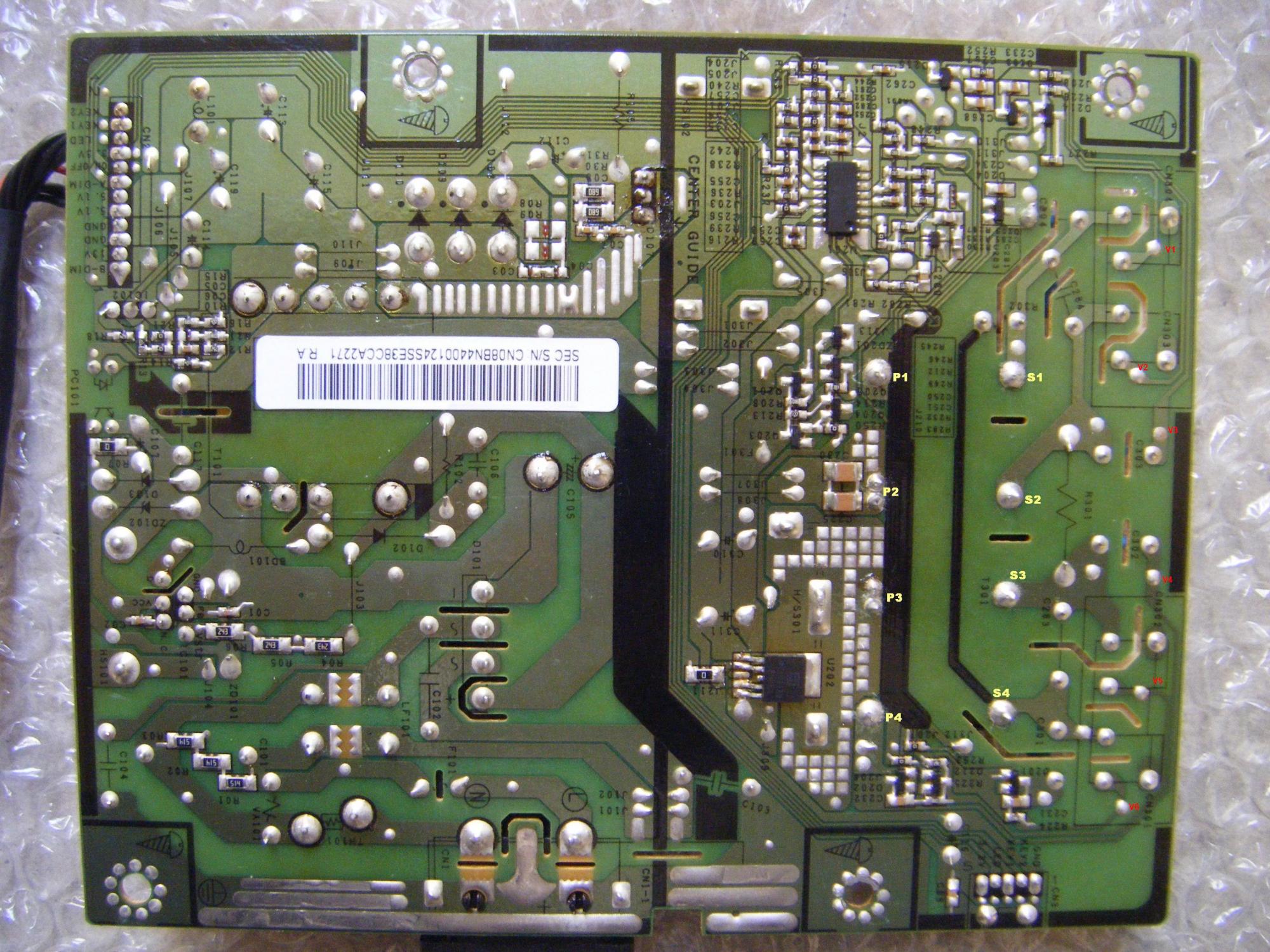

                            this is what i can afford to update as of now,
                            *Al, nope. I did try to leave it for about 1 min but it did the 2sec-to-black twice only.. One during start-up & the second one 20sec later.. After that couldn't detect anymore 2sec-to-black..
                            * retiredcaps & POM_MJ ('sawadee krap', fellow Asian), I manage to swap the three caps 820uf 25v (one at a time) with three caps 1000uf 25V Panasonic FM (12.5x20mm) & here are the result of the voltage measurement taken at middle pin of the diode (D107)
                            [backlight on > backlight off-power led on > all off but power plugged]
                            = 1st cap changed - 12.2V > 14.18V > 13.43V
                            = 2nd & 3rd cap changed - same as above
                            FYI, i did further measure some other points near the secondaries (see attached), hope i did the right thing
                            [backlight on > backlight off-power led on]
                            V1 = 3.7V > 0V
                            V2, V3, V4,V5 = 0V > 0V
                            V6 = 0V! > 0V
                            I am a bit puzzled by this, why V6 is not reading the same as V1?.. hhmm.. Is it indicating transformer problem or circuit on that side of the transformer?..

                                    Ok managed to re-soldered the transformer & measure the resistance
                                    - on T301 (out-of-circuit)
                                    : P1 = open to all
                                    : P2 = 0.3ohms to P3, open to the rest,
                                    : P3 = 0.3ohms to P3, open to the rest,
                                    : P4 = open to all
                                    : S1 to S2 = 904ohms,
                                    : S3 to S4 = 981ohms
                                    comparing to T301 (in-circuit)
                                    : P1 =open to all
                                    : P4 =increasing to P2, P3
                                    Any thoughts?
                                    So currently, on the board now are the replaced 13V caps (820uf) with 1000uf and it is without Transformer T301..

                                    • jetadm123
                                      • 2169
                                      Re: Samsung 2233sw '2sec to black'. Need guidance please.
                                      Looks to be a greater than 3% difference between S1&S2, S3&S4. Suggest you start looking for a new inverter transformer.
