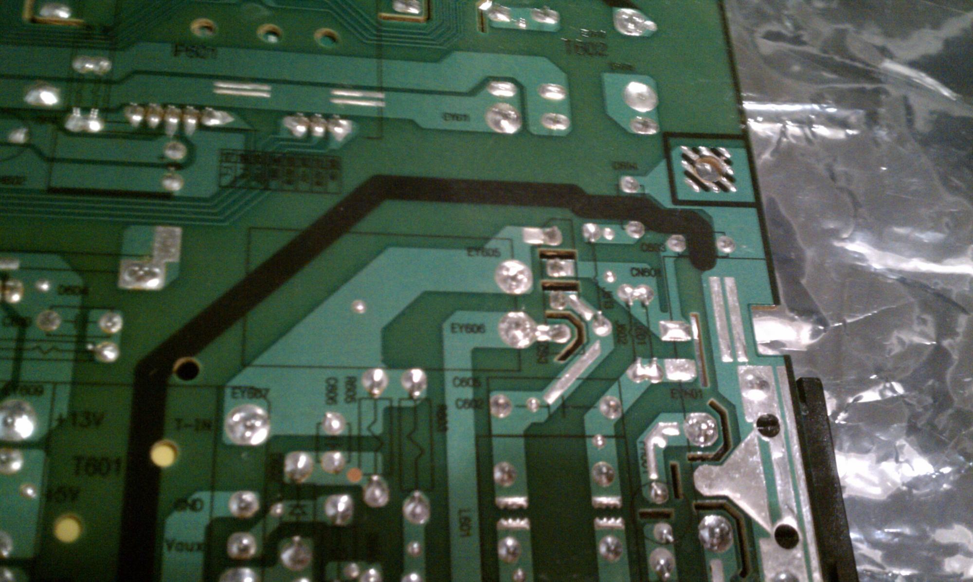

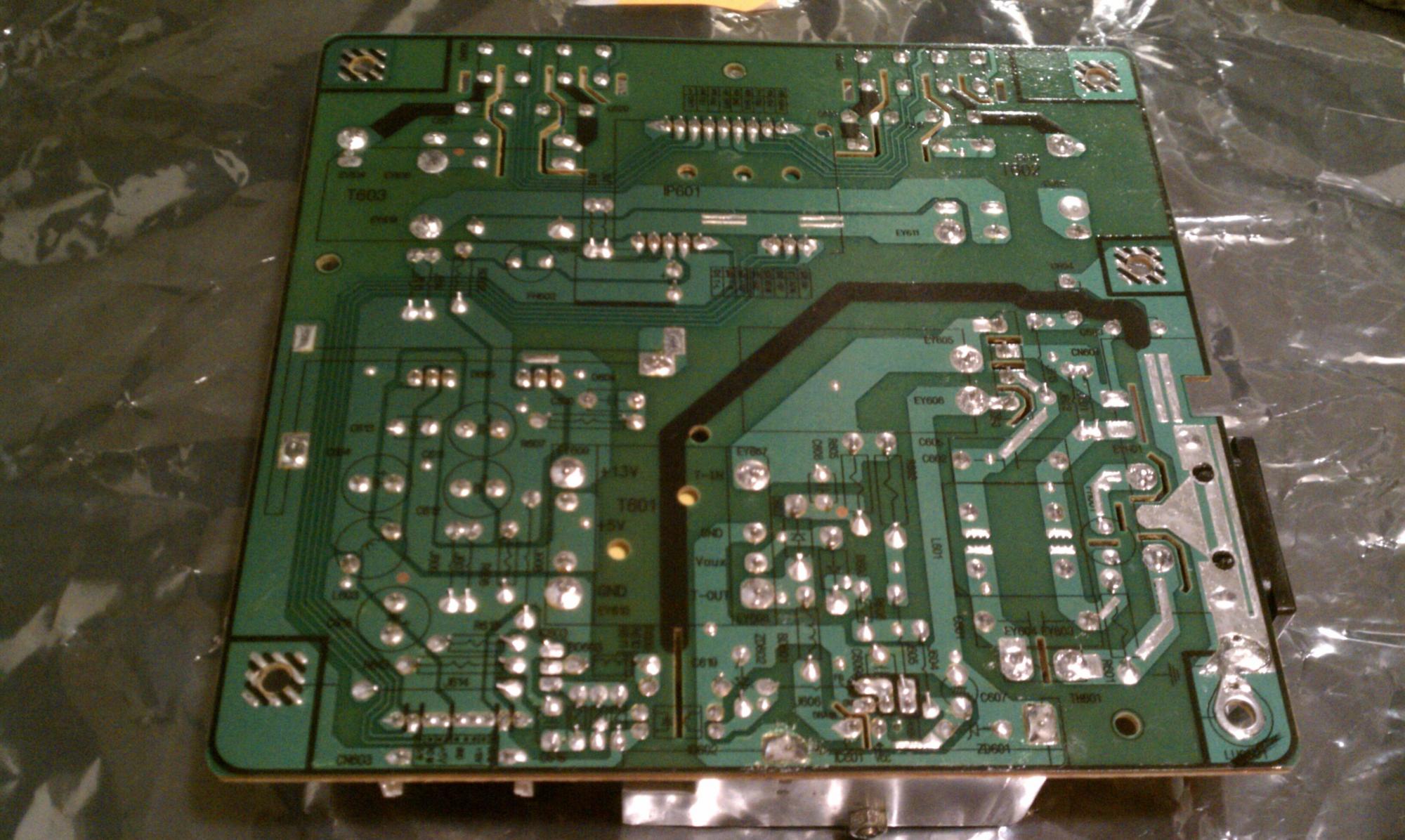

    This has been my daily monitor for over 3 years. Now, when I turn the monitor on it makes a buzzing sound. Sometimes if I turn it off and then back on again, I get an image for a second or two. There are no obviously blown caps, but that doesn't really mean much.

    We need a picture of the entire board. Your pics are chopped off. Use this guide as a start and then post your questions here. Start with post #13 and #14.

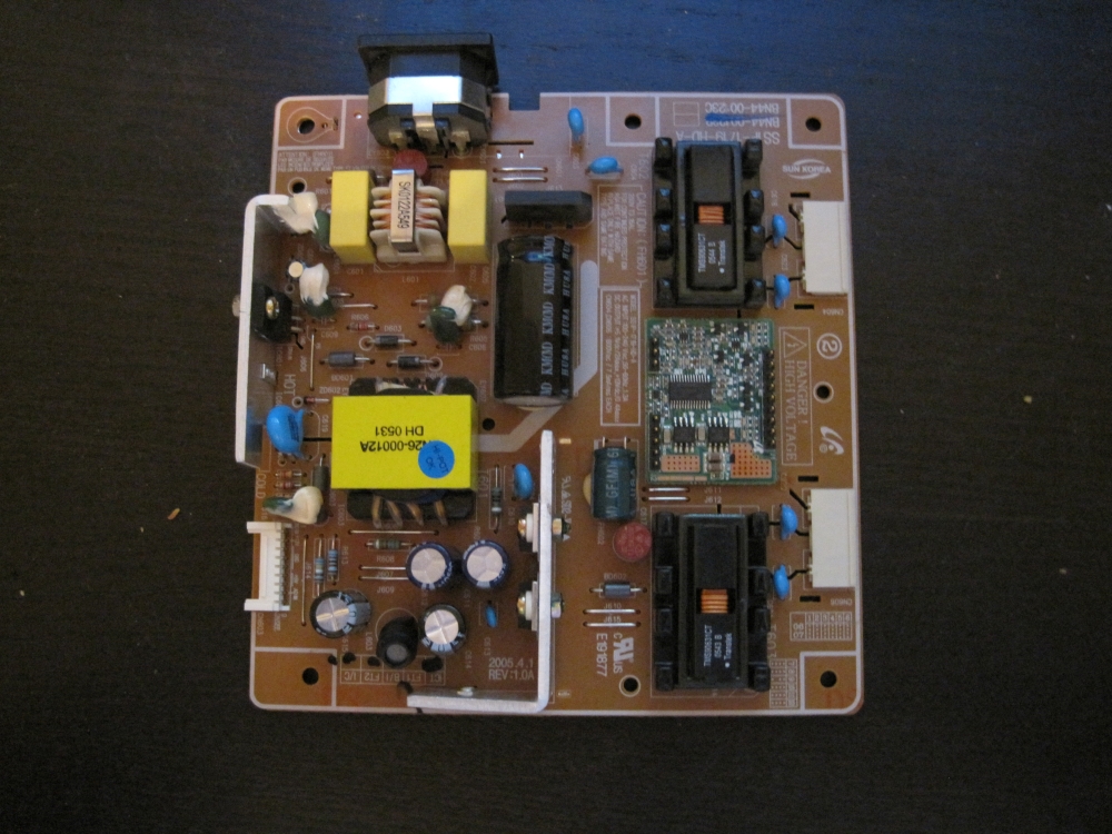

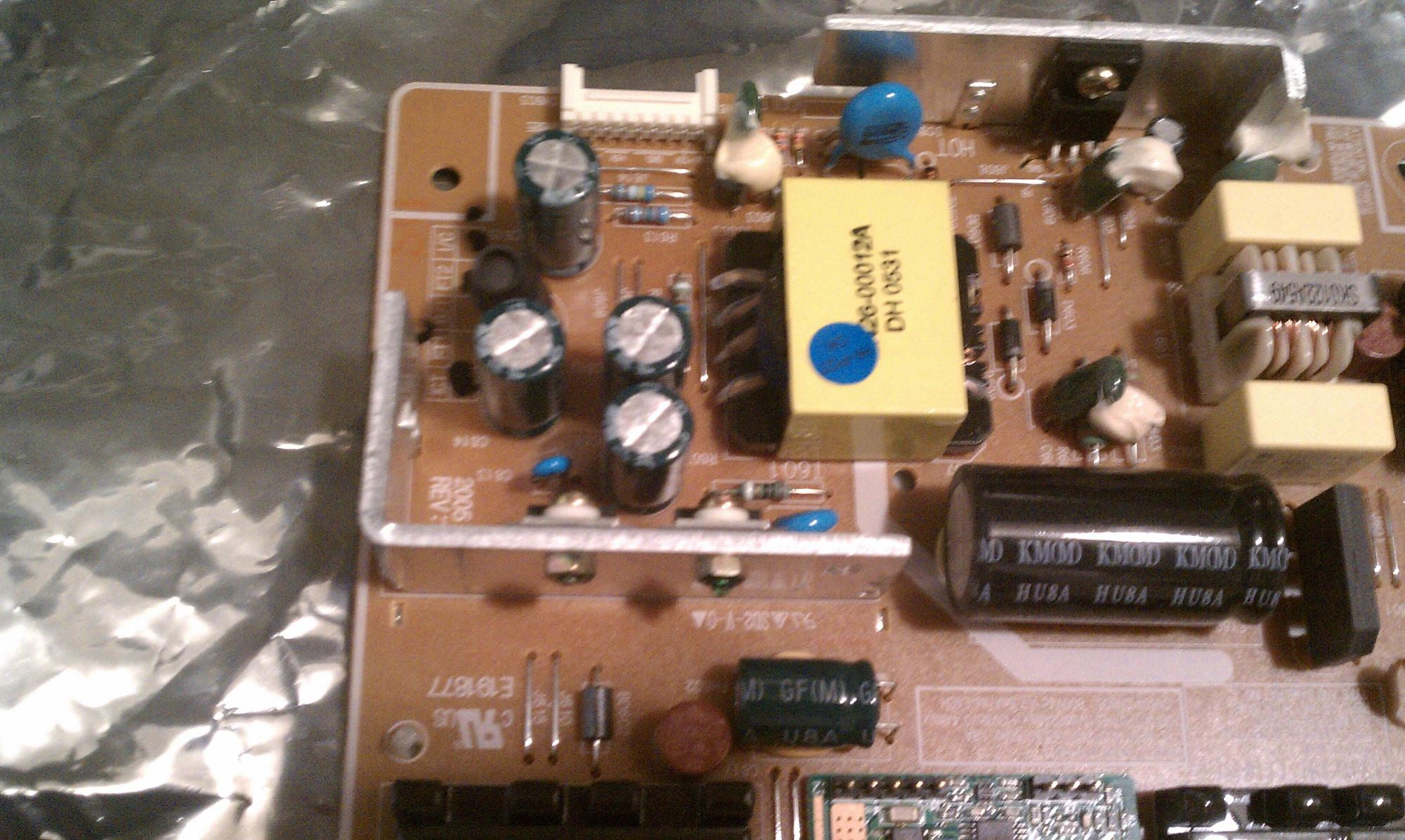

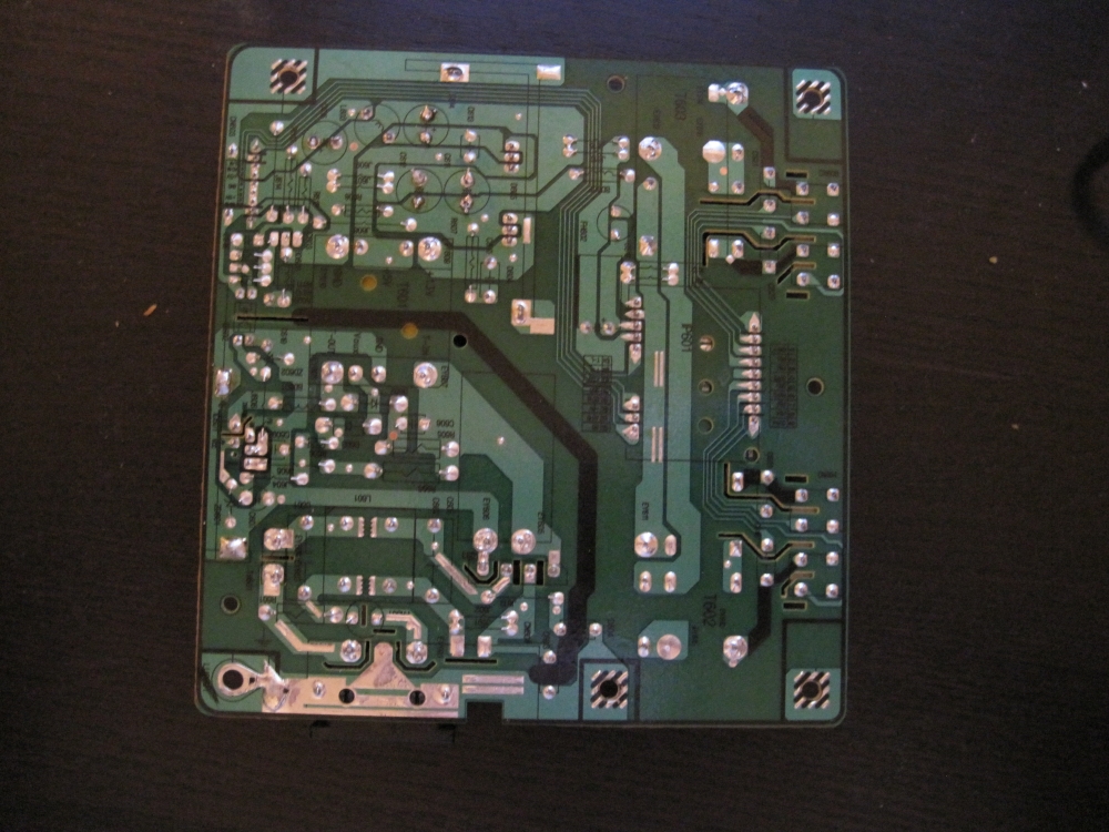

      Replaced the four similar caps with caps from a local parts store and the situation is the same (although my soldering job is absolutely terrible). I power it on and I hear sporadic buzzing for a bit and it looks like the screen is flickering at the same frequency as the buzzing. When the buzzing stops, I lose the image, but if I shine a flashlight directly at the screen I can still see it.
      Here are some updated pictures.

        1) Put your multimeter on 200 ohms (if manual ranging). Touch the 2 probes together. What reading do you get?
        2) Please list all the multimeter readings from the inverter transformers (using 2000 ohms setting this time) and we will intrepret them.
        3) What caps did you get from the local store? What brand and "series"?
        4) BTW, a poor soldering job can also cause 2 seconds to black. Wiggle the caps and see if they are loose or not.
        edit: 5) PS. Try to get a 2000x2000 resolution for photos. This will give us better detail.

          The flickering sounds like a cap problem. Once you have verified retiredcaps request for the cap brand/series, one question: why did you replace only 4 caps? And did you use the exact same capacitance value? There are at least 2 (possibly 3) other caps you should have replaced. One is to the left of the inverter transformers. The other 1 or 2 are small startup caps and are probably hidden underneath the white glue (can't tell from your photo). The large one can generally be left alone unless it's showing some signs of leakage.
