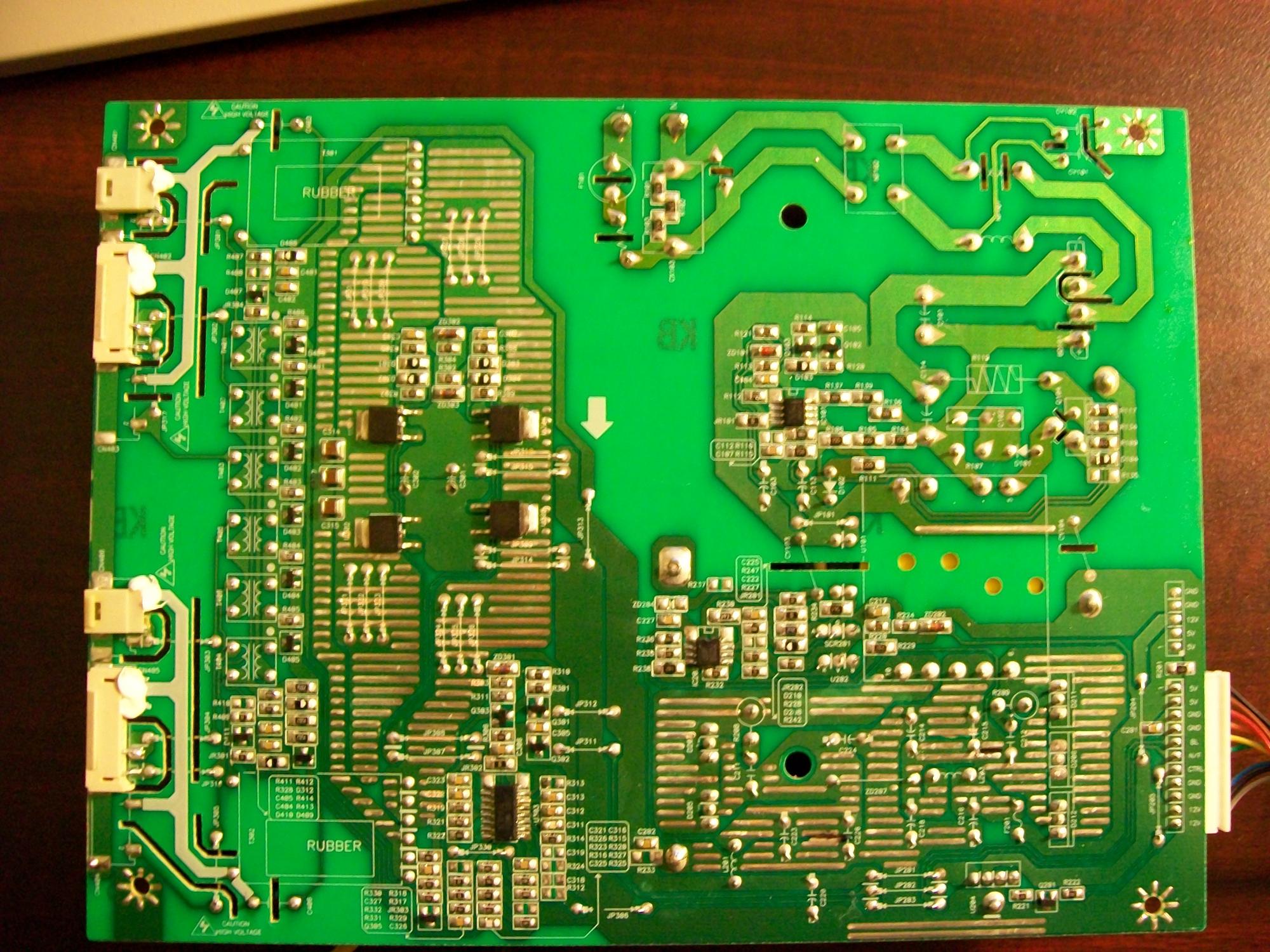

    I was using the monitor one day, then suddenly red lines from top to bottom on the center of the screen (but not spanning the entire screen) showed up, and then the display went black. No backlight, nothing.
    I pulled the unit apart, and can't for the life of me find something obviously (visually) wrong. I've searched for similar symptoms, but haven't found anything at all. Attached are photos of the power and video board from the unit. I'm an amateur at best when it comes to repair theory. I can solder and follow instructions quite well, but that's about where it ends.
    The capacitors look to be intact. No burn marks around any of the components. Attached is a few photos I took.
    Anyone have any ideas for me? This monitor has a twin on my desk that's getting lonely. =/
    Thanks in advance for any help you can offer!
  • PlainBill
    • Feb 2009
    • 7034
    Re: Sceptre x20g-NagaIII (x20wc-gamer) issues.

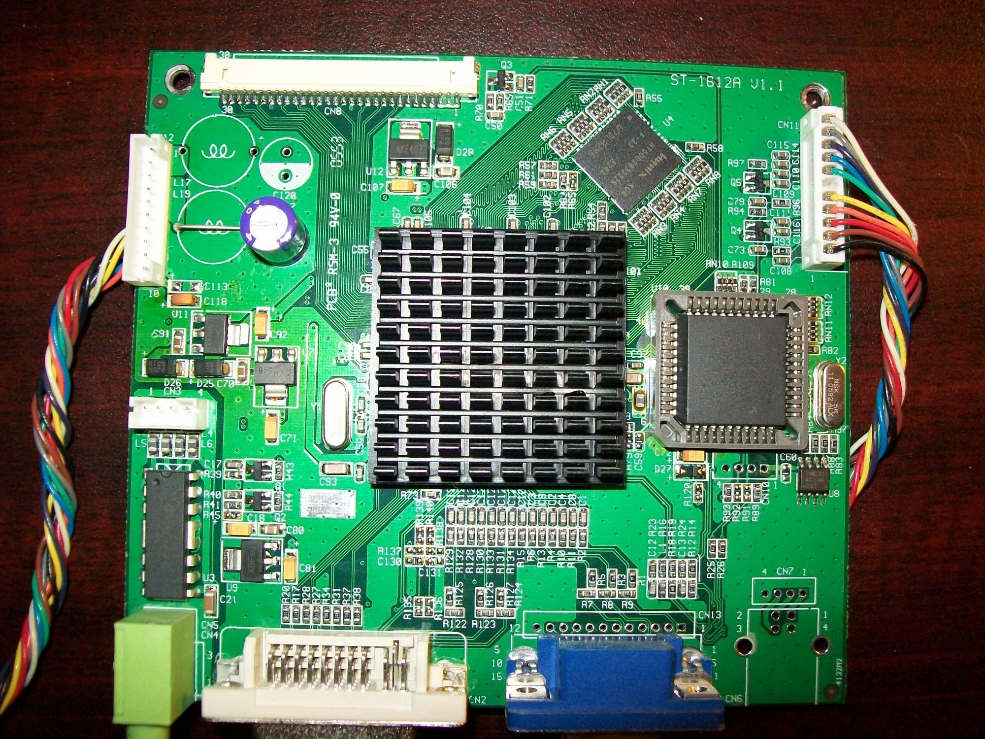

    First step, there are two connectors on the lower right corner of the picture of the back of the power supply / inverter card. Note that some pins are labeled Gnd, 5V, 12V. With DMM measure the voltage from GND to 5V (should be 5 volts) and from Gnd to 12V (should be 12 volts). If either of those are missing, it's most likely a problem with the power supply, disconnect the logic card to be sure (turn off power before disconnecting it!!!).
    Second step, the logic card. There are several voltage regulators, U7, U9, U11, and U12. In the 'normal' orientation the tab is at the top, the three legs are at the bottom. The legs are numbered from 1 to 3 from left to right. Use one of the mounting tabs of CN2 as ground. Measure and report the voltage on each leg of U7, U9, U11, and U12. Also report the part number of each IC.

      Tested the 5v and 12v lines. All showing normal.

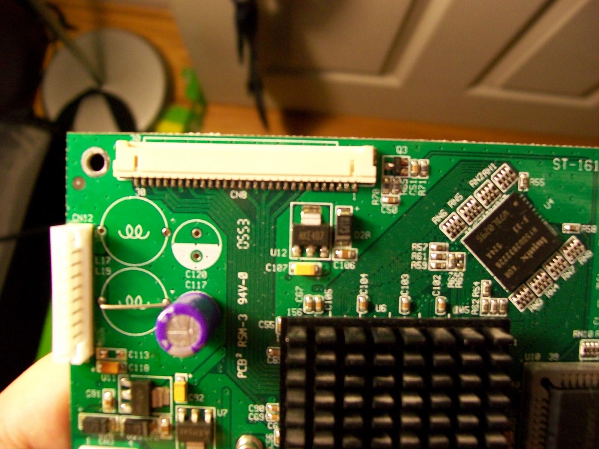

            Yeah, there isn't any other information printed on the component itself. Here's a slightly better photo of it, but I don't see it being of much help.
            This is probably the best I can do with my little camera. =/

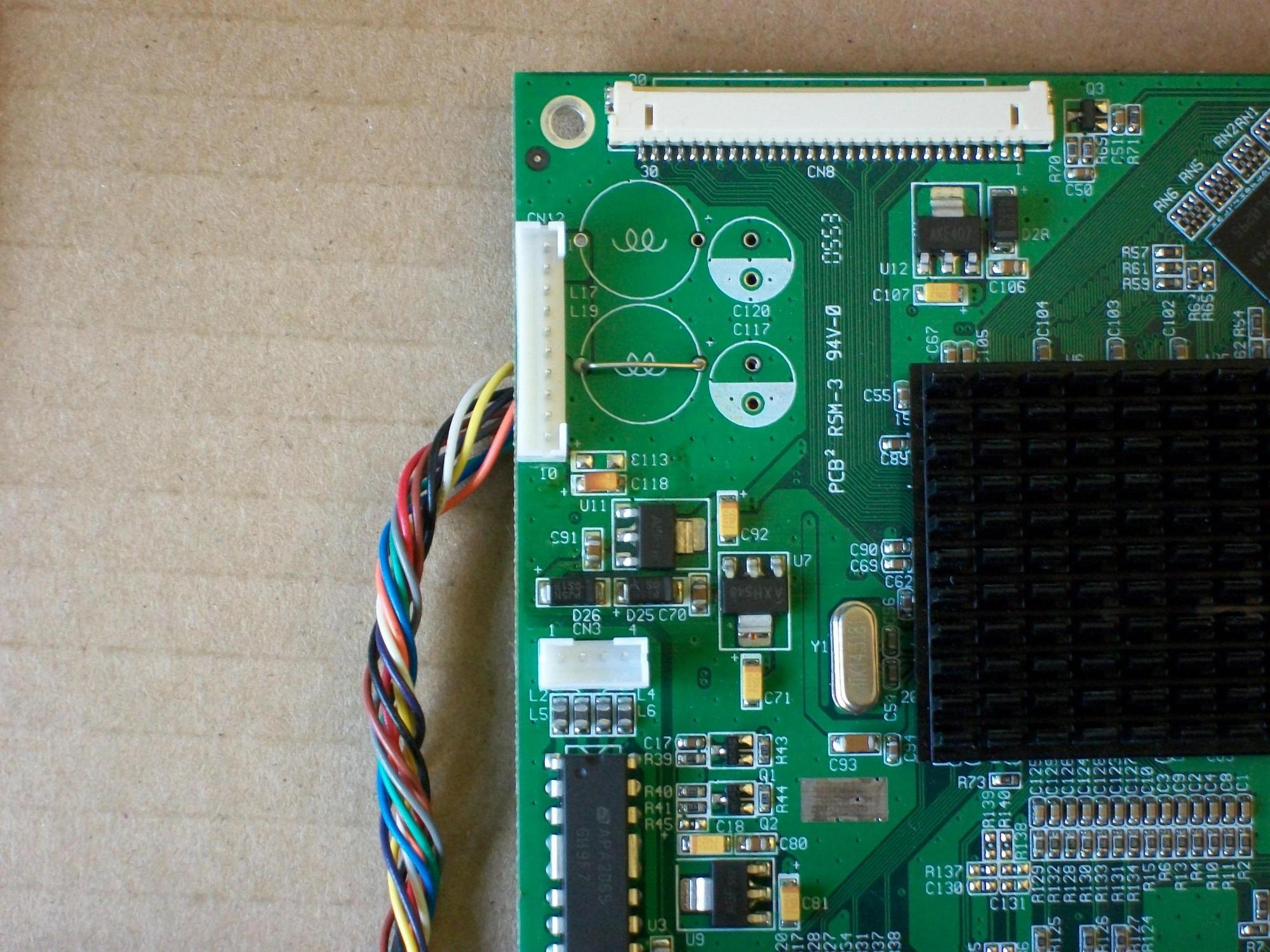

                      Hrm. While removing the capacitor from the logic board, I think I found a burned component. Not sure how I missed it before.
                      C118 on the board. One of the orange / yellow components. Top-right of both photos, right next to U11.
                      Think that could have something to do with it? I don't even know what that thing is! haha
                      Text reads (far as I can tell):
                      A226J
                      93AF3
                      • jetadm123
                        • 2169
                        C118 does look a little discolored, but it's hard to tell because of the lighting. It's a cap because of the "C" in C118. These type of caps seldom fail on their own and if it is burned out, it might have been caused by another component shorting out.
                        As for the A226J. Not sure what the "A" stands for, but
                        226J = 22000000pf = 22,000nf = 22uf, where "J" = +/- 5% tolerance

                          Was actually just taking photos. This is after cleaning it off to make sure it wasn't just 'dirty' from whatever.
                          It's actually a sunny day today, so I can follow the guide. haha
                          The only writing on it I could make out is what I posted above:
                          A226J
                          93AF3
                          Two lines. The A is superscript it seems, it that matters.
                          http://i.imgur.com/p0z0x.jpg isn't resized.

                            See post #12 for cap value. Try tracing the path of C118 to see what each end of the cap is connected to, maybe D25, D26, U11?
                            • Flababa
                              • Oct 2010
                              • 41
                              Yeah, from what I gather the A relates to the physical size of the unit. (http://www.scienceprog.com/few-words...nt-components/)
                              Now, how does one obtain the rated voltage from something like this?
                              Far as tracing where it goes: It seems to eventually run under the board? (maybe?) It's hard to tell since I have limited experience doing this..but just at a glance it seems to contact D25, D26, U11, then shoots down to several others and possibly the back via the pins above it? Could connect with C119, R110 etc.
                              Think it would be easier to replace both that, and the capacitor I've already removed to see if it works / blows out again? I did use the display a lot. At least 8 hours a day, seven days a week for ~3-4 years. Give or take. (home 'office')
