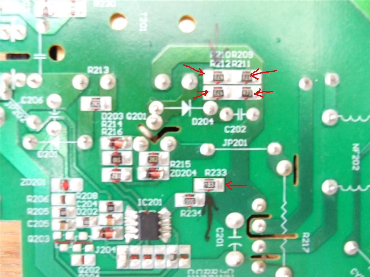

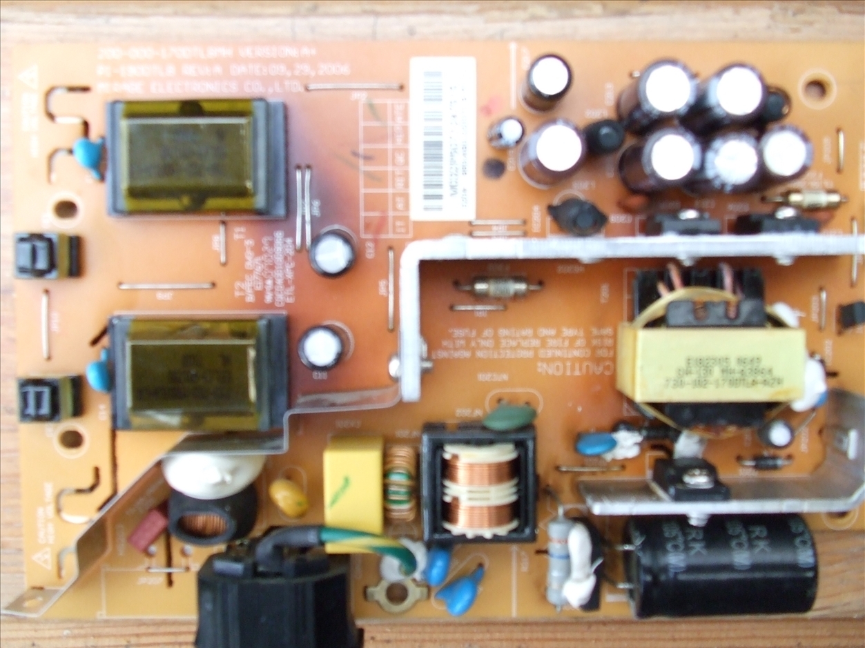

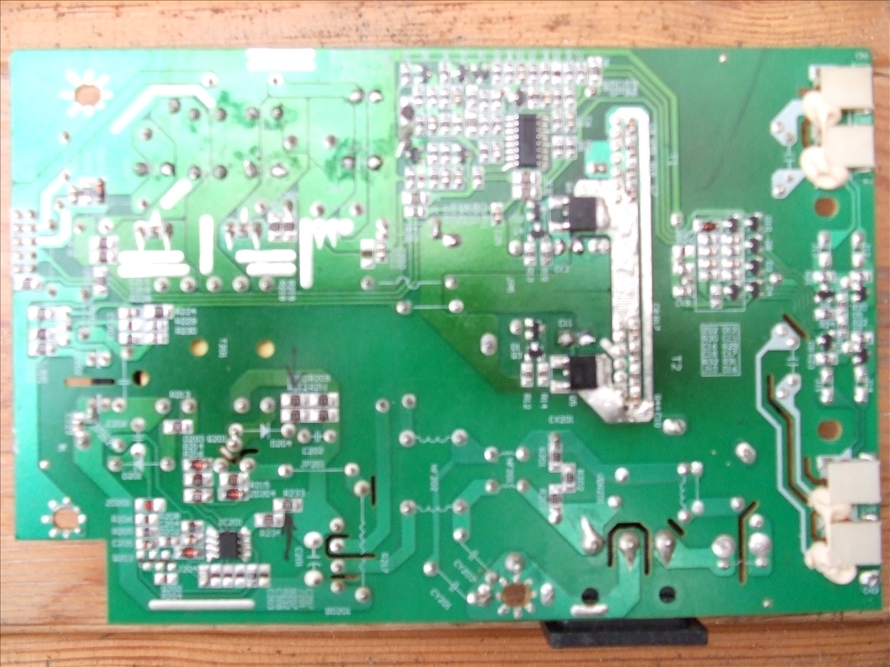

    Hello all
    I have a problem with a xerox XM3-22wB it started about 4 weeks ago with the screen turning to black after 30mins and then down to 2 seconds..i can still see the screen using a flash light..
    I have replaced most of the caps on the power board from rubycon to panasonic and nicicon
    4 x 680uF-25v 105 nicicon
    2 x 470uF-25v 105 nicicon
    3 x 220uF-25v 105 panasonic
    1 x 10uF-50v 105 CD287 LESR suntan?
    The org caps didnt show any signs of blown or leakage
    After completing the re-caping i assembled and tested and the problem still remains.
    i have inspected all the soldering and all seems well as you have probably noticed I am no expert in this feild, i would just would like to fix it and understand what's what..
    I have also set my dmm to Continuity and found that the marked surface resistors are short I think that is the word for it EG all other surface resistors i get a reading, but on the 5 marked with red arrows there is no Continuity?
    I would appreciate any help on this as after reading alot of posts on this fault i cannot figure it out
    I am a novice though but have lots of spare time
    I can upload better images if required Thank you
    Art

      Contunity tests beep "good" if the ohms is less than 35 ohms (depending on the multimeter). Resistors come in different values (ohms). A resistor marked 103 is 10 (3 zeros) or 10,000 ohms (10K).
      There is no way that contunity will beep good for a 10K resistor. So put your multimeter on ohms and check the resistor code to its stated value.
      The pics you posted are out of focus. To get the best pics, take your boards to a window on a sunny day, turn off flash and put your camera on macro mode. See my pics as an example of what clear focused means.
      https://www.badcaps.net/forum/attach...7&d=1280167246
      https://www.badcaps.net/forum/attach...6&d=1280167246
      What are the transistors on the back of the board? They are hot enough to put some discoloration on the front on of the board? What is the markings or part number?
          Thank you for the reply..
          Regarding Pictures I will make a better job of it
          I will get on to it straight away. Well tomorrow now as its almost dark here in England.I can give you the transistor info will be back soon

              What parts are the transistors so I can get the no's Please I know your a busy man as i have been reading forum posts for a while and I am grateful for your help

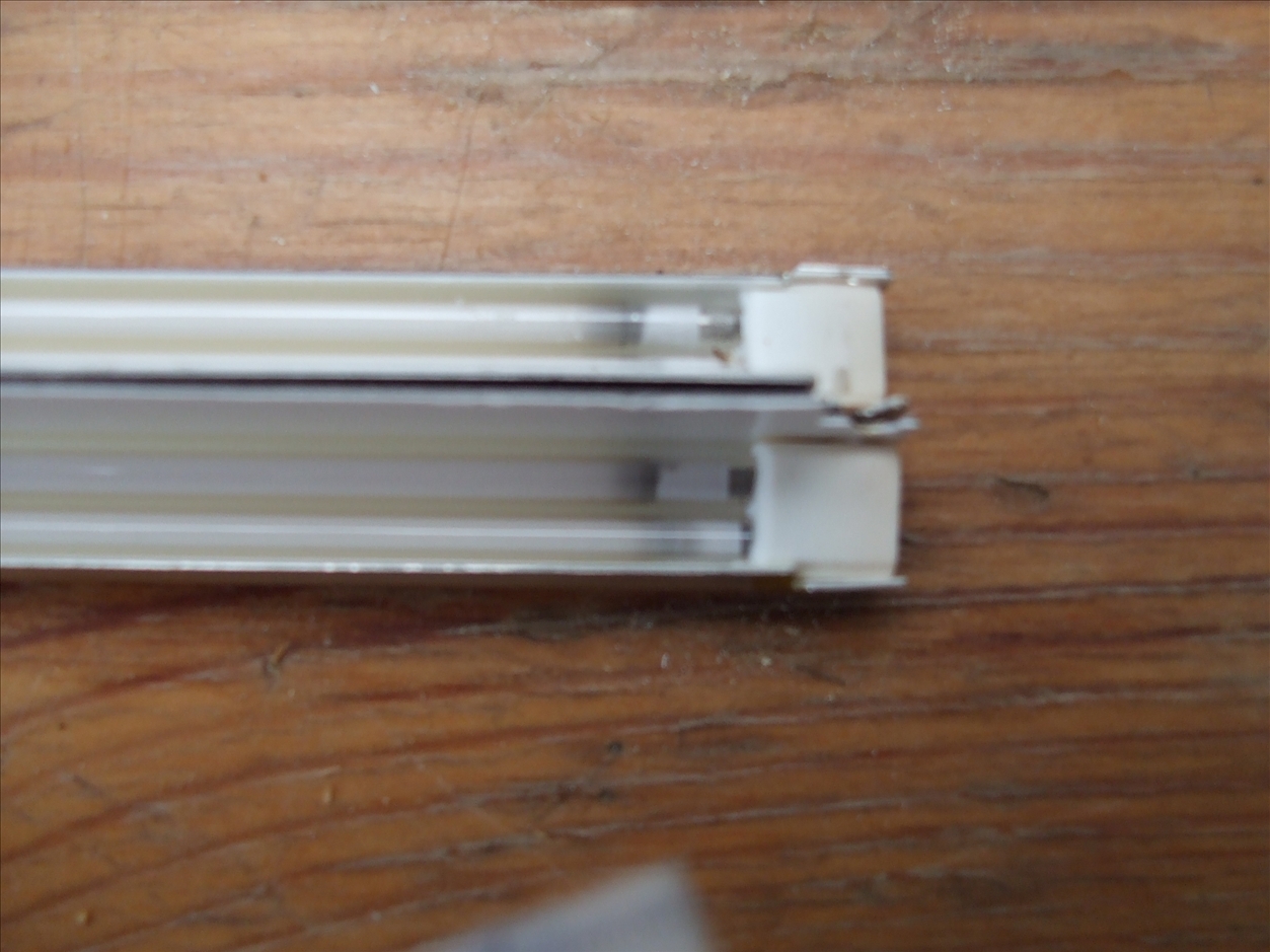

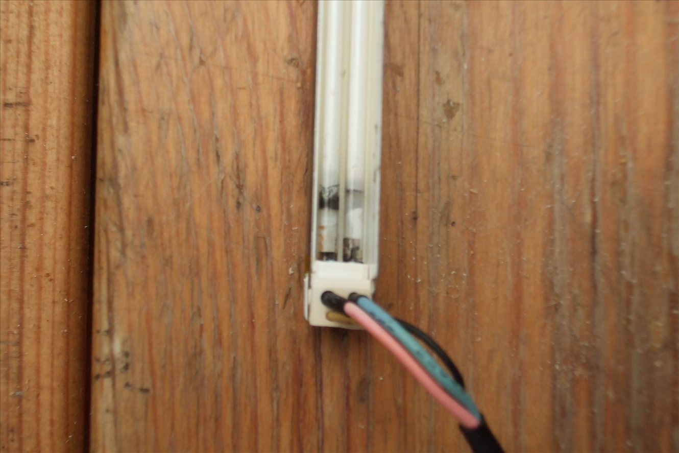

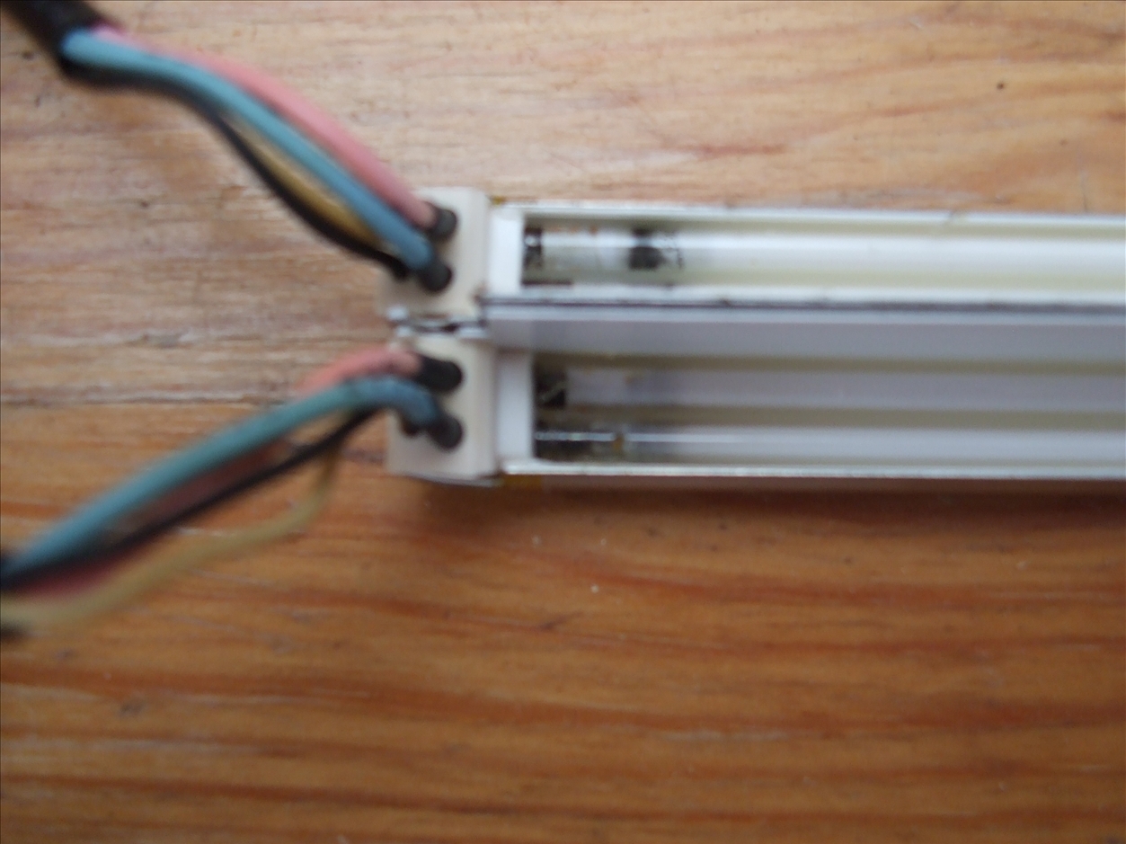

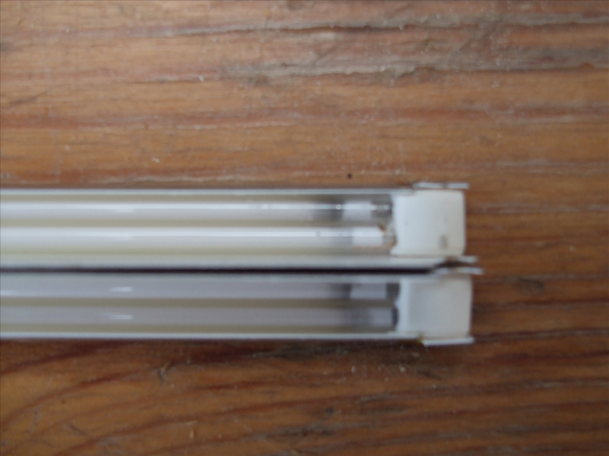

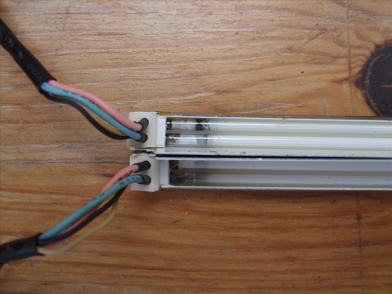

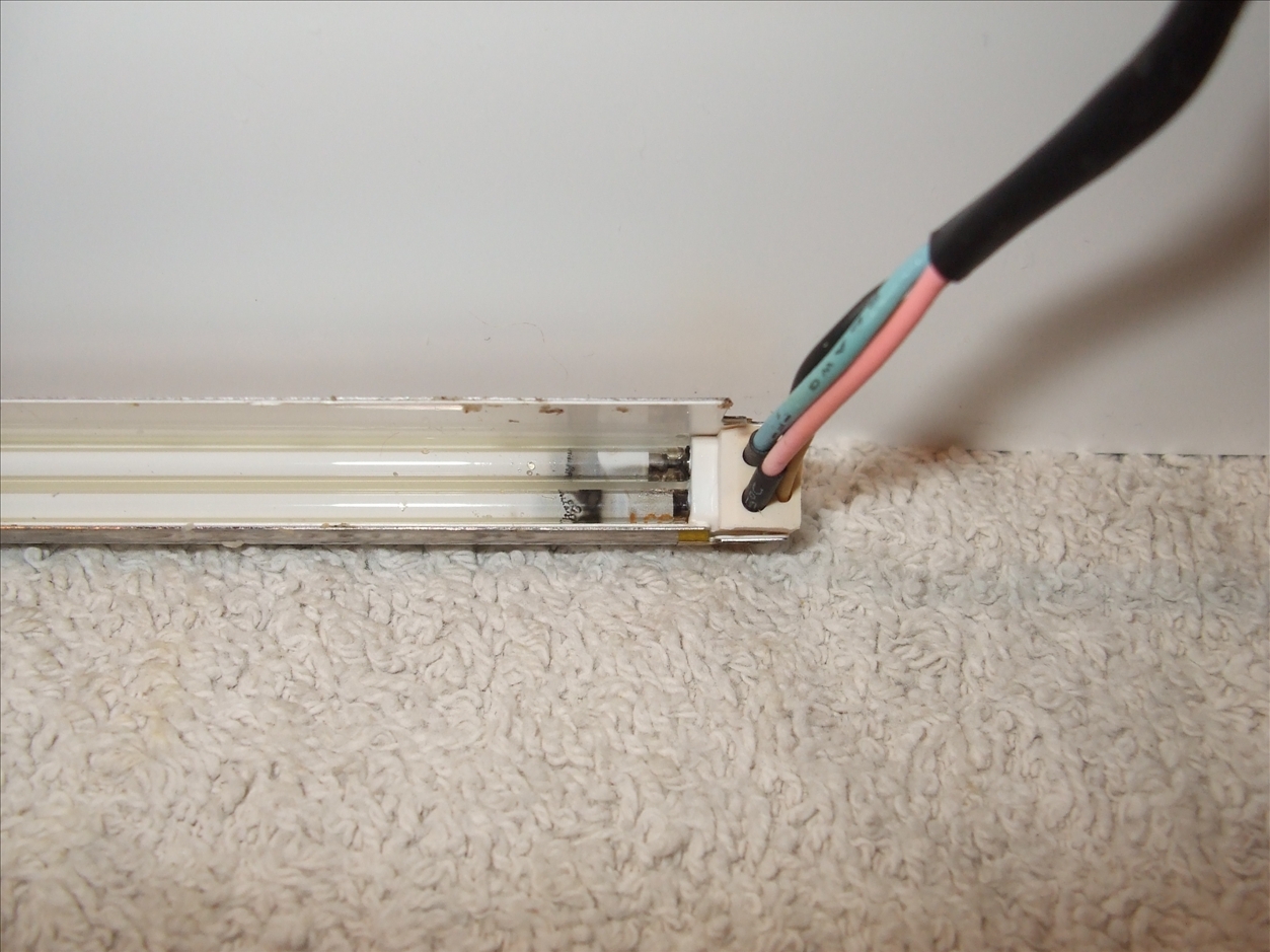

                            Hello
                            I have managed to get to the CCFL's.. It's not to difficult a job, You just need patience and a bit of common sense.oh! and advice BTW!.. I also take pictures of each stage just in case I have a amnesia episode or have to put the job off for a while (my wife calls it a Senior moment) don't you just love them..A title for everything..now where's my glasses ha!
                            I will upload the images for the ccfl's and you can advise me if there duff?
                            I have not taken them out of the frames yet as I am just about to source the replacements if they are duff (useless)
                            I am wondering what I could test them with? I have connected a pp3 9v to the leads and nothing I suppose they work on 12v but I am not sure?
                            I do have some ccfl tubes here with invertors that I used to sell on fleabay for pc modding?, would that work? meaning the right voltage.
                            I am off to source some ccfl's but always online
                            Art
                              Re: 2 second to black on xerox XM3-22wB I need help please
                              You can be sure they have all 'had it'.Most Monitor CCFL's work from 800volts plus(but low current),and this is achieved,in the main, by the Output transformers.So you cannot test them with your 12volts.Fitting indidvidual new bulbs,is long and tedious,and they break so easily,and I have done quite bit with Monitors,but draw the line with that job.
                                I test them by using them in another monitor. I'll just take one of them (in their housing) and hookup the connectors to a known working LCD monitor. If that tube works for 60 seconds, then I move on to the next.
                                Be VERY Careful. This is very high voltage. See #5
                                  Hello Rtech
                                  I can see the pitfalls of this sort of repair, I have OCD which makes me want to carry through what I have started.. It's either all or nothing..I understand what you mean about the tedium, Then to me I tend to thrive on it, Just to get it right or in my younger days I would kick it all up in the air and walk away ha!
                                  I cant do that now? (Tongue in cheek) on the other hand I have purchased a new LG W2243S 22" LCD MONITOR, FULL HD, 5MS £89 jobby from fleabay so I can still operate my lifestyle so I am not to desperate to fix it..
                                  Saying that I went to a site in the uk www.backlightweb,uk they have loads of 2mm ccfl's but not the length I need which is 4 x 2.0 or 2.2 x 475mm their prices for some similar is £9.40 + for 2 so its going to cost about £25.00 for the 4 and with the caps etc it will get close to half the new price..
                                  I will re-solder the transistors and put it all back together as I think that 1 of the transistors is overheating
                                  However it keeps be busy
                                  Art
                                    Here are instructions written from a different point of view.
                                    Take a known good working LCD. Assume it has 4 CCFL connections. Number them 1, 2, 3, 4.
                                    Take cover off known good working LCD and lay it face down on soft surface. You should be able to access the CCFL connectors.
                                    Remove CCFL connector #1 from the good LCD monitor.
                                    Plug in cable for potentially bad CCFL #1 into connector #1 for test.
                                    Plug LCD into power bar and turn on power bar. Now power on LCD. See if 2 seconds to black occurs.
                                      at
                                      https://www.badcaps.net/forum/showthread.php?t=10419
                                      Hello retiredcaps
                                      As I said to Rtech,I have a new monitor here,the same size 22". I also have a few lcd screens, all working. Would a 17" ilyana be okay to check it on?
                                      I have read that post on #5 and understand the safety rules! regarding the HV
                                      Are all CCFL's the same re-voltage? meaning would it hurt to hook up a 480mm ccfl to a 17" screen or is that irrelevant
                                      I Need to read up more on this
                                      Art
                                        Turn off power bar, unplug LCD power cord. Wait 1 minute.
                                        Repeat same instructions as above for each potentially bad CCFL.
                                        If these instructions don't make sense, don't try it.
                                        Hello
                                        Those Instruction's make perfect sense and I understand completely
                                        I shall get on with it and let you know the result
                                        Art
