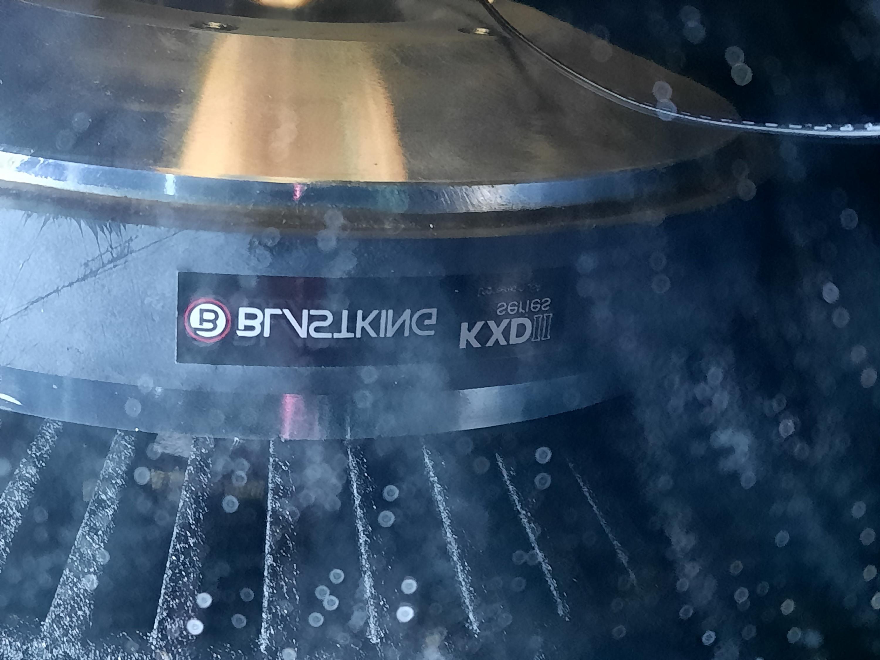

    Hi all
    Far as i can tell this unit not producing any audio , although customer mentioned it does , but distorted .
    Anyway , started by testing impedance of main driver speaker .
    Measuring 80R , which i have not experienced before .
    Anyone familiar with this unit enough to know ?
    Can't seem to find any info on it .
    See picture of label on speaker .

    Re: Intimidation Professional sub advice please
    Most of the Blastking drivers seem to be 8Ω
    • zen
      • 511
      Thanks RJ for confirming .
      Will test with another driver & report back

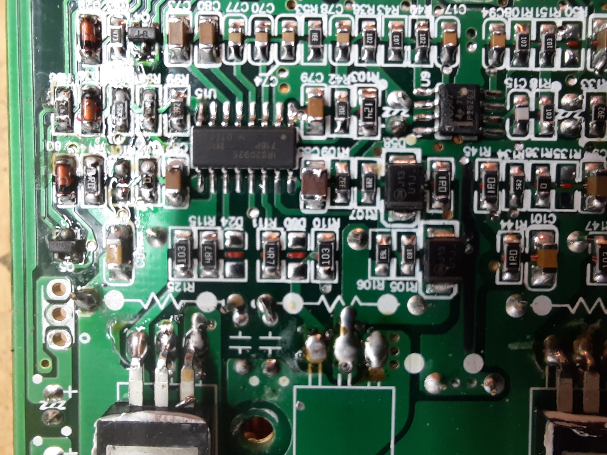

            Some progress made on this unit .
            Discovered a low reading of 30R between pins 15 & 13 of U15 ( IRS2092S ) , compared to same measurement on other channel , which was over 4K .
            It's a drive chip for one of the channel output devices , which seemed to have survived .
            Surprised protection mode didn't kick in .
              There likely is no protection circuit. I suspect the output mosfets could also be bad, I see what looks like a lead trimming or solder splash on the mosfet lead in the lower left of your picture.
              • zen
                • 511
                Hi RJ , there is an LED on unit labelled protection .
                I did notice the solder splash also , but suspect that's during manufacture , as it doesn't seem unit has been opened before .

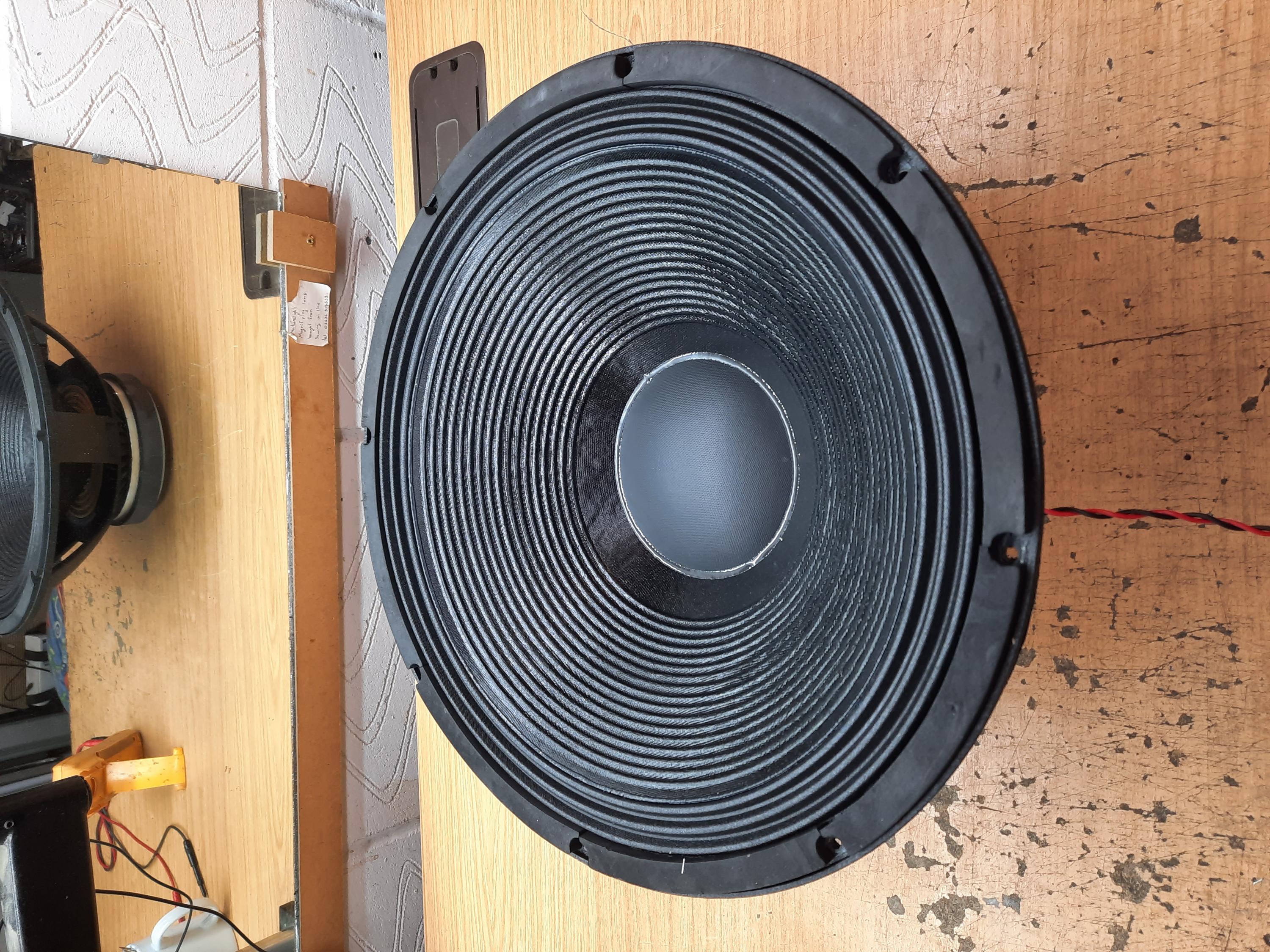

                  Pulled out the driver , which has a larger diameter than any pizza i have ever seen , 47 CM in fact .
                  Now impedance reading 1R2 therefore assume it has shorted turns .
                  I guess it should be a 4 ohm .
                  Not sure why the high reading before . Quite possibly meter probes not contacting fully .
                  Any suggestions for a replacement .
