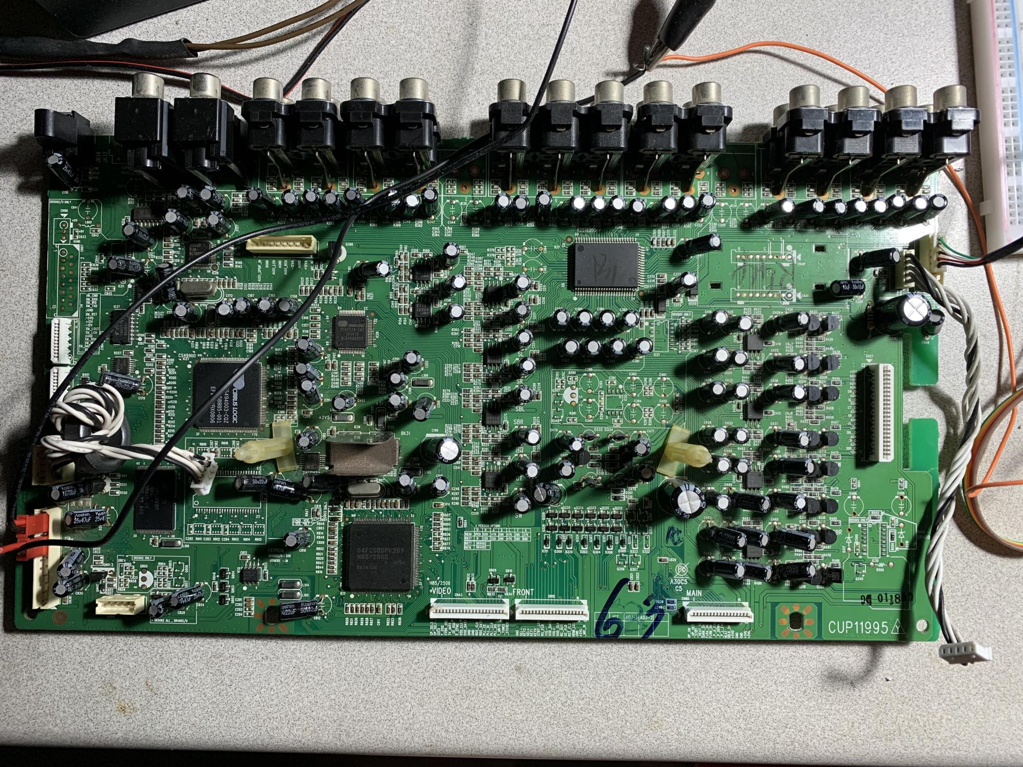

      I need both of them if you have. Mainly my SR4003 MCU chip is burned. I need replace a new chip and then reload firmware. I realized CPU firmware it works for this MCU chip. Thanks ! ******

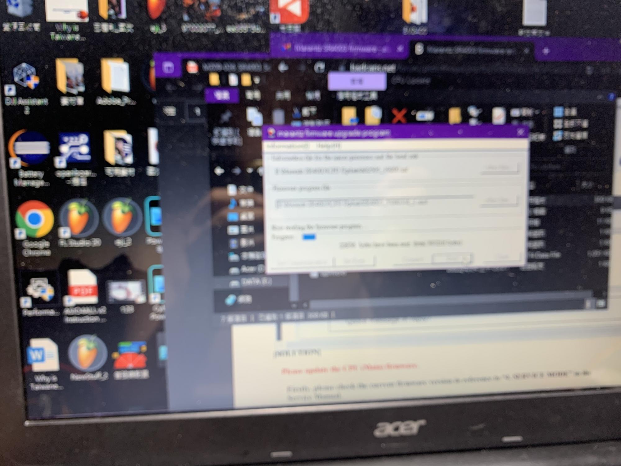

        Hello, I only have firmware on the CPU, how to program there is an instruction in the service manual for it.

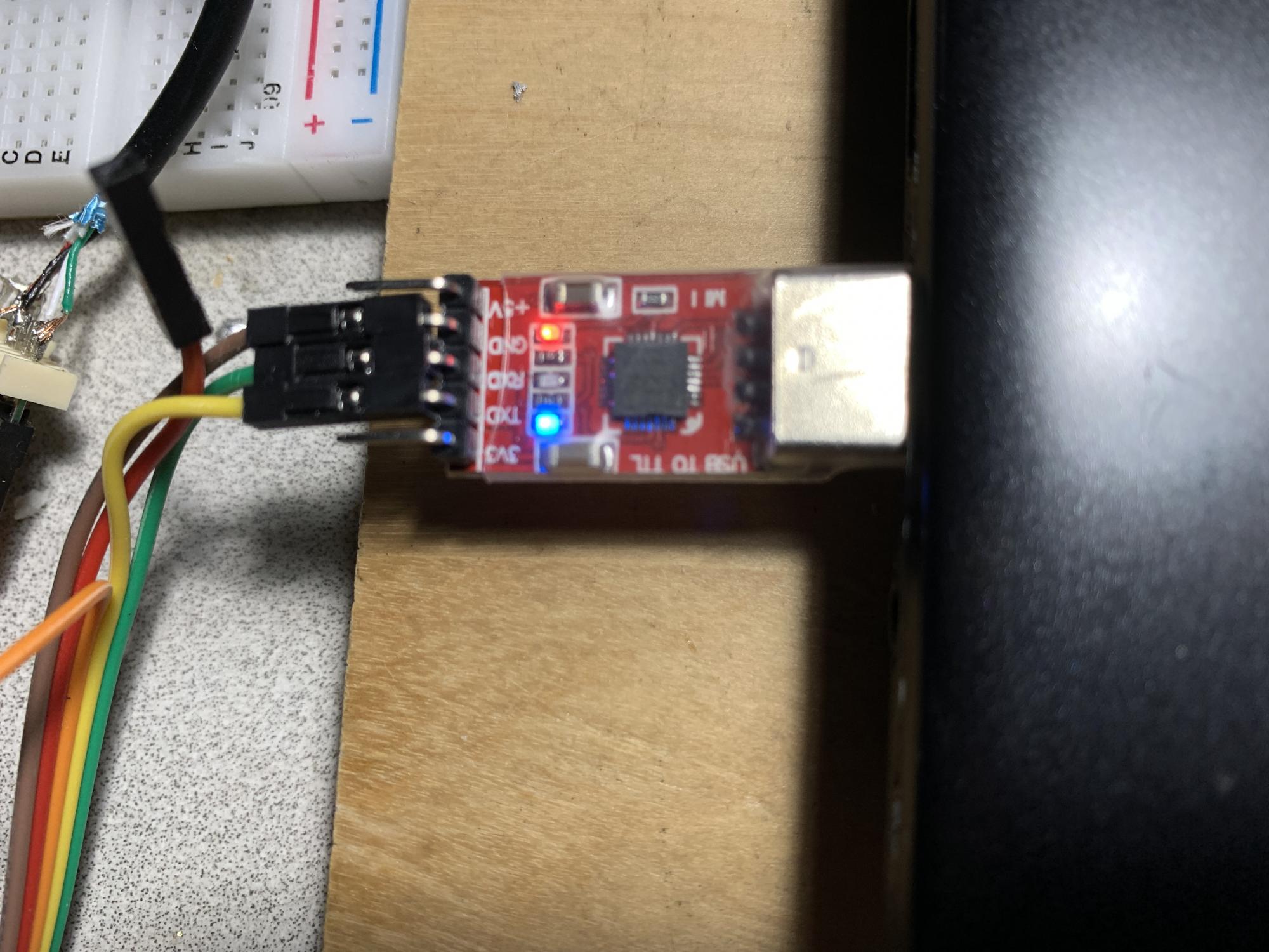

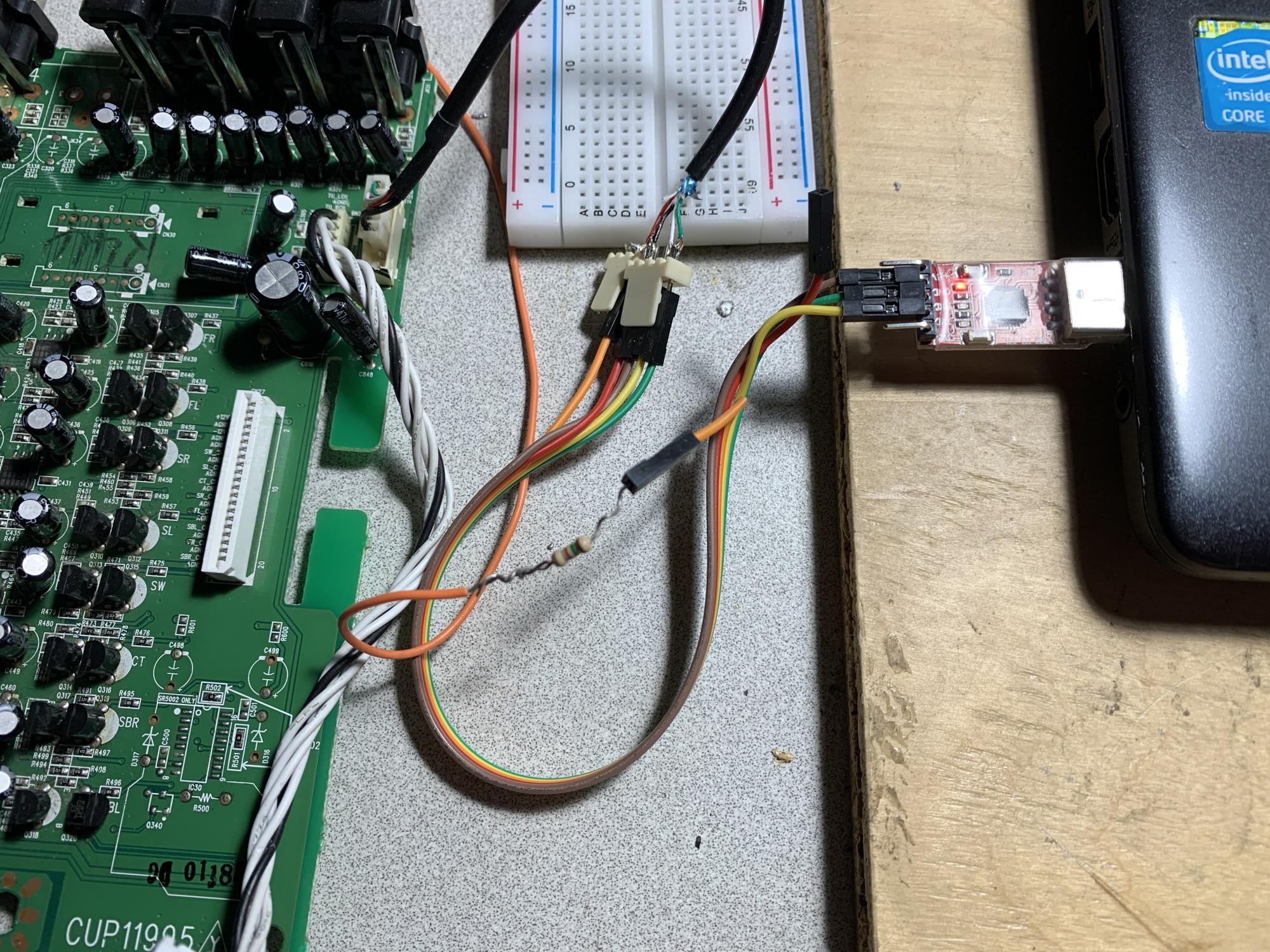

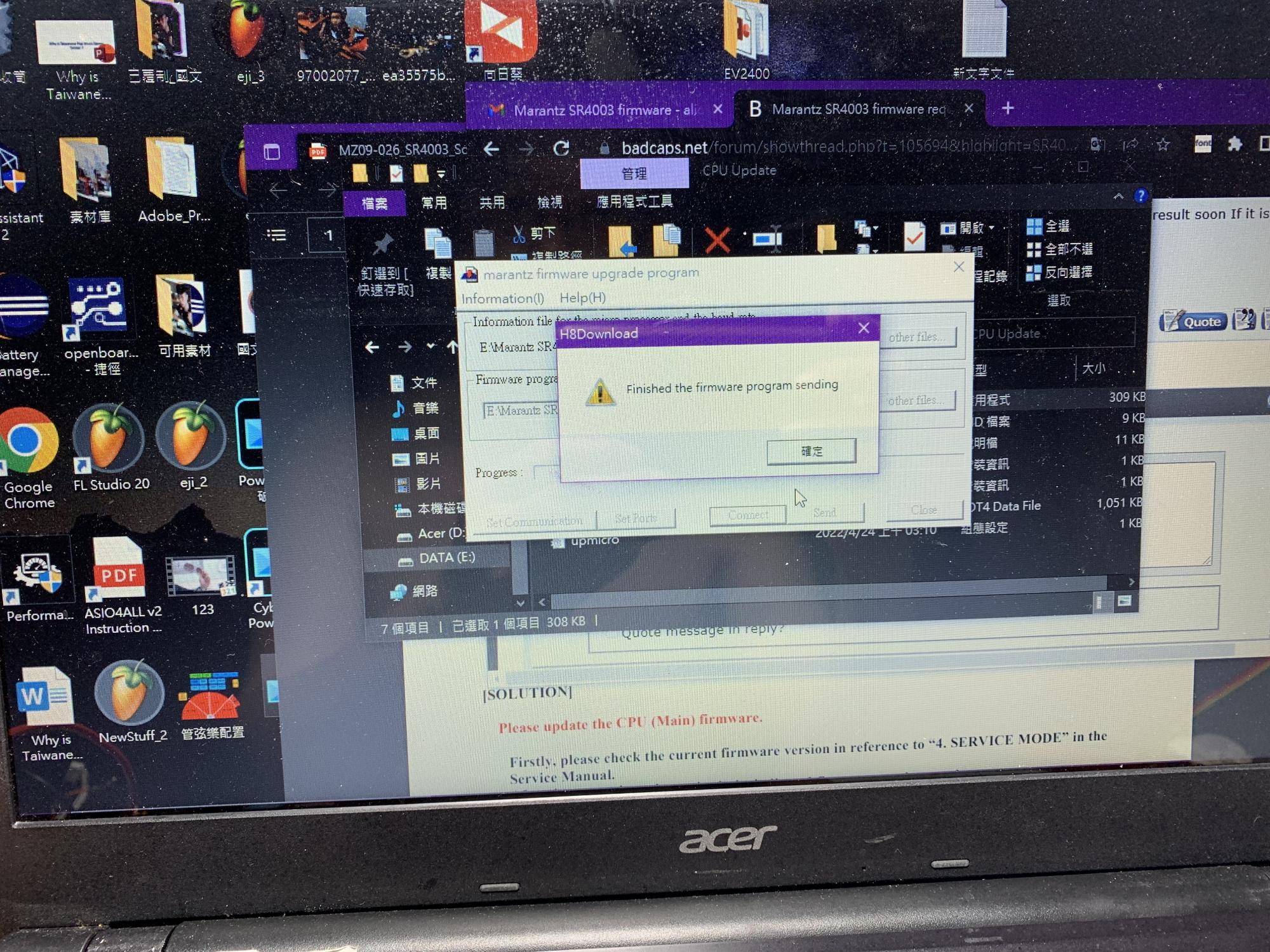

            Let you know, finally I updated the firmware successfully after a lot of hard work with new MCU. Thanks got your help again. Without your help I have no way to go. I used a USB to UART adapter to make it happened write this firmware to the MCU without use official updates hardware kit(from Marantz which discontinued product). I post some pictures here. Also share this results to contribute this forum for those who are dealing with AVR MCU.
            But additional problem is no HDMI no audio. I checked it is Sil9033 HDMI receiver chip is burned. I am working on that waiting for this ne chip arrival.
