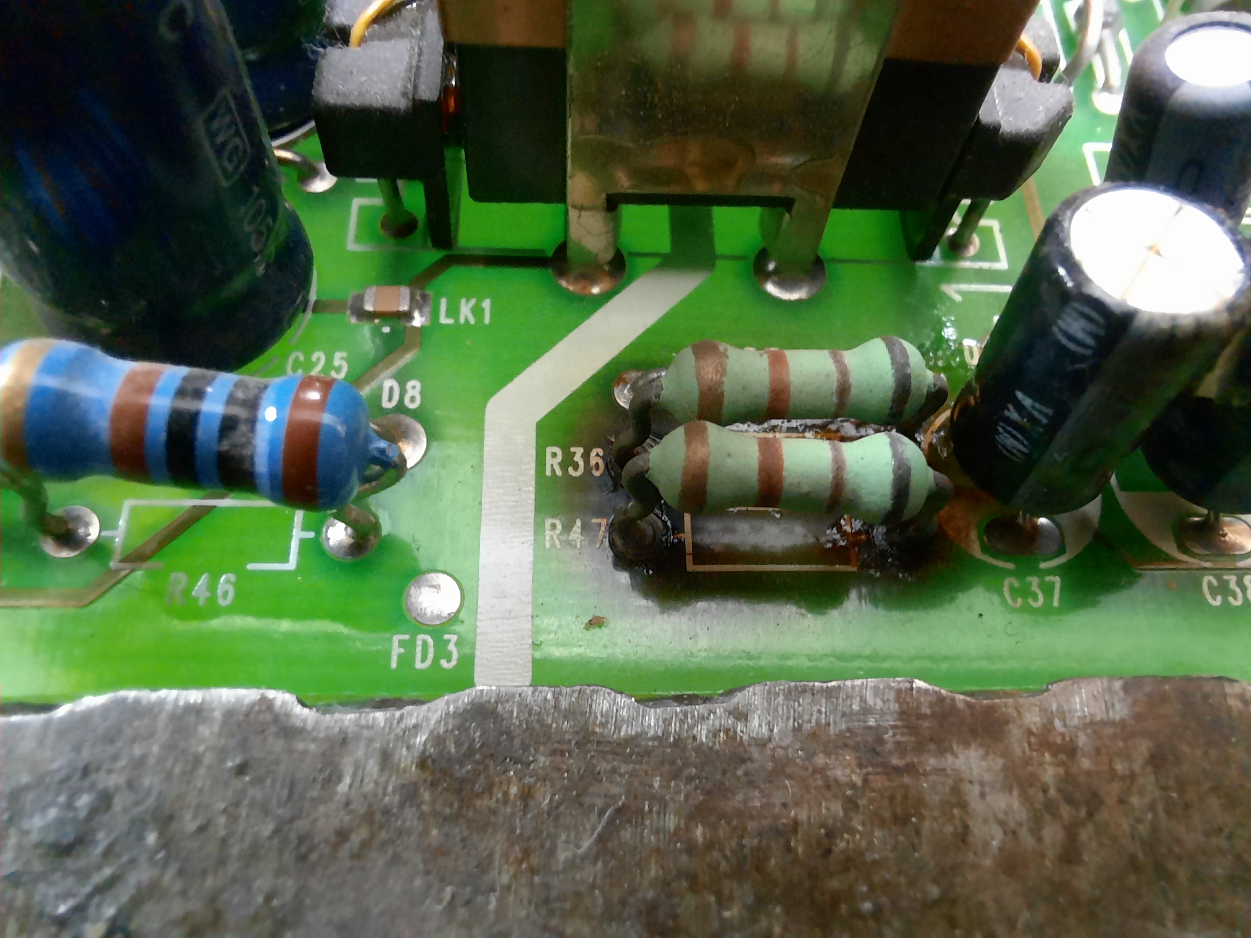

    Hi all
    This is my next project .
    Rebuilding PSU & require values of R36 & R47
    Both measuring around 650R .

      Re: Soudcraft Spirit M12 mixer schematic please
      Found this site
      Looks like they have been replaced using 680R types
      http://studiorepair.com/gallery/Soun...612145982.html

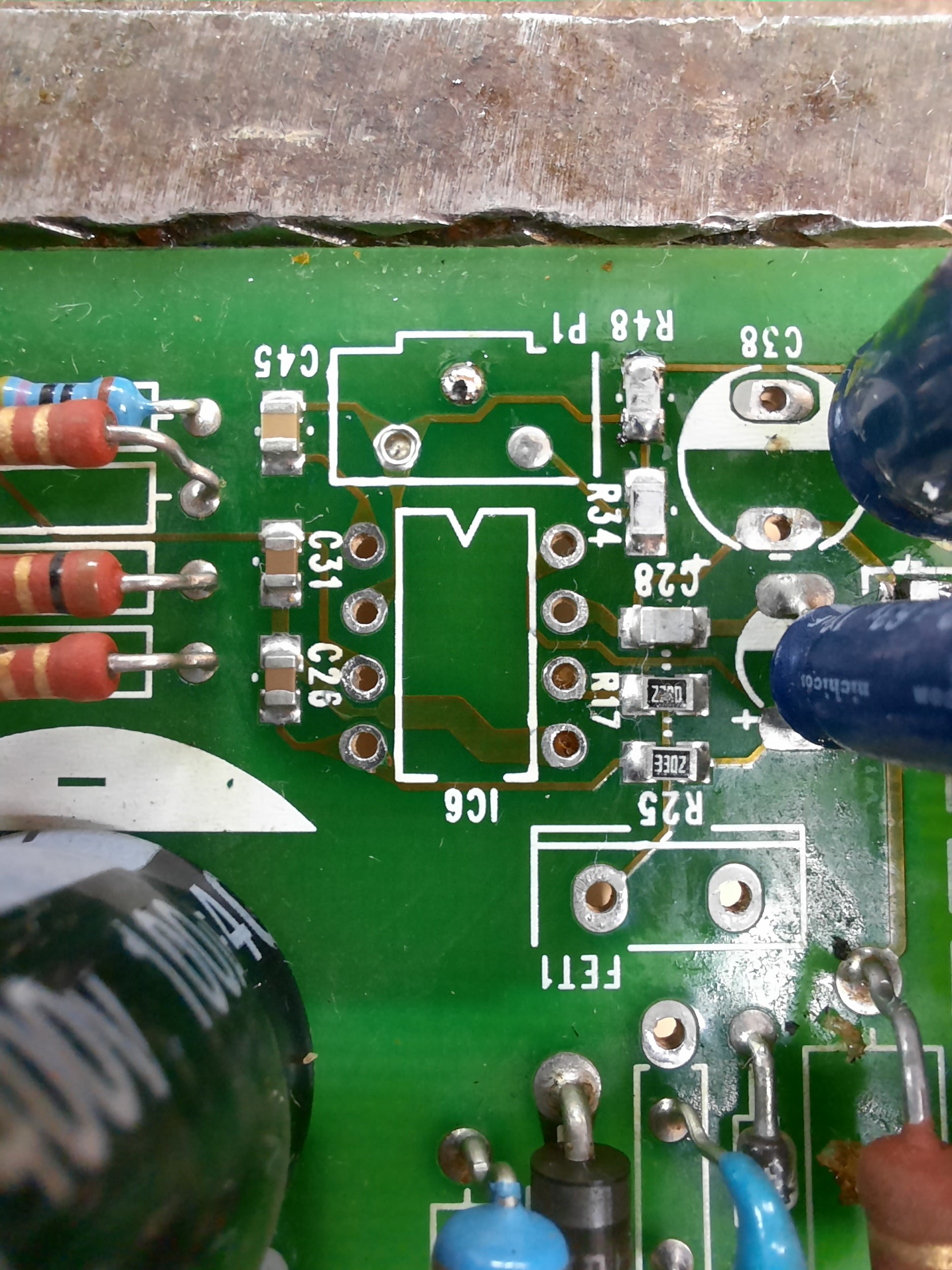

        R17 also cooked . Connected to pin 6 of IC6 ( UC3842AN ) , which is faulty as well .
        Can anyone help with the value ?
        I'm guessing 22R or 220R ( see picture )
        • zen
          • 511
          Pulled datasheet for the UC3842AN & pin 6 is the gate drive output to FET .
          Diagram shows resistor as 22R ( see link )

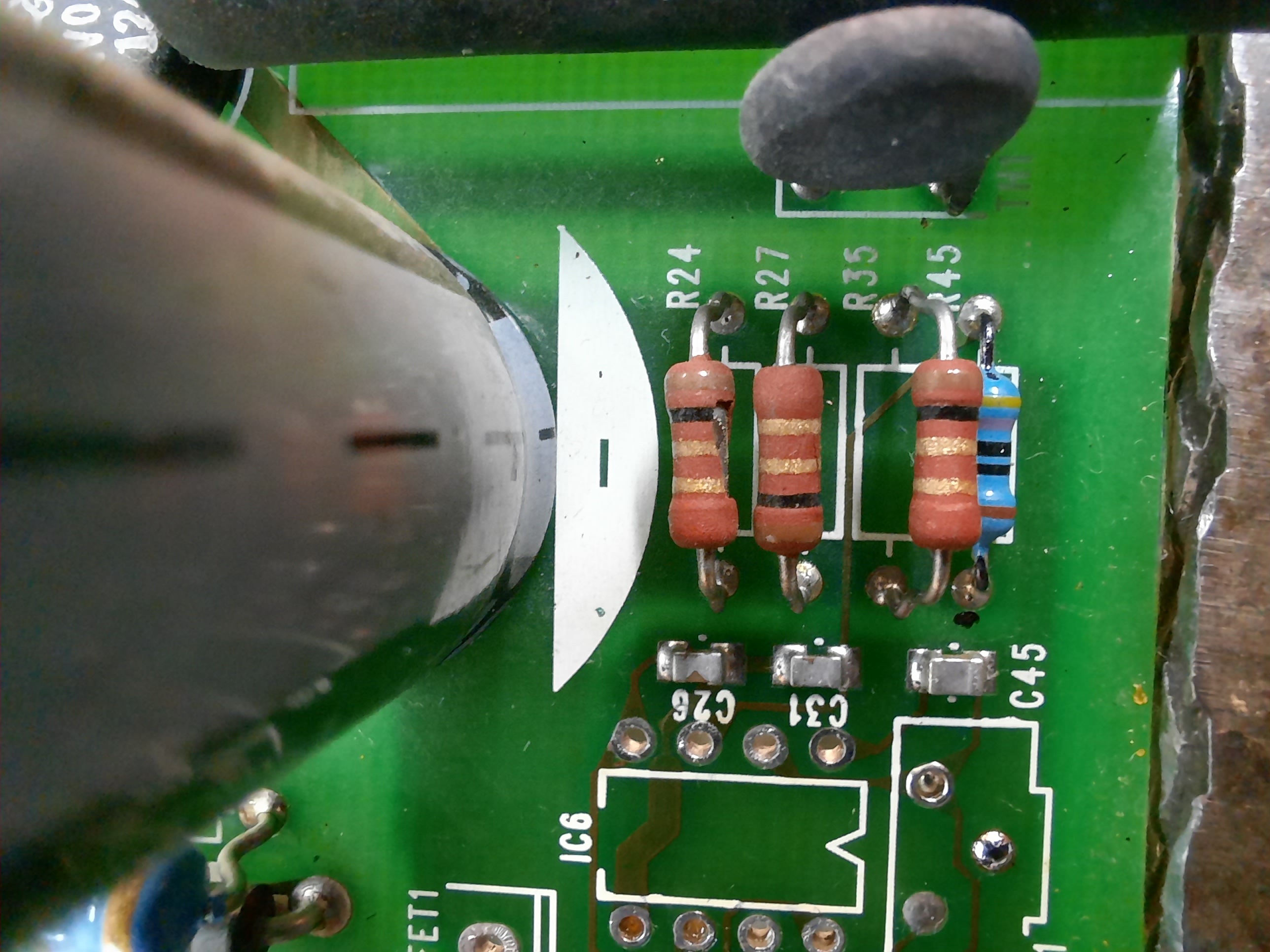

            R24,r27 & r35 , all 1r o/c

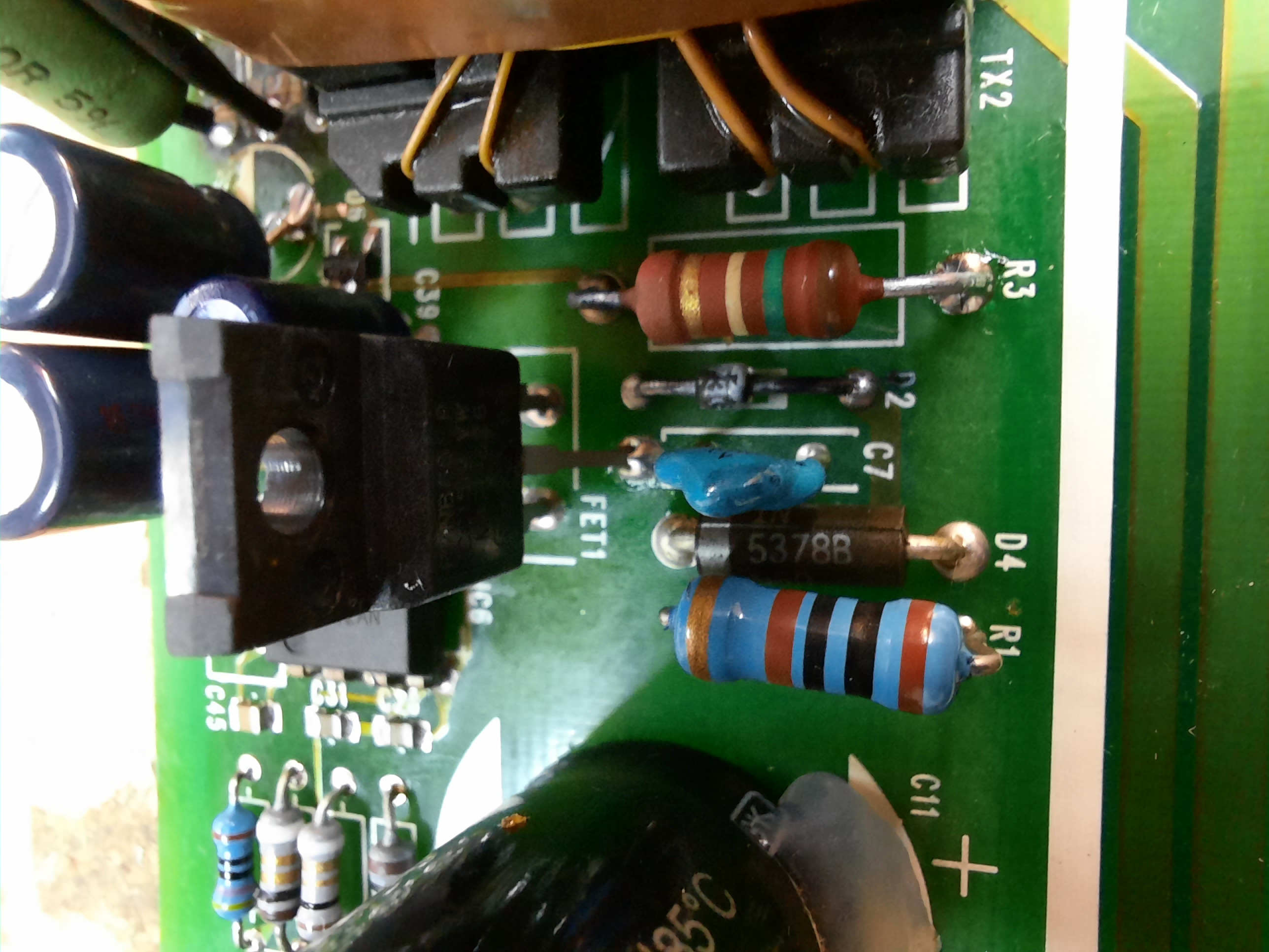

              Last , but by no means least FET 1 ( P7NB60FP ) , S/C . Manufactured by ST Electronics .
              With PSU in stand alone , gradually increased AC supply using the variac .
              No big bangs which is good & all secondary supplies seem to be present .
              Will fit PSU back into mixer next week , when i have some free bench space to test fully .
                  D2 looks cracked, broken and possibly part of the snubber network
                  • zens electronics
                    • Jan 2021
                    • 31
                    • uk
                    Hi redwire , yes it does in the picture but it's absolutely fine .
