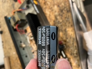

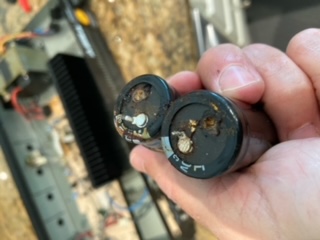

    I picked up a KLH SP-90 subwoofer amp it looks suspiciously like the NHT MA-1 amp. There's a board in the KLH that actually has "MA-1" printed on it. Anyway, it powers on and I can hear/feel a slight "noise" from a subwoofer cone attached to the amp, but I get no audio. The two main caps (6800uf 50v 105 degree, 25mm/45mm) are bulged and I measured "OL" on my meter. The leads fell off as I removed them. Can someone recommend a cap that's in-stock somewhere that would be a good replacement? And would these being "bad" cause absolutely no audio? Thanks!

    You can look at Mouser or Digi-Key for a 6,800uF 50V snap-in the same size.
    As mains filter capacitors, they should not cause no audio. Their leaking may have damaged traces, fuses blown, damaged power amp section etc. so I would look for further trouble.

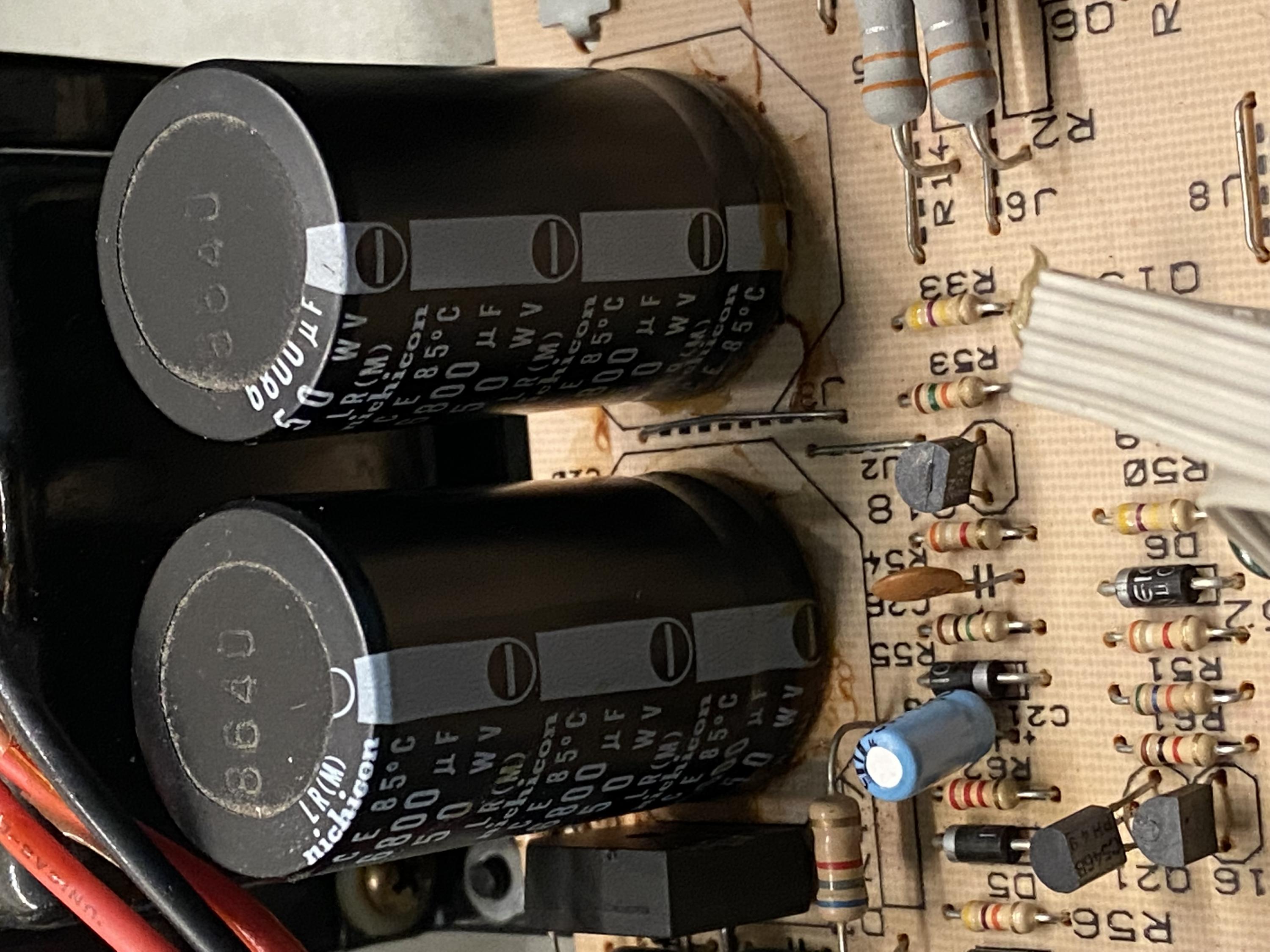

        Ok...either it was those caps that weren't allowing the amp to make sound or it's just a coincidence, but I replaced the caps and it works!
        I found a couple old onkyo receivers in a pile of electronics and other junk on the side of the road where someone was cleaning out an old house. One (looks to be from the late 80's - early 90's) had two Nichicon 6800uf 50V caps in it. I pulled them and they STILL measured very well on my component tester. Capacity as great as was ESR. Popped them in and the amp worked again! It acted differently as well. Before, when you powered it on, both the standby and power lights illuminated and stayed lit. When you turned it off, they both went out. Now, when you turn it on, the power and standby lights illuminate, but the standby quickly goes out. And when you turn it off, they both illuminate and fade out over time.

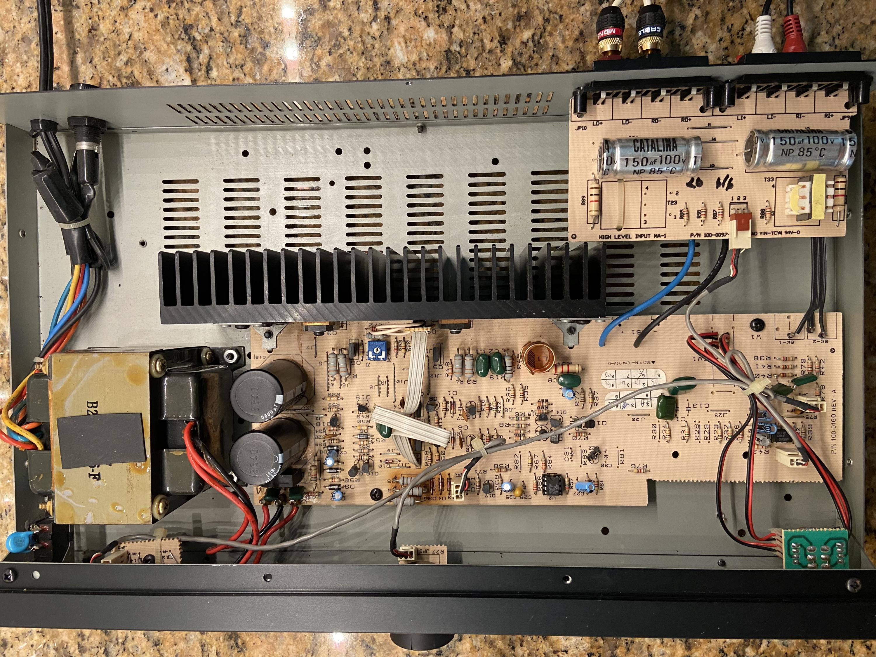

        Now, I'm curious if this is a NHT subwoofer amp (MA-1?) clone or they were just made by the same factory. The high level speaker input board has MA-1 written on it and the chassis' look very similar.

          Ok...found this pic of an opened MA-1 and the boards are rearranged, but it looks just like the parts in this KLH amp...
