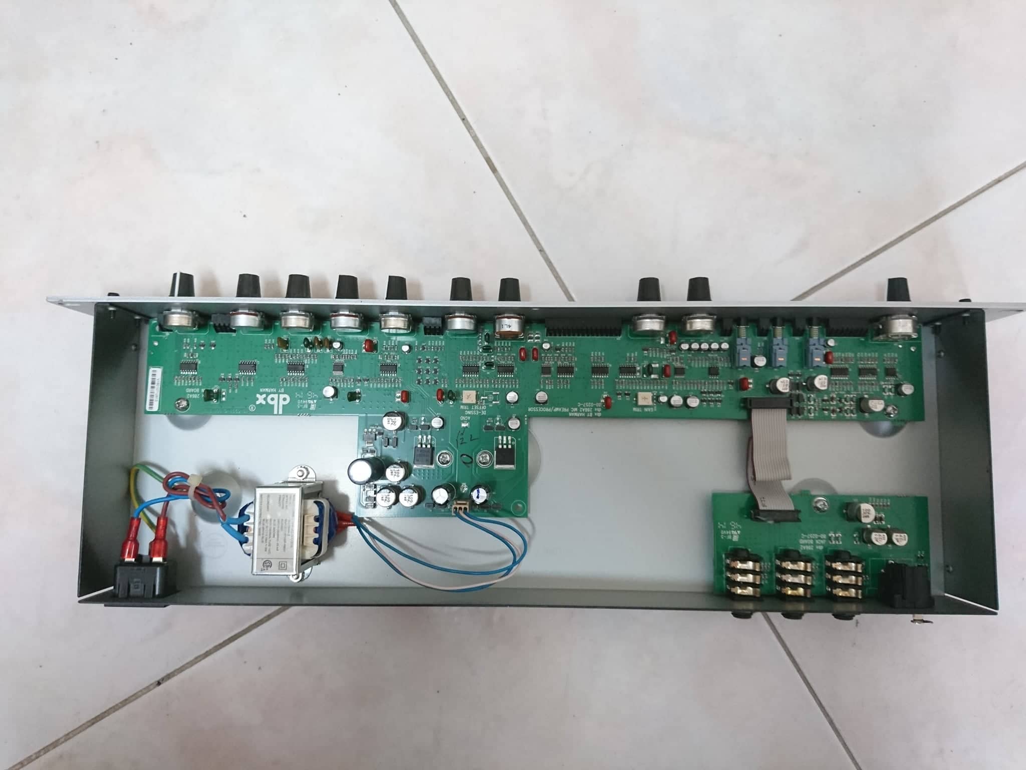

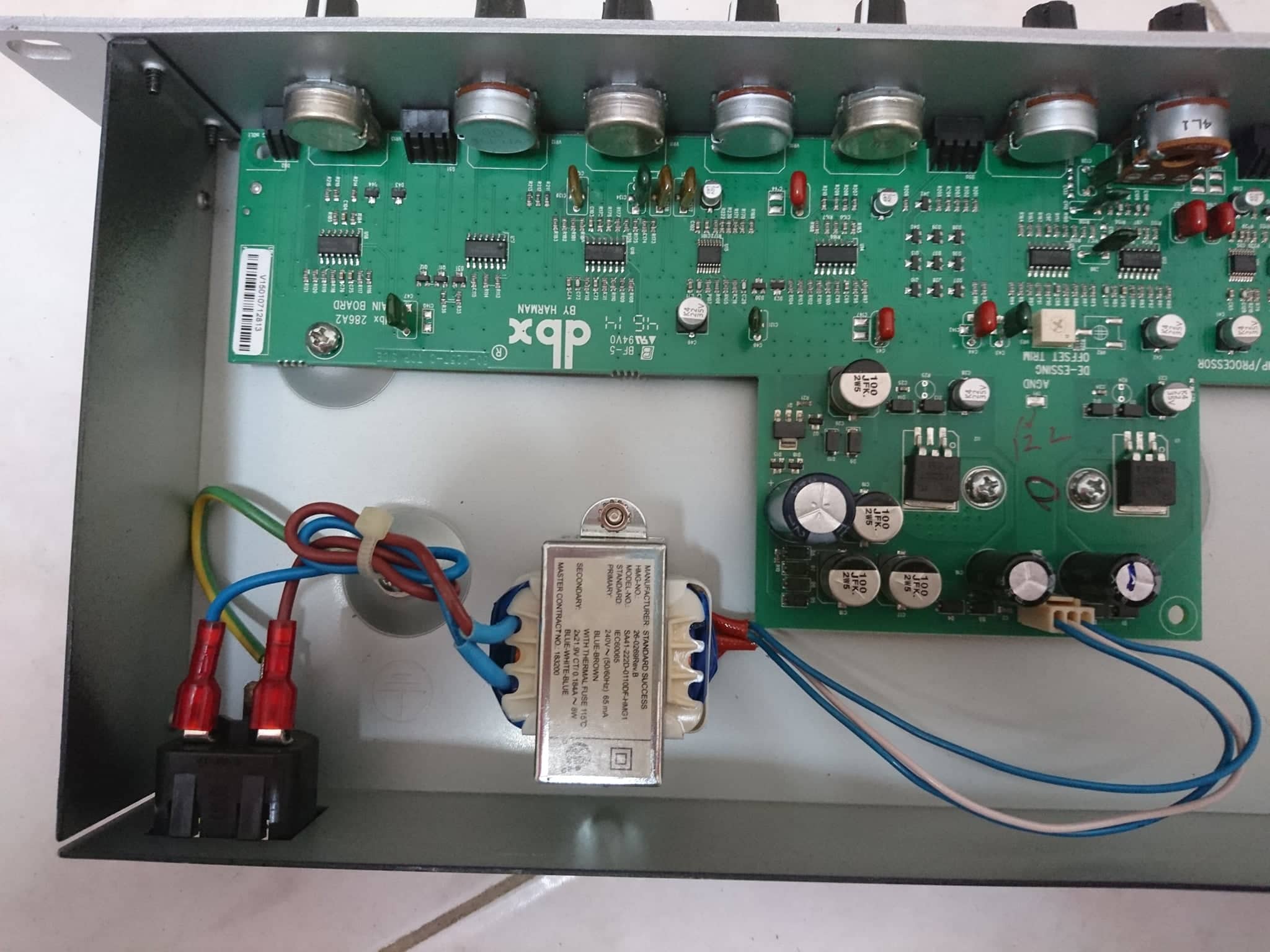

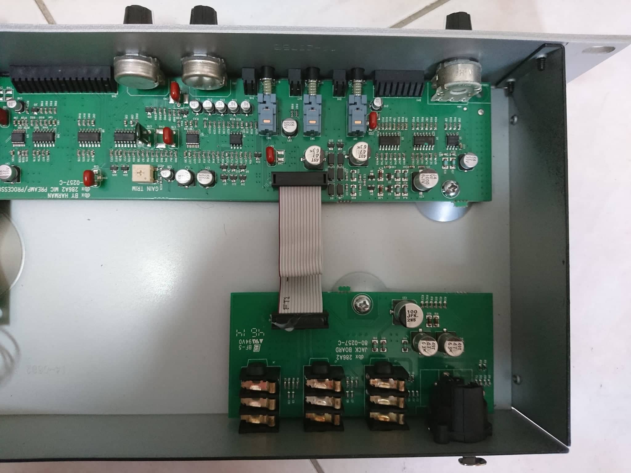

                        Re: Dbx 286 repair
                        these are the photos of the circuit, the only xlr present is the microphone input

                          Re: Dbx 286 repair
                          the 7815 should have +15VDC, while the 7915 should have -15VDC. For the 7815 only having +12VDC something is already off. Either the regulator is getting loaded down, or it is bad as it cannot handle a load.
                          Manualslib has a block diagram for this unit within the regular manual.
                          https://www.manualslib.com/manual/58...S.html?page=25
                          Try bypassing everything processor wise and see if you get output. If no output, the problem got to be in the very early input stages, see block diagram.

                                  Re: Dbx 286 repair
                                  no unplugging anything required. Just press the process bypass button on the front panel. When pressed, a red led should turn on.
                                  If you use a mic, make sure the 48V Phantom Power is on. Other than that you wont get anything from the mic either, if you hook the mic directly to that box.
                                  7815 and 7915 are good, I was wrong to put the test leads, now where could the problem be?
