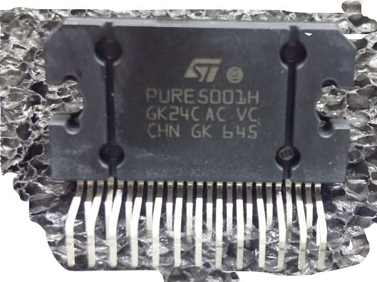

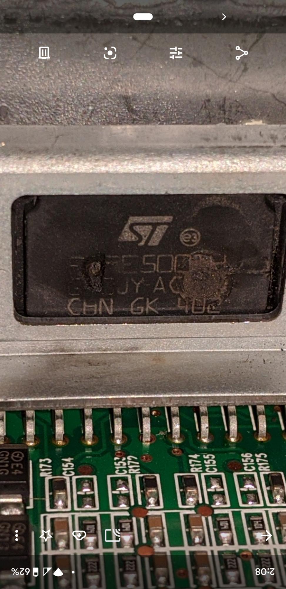

    I need help identifying this blown part that's in the picture I included. It sits inside the unit right up against the back of the heatsink, I'm not sure if it's a power MOSFET or the amplifier, but it has two holes blown in it and the stereo will not power on just more smoke comes out of the part. I can't identify it because the burns removed some of the markings. Anyone have any ideas?

    Here is a free schematic to download for it. Probably the audio ic.

      I appears to be a ST PURE5001H
