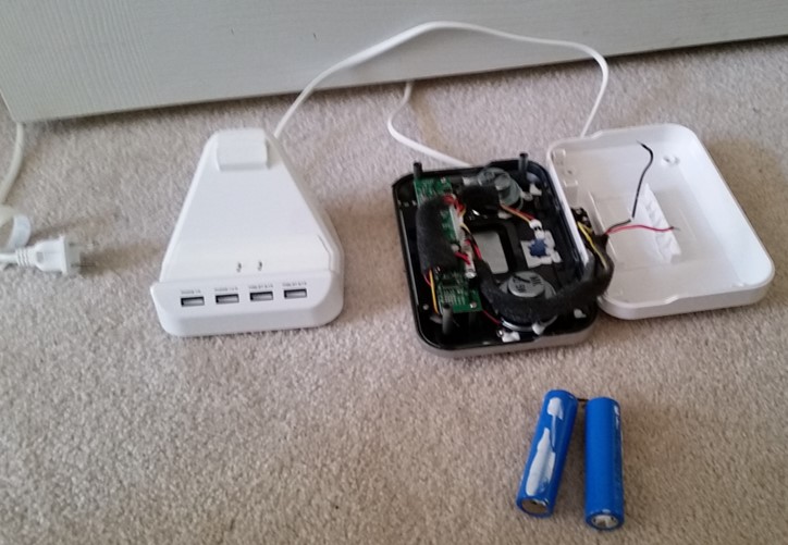

    HI,
    I am taking about my bluetooth speaker as it quit working and i thought i would put "new" rechargable batteries in the unit and see if this fixed the problem.
    When i opened the unit and looked at it i noticed that the battieries (both 18650 rechargeable batteries....3.7V) were connected in parallel (see enclosed picture).
    so my questions are
    (1) i have never seen batteries connected in parallel is this right? why do this
    (2) the old batteries were 18650 3.7V 1800mAh and new ones i got are 18650 3.7V 2000mAh...........is this difference in mAh ok?

    Re: BlueTooth speaker batteries question
    I don't see any picures
    #2: That's fine.

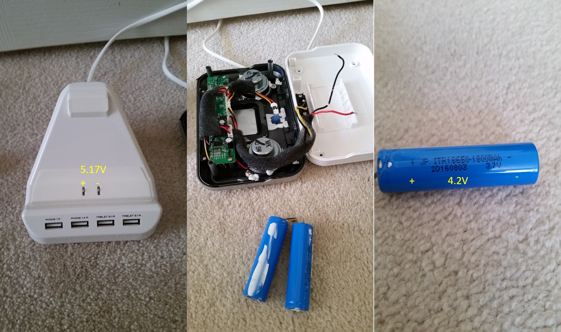

        • Welchs101
          • Sep 2008
          • 979
          i am enclosing a few pics.........
          overall showing all the components...charger + speaker
          another showing the speaker opened up and the batteries laying beside
          and one showing close up of batteries
          note:
          (1) i did measure voltage coming out of charger and it was 5.17 V
          (2) i measured the voltage across both batteries and "each" measured ~ 4.2V
          question (1):
          if batteries measured 4.2V are they bad? my initial thought was no but i dont know.
          i am getting a descent voltage out of the charger so i would think its ok......so now i am not sure whats bad and whats not.
          thoughts?
            5.17V is within the +/-5% "usual" accepted tolerance for things like USB power.
            4.2V is what you'd expect from a fully-charged lithium-ion battery.
            But that says nothing about the actual state / shape those batteries are in. If they're aging (or they were just crap straight out of the factory), their internal resistance may have climbed, and when the circuitry needs a bigger "gulp" of current, the voltage drops (Ohm's law), possibly below the brown-out level (or undervoltage cut-off) of said circuitry.
