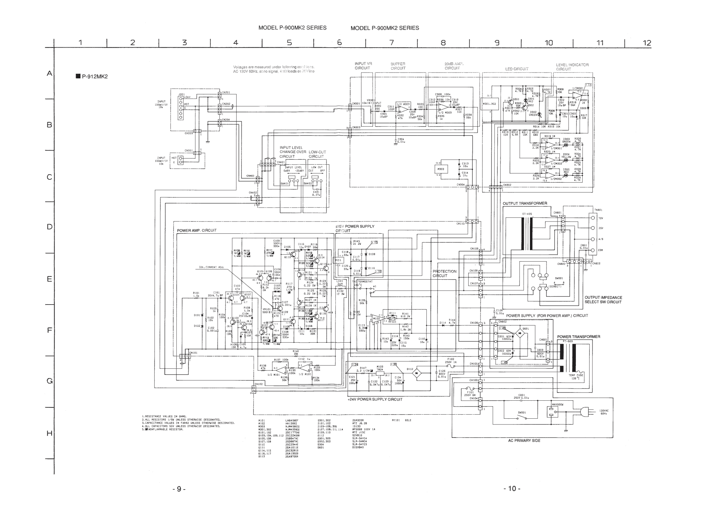

          If you can post the schematic you obtained, that would help.
          If a resistor (in circuit) reads higher than rated value, reverse your meter's leads and see if the reading changes. Sometimes DC voltage stored on a capacitor nearby upsets the multimeter reading. Otherwise, the resistors are damaged I would say.
          If the output transistors shorted, the fusible emitter resistors 0.22R would be open circuit. Some resistors used here are fusible types and look fine but can go open circuit. They have a square symbol next to them on the schematic.
          I would keep checking parts. Or you can take more voltage readings with the amp powered on, carefully at each transistor and write them down. This is another way to troubleshoot.

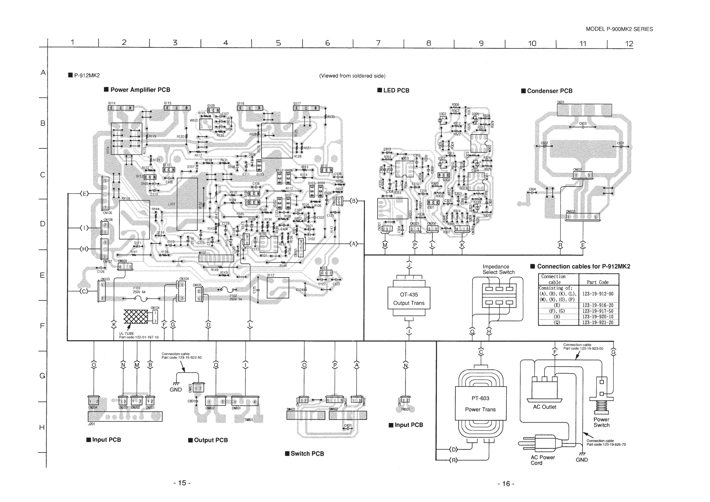

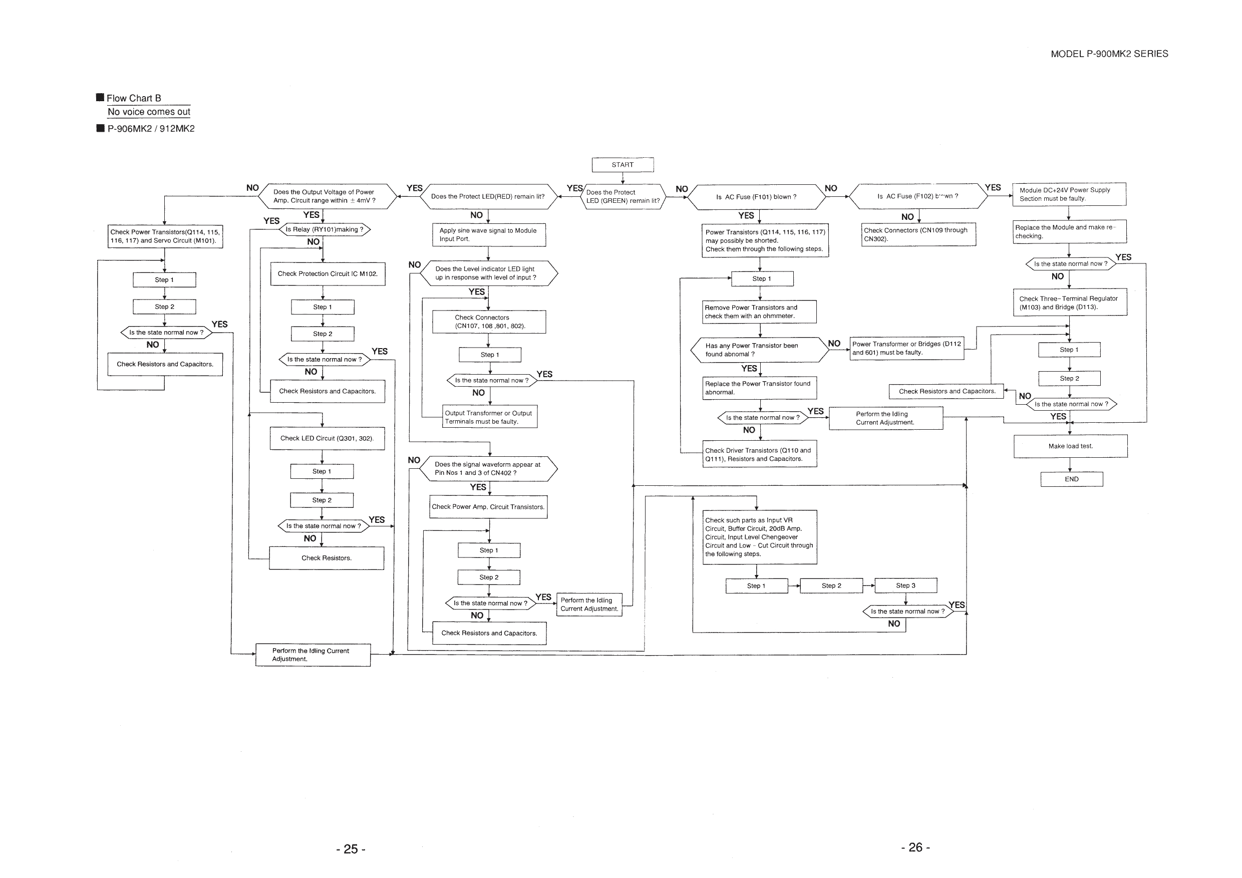

            See attached schematics and troubleshooting guide.

              R145 & 146 are 2k 2watt, so they are ok.
              What is the voltage that is measured at (L101) or where the two .22 ohm 5 watt resistors connect together. Note the polarity of the voltage if it is not zero. You can NOT look at a transistor and say it looks ok, you need to at least check them with a meter, even if the transistor is leaky or if a resistor is (ie higher than its value) is enough to unballance the amp and trip the protection circuit

                There are many different approaches to fixing audio power amplifiers.
                You can start at the power supply, the amp input, the output, the middle etc. or use your eyes to see damaged parts or, use educated guesses. The point is to be a detective and have fun.
                Note this amplifier uses a servo circuit op-amps M101 which work to keep the (idling) output at 0VDC. I would also check if its power +/-15V from zeners D109, D110 is OK. Sometimes the amp is fine, but it's the support circuitry that is misbehaving.

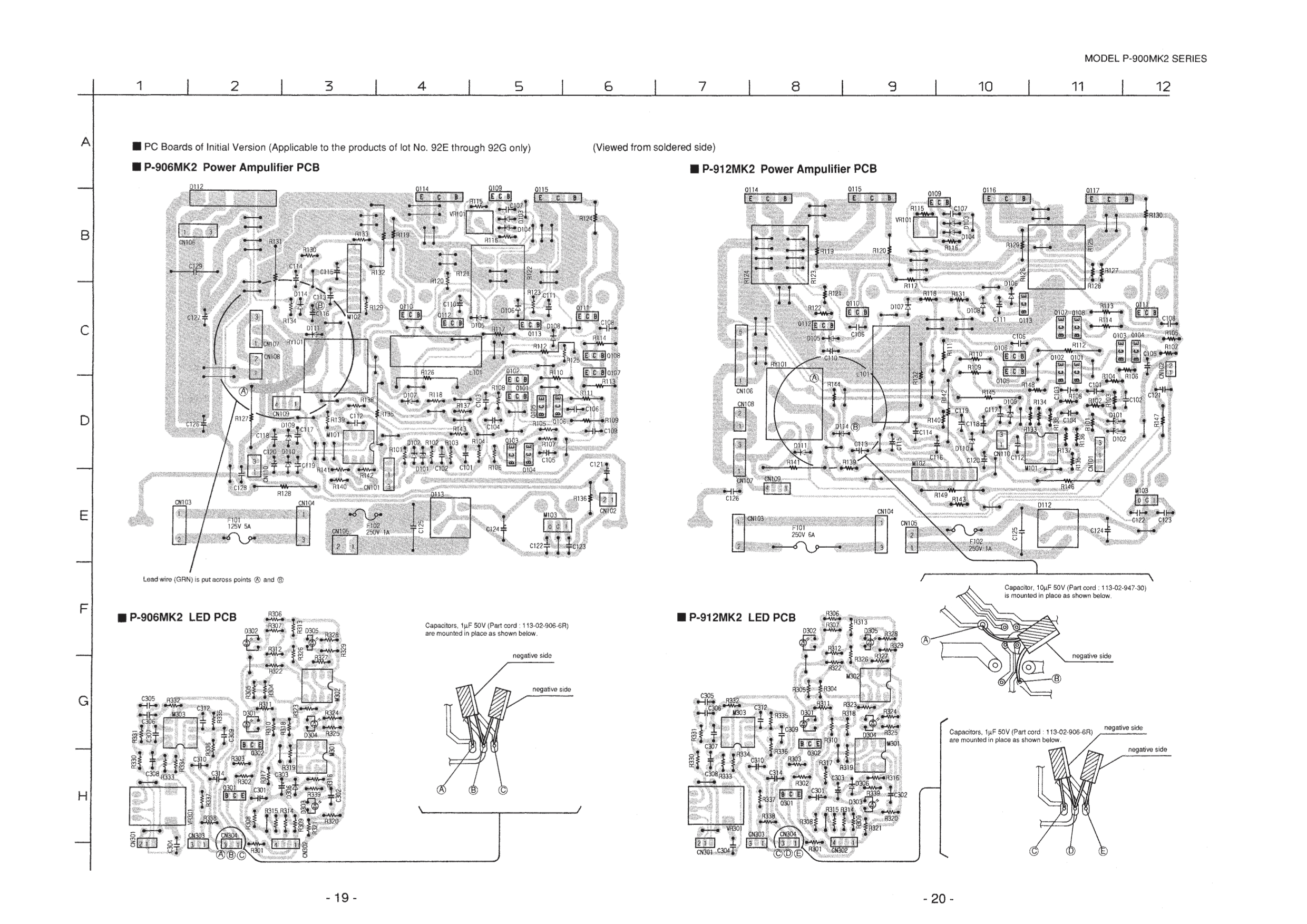

                                I looked at a couple other schematics and R111 is shown as a 27 ohm
                                It may depend on the version 'A-912' vs 'W-912'
                                Here is another manual, schematic at the end
