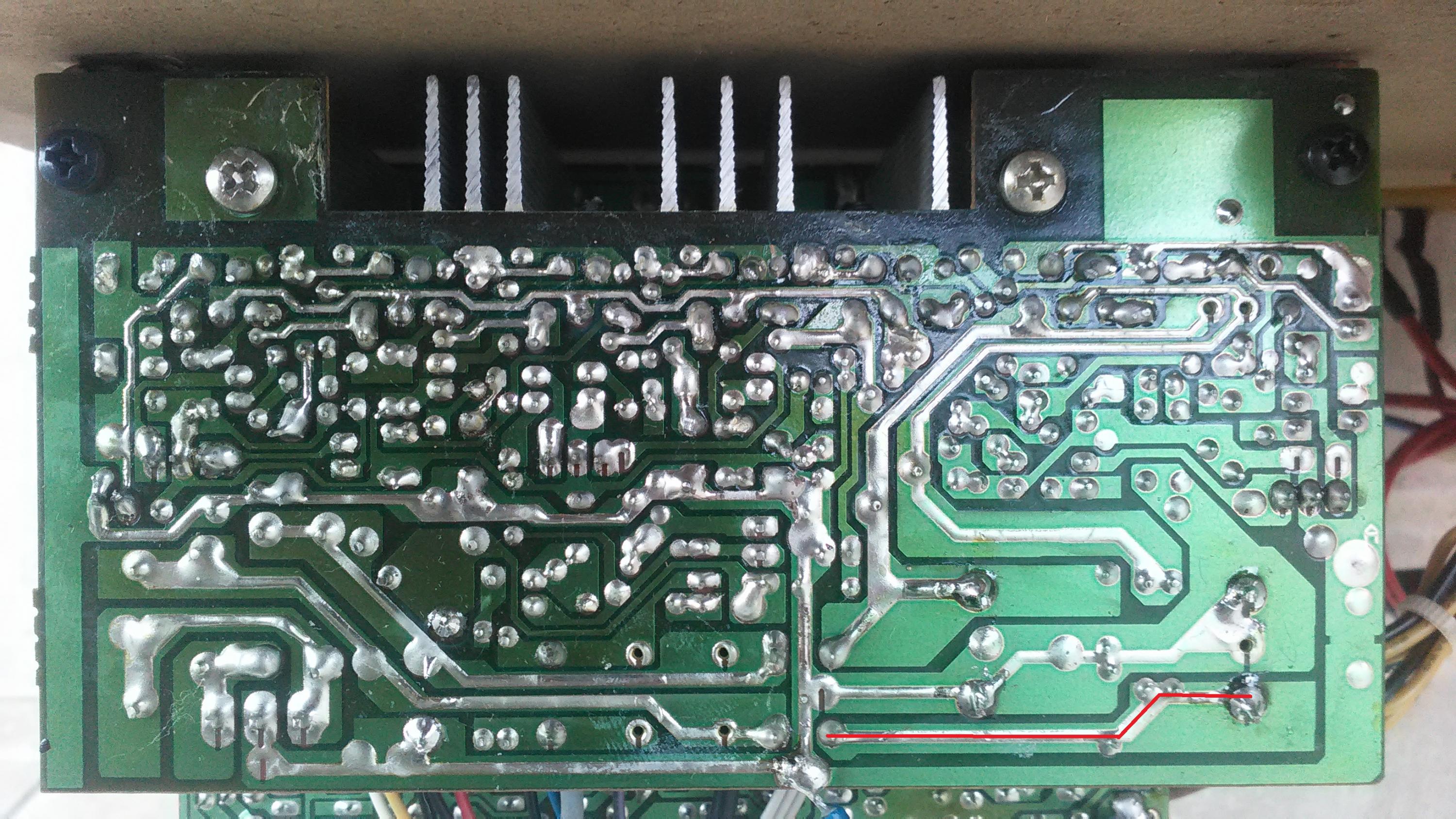

    The heatsink is not connected to the circuit ground, right? Does the heatsink have the electrical connection the Negative power supply?
    It sounds like you have bad connection since it works some time.
      Re: Watson AS4541 no power
      Checked the connection between the heatsink and transformer input jack pins - none or the 3. Next I started searching for connections through the board and found out that this branch is actually connected to the heatsink.
      Another thing that I noticed is that this one jumper maybe touches a diode it shouldn't so I separated them as best as I could. The result was the same.
      I don't know what told me to check the fuse again and I found it with a burn mark on it. Checked it and yup it was broken in one of my previous attempts of testing. I am on my way to the electric shop to buy few more of the same kind.

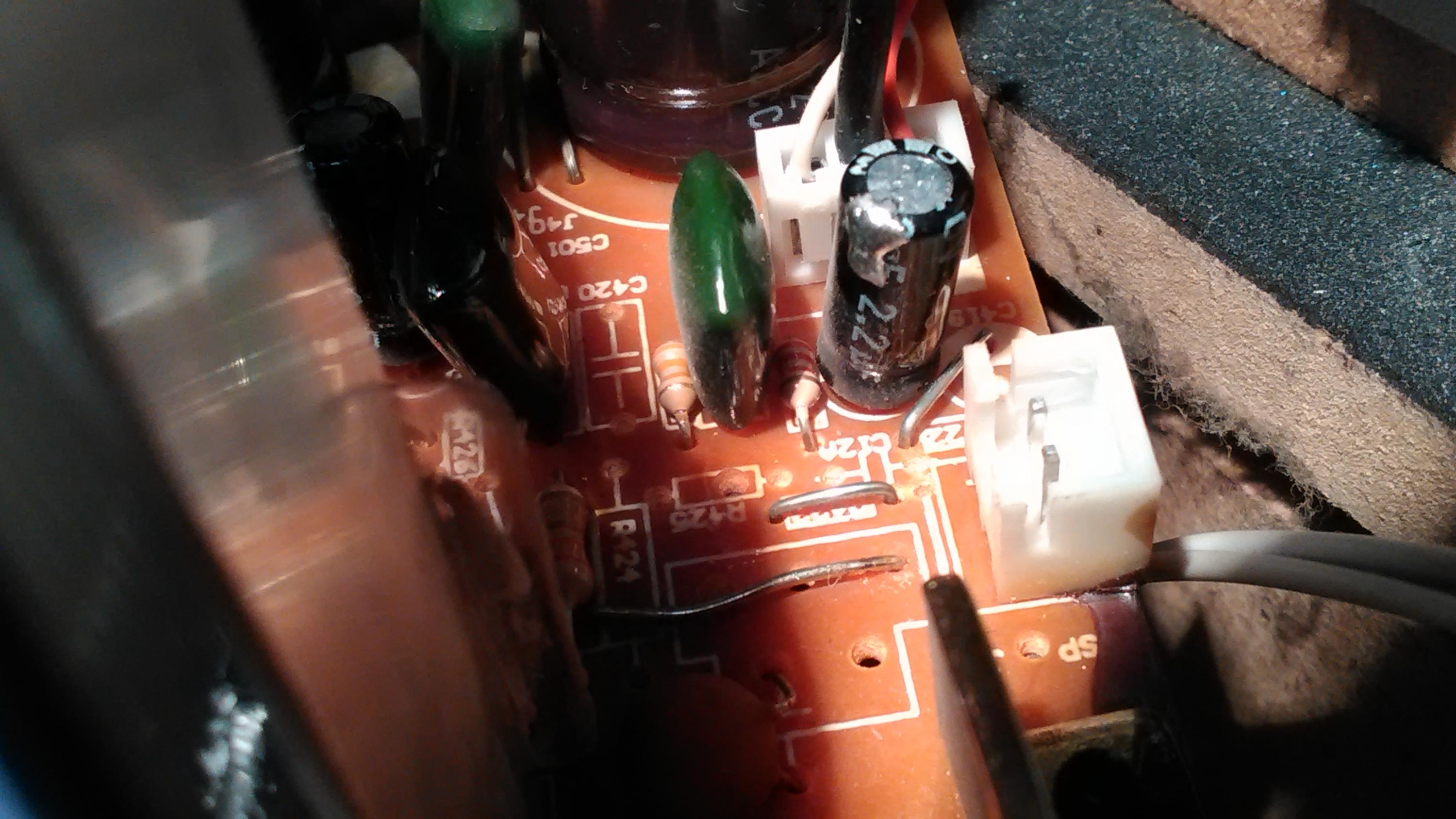

                I found the exact same fuse. The woofer worked for a whole day. This morning when I started it it wouldn't power on. After opening the case again, disconnected all cables, found two "might be bad" caps. After putting it all together without doing anything else it worked again. And it still works but I guess its just a matter of time for it to stop working again. here are the pics of those two caps, could those be bad? The one has the same orange-brownish goo on and under it, I am guessing its only the secure glue.
