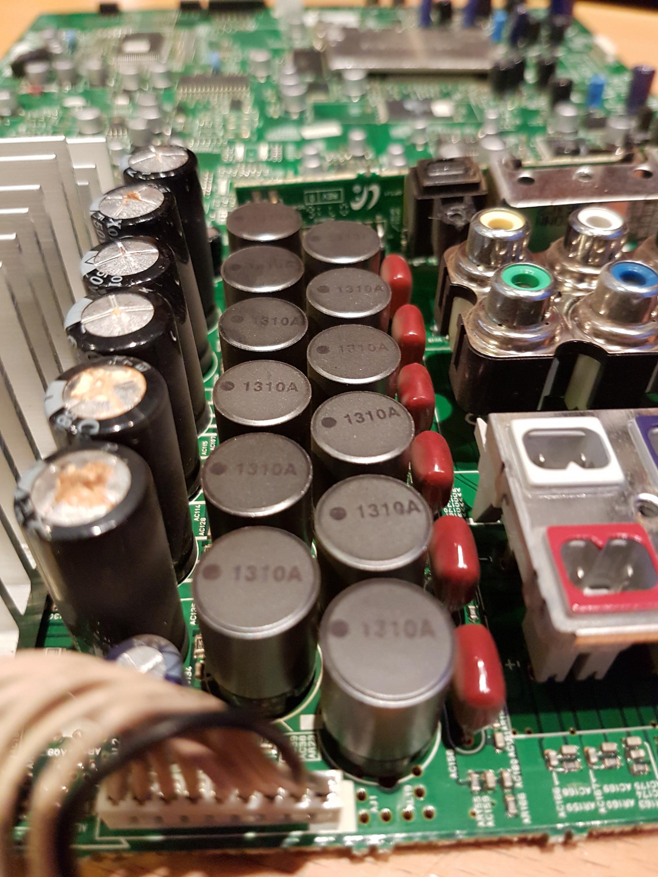

    I was doing a cleaning and cable management in the living room, noticed how
    my AV was really dirty, so I decided to take it and do some dust cleaning.
    I opened it and noticed all the large caps for the audio are bulged.
    They are Capxon 680uf 50V, everything else looks to be OK, so i'm just going to replace them all 5.
    Should I stick with 50V caps or should I go a little higher voltage as long as the space allows it?
    Is there anything else that I should change also since I'm going to do the surgery?
    The only problem with it was that the sound would sometime drop in volume
    and some speakers would become quiet or extremely low volume, to "fix" that
    I just raised and lowered the volume few times and it would usually return to "normal",
    it kinda descripes like when the analog volume knobs would go dirty on the old sterios.

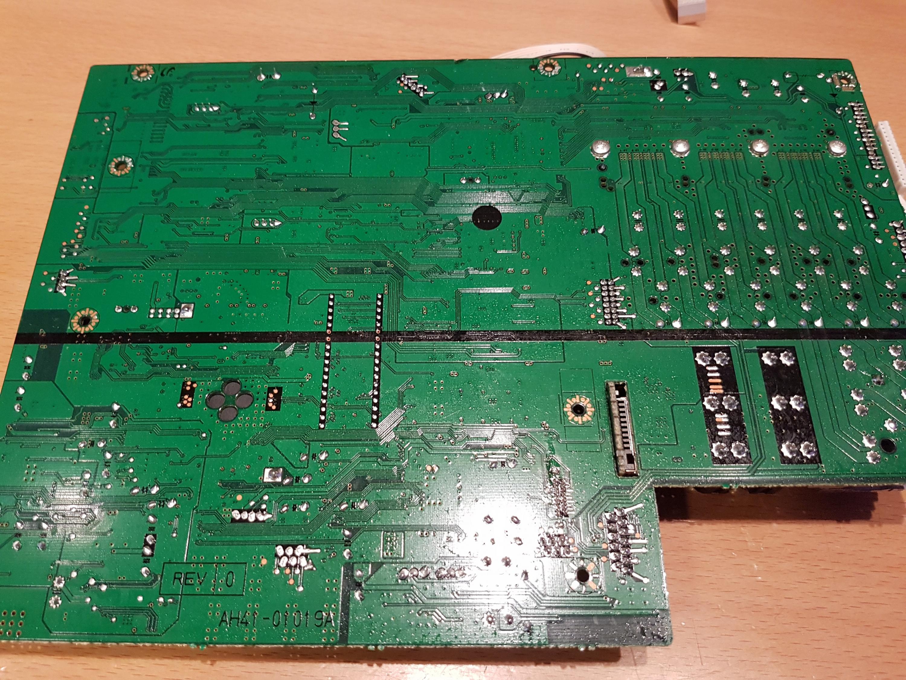

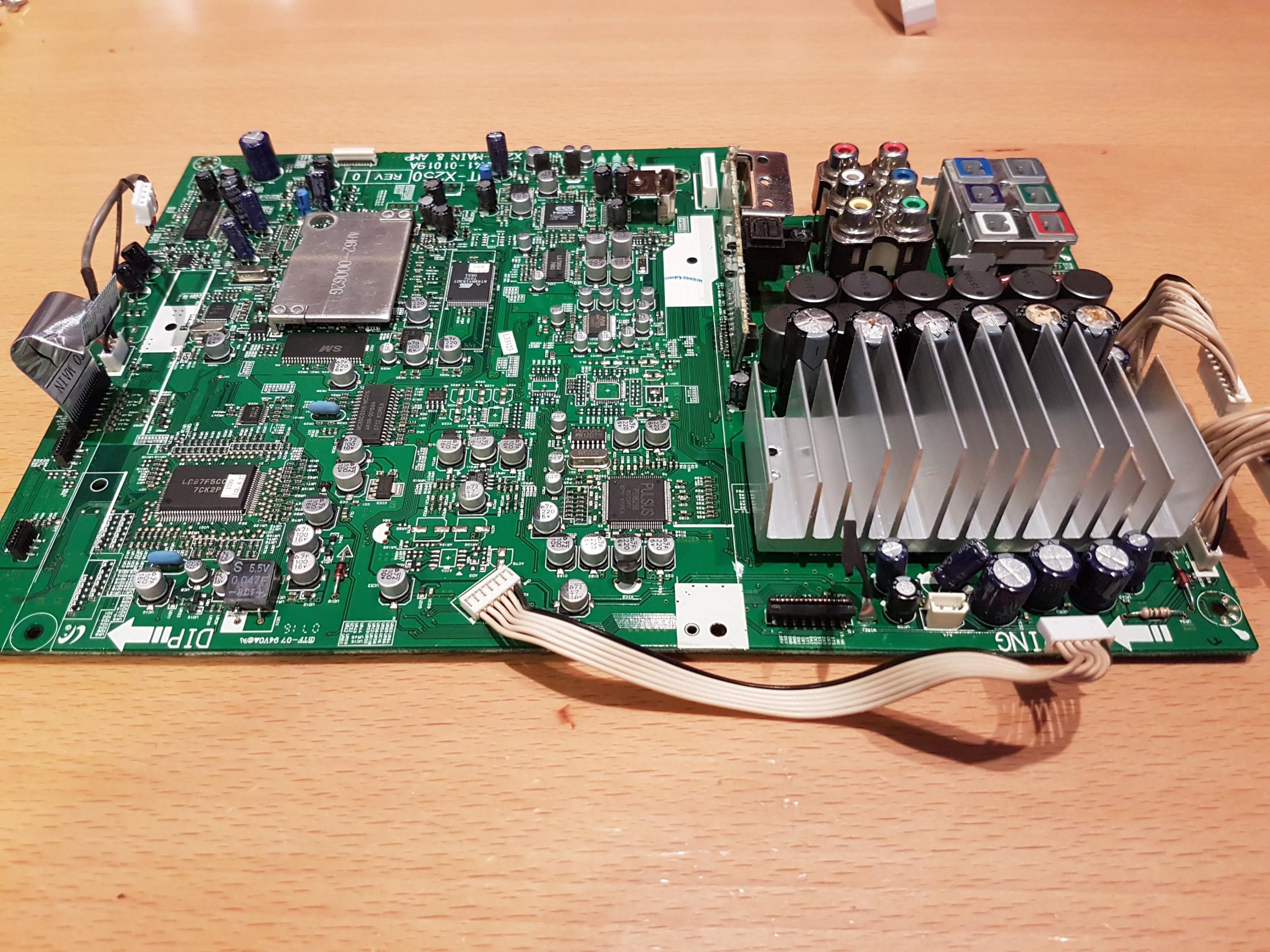

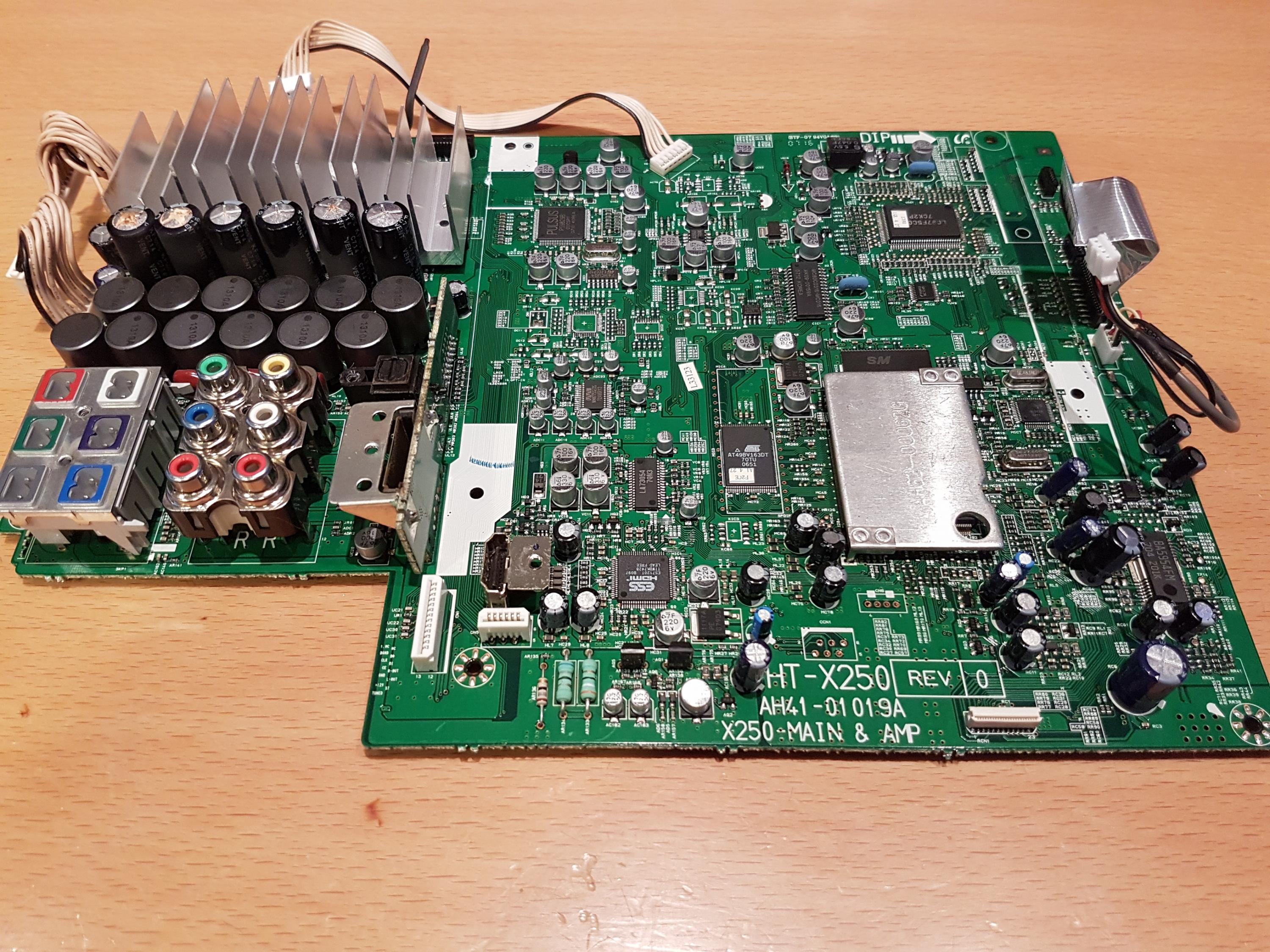

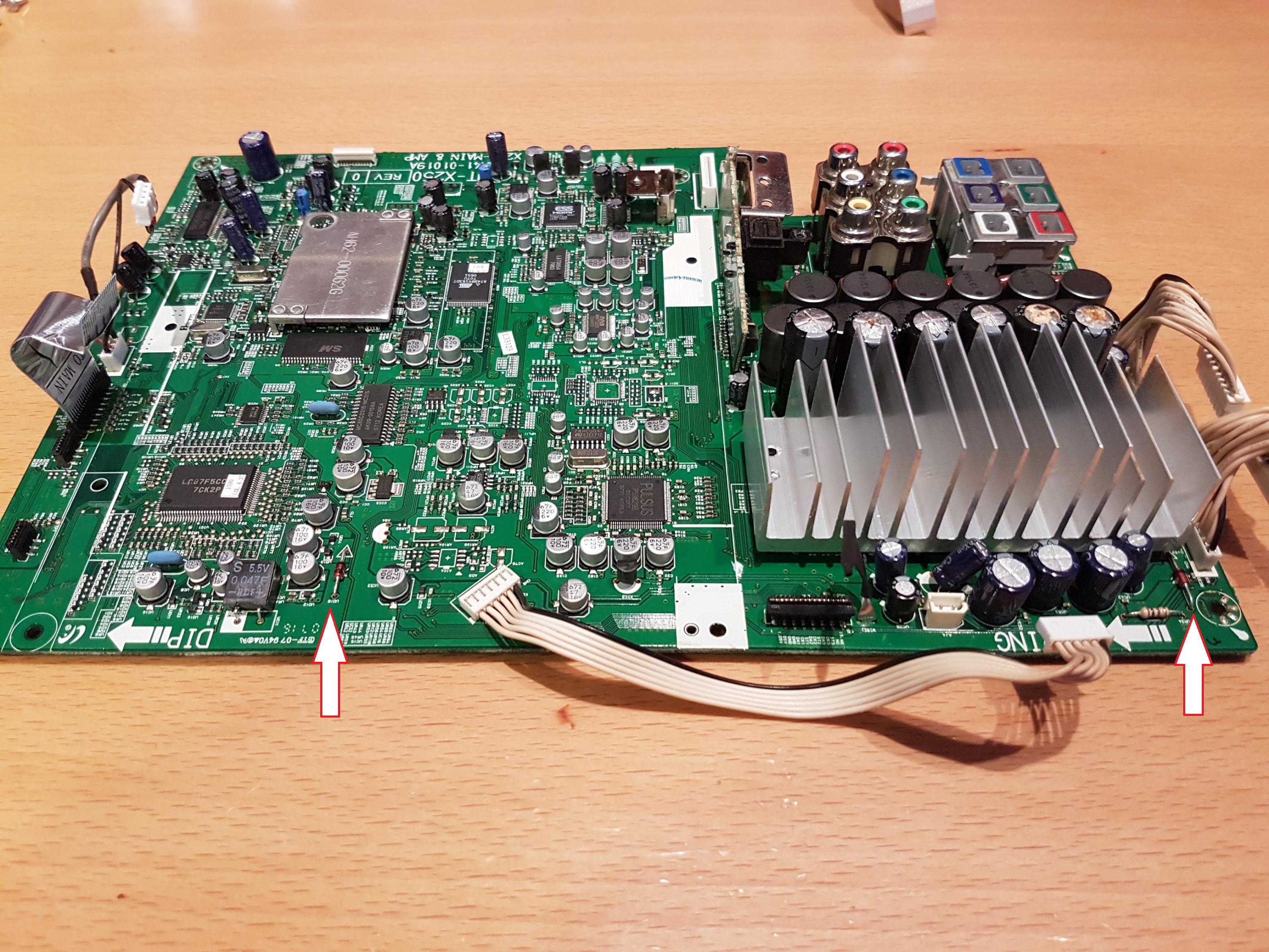

              Re: Samsung HT-X250
              From manual I found just 3 zener diode:
              RD2 0403-001062 DIODE-ZENER;UDZ4.7B,4.55-4.75V,200MW,SOD
              UD18 0403-000398 DIODE-ZENER;UZP8.2B,7.7-8.7V,1000MW,DO-4
              UD19 0403-000139 DIODE-ZENER;1N4734A,5%,1000mW,DO-41,TP
              UD18 is on the left (figure)
              UD19 maybe is on the right (figure)
              RD2 found on the schema (1-1. MAIN PAGE) but not found on the board.
              Which one must be replaced for my problem?
              Must I replace even the caps of the first post?
              Please help me.
