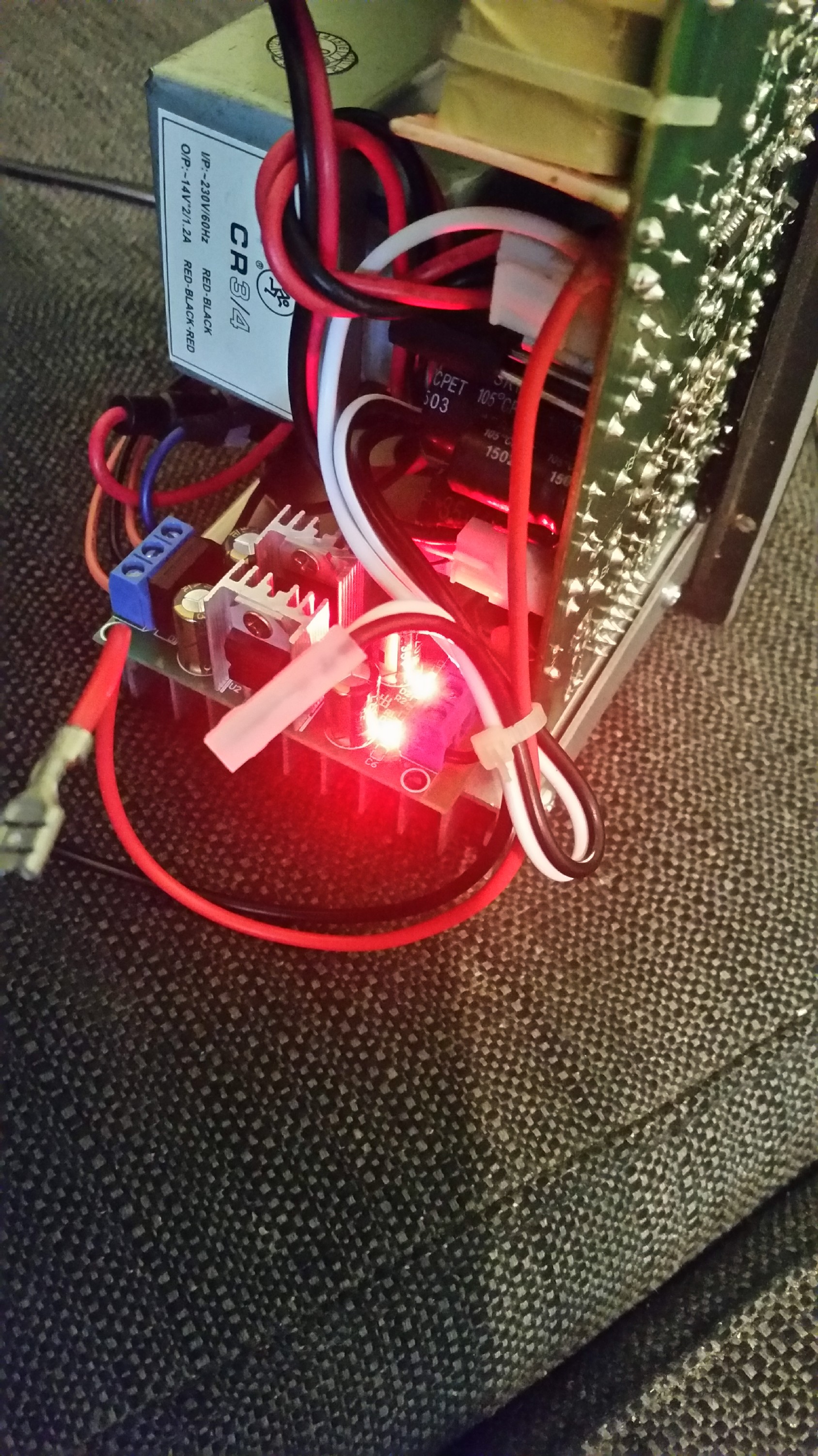

      Guys, I just want to add an update to the problem regarding the overheating +/-12 regulator on this PCB. I ordered and finally received the dual voltage regulator module based on LM7x12 parts (after 29 days of delivery time). I ordered two of these for $6 and they seem to be built quite sturdy. Both positive and negative rails have an input and output filter capacitor rated at 35V220uF. The two red LED indicators are SMD parts, and the PCB looks clean and quality soldered.
      I installed one of the modules into the powered speaker. The red light from the LED indicators does not bleed through any opening on the front side of the speaker. Of course, the procedure may or may not apply to your set of speakers. Should you try to do any of this, the responsibility falls entirely on you.

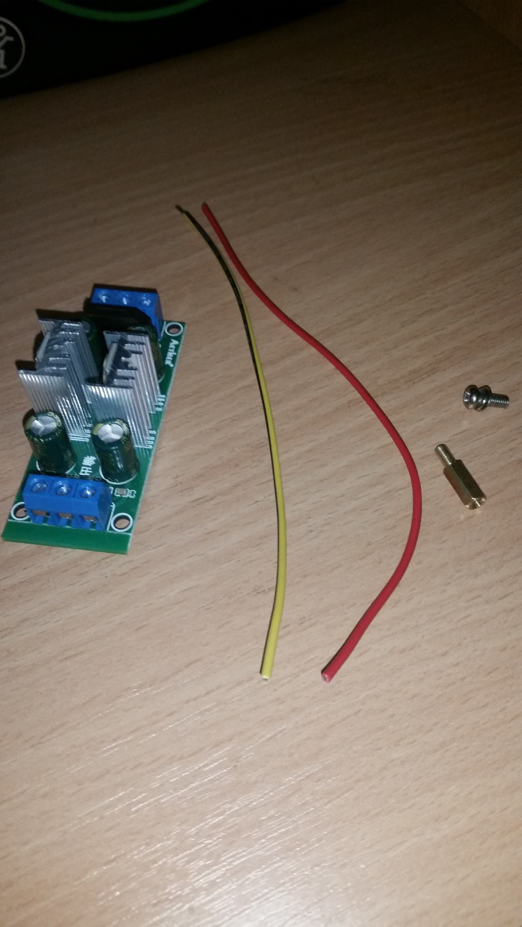

      Items required (in my case anyway):
      1 X LM7x12 1V dual voltage regulator module
      1 X M3 stand-off with one end bolt-threaded (I only had a 10mm one)
      1 X M3 screw (I used one with an integrated washer and a spring-washer)
      5 X pieces of wire (I used those from and old PSU: three for input and two for output)

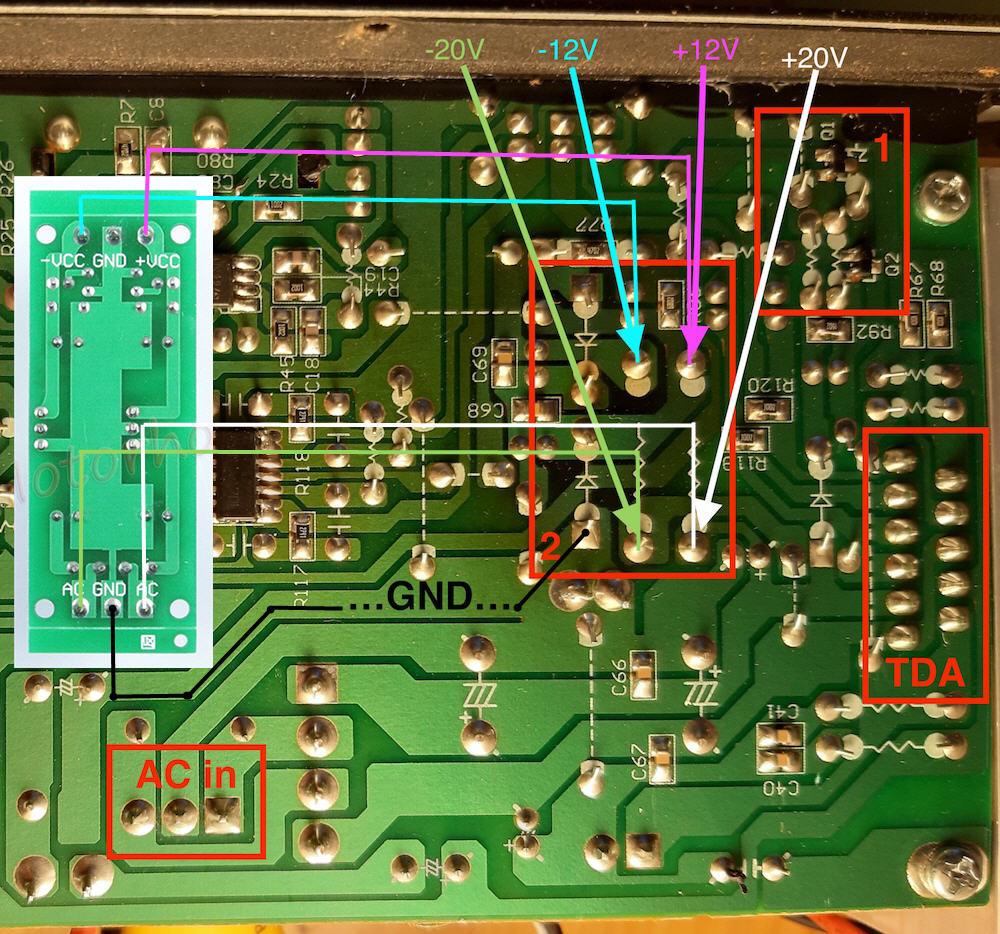

      Now, I have included the pictures of the module and the schematics. They are not the clearest as this is the first time I have done something like this and I used the image previously mentioned in the German author's post. But at least it's something.
      The module has an input connector, which needs two +/- AC lines and a ground line to work. The ground on the input side simply passes to the output GND connector, which is why only the input GND wire is required. There is no need to mount the GND wire on the output end.
      Also, R1, R2, Z3 and Z4 components need to be removed from the speaker's PCB. Clear their holes of solder as wires can then be threaded through the PCB and soldered on the other side.
      1) Now, the AC inputs on the module are to be connected to the incoming voltage points on the PCB (+ and - 20 V in the image), where the pins of the resistor used to be soldered. You can connect those points to the AC input on the module any way you like because the module includes a rectifier and allows both AC and DC input, so it will sort out the rails as necessary.
      2) I connected the GND wire to the point where a zener diode used to be soldered, as this point is the actual GND rail on the speaker's PCB.
      I used a black wire for the GND, and orange wires for each of the AC input lines.
      So, the wires connected to the speaker's board, going from the left to the right, are Orange (+), Orange (-), Black (GND).
      3) The module dynamically outputs only 12V of the incoming voltage. These are the rails that we need to connect to the speaker's PCB where zener+resistor combo used to output the 12V (take a look at the included photo). The output connector of the module is connected to the second point of R1 and R2 respectively. Now, here you must not make a connection wrongly. The positive goes to the +12 marking on the PCB, and the negative goes to the -12V on the PCB.
      I used a black wire for the negative, and a red wire for the positive output.
      So, the wires connected to the speaker's board, going from the left to the right, are Red (+12V), Black (-12V).

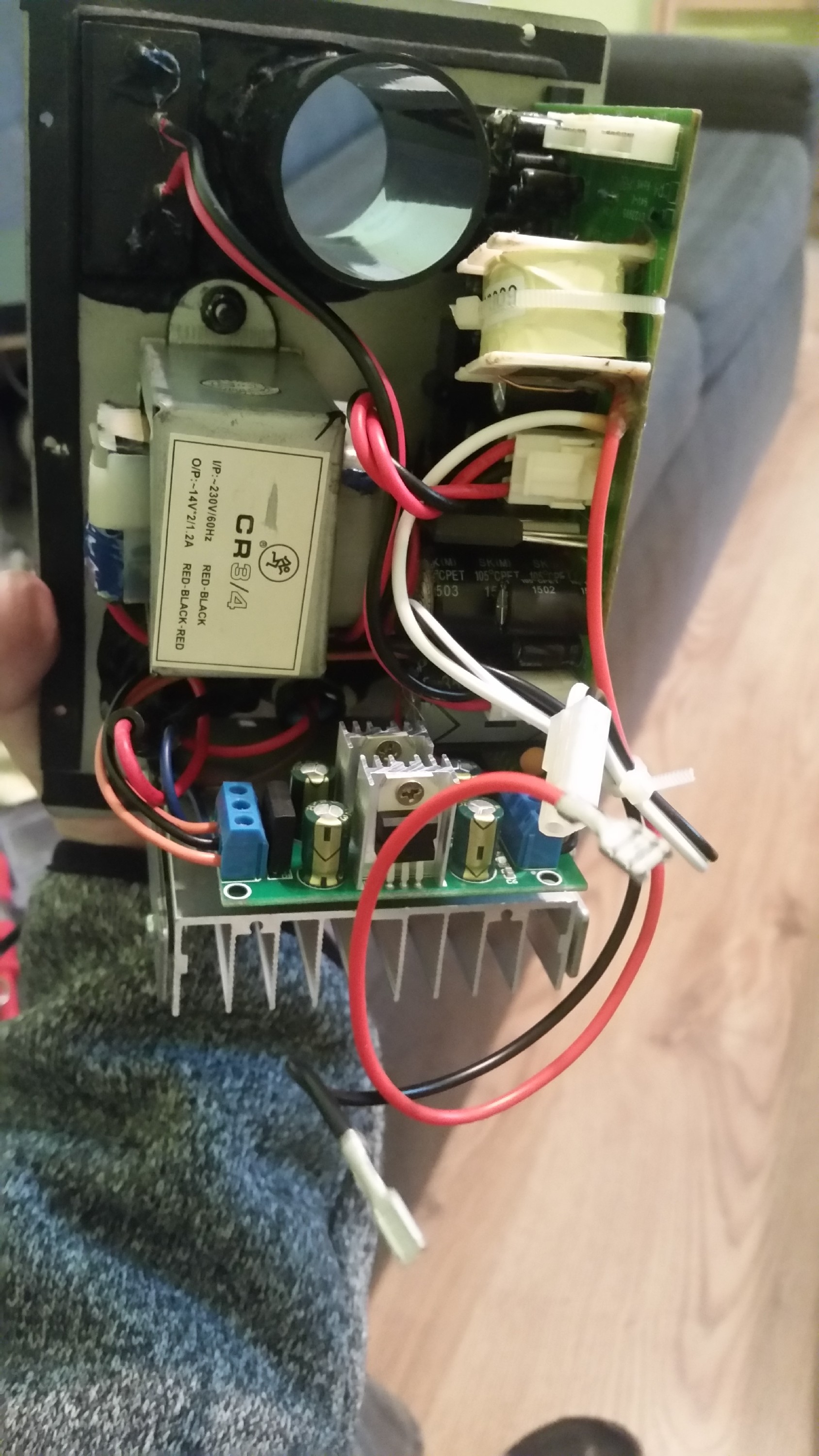

      Now for the mounting: I removed one of the screws that mounts the heatsink to the metal holder on the PCB. I used the stand-off as a screw to re-fasten the heatsink mount, and then mounted the module onto the stand-off. I didn't remove the heatsink to drill another hole because it would require to remove the amplifier and there was no need to do so. One screw with a spring-washer is all that it took to fasten the module sufficiently, so now it kind of floats 10mm above the heatsink.
      The clearance between the magnet of the 4" driver and the back plate is 12cm. When the module is mounted like in the photo, protruding slightly toward the driver, the overall length is 10cm, which leaves 2cm of clearance for the wires inside the speaker's casing - more than enough. So nothing is hitting or compressing anything.
      Please take a look at he included photos and give me your thoughts on this. Hopefully, this can help others in repairing their Mackies. I don't know why the company chose to use zeners and resistors, especially if they get hot enough to burn the PCB an potentially cause fire. A 3$ part really wouldn't increase the price to much. Unless planned obsolescence was into effect.

        Same HP and same problem but not opened for the moment probably burned too.. never understand manufacturer to put noname cap and design bad pcb we should use 24/24h 7/7d just for return under warranty each time
        Are you happy about the result ? No more heat ?

          I'd asked myself the very same question, so I had to reopen the powered speaker while it was on for over two hours just to inspect the inside situation. The results are that the PCB no longer becomes hot at that R1/R2 area. The regulator module itself works quite cool, its heatsinks were barely mild to the touch and I think they actually warmed up to the inside temperature of the powered speaker, which would rise after a prolonged use due to the transformer. But the PCB itself no longer felt hot to the touch in the designated area. Of course, mounting the power supply externally would reduce the inner temeprature drastically. I haven't done that (yet) so I suspect some more of the smaller caps may eventually fail due to the heat. But at least (hopefully), nothing else will burn.

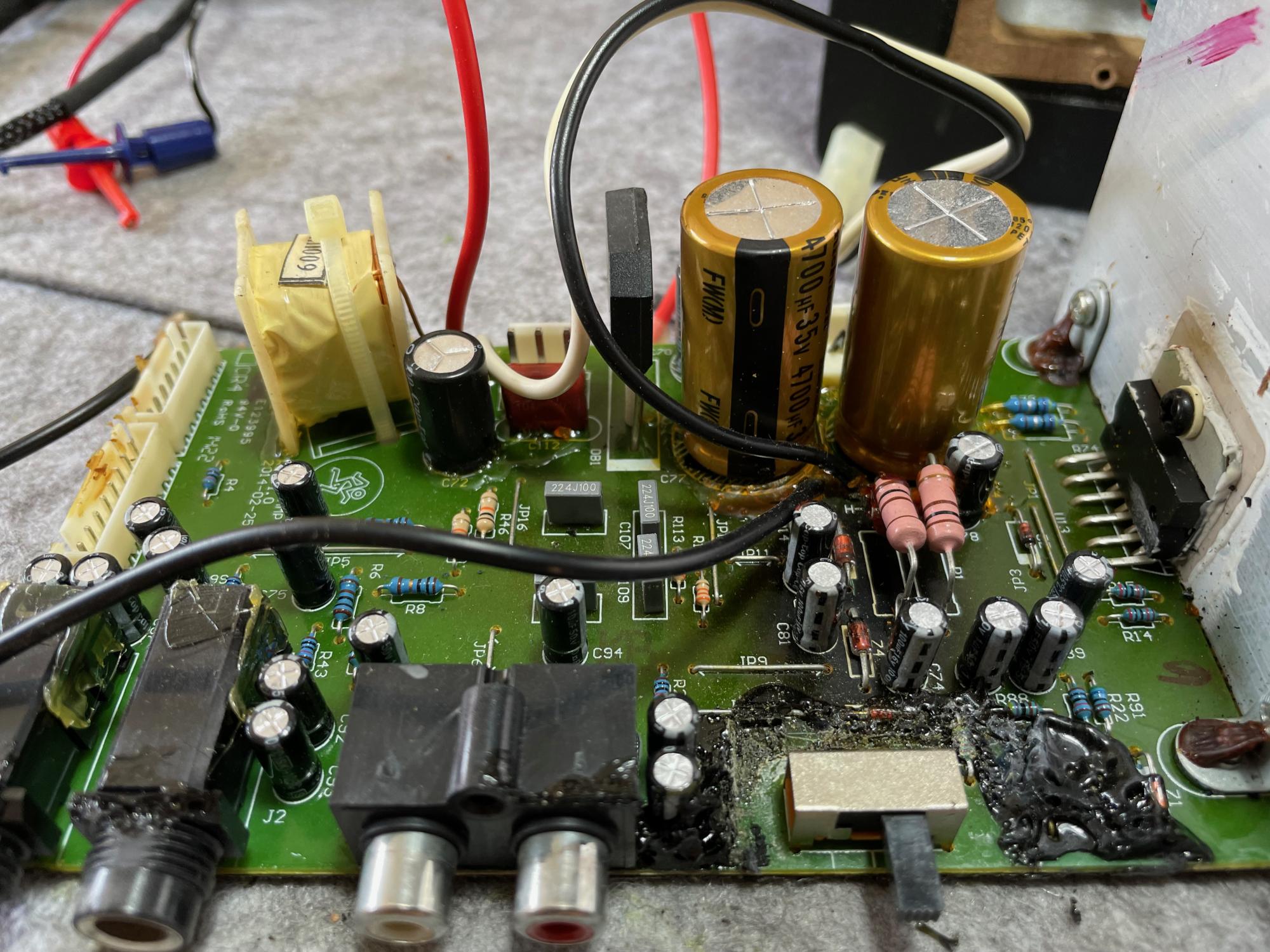

                        Thanks to this thread, I just replaced the capacitors and removed the failed DPDT switch in my CR4.

                            Implemented my own variant of this fix. I had more damage around the PCB that affected the mute circuitry though.
                            https://fillwithcoolblogname.blogspo...r4-repair.html

                                As I'd mentioned in a previous post of mine, I also bought one of those modules but did not know how to wire it. Actually, turns out that I had wired it just fine. Your post confirmed it. I also removed Z3 and Z4 (one of which literally fell apart!). My board is heavily burnt and damaged with cracks. By analysing the photos of traces, I managed to wire components together correctly where the traces had burnt or the board had cracked.
                                ​​​​​​Other changes for me were:
                                I had also cut the mute pin on the TDA previously. I left it like that.
                                I replaced all of the 100uf16v caps around the burnt 12v circuit and also a 1uf16v cap around the area.
                                I removed the L-R switch and jumped it in the R position as my switch was failing.
                                Things seem to work for me now...almost...
                                Maybe someone can share some insight on what I can do next:
                                ​​​​When I turn the power on the speakers, even with the volume at 0 (and the front LED off), they start to make an electrical buzzing sound out of the powered speaker...kind of like when you half connect a 3.5mm audio jack. I can't really explain it, but I suppose some current is leaking into the audio circuit. No input audio works even when I turn the volume up, I only hear this sound. The volume switch doesn't increase the volume of this sound. The headphone jack does work as usual, but the main speakers still buzz.
                                I found that by SLOWLY moving the power switch from the off to the on position, it resolves the issue...or I can turn the power off and on rapidly and that sometimes works. Then the buzzing sound stops and the speakers work perfect all day until I power off the speaker for a while at the AC switch or wall until the next day's use.
                                I may also note that the speakers make a boom or a pop sound when they power on or off. I suppose the mute switch is supposed to help with that but I cut it
                                Does anyone know what I can look into next to resolve my buzzing powered speaker issue? Does it sound like I need to replace more capacitors, or is a diode behaving badly? I see a poster above replaced their 4700uf capacitors. I'm not sure if that's what I should do too?
                                Much appreciated for your time
