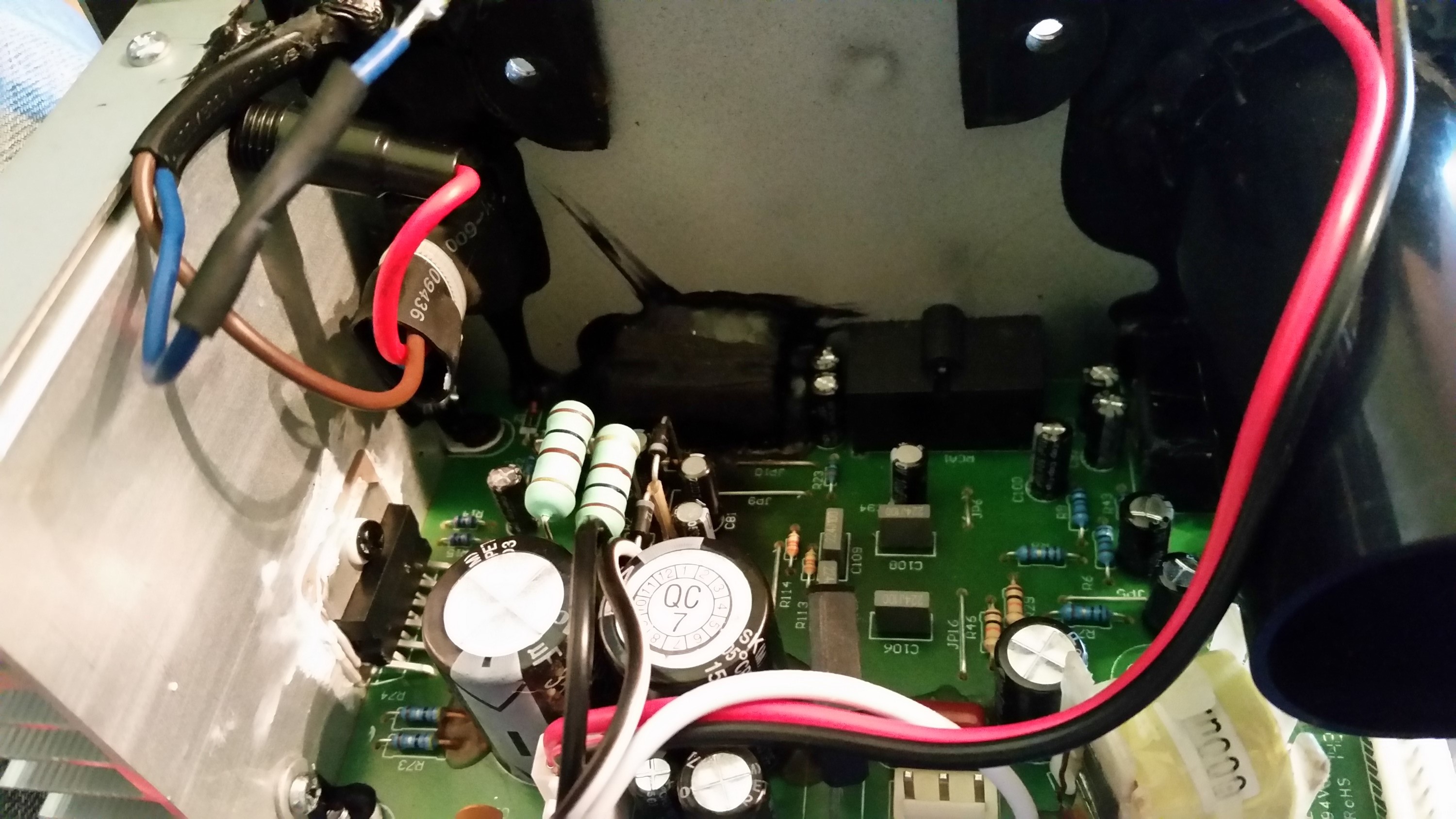

                    OK, here are a few images showing what I did. The components are mounted in a cascading fashion, so the heat release is not being directly blocked by other components (when viewing, the improvised schematics should be envisioned 90 degrees rotated counterclockwise to get the actual orientation):
                    (R1) ===>
                    | (R2) ===> heat goes upward
                    | | Z3/Z4 =>
                    ===============PCB
                    Total capacitors replaced:
                    3x 16V100uF CapTop SK replaced with Panasonnic FR 16V100uF
                    2x 10V220uF CapTop SK replaced with Panasonnic FR 16V220uF
                    1x 50V10uF CapTop SK replaced with Panasonnic FR 50V10uF
                    2x 50V47uF CapTop SK replaced with Panasonnic FR 50V47uF
                    Now, the original 50V47uF and 50V10uF capacitors measured OK, but because they were very close to the hot area, I replaced them anyway. The two 10V220uF measured almost 390uF, which is way off their rated value.
                    Now, upon longer testing, the back plate of the right speaker does get quite warm but only after several hours of non-stop operation and playing audio. I am still considering taking out the power transformer and mounting it externally in a separated case or alike, and then extending the wires to the speaker. It might actually be done in a "plug-in" fashion so that the power source can completely be separated from the backlplate if necessary. This would definitively take some heat away from the right speaker and the PCB.
                    But, after the repair so far, the speaker have definitively stopped clicking, crackling and cutting out.
                    What are your views/opinions/thoughts on the work so far?

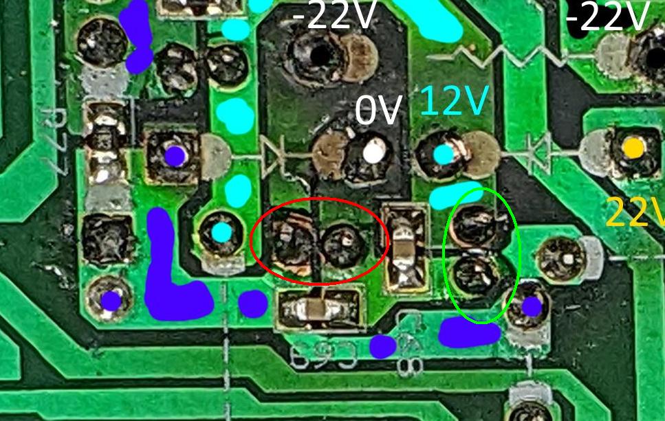

                              So I'm getting 0V instead of -12V on one of the diodes, just wondering if anyone know whats the problem could be now?
                              The 0.6V line leads from the TL074CD VCC- pin

                                People here suggested that those transistors are involved in the phonejack cutout function when plugging in the headphones.
                                Check the condition of the D1 diode, which is soldered directly above the R77 SMD resistor on the other side of the PCB. Mine was corroded and broken in half due to the gunk used on the PCB. The diode may be covered by the black resin right in front of the switch spongy shielding.
                                Also check other components for chemical damage or failure in the area, as it gets extremely hot. An acidic flux may have been used to solder some components, which might also have caused the corrosion. R1, R2, Z3 or Z4 may have died due to extreme temperatures, producing no voltage. The caps around the Z3 and Z4 diodes are probably gone too due to the extreme heat generated by the zeners and resistors. Look at my previous posts, you may find some useful insights. My CR4s have been working great since the repair.

                                  You likely have an open resistor (circled in red), If it is open, it could be open due to a shorted zener or something else on that -12v line

                                    I replaced the diodes and all the caps on the board, so I figure its probably something else

                                      Bare in mind that there are two bipolar capacitors. Did you replace those with suitable replacements?
                                      Also check the black gunk with a multimeter, it may have become conductive and is causing irregular voltage conduit between the components.
                                      Also check what R_J suggested.
                                      One more thing: inspect the leads on the PCB between the resistor and the problematic diode which gives 0V. This board gradually develops cracks due to extreme heat. A crack may have developed between the resistor and the diode, thus leaving the diode unpowered. If this is the case, locate the crack and attempt to mend it. The easiest way to spot it is to turn a flashilight on from the other side of the board. Where you see the light coming through is the place where the crack exists. Scrape the green coating over the leads around the ceack, apply flux and put a bit of solder on top of it, it will reconnect the severed leads. My board also developed cracks, so maybe this experience can help you, too.

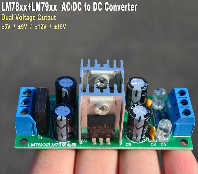

                                        Hi again, friends. I need your advice. I am thinking of replacing this original "resistor/zener voltage regulator" with a separate PCB, something like this:
                                        +/-12 regulator (as in the picture)
                                        Now, I would need some help on which parts should I remove from the speakers PCB (resistors, zeners and possibly some caps) and I would need assistance with connecting the leads. Now, this regulator operates on alternating current input. My guess is that I can connect its "input port" to the the positive input before the + resistor, and the negative input before the - resistor from the speaker's PCB. The ground seems to be common for both input and output on this regulator. But where would I have to connect the regulator's +12 and -12 output wires to the speaker's PCB?
                                        I can label the components on the PCB as soon as get the chance if you need that. But first I would like to know what are you thoughts on this solution. Would this generate less heat, and would the regulator work OK in an enclosed casing of the speaker? I know that I would have to mount it somewhere inside, but that would not be a problem as it has four screw holes which can be used with standoffs or something like that for mounting.

                                          Yes please. That is what I purchased (and what the article I mentioned suggests making). Would like to know how to wire it all in too. My speakers are collecting dust
