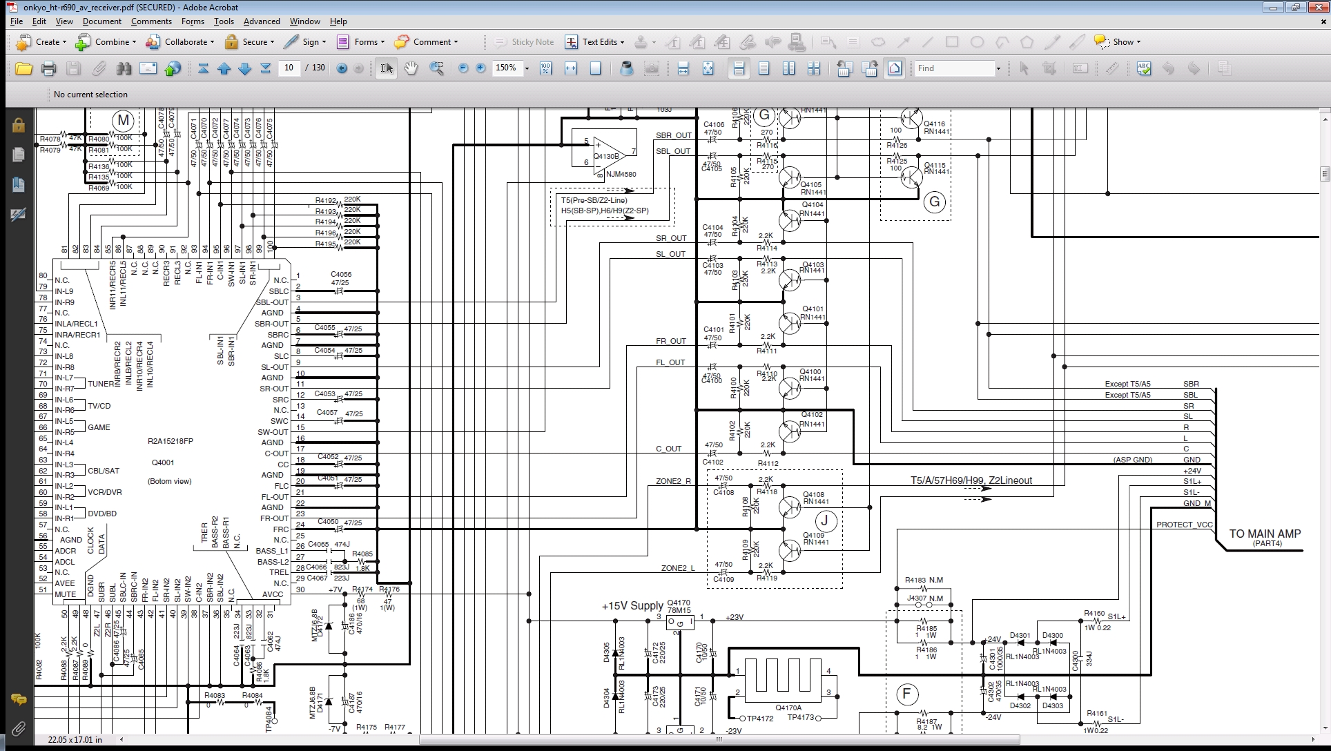

      Look at PDF page 7 which is the Block diagram, you will see FR comes out from IC Q4001 pin 21, FL pin 23.
      Those two output signals are fed to the connector P6600B (PDF page 11).
      So those are where you need to trace and find out if you have audio signals there or not.

          [QUOTE=budm;684860]Look at PDF page 7 which is the Block diagram, you will see FR comes out from IC Q4001 pin 21, FL pin 23.
          So those are where you need to trace and find out if you have audio signals there or not.[/QUOTE
          Thanks BudM for the page correction. I had just look at the first diagram and did not see the small letters for the model number.

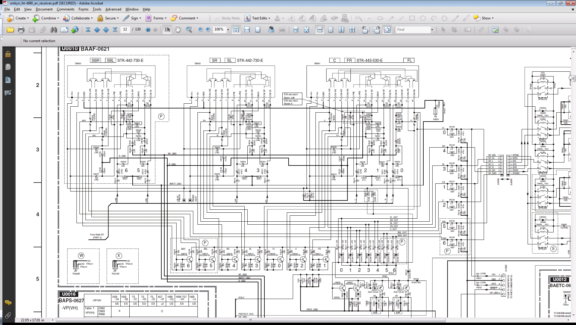

            Correction! PDF page 10, NOT 11, disregard about the connector P6600B in post #22.

                I'm looking all over the place for Q4001 I can't find it.
                  Re: Onkyo HT-R690 AV Receiver Front Right Channel Not Working
                  PDF page 7 & page 10 Board # BAAF-0621

                          Audio input, it has connectors p5502b, 5503b, 5504b, PDF page 10.

                            Ok found it. It's called BCAF 0621 no wonder I couldn't find it. I'm happy I looked for the numbers instead. So I'm assuming this IC is in the bottom correct? If so how is it possible to probe it playing audio with the whole unit apart and all boards disconnected?

                              PDF page 2 Exploded view # U0010.
                              PCB Part list page 53, Q4001 listed on page 56.
                              You NEED to look at the service manual.
