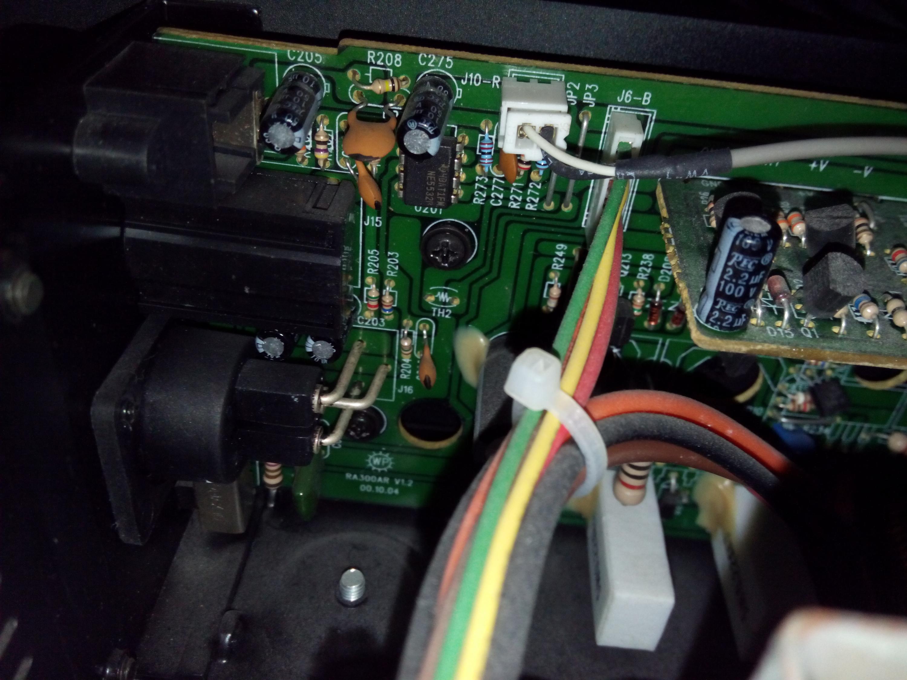

    Hi, I have some strange problem with my Alesis amplifier. One day I want to power the amplifier like every other day but it was completely dead, I opened it and checked the capacitors on PSU and found out that two big ones 63V 10000uF were strange but when I measure them they were fine. I decided to replaced them anyway with nippons because that Suscon is junk, I also replaced two 25V 220uF and one 35V 1000uF in that PSU because their capacitance was low under that 10% drop tolerance. After replacement amplifier turned On but signal from my sound card was not getting in amplifier, there was no sound and no bars were jumping on display on amplifier. Anyone have idea why and what to do ?

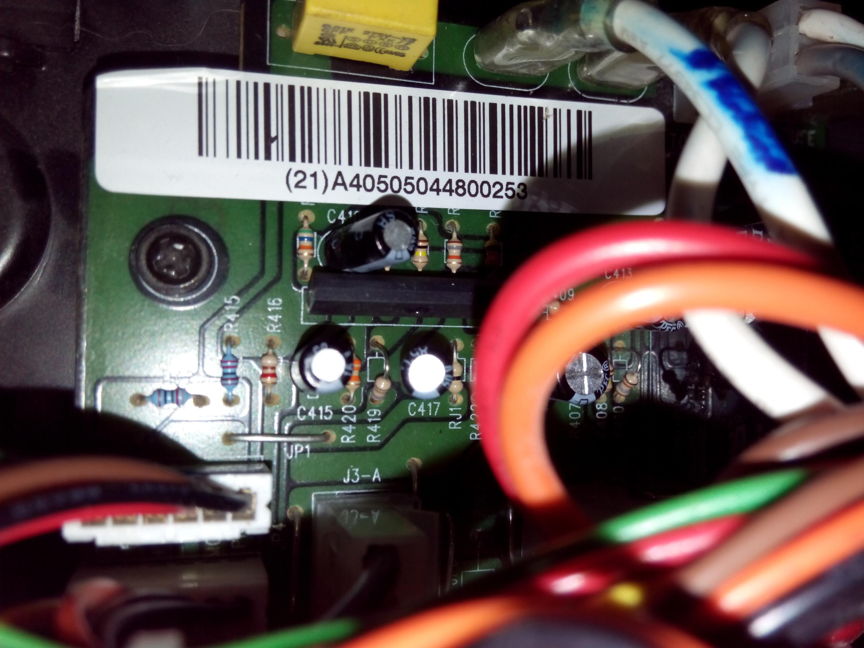

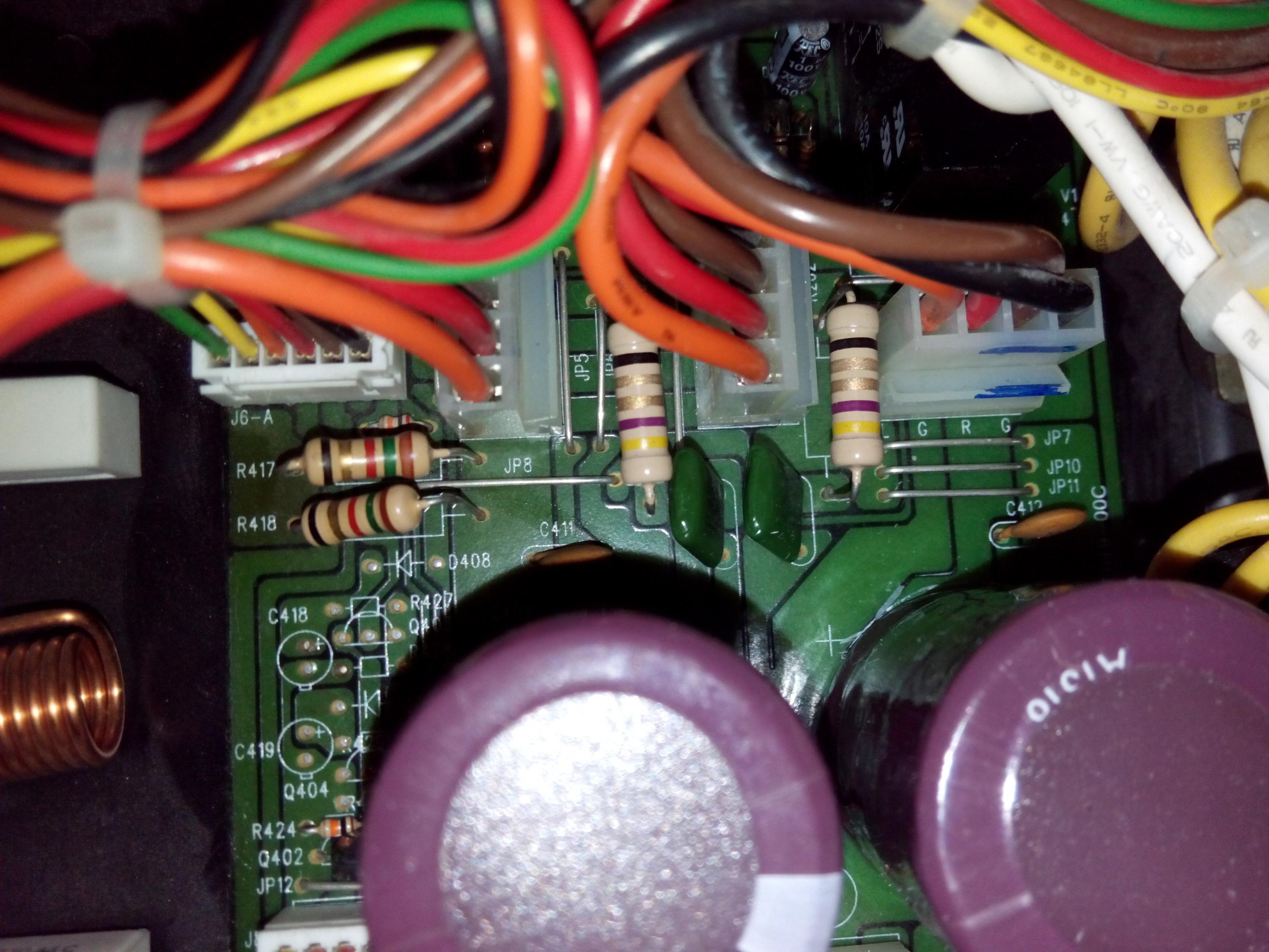

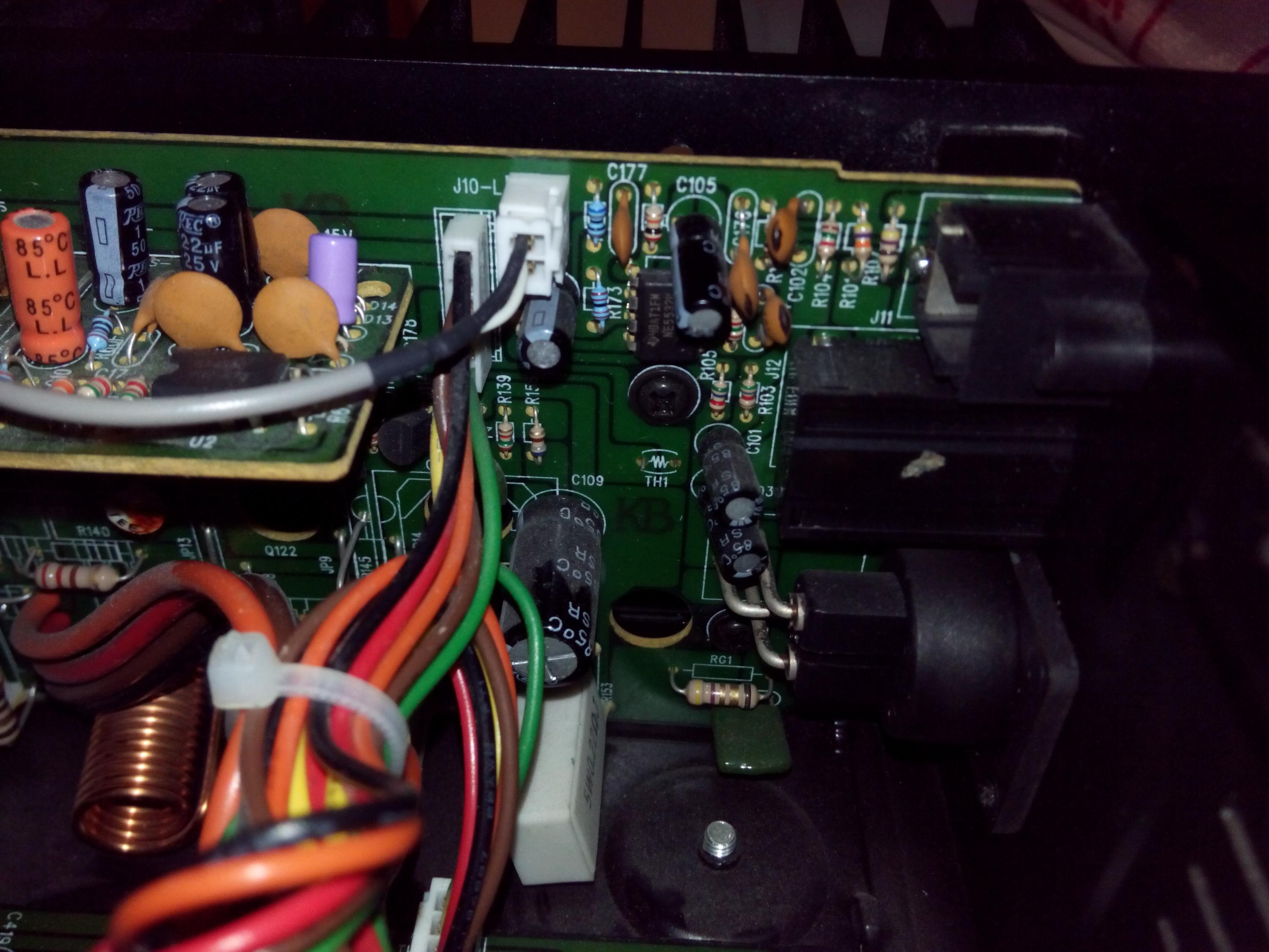

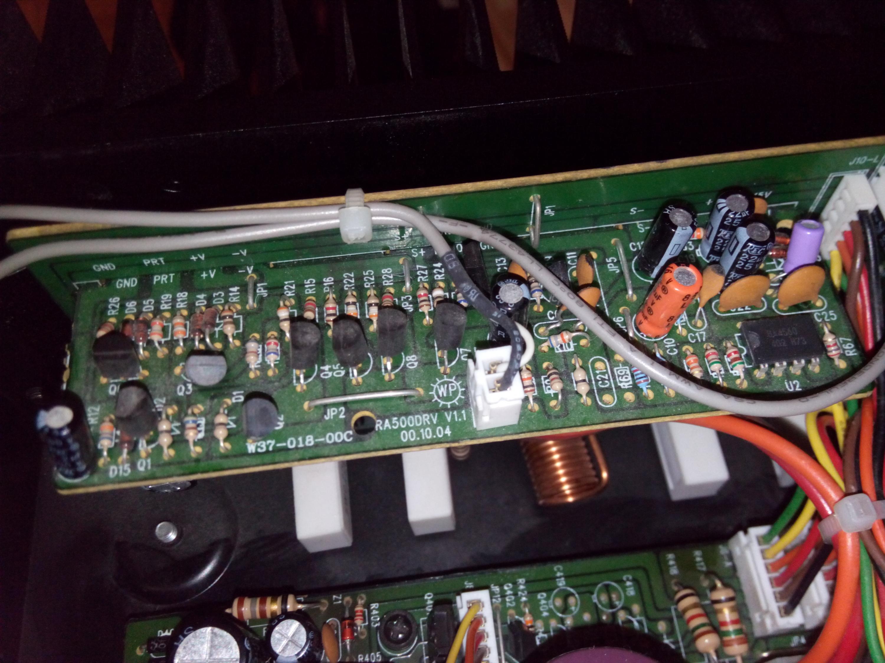

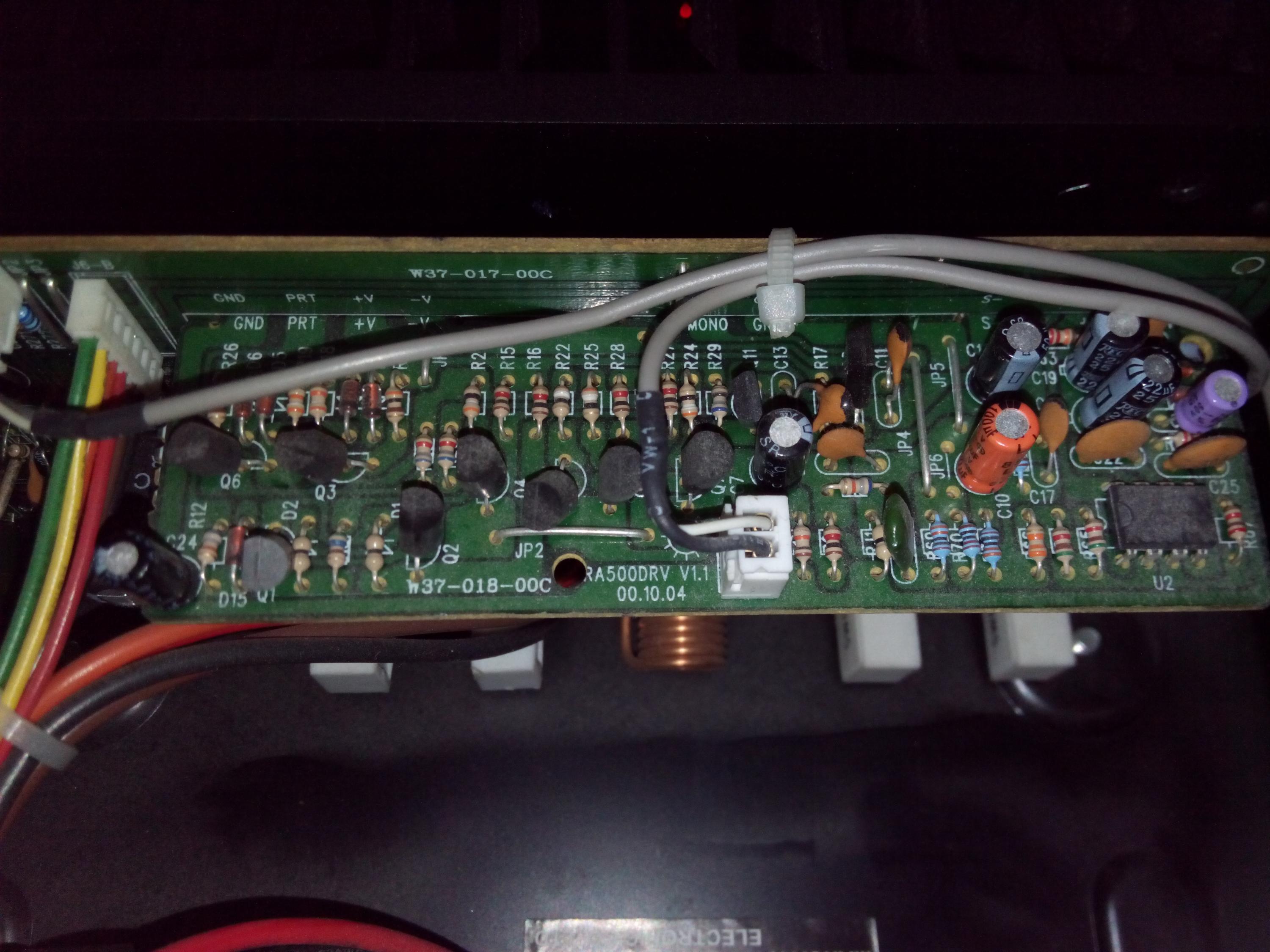

                  Re: Alesis RA500 Amplifier
                  Can you show me on pictures I can't find any of those numbers beside mosfet or anything that you are saying I'm kind of new at this so...
                  • keeney123
                    Lauren
                    • Sep 2014
                    • 2536
                    So go to the schematic that rhomanski provided and go to page 14 find the TA3717p you will notice the marking U1, that is the chip number on the board. Pin1 usually has a indented circle on it. You can also google the pin out of TA3717P or google that number for the data sheet. That should start you off.

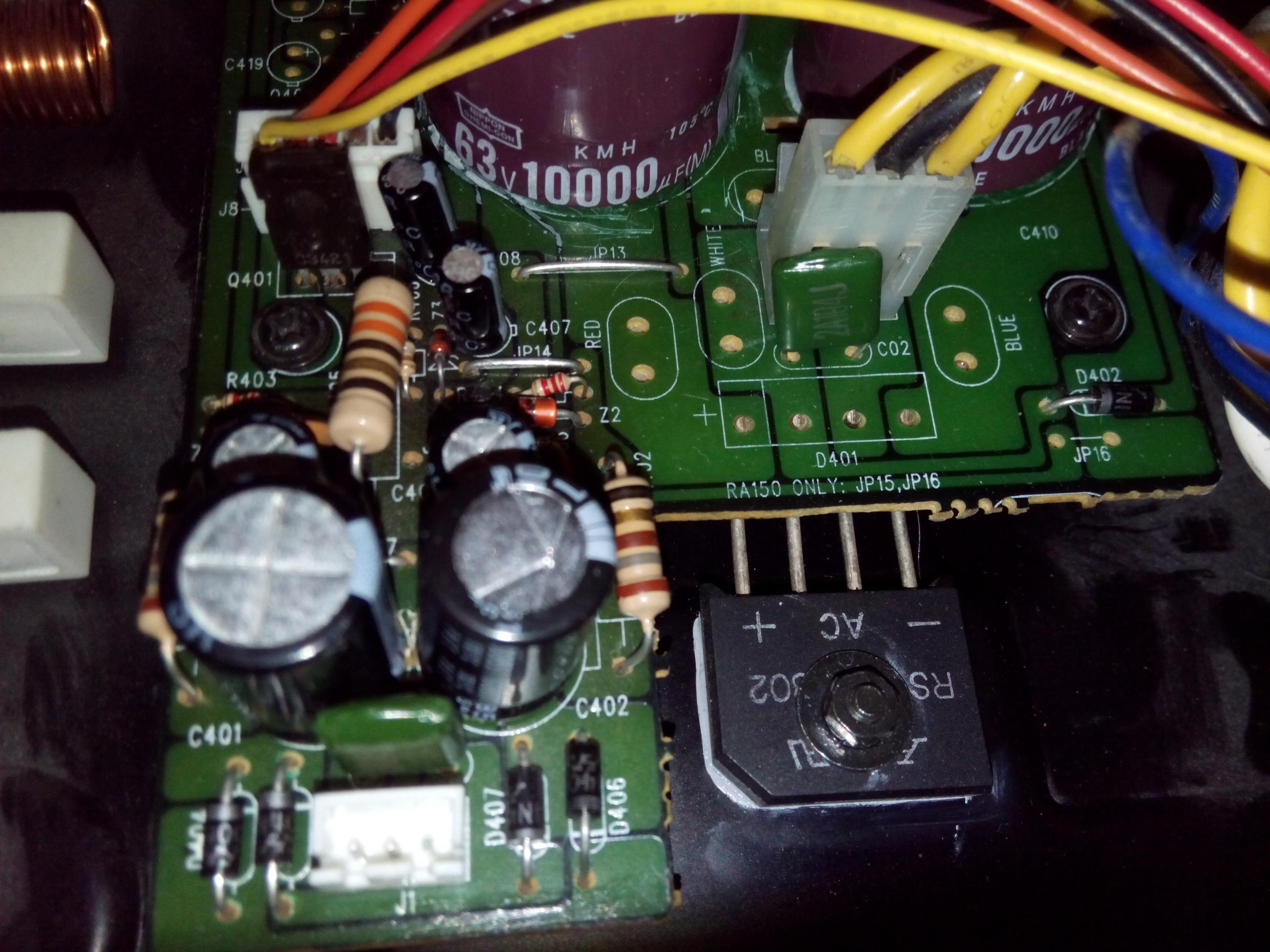

                      https://www.badcaps.net/forum/attach...0&d=1459801803
                      Where is J1 Female connector for the +/- 15V power supply for Op Amp? Unless you removed it to take the pictures, otherwise check and see if you do have +/- supplies.
                        I removed it because my phone could not fit in case
                          If you go to your picture "1" of 9 at the bottom left in the middle of that section of the board is J1. The male connector is with the pins sticking out. The female connector would be the connector that would slide over the male pins.
