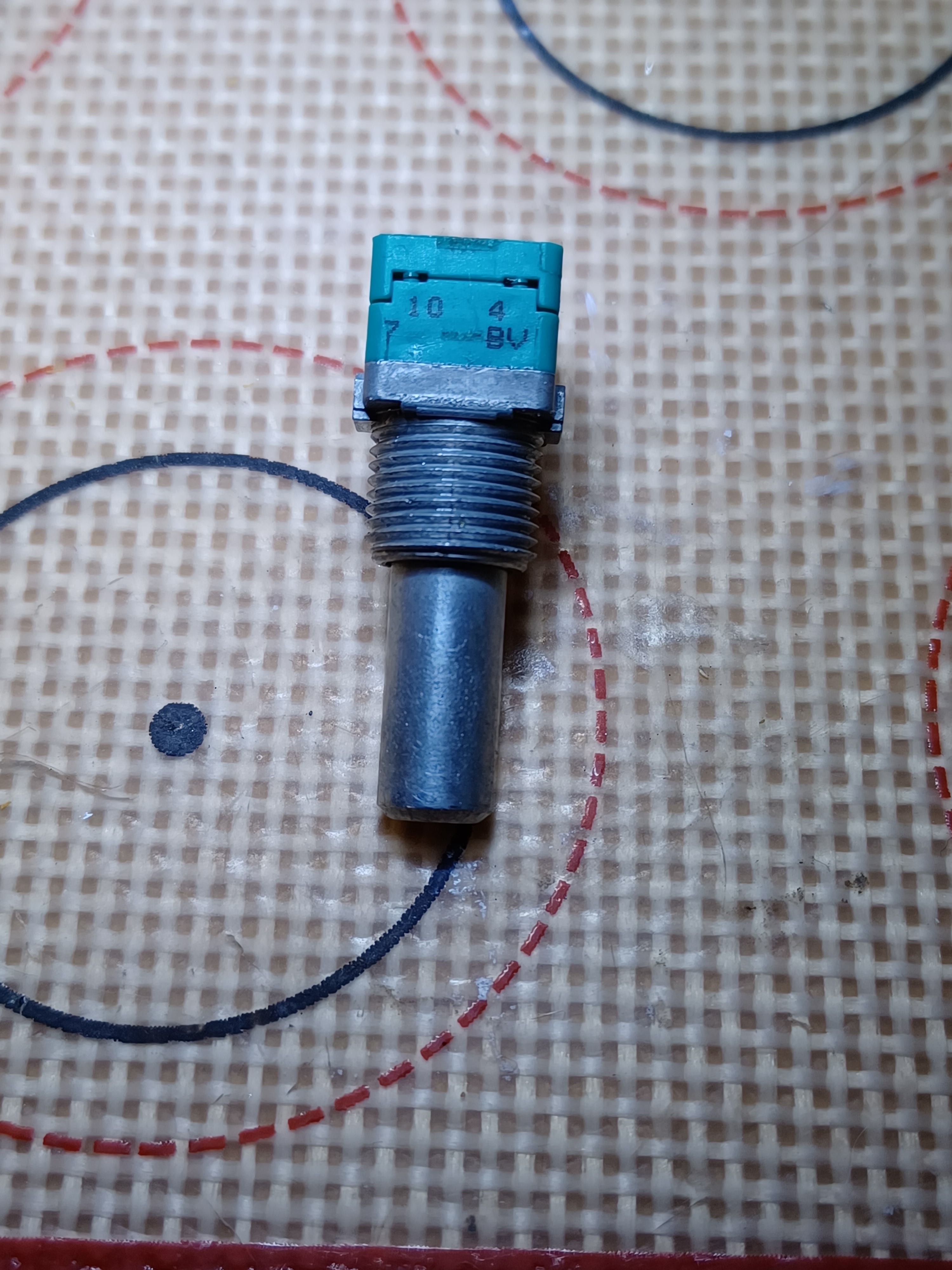

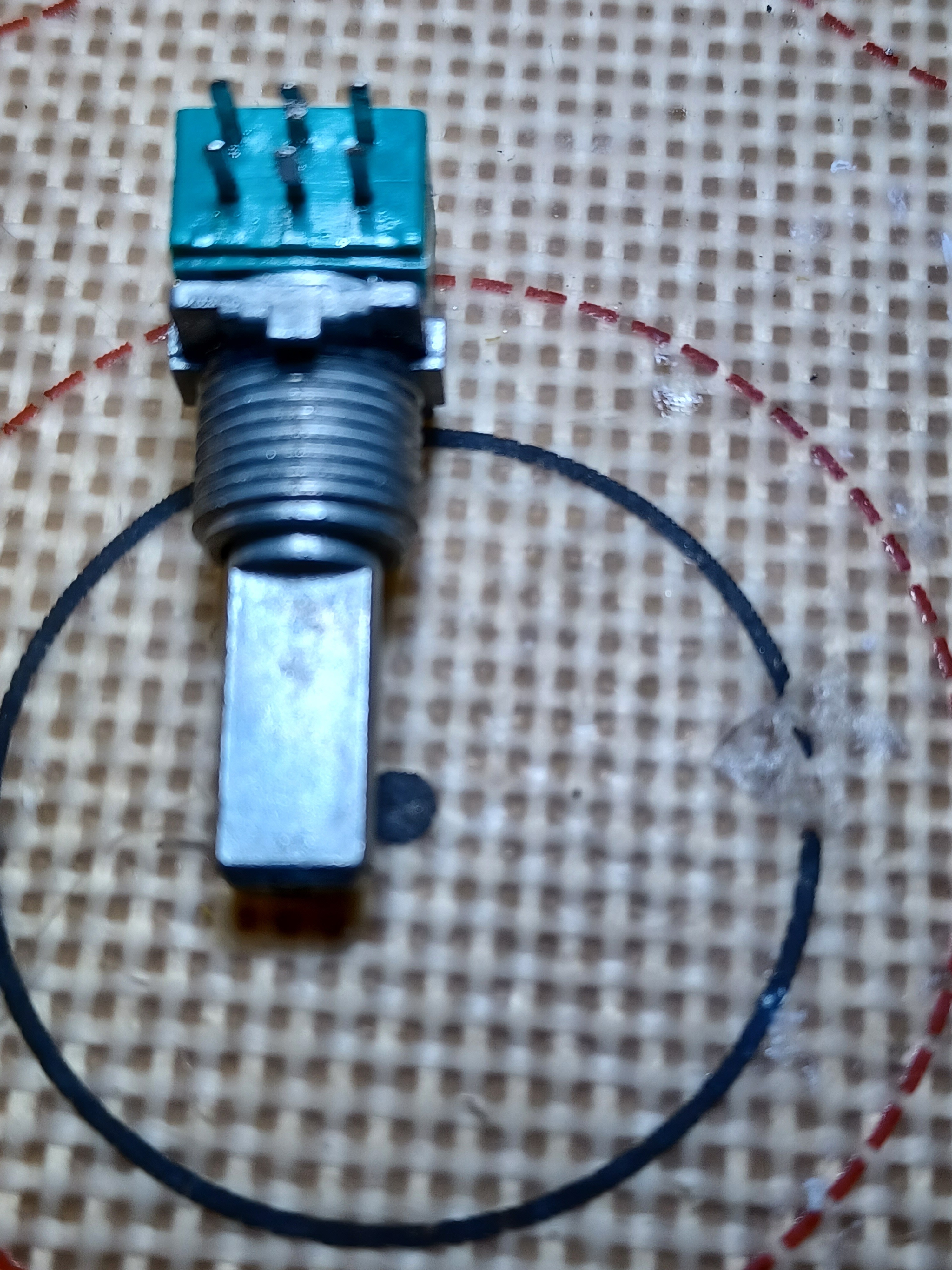

marantz pm66se balance pot
  • andy smith
    • Jan 2021
    • 6
    • uk
ID:	3592375 Click image for larger version
    Hi all
    I have a marantz pm66se that the balance pot does nothing i have removed it and it measures 88k and 106k between outer pins and 72r to 88.3k and 51r to 105k between wiper and outer pin i have tried to find a replacement but i am unable to.
    can anyone help i have included pics
