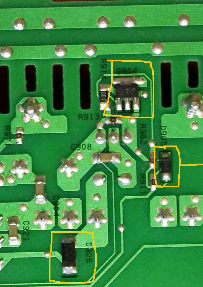

    I have not been able to locate a service manual for this Pioneer SX-S30 receiver. The unit will not turn on. I am troubleshooting the switch mode power supply. I found three smd semiconductors that test open while in circuit. The first (Q904) is a transistor marked AZ43W. The second is a diode D905 marked L68 and the last is a diode D906 marked 66 CU1M. I have attached photos.
    Any help would be appreciated. Thank you.

    Are you measuring ANY voltages on the output pins of the power supply? Check if you have +12v standby on P902 (1~3) if not check fuse F902
    Q908 is the standby switching ic 2A153
    If you don't have 12v standby Q904 circuit will not turn on and operate
    Q904 is a INA5001API transistor, D905 is a M1FL20U
    D906 is a GU1M ultrafast 1000v, 1amp diode

      I do have 5V and 12V but no 33V. The unit does not completely turn on. I do get a display over hdmi but the display on the unit does not light up.
      Any suggestions?

        Also Q904, D905 and D906 did not register anything with my multimeter using diode check.

          Check P902 pin 7 for PON, this should be a high, likely around 3.3 vdc, this is needed to turn on the power supply +30v and the display supply
          section
          There are two other pins on that plug, 8 TSENS and 9 PSENS what are their voltages? TSENS could be a protection line so maybe the amp section has a fault, and the unit will not turn on to protect the power supply.
          If you have the remote control, try pressing the MODE and HOME buttons together for about 5 sec. and see if you get anything on the display.

            Thank you for your help. I have ordered replacement for Q904.D905 and D906. I will get back to you when i receive them.
            I will try your suggestions R.J. Do you know where I can download a schematic?
