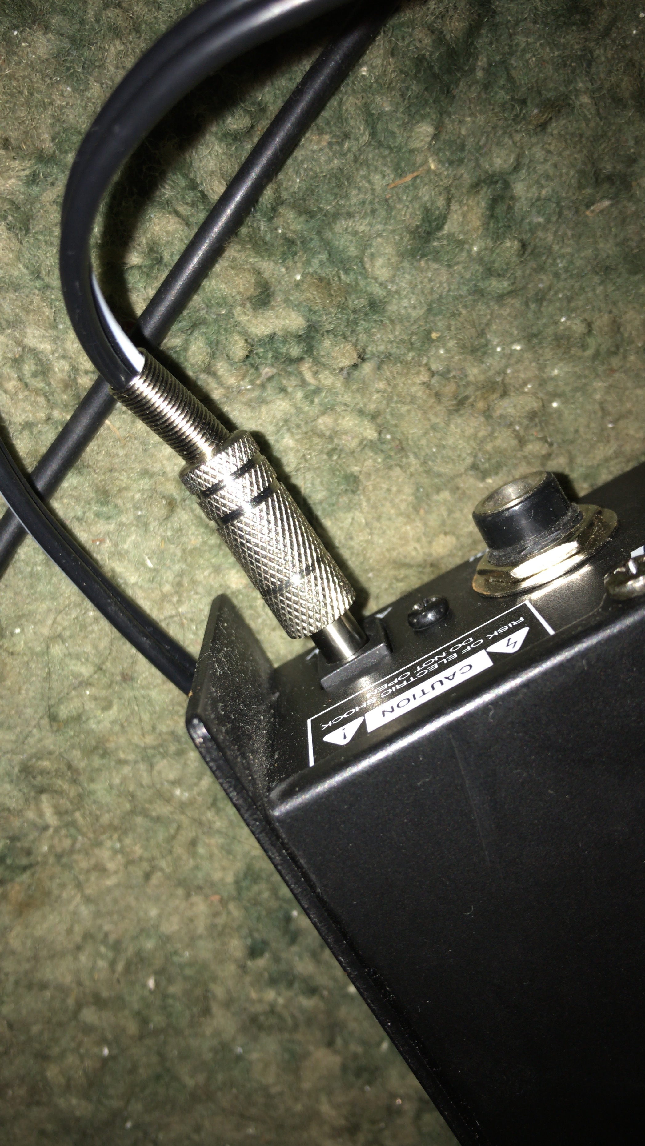

      I just checked again. The adaptor is DC.! 💀
        So disassemble the adapter and remove the diodes from it and it will turn into AC
        And the filter capacitor must also be removed

          I bought one. 10VAC 1500mA.
            Are waiting for the results…
              The Adaptor should be here next week.
              I'll be surprised if it don't work.
              Cheers for the help so far.
                Im waiting on a plug for the adaptor ,as the one on the end ,don't fit ,as the pin on the device is too big.
                One thing I noticed when buying one ,is there are a lot more DC adaptors than AC ones around.
                Did you work out why the front panel works with the DC Adaptor.?
                Cheers
                  Hi, the front panel is working by DC because it doesn't need negative voltage. Minus 8 volts is only needed to power the chips operational amplifier .

                    The Unit is all back together now.
                    I'm still waiting on the plug.
                      #30
                      I got the Plug for the adaptor at last. A Nice Silver one.
                      Soldered it all up with Heatshtink included to make it ice and neat.
                      I plugged it in and hooked it up like a mixer and it works.
                      Im getting the audio through it.
                      I'll try a mic later on and mess with the effects a bit.
                      Ive had it a while and didn't know the adaptor was the wrong one.
                      Sad really.
                      Great to see it working like it should .😊
                        #31
                        Well, great, congratulations!
                          #32
                          Thanks for the Help Man.😎
