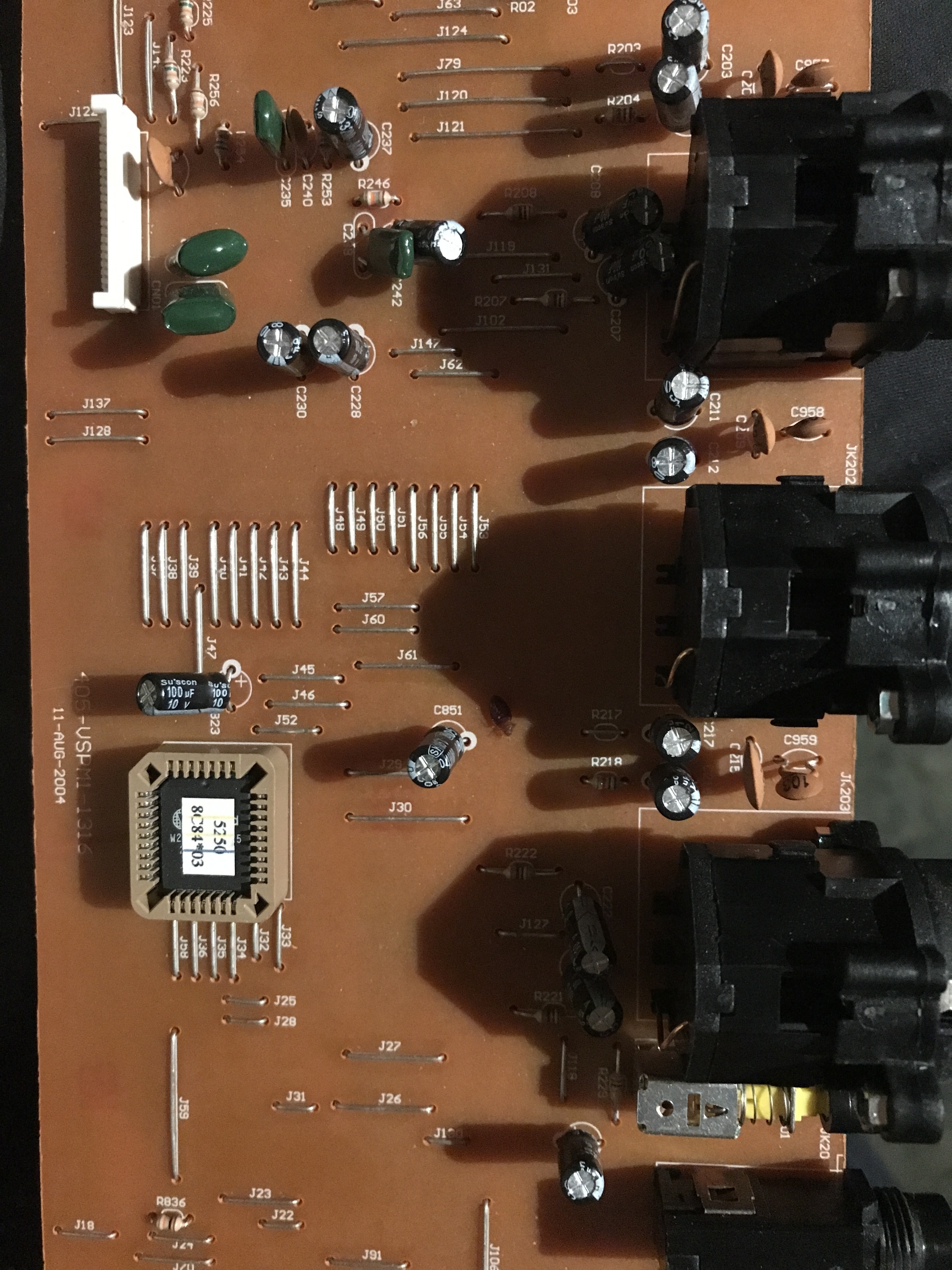

    I have a VSP-M1 with no sound. I dont know if sound is going in or not coming out as theres nothing at all ,not even hiss.
    Does anyone know about these particular ones.
    I'll take some photos later so you can see the board.

        You promised a photo...

          I'll take some photos later on. I cleaned the boards and had a good look at them and couldn't see anything wrong.
          Im gonna try it again first. Then ill take it apart again for photos.

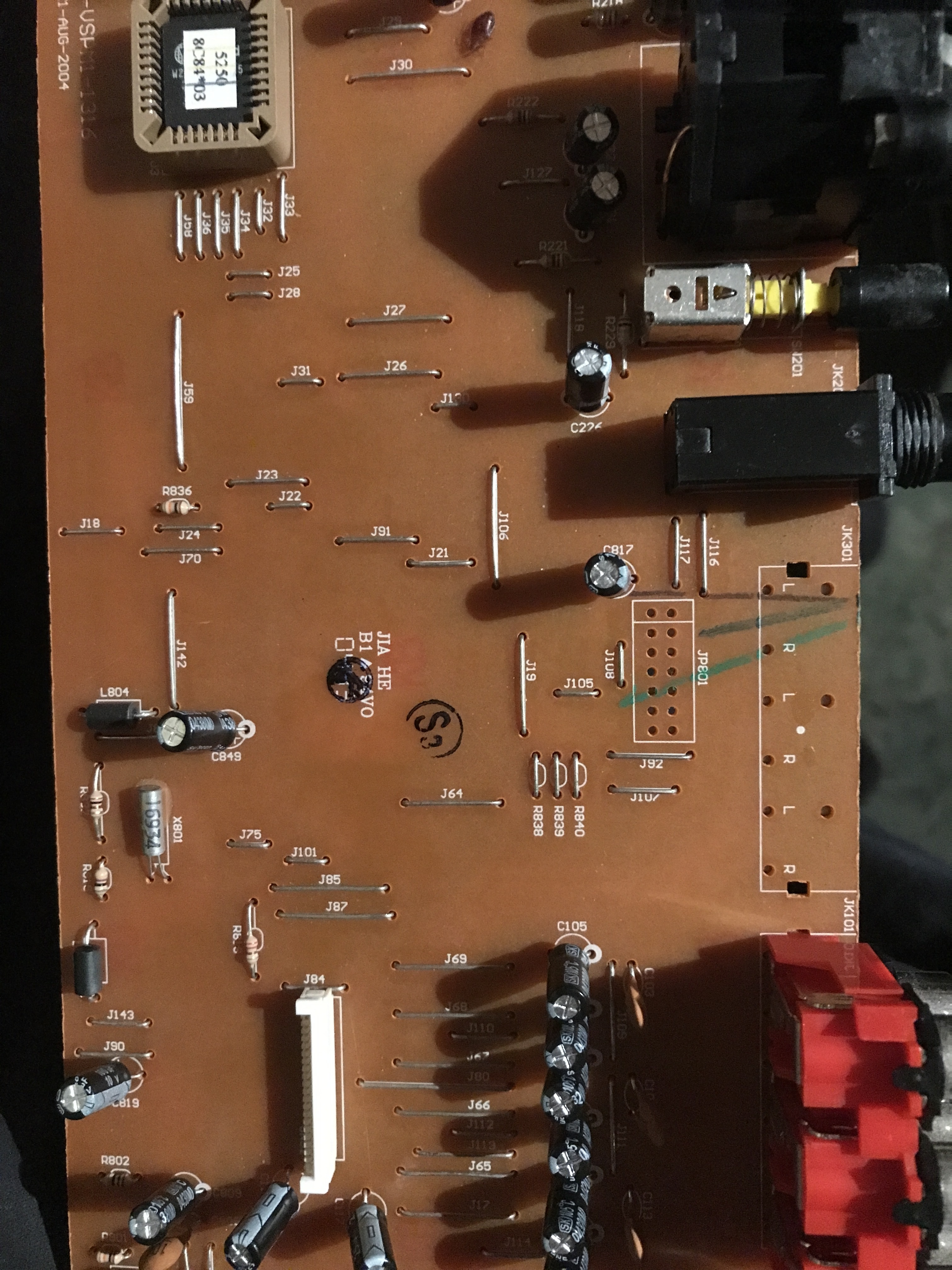

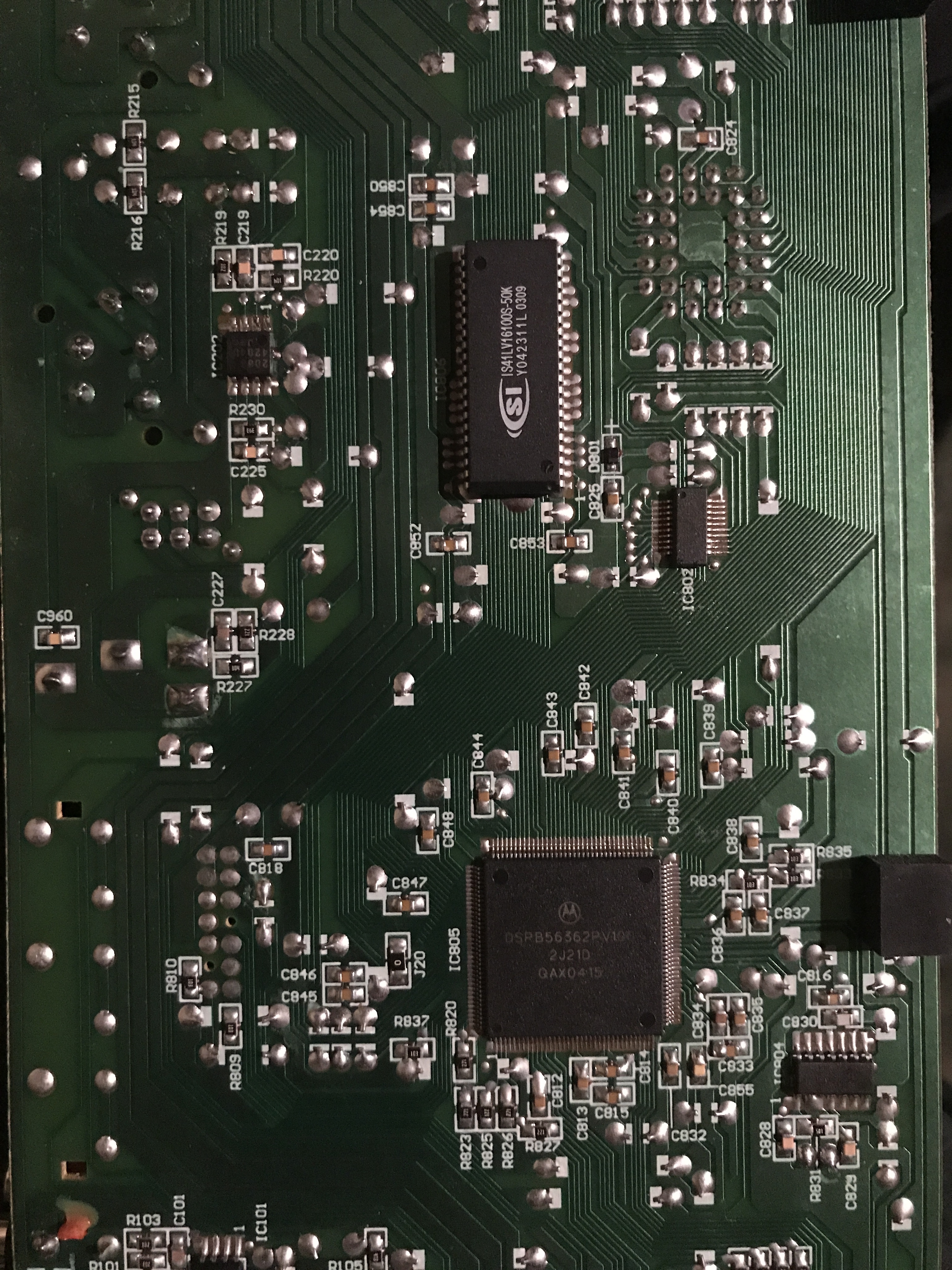

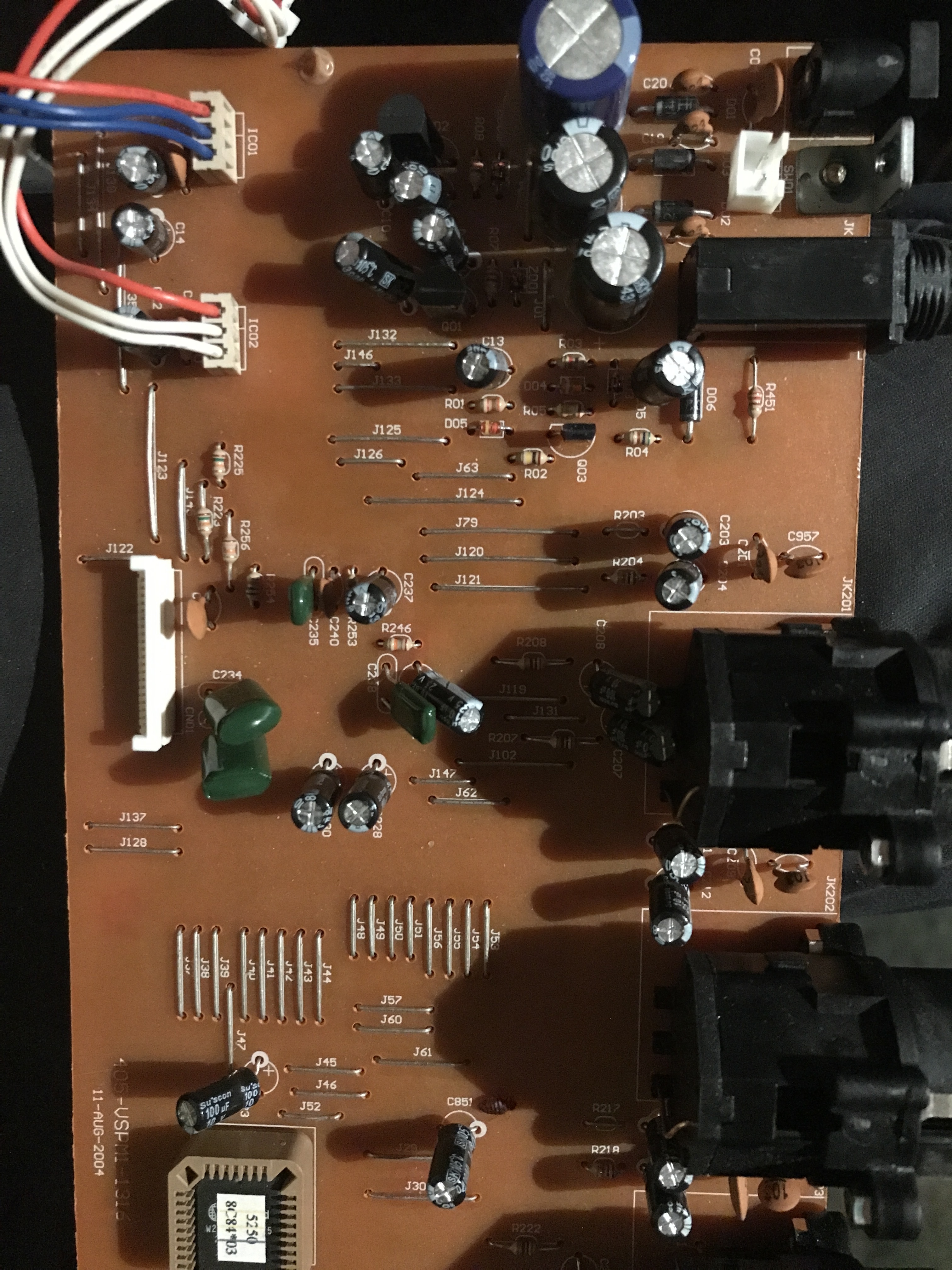

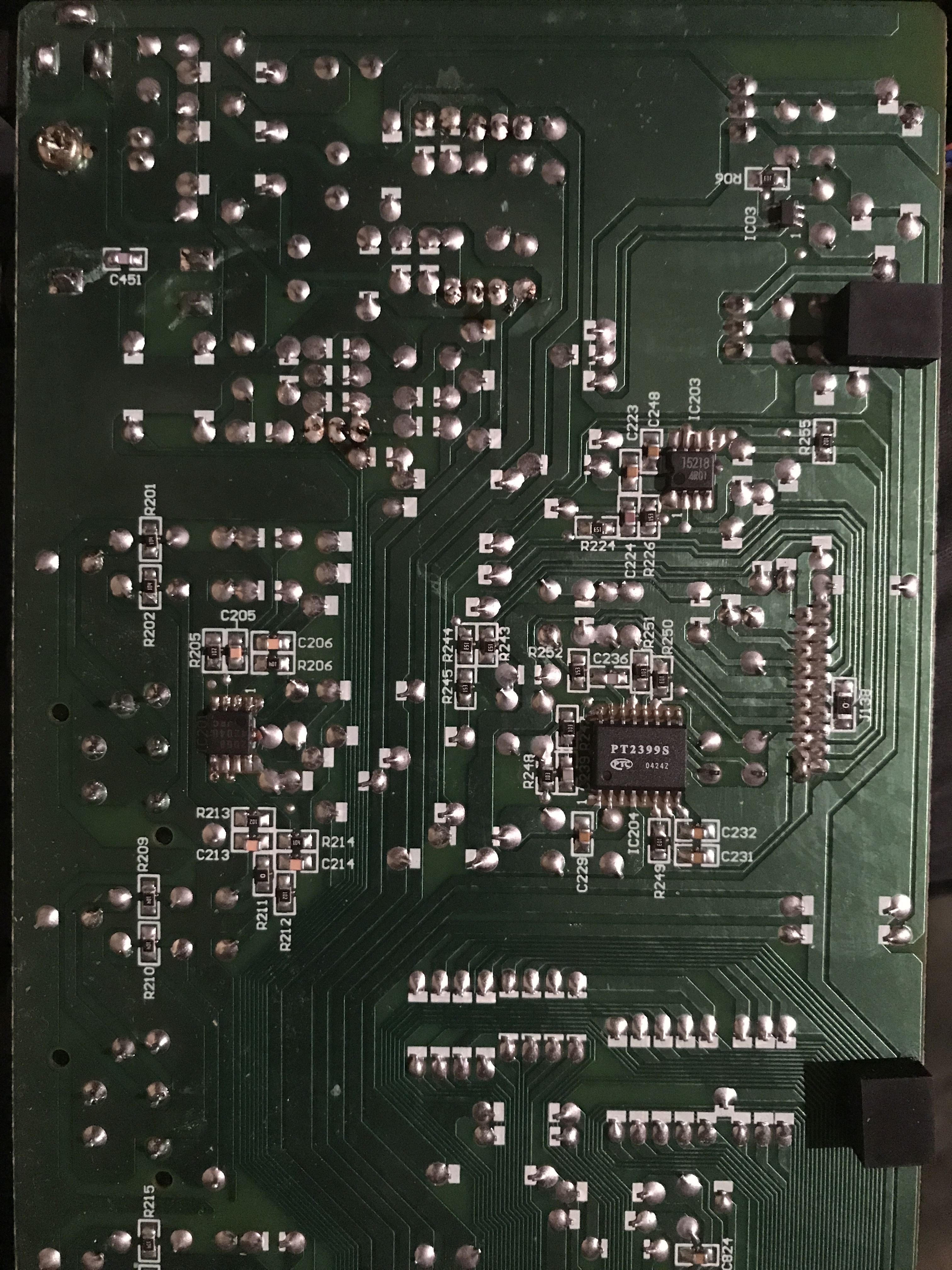

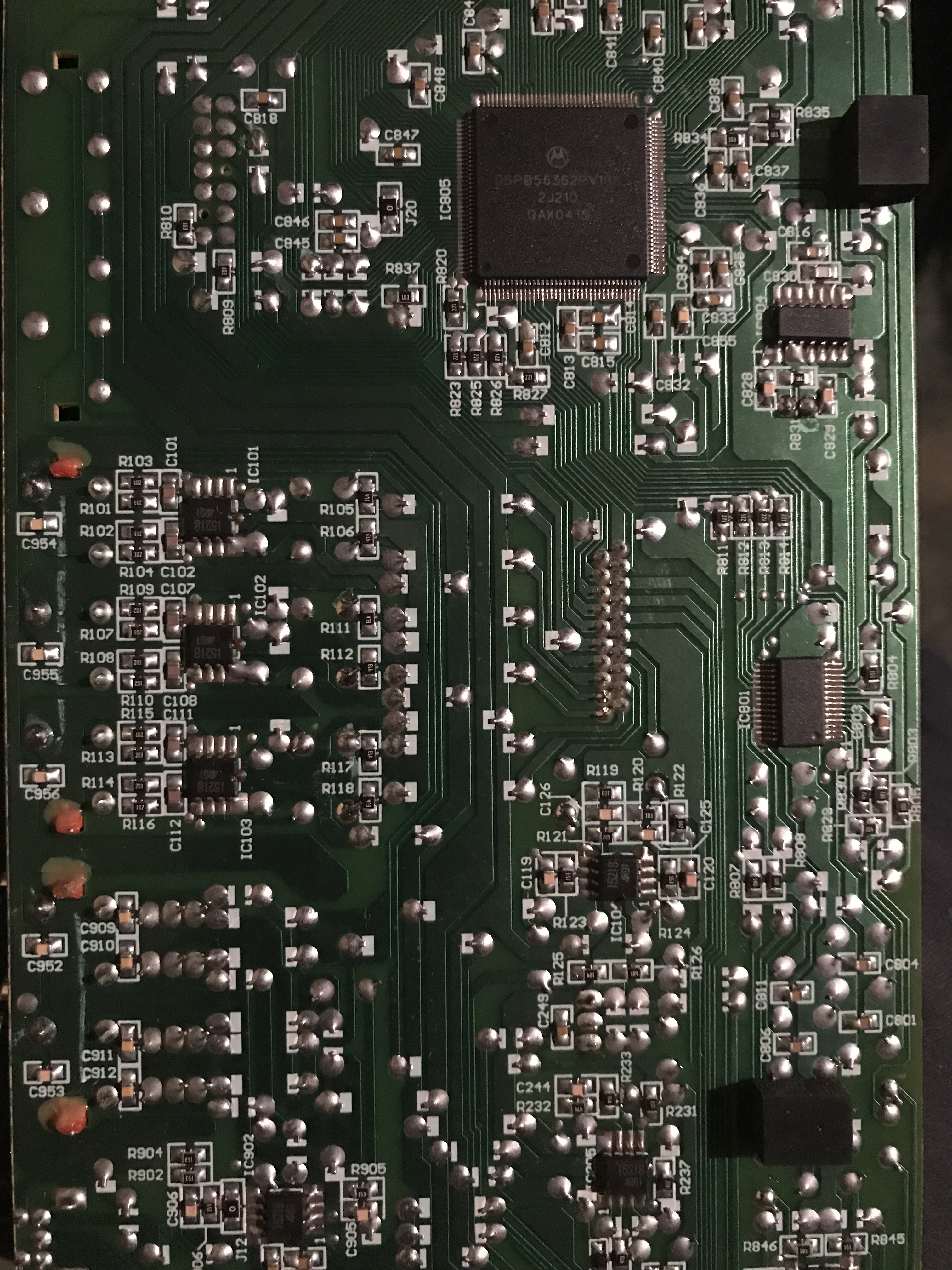

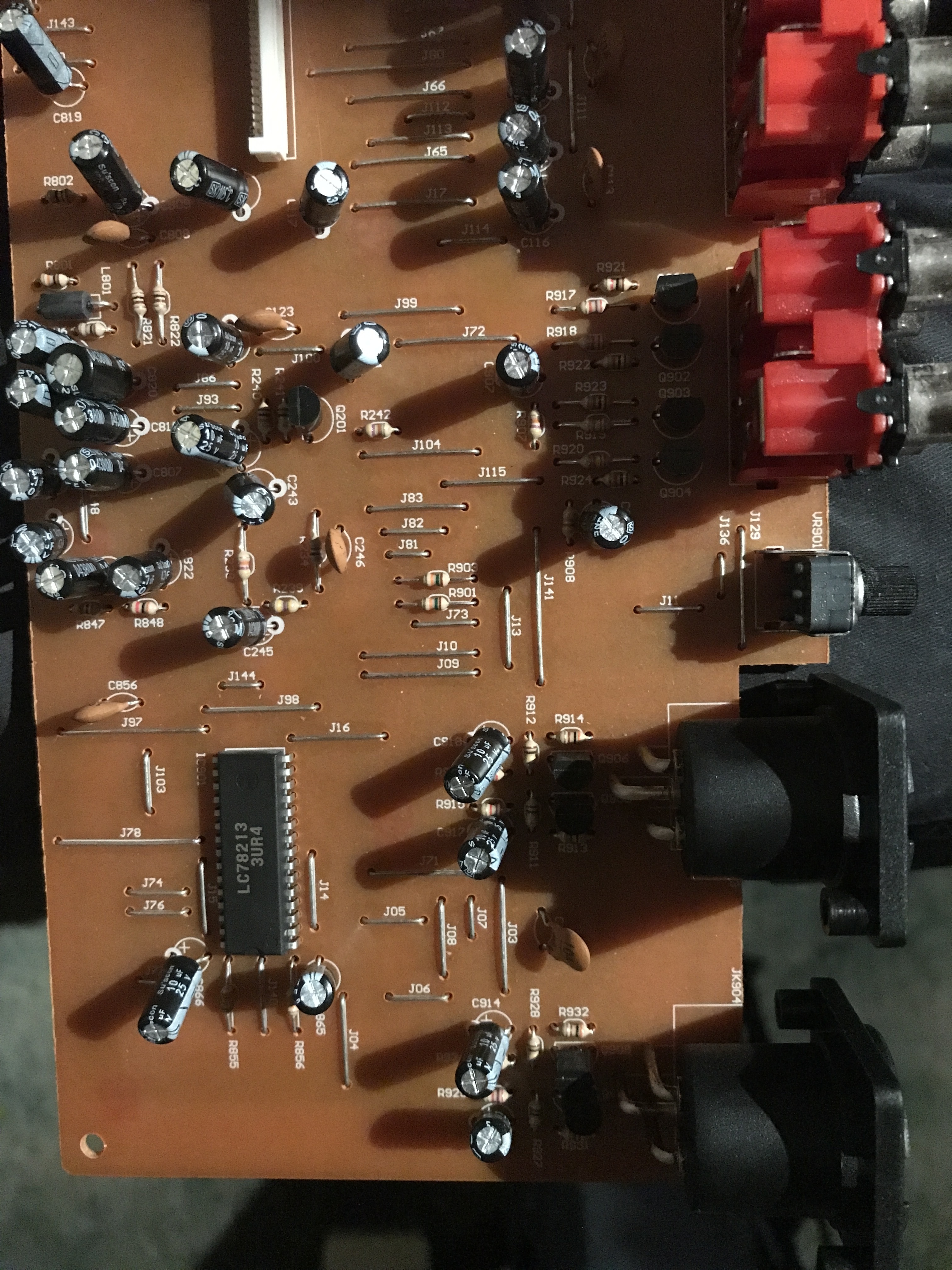

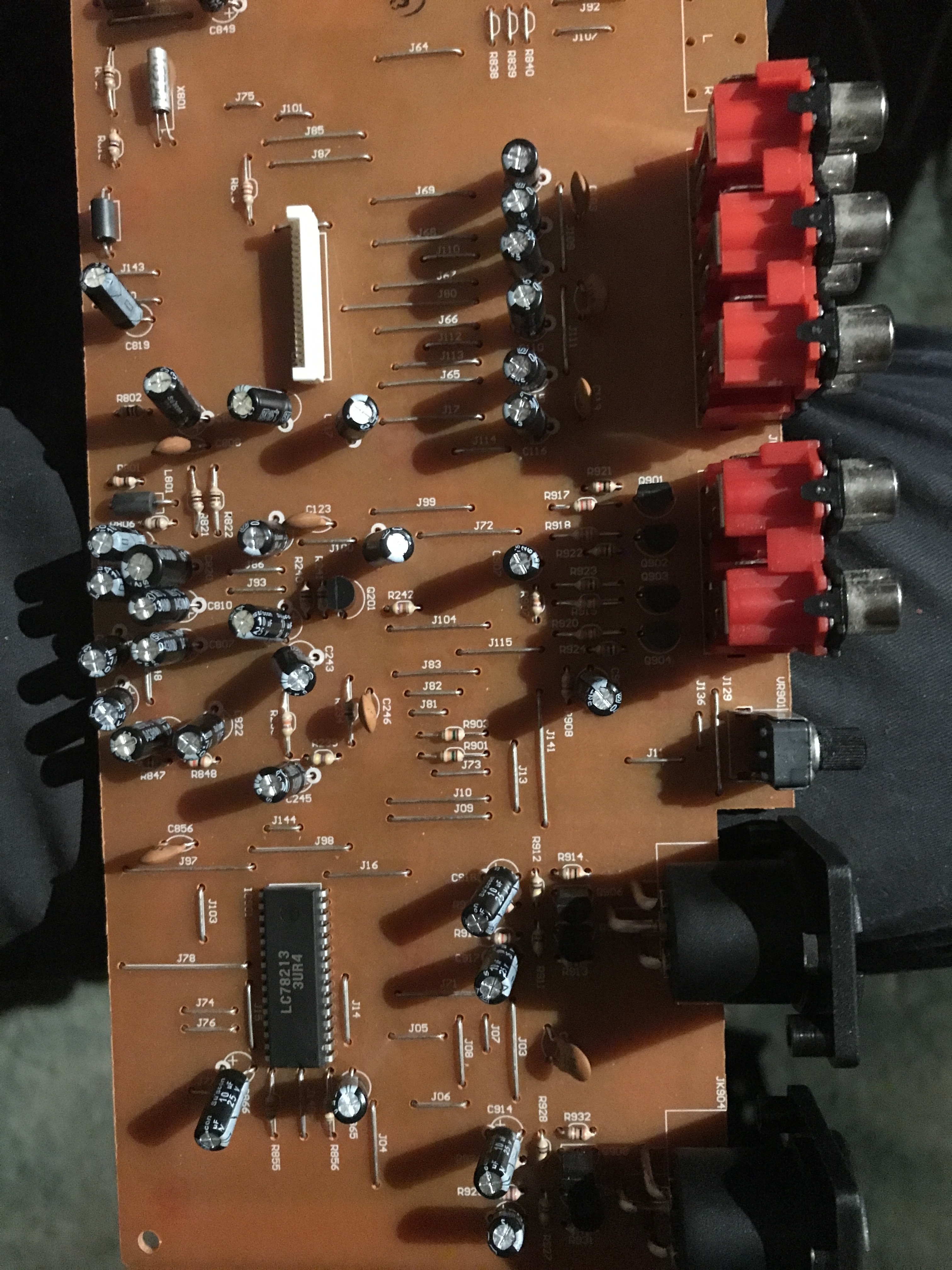

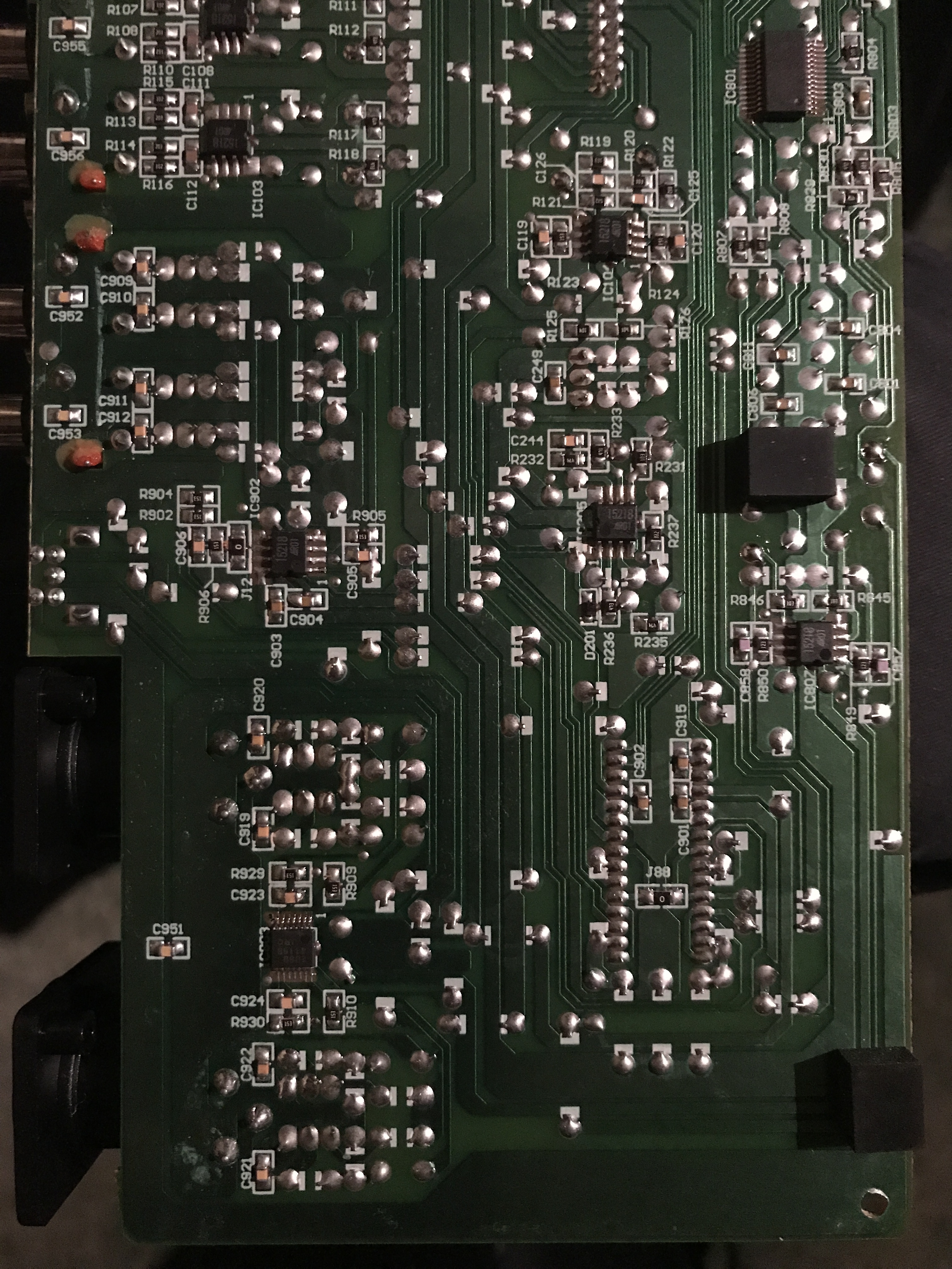

            Hi
            Heres some photos of the main board.

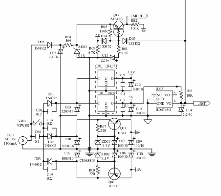

              Heres the Schematic
              Click image for larger version  Name:	Voco VSP-M1 Schematic 1.jpg Views:	0 Size:	711.4 KB ID:	3234478 Click image for larger version  Name:	Voco VSP-M1 Schematic 2.jpg Views:	0 Size:	1.07 MB ID:	3234479

                Check the voltage : 3,3/5/8/-8/ Click image for larger version

                  Thanks Man
                  Ill do that later.👍
                  Im thinking its an IC myself. No Audio at all.

                      For future reference.

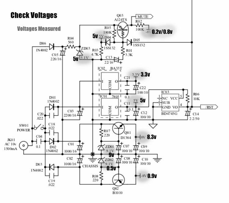

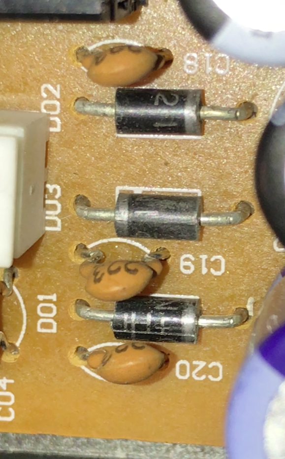

                      • Carm99
                        • Jun 2014
                        • 69
                        • England
                        Voltages Checked and we are not getting some of them.
Name:	VSP-M1 Voltages Checked.jpg
                        • Carm99
                          • Jun 2014
                          • 69
                          • England
                          There's 9 volts on both sides of DO1 and DO2 but only on one side of DO3. One side is 0.8.🤔
                          No Negative Voltage.
                          • Carm99
                            • Jun 2014
                            • 69
                            • England
                            Diodes
Name:	VSP-M1 Voltages Cecked 2.jpg
                            • Carm99
                              • Jun 2014
                              • 69
                              • England
                              DO3 Looks a bit grey.
Name:	Screen Shot 2024-03-15 at 00.41.41.png

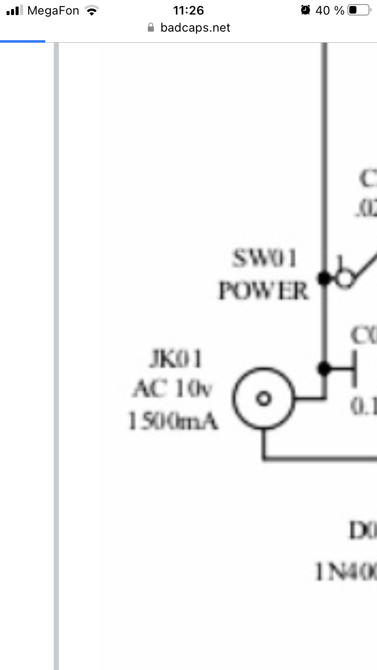

                              • kasfamily
                                • Aug 2014
                                • 765
                                • Russia
                                Check the external power supply - it should output an alternating voltage!
                                • Carm99
                                  • Jun 2014
                                  • 69
                                  • England
                                  I was thinking about the supply as I checked everything and its ok. The unit powers up as the front screen is on and you can adjust everything.
                                  I was wondering where the negative voltage was going to appear from.
                                  Let me look in the manual.
                                  • kasfamily
                                    • Aug 2014
                                    • 765
                                    • Russia
                                    The diagram shows - AC 10 v 1500 mA
                                    • Carm99
                                      • Jun 2014
                                      • 69
                                      • England
                                      Yea thats what Im using.
                                      I tested it with a multimeter. Its going + then 0. AC
                                      I'll try with the analogue one when I find it.
                                      Im looking for another one ,if I have it.

                                        Show the photo of the nameplate of this power supply
