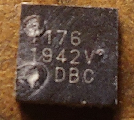

please id QFN chip from yamaha PSR EW 300, I guess it's a power driver or similar
8x4 pins

Y176 -
YDA176-QZE2
https://aliexpress.com/item/1005003564962638.html
YDA176-YAMAHA.pdf

PSR? a keyboard?
if it's a keyboard then backup the roms while you can - they are all failing about now!

thanks, yes a keyboard. I will backup the roms.
