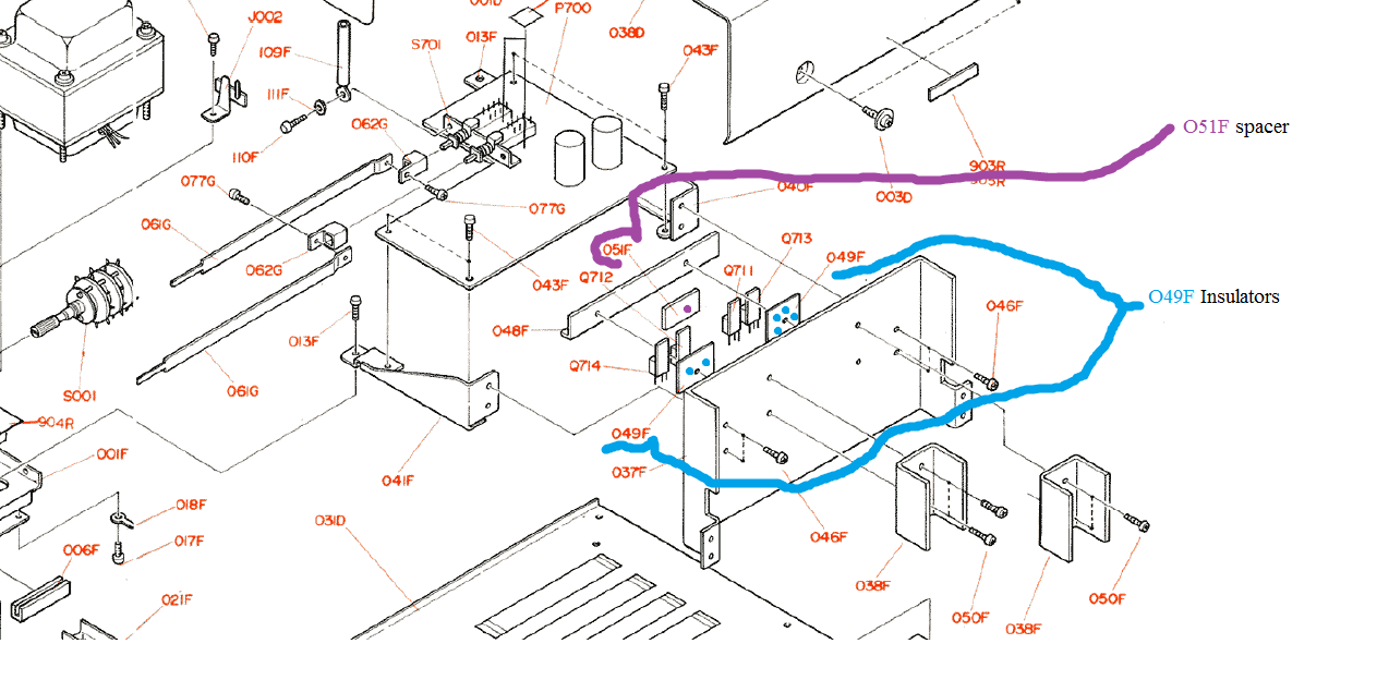

                        Re: Marantz model 2216b
                        Did you try it with headphones before taking out your old output transistors?
                        Before getting new transistors:
                        Disconnect all speakers.
                        The receiver's driver transistors can drive the headphone circuit but not speakers.
                        In fact you will be able to hear any faults like a hum, distortion and/or a channel out using just headphones plug into the headphone jack in the front of the receiver and NO output transistors.
                        Remove ALL the output transistors and do NOT instal any output transistors at all.
                        As you take them out please take note and let us know of the numbers on the transistors. The two in the center should be B507 (2SB507) in the middle of the output stage and D313 (2SD313) on the corners.
                        Are the insulators look ok? (O49F)
                        If you have an ohmmeter from the metal chassis you should not see much of any resistance to any of the center lead of the output transistors. No dead shorts!
                        Before you plug into the wall make sure:
                        All speakers are disconnected and
                        All output transistors are removed.
                        You will probably still hear your popping noise.
                        Now does the "HI-FILTER" change the sound?
                        By the way if you still hear the noise your original output transistors are good but please do NOT install them yet and do not use speakers.
