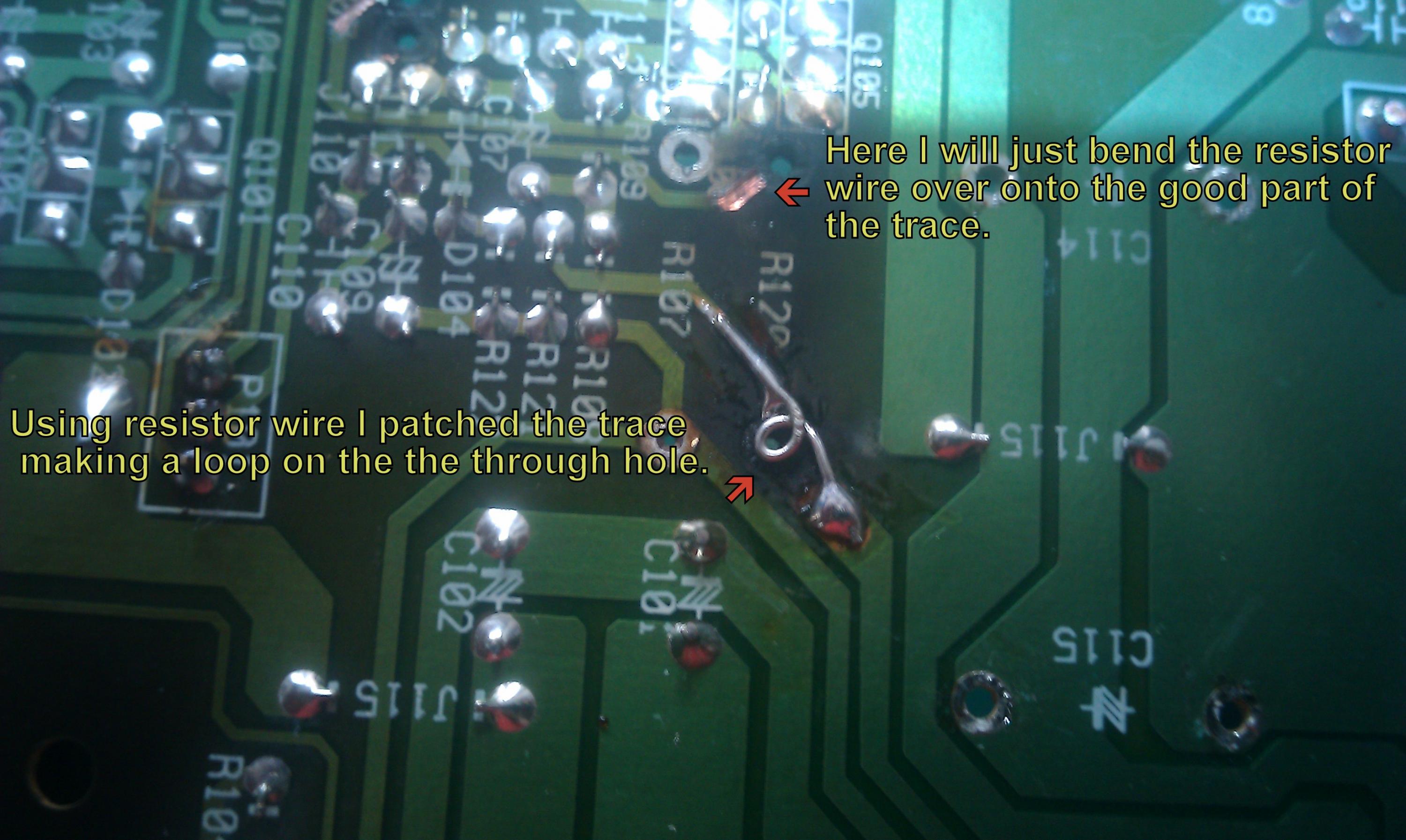

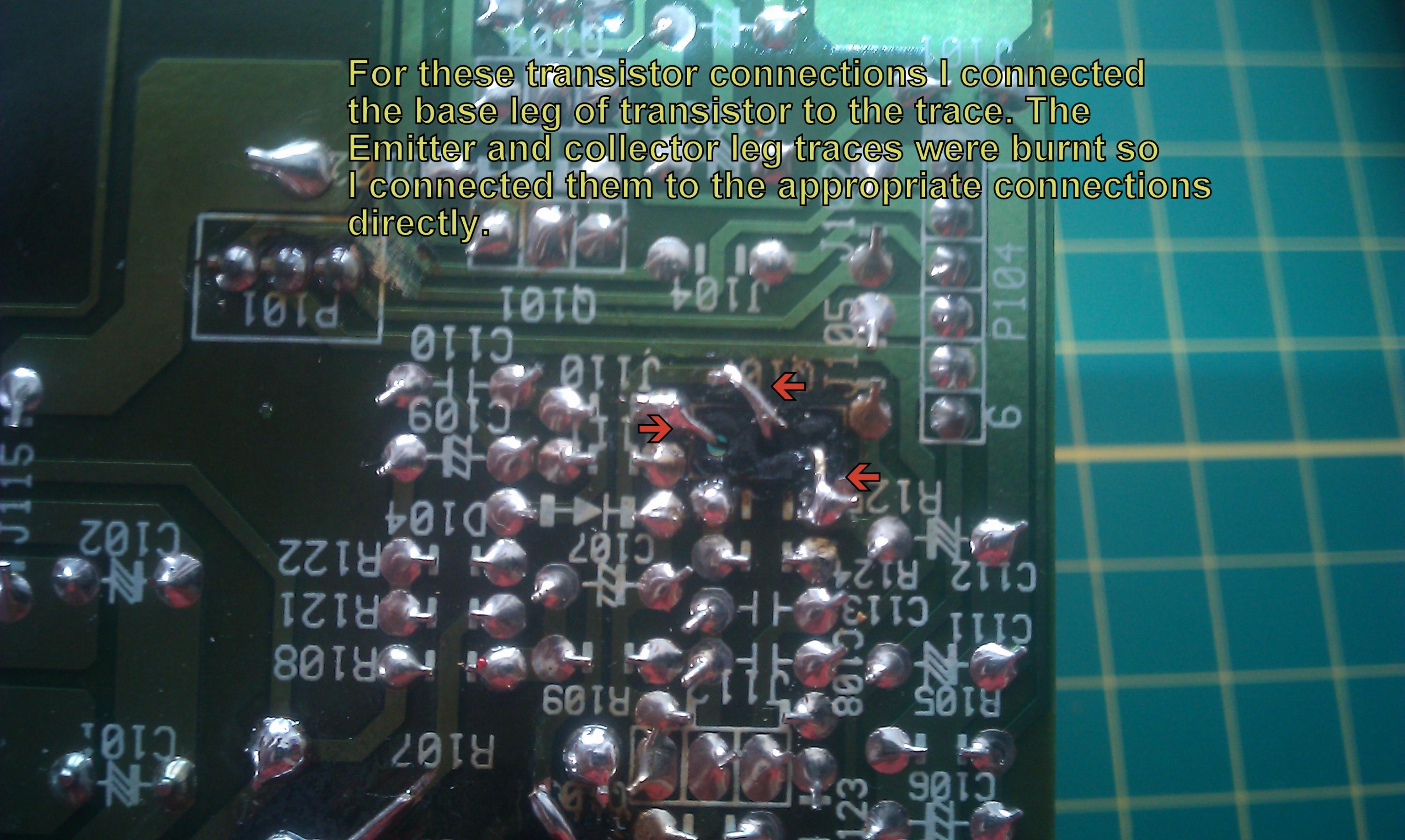

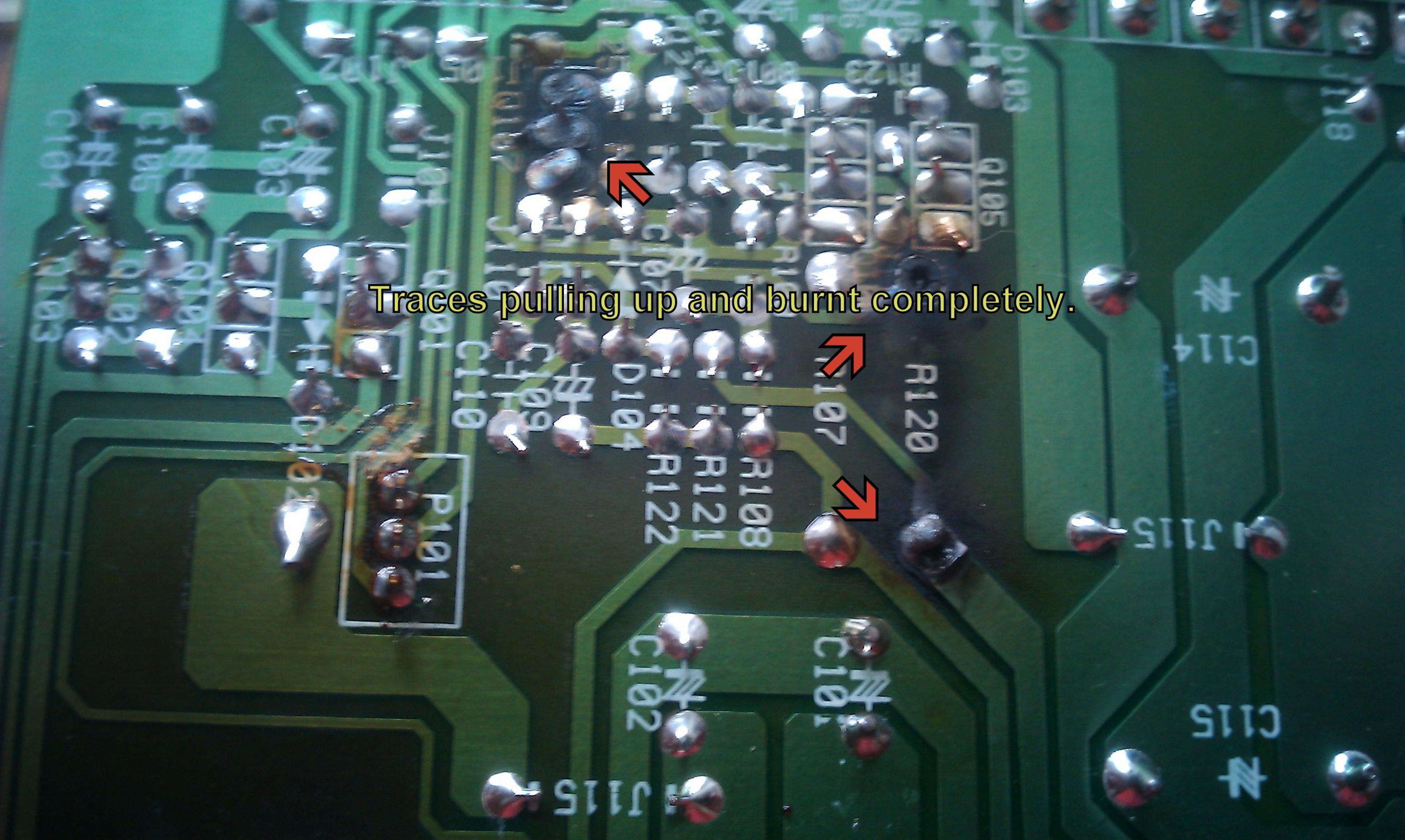

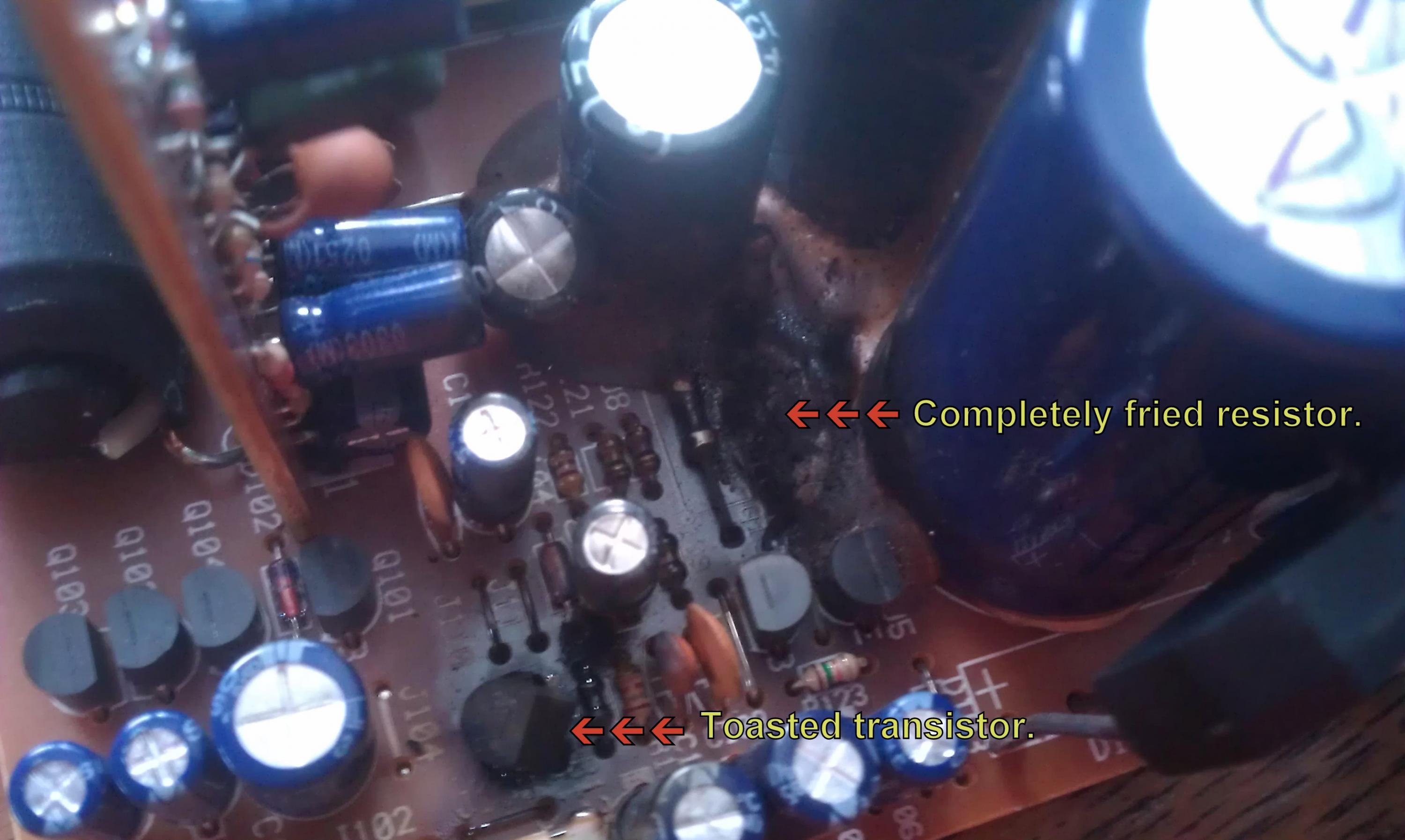

    Klipsch Pro Media 2.1 repair.
    Been lurking awhile and learning the whole time. Thought I would share a little repair project that I did. I am very new to this kind of work so go easy on me.
    Because I read the wrong pinout an attempt to replace a bad DIN plug ended with magic smoke coming from my Klipsch Powered subwoofer. This is how I fixed it.
