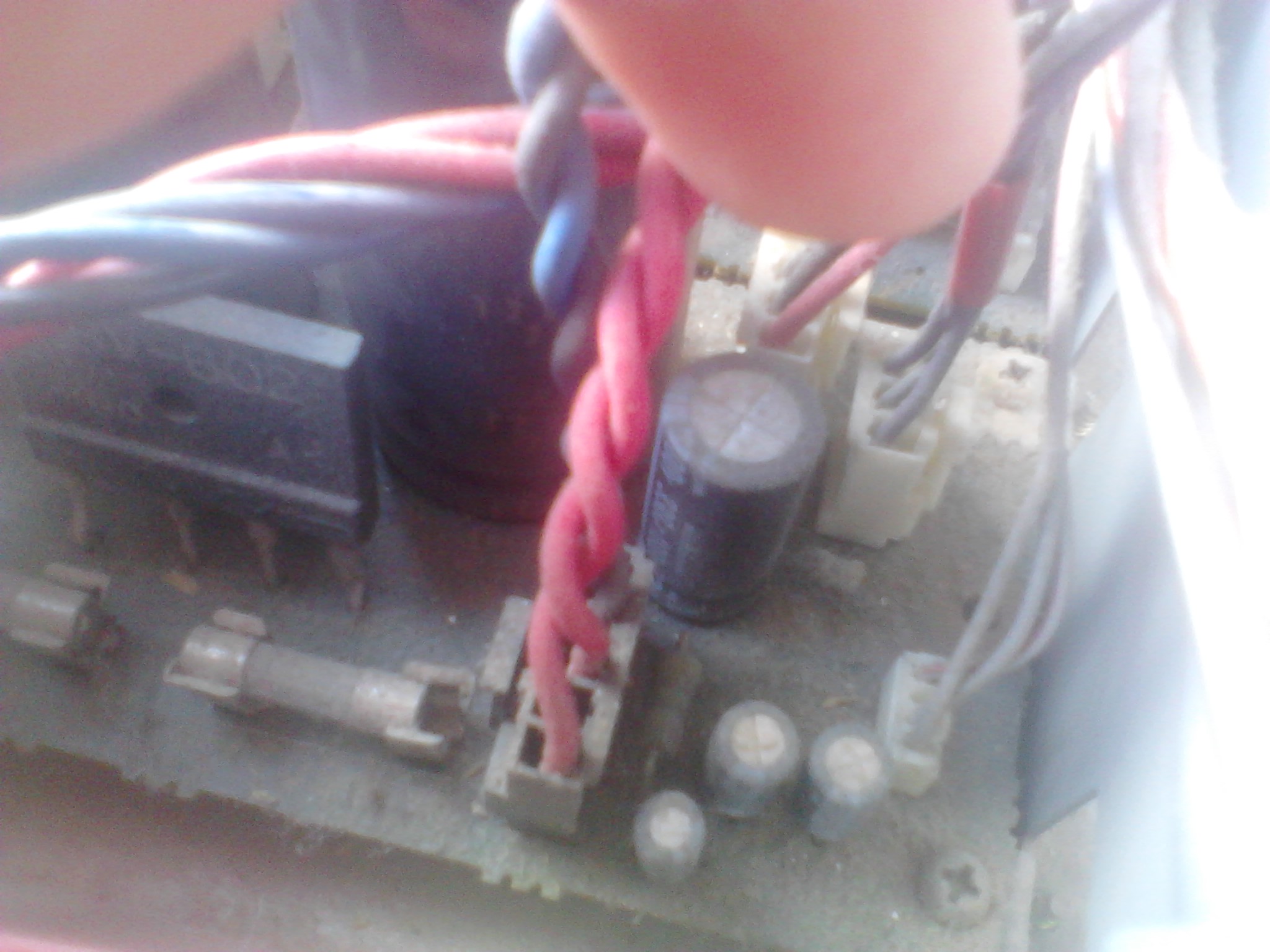

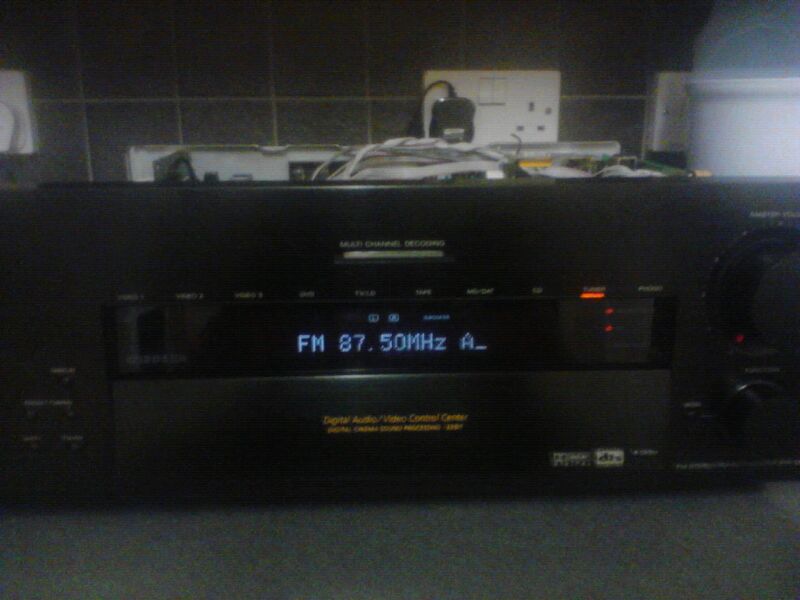

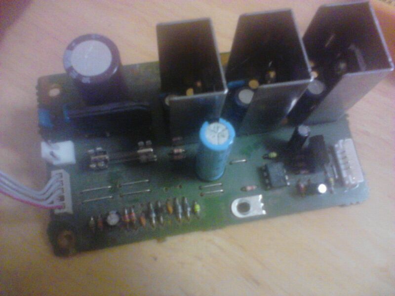

    Just fixed a Sony STR-DB925 for a friend.
    Just thought i would share the symptom and fix in case someone has a similar problem.
    Friend calls me and says his amp wont work, no lights or anything.
    I open her up and there was 1 bulged cap on the voltage regulator board so i replaced that, still would not switch on.
    I then reflowed all the solder joints on the regulator board, fitted it all back together and boom,, working again
    Blue cap is the one i put in.
    Sorry for pic quality RC.

    Is that a Teapo in a Sony amp? Ugh.
    Nice fix though.
      Nice fix though.
      I just used what i had lol.
      I was originally a Rubycon, but it was bulged so i nicked that one out of a atx psu i had lying about.
      And thanks.

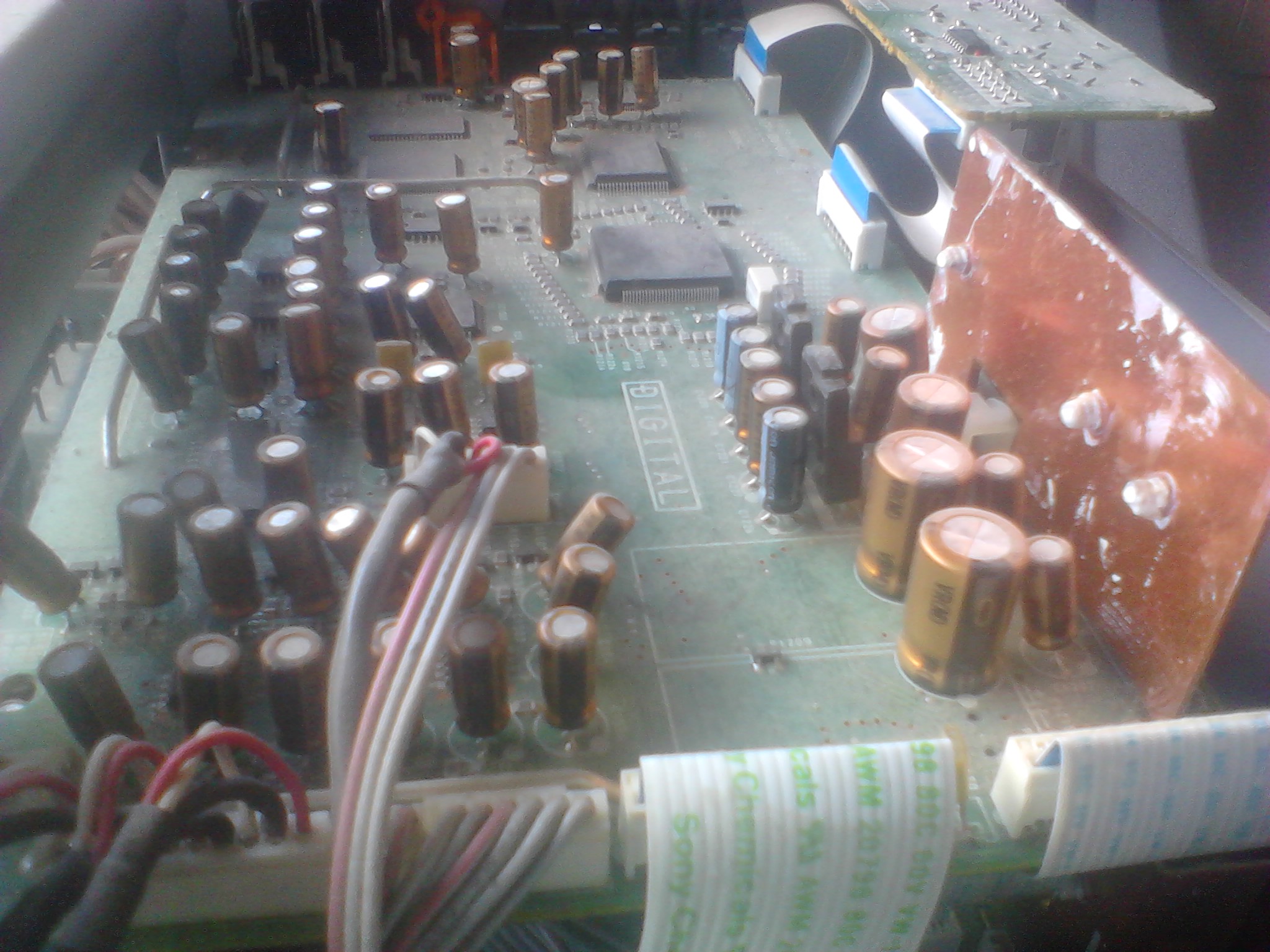

          Can we see the bulged Rubycon?
          Gave it him as a souvenir.
          I will get him to send me pic tomoz on whatsapp.
          I have the sony STR-DB830 which is very similar to his 925, think i better check my caps too lol.

            Just looked through the vents on mine and it has a different layout to his.
            Will open it up tomoz because there is a million wires plugged into it.

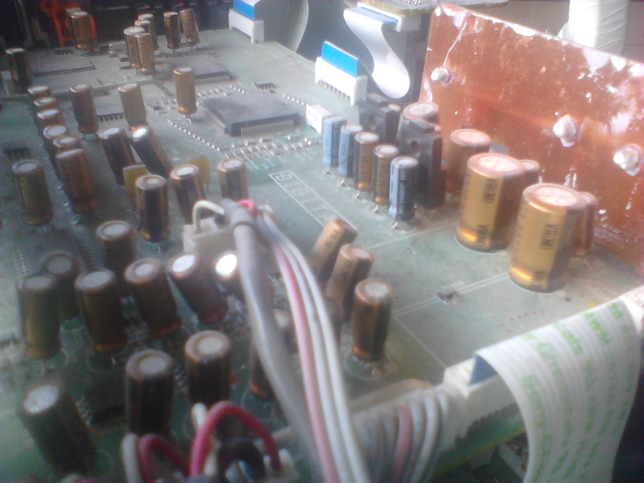

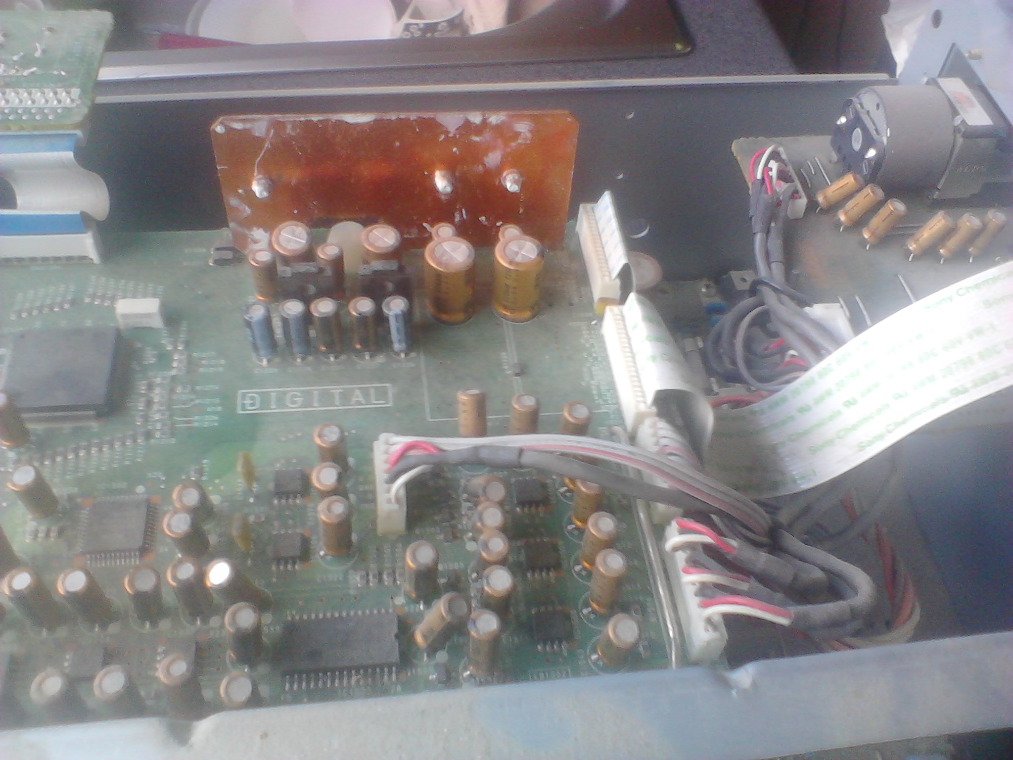

                Ok, it may not of been rubycon, Just opened mine up (STR-830) and it has 2 Large Nichicon Gold Tune caps on the psu and all the other boards are full of Gold coloured Nichicons and 1, yes 1 Jamicon!
                His caps were all black ones.
                So it must of been a Nichicon that bulged? As his amp is only a year older than mine.
